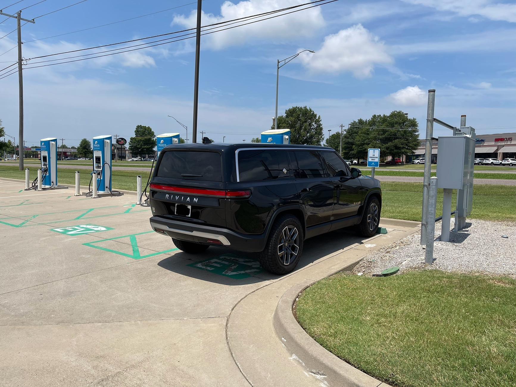

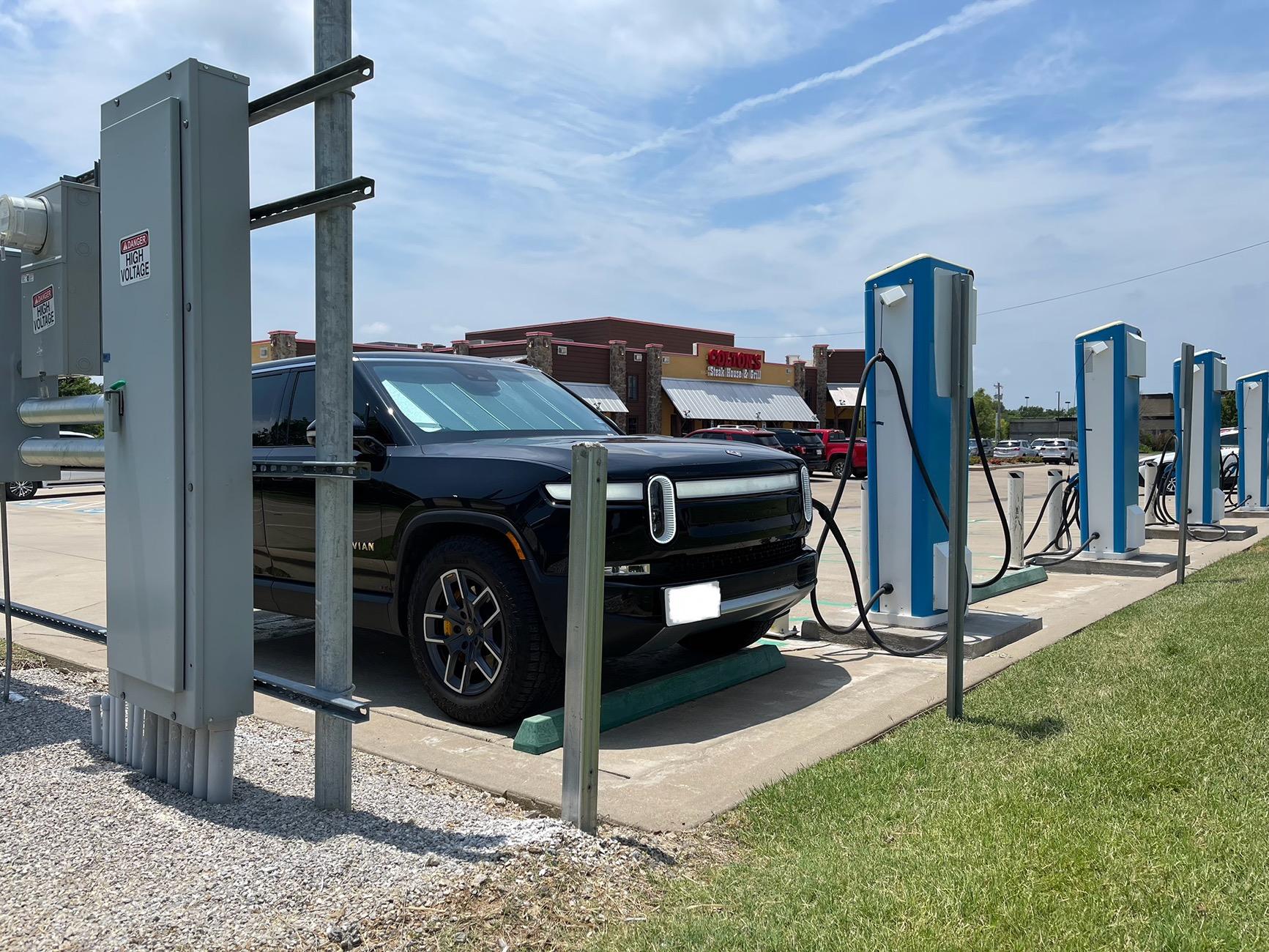

Are you getting the maximimum charge rates out of the units? Are they charging by the kwh or by the minute?
Francis Energy was like 52 cents per kWh, I did my best to hit Tesla chargers and pull down as much as I could and only used Francis if I was planning on making a rest stop or needed a charge to make it to the next station.
Honestly I don't remember exactly but I do know I was hitting like 150 kW - 170 kW speed easily.
Once It started to slow down around 80%, I moved over to a slower 50 kW charger at the Steak House down the street since I was planning on eating there and took my car to 100% charge for my road trip.
