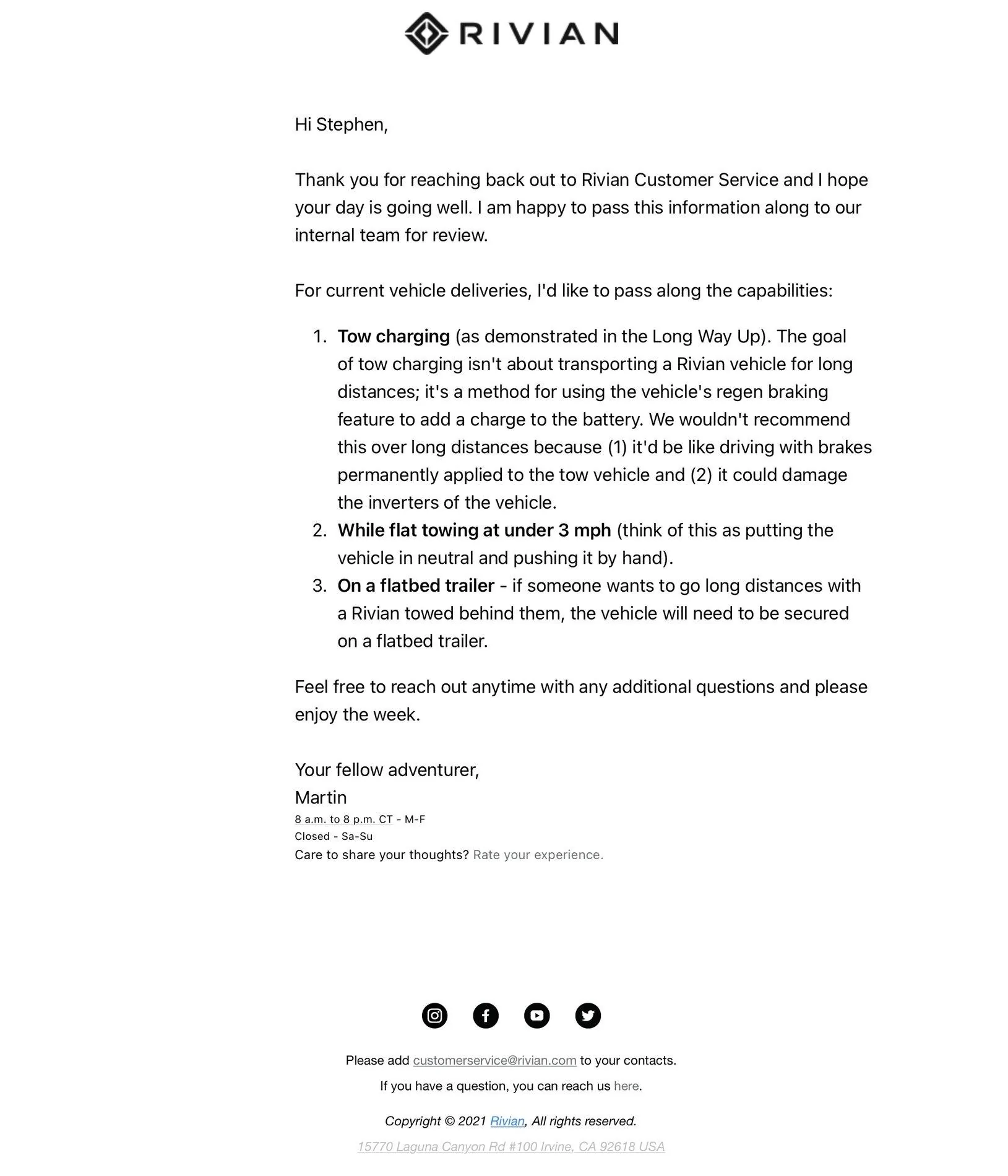

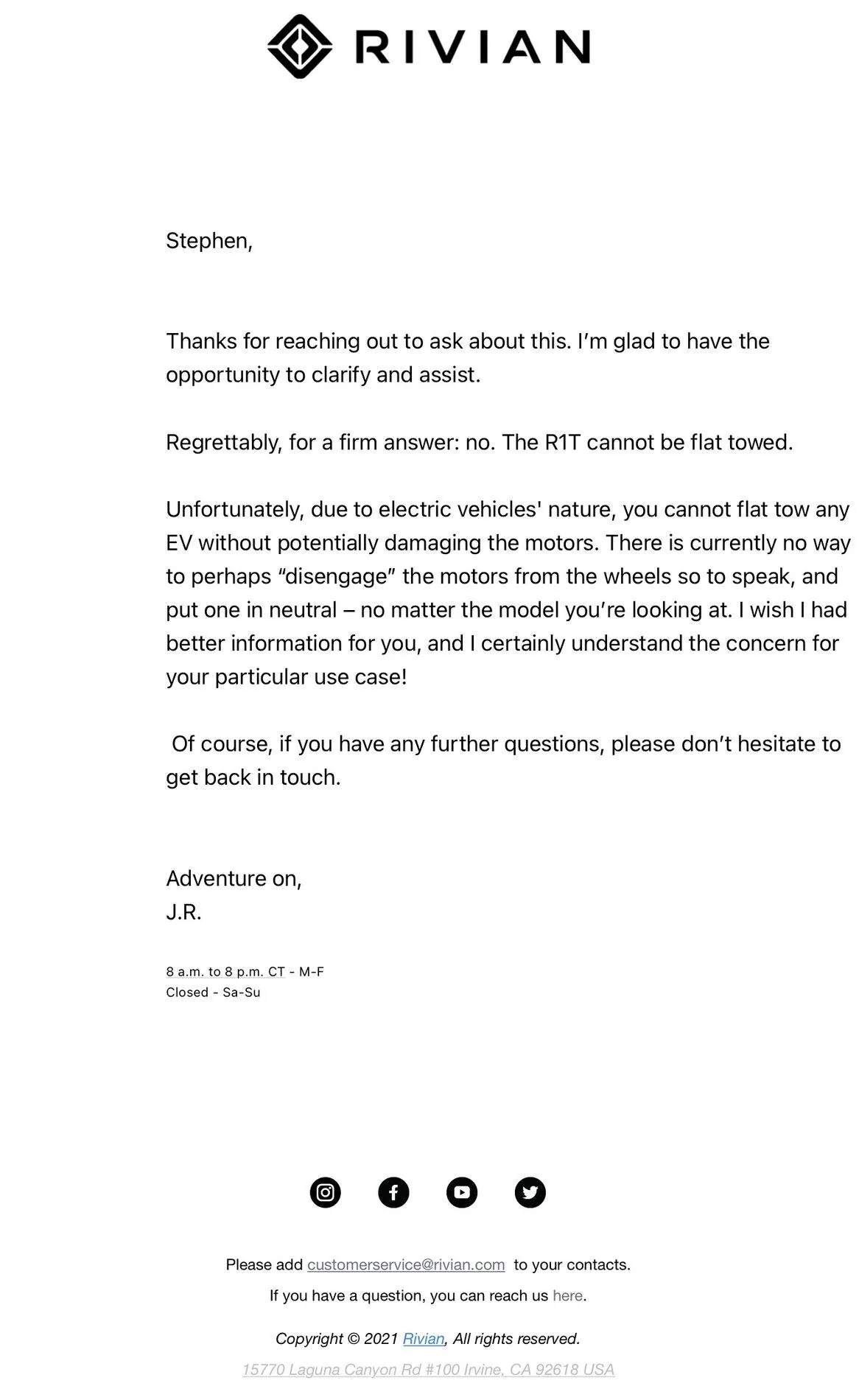

Although I think this is great news, it confuses me even more.
Why would we be able to tow charge a Rivian in neutral to add range according to one customer service rep, yet not be able to tow a Rivian with any wheels on the ground according to a 2nd customer service rep, all in the same day?
Those are two different things. You could technically tow-charge the R1T behind an RV, but that is a different use case than the "flat towing" that RVers typically want.
Tow-charging involves pulling the R1T behind another vehicle, with the electric motors in the R1T being used as generators to charge the high voltage battery. This will create significant drag on the vehicle towing the R1T. There is also probably a limitation that you must stop tow-charging the vehicle once the battery reaches a certain charge state.
RVers want to flat-tow a vehicle not to charge it, but rather so that it can be unhooked and used as transportation when the RV is camped at its destination. Most RVers wouldn't want to deal with the huge hit to fuel economy caused by the drag of tow-charging. Also, the potential distance limitation imposed by tow-charging may not be acceptable for the RVers use case, anyway.

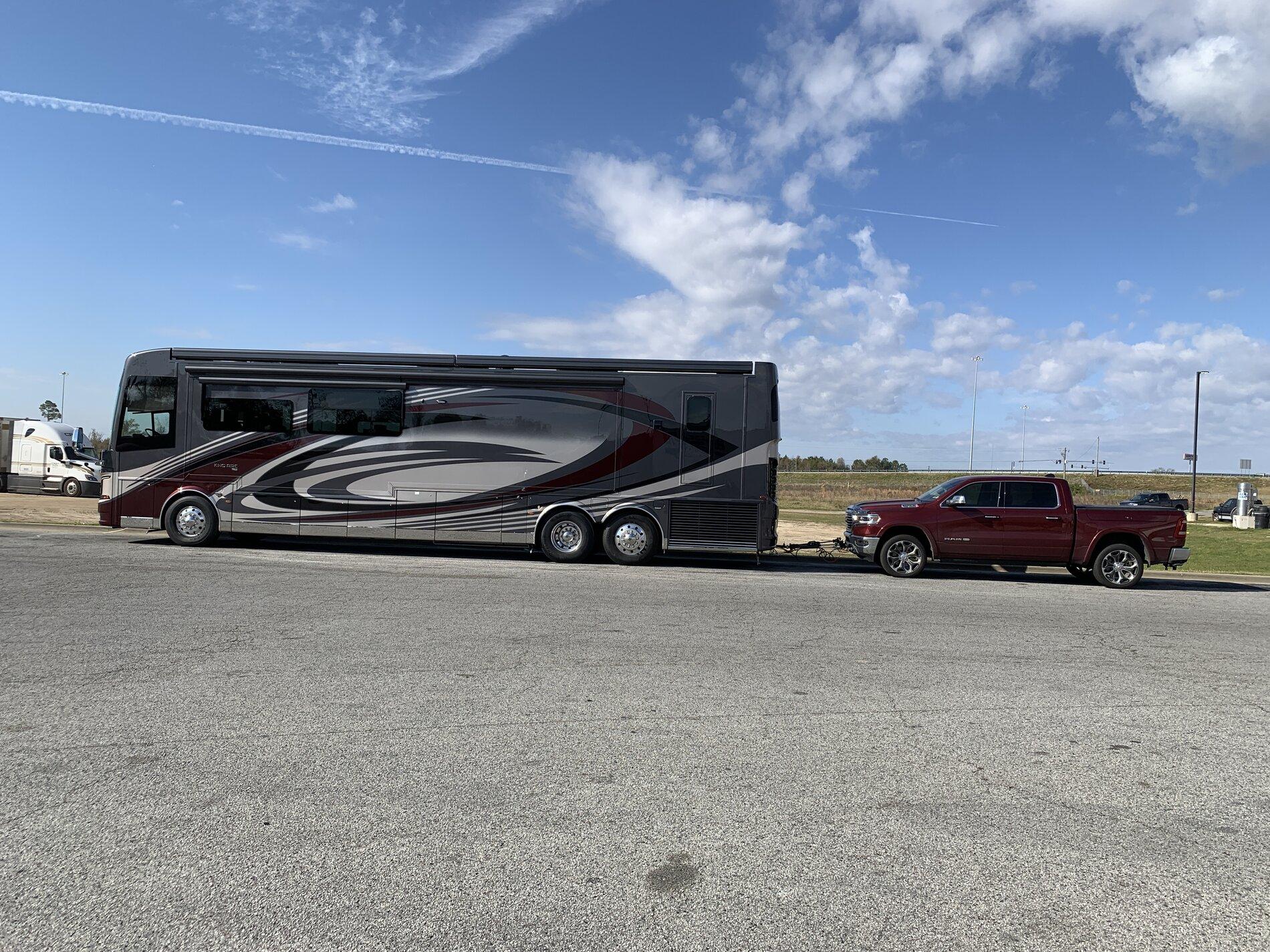

I don't know how many of you have flat towed a 6000+ lb vehicle with no trailer brakes, but it's really not safe. In a panic stop, the rear of the tow vehicle lifts, and then the towed vehicle tries to lift and jack-knife the tow vehicle. Lightweight vehicles aren't that much of an issue.
While I did not have any problems doing this with a 7000lb pickup behind a motorhome, I only did it because I was out of options and only going 90 miles.
As far as braking is concerned, it’s easily solved. I tow my RAM 1500 behind my RV as I have done in the past with my Toyota TIndra, Scion xB, several Jeeps, and a few other vehicles. Because my RV has air brakes, I use Demco’s Air Force One to perform proportional braking action in the TOAD. It uses a small piston attached to the brake pedal to apply the brakes when needed and supplies vacuum to the brake booster to reduce the braking application force. Further, it has a breakaway switch to lock the brakes up if the toad separates from the RV. There are other systems that perform the same functions, including for those RVs with hydraulic brakes.

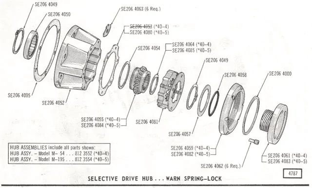

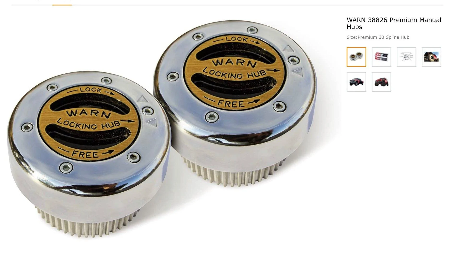

THIS IS A POSSIBLE SOLUTION — NOT THE ONLY SOLUTION — RIVIAN WOULD NEED TO SUPPORT IT IN PARTNERSHIP WITH AFTERMARKET SUPPLIER OR INCORPORATE IT IN ITS MANUFACTURING.
Problem Statement: EV motors and components are susceptible to damage when the EV is flat towed at the speed and distances normally experienced when towed behind an RV.
Proposed Solution: Manual Hub Locks will disconnect the drive wheel(s) from the entire line thereby inhibiting motion transfer to EV drive line components, including the EV motor.
Exemplars:
Manual Hub locks like the one shown operate at the wheel to set the configuration to “free wheel” or drive train “Hub”. Since flat tow already involves outside activities to attach the EV to the RV, the wheel configuration setting can easily be done at the same time.
Rivian R1T R1S Flat towing  a Rivian 1618322022508
One internal design that may likely be changed to suit Rivian EVs involves the drive line extending to the wheel hub housing to a termination point that allows its separation from the hub when selected. In the exemplar, the termination point is part #4049. The arrangement allows the wheel to free spin or be connected to the drive axle as the user selects.
Rivian R1T R1S Flat towing  a Rivian 1618322022567
The manufacturer currently offers the product in marine grade stainless steel, different appearance options, and different vehicle configurations.
A typical set of parts supporting 4 wheels purchased today on Amazon for the right vehicle costs less than $600 .

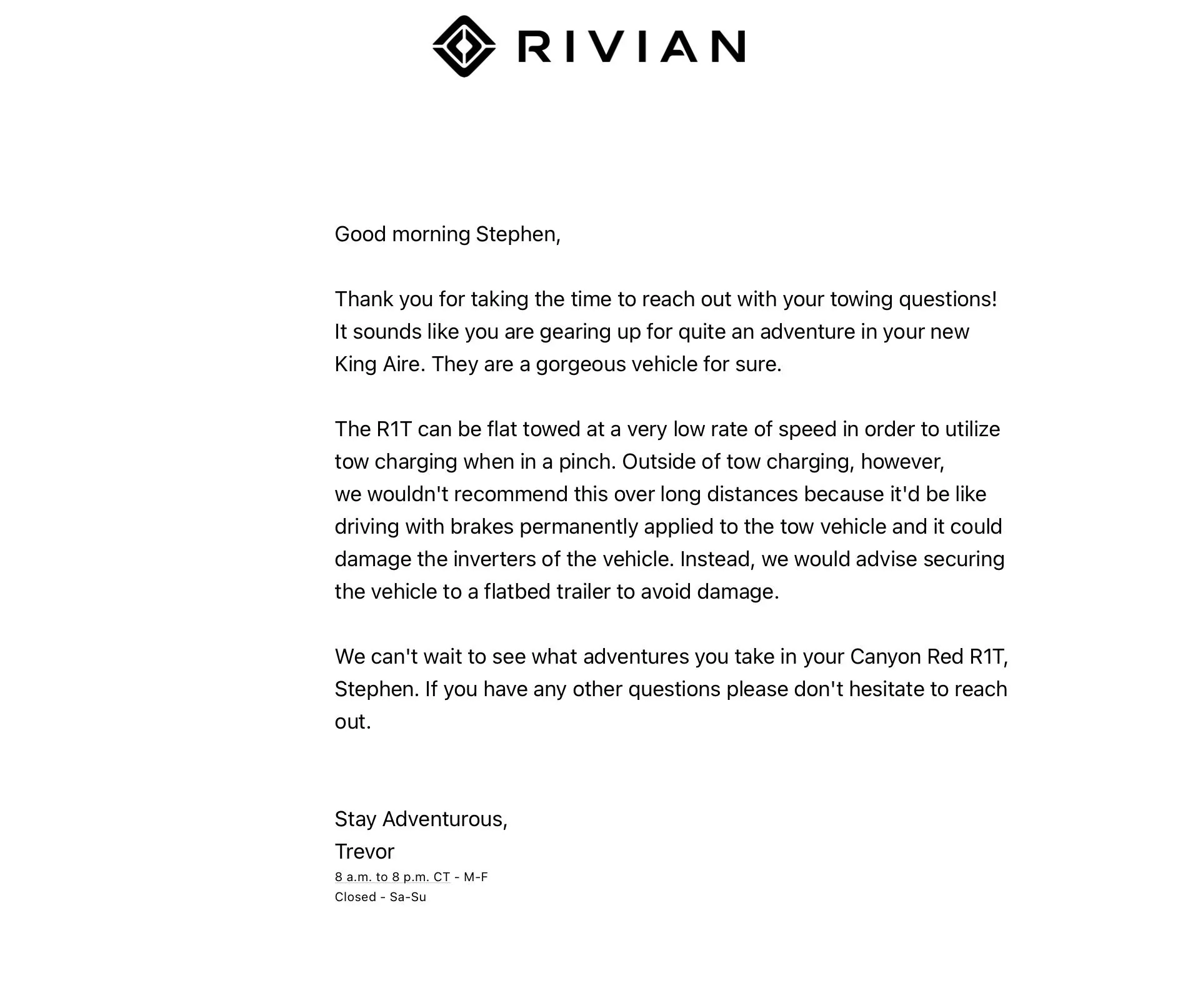

There’s been a lot of discussion about flat towing ranging from the basics of what is needed by most people, including me, of being able to tow behind their RV to additional benefits of enhanced braking, battery charging, etc. Unfortunately, the most recent news from the Rivian team is that flat towing is not available and other features are limited.
I’ve presented some considerations to Rivian who have held out that it’s under review by the design team. We’ll see.
This is the most recent letter I’ve received from Rivian regarding current flat tow capabilites:

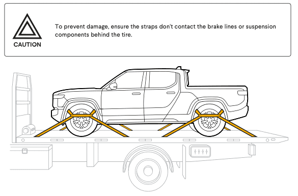

Do not tow the R1T with another vehicle with either the front or rear wheels on the ground and rolling. From page 175 and 177 of the current R1T Owner's Guide:
Rivian R1T R1S Flat towing  a Rivian 1639538082605
Rivian R1T R1S Flat towing  a Rivian 1639538139060
There is no disengaging clutch on the rear axle that allows the rear wheels to rotate without damaging the motors on the rear axle. Edit: a couple people pointed out that there is actually a clutch on the rear axle. That's what I get for assuming the R1T is like every other EV out there and doesn't have a clutch.
Also as @Autolycus said, the reason this is a problem on EVs is that for almost all EVs, there is generally no clutch that can be disengaged or transmission that can be put in neutral. For neutral on an EV, you are just shutting down the field to the electric motor and letting the system coast. There is a gear reduction unit (single speed transmission) that is always engaged and ties the motor directly to the wheels. As you tow the vehicle, the motors are going to be spinning, and will be doing so without any supplemental cooling that the vehicle may have. In addition, no power will be applied to supplemental oil pumps/coolers for the gear reduction unit. Both the motor or the gear reduction unit could overheat due to lack of cooling or possibly suffer issues due to lack of lubrication.
