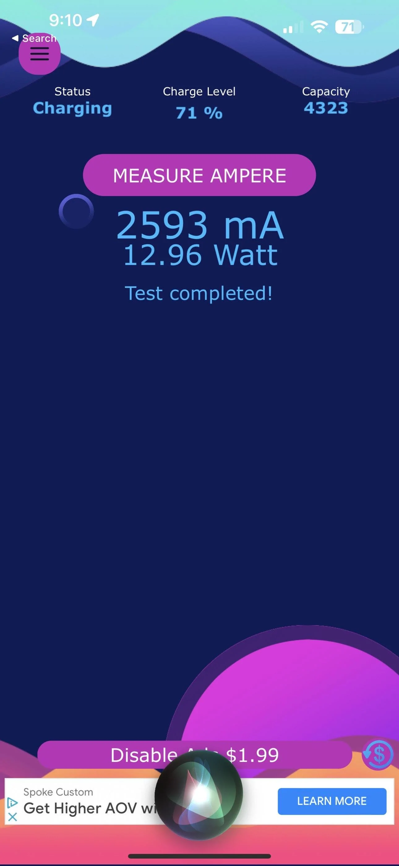

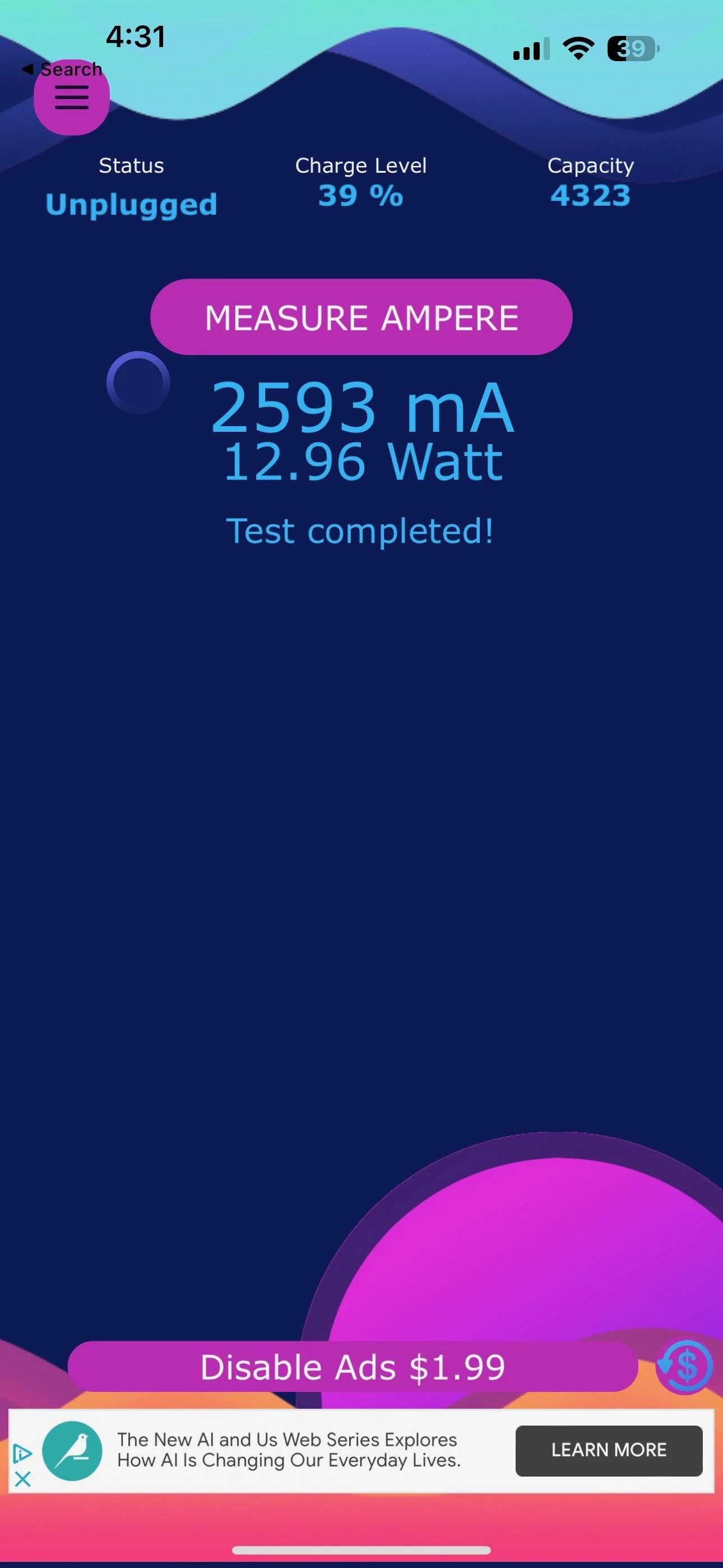

Tested a PD 3.0 buck charger. I was able to get 13 watts with the Apple Magsafe Chargers. So testing works. We will be putting in an order for these. For those that DID NOT order our pucks we will be sending an email to confirm which charger you want. Eventually when we run out of our original buck chargers we will switch over to this new one.
Attached are two pictures: The one with the earlier time and 39% charge was an iphone max 14 with no case directly on the magsafe charger. (control test)
Second one with the later time and 71% charge was with the wood plate in between the phone and magsafe charger. As you can see it did not change the charging speed.
I did not use a case, as each person's case will effect charging rates etc.
I should be getting our order of wood today. I will be staining the wood this weekend, and we should start shipping relatively s00n. If you are going to wait for the new PD 3.0 compatible charger please be patient as we wait for those to come in.

On iphone's the only magsafe charger capable of charging at greater than 7.5 watts are the official Apple magsafe ones. Unfortunately, those specific chargers require a very specific voltage/amp combo. So I had to find a new buck charger (a dc-dc voltage drop down module that outputs with a USB A or USB C plug) that would work with Apple Magsafe chargers.
If you are using aftermarket magsafe chargers (which are totally fine and work great) they can output at higher rates or the default 7.5 watts with iphones.
TLDR: Buck chargers convert the 12v to USB. New ones allow Apple Magsafe to work full speed. Third party doesn't matter.
