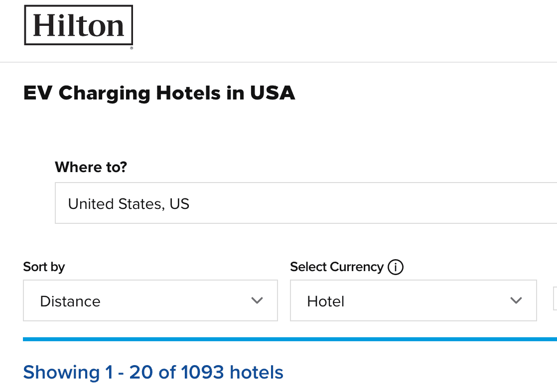

Hilton has a page that shows all Hilton family (Hilton Garden, Hampton, Homewood, Doubletree, Embassy Suites, etc.) locations (1093) with EV charging. Sign up for Hilton Honors and get free nights as well.
Disclaimer: I don't work for them. I've been staying at Hilton properties for business and personal travel for years, always been happy with them, and have earned dozens of free nights over the years.
