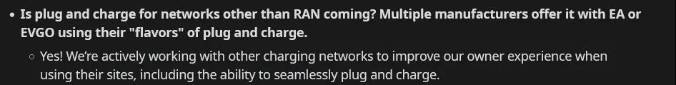

At the end of the day, the whole plug and charge thing is a bit disappointing. This is mostly because certificate management has to pass thru the OEM, and it's not possible for the owner of the car to signup with a charging network directly and present their identity keys or certificate. It's be really nice if compliant vehicles could be self-enrolled in the charging networks app without needing a software or OEM coorperation.
For what it's worth, Rivian has said they are working with their charging partners. Who knows what that actually means and what the holdups is though.

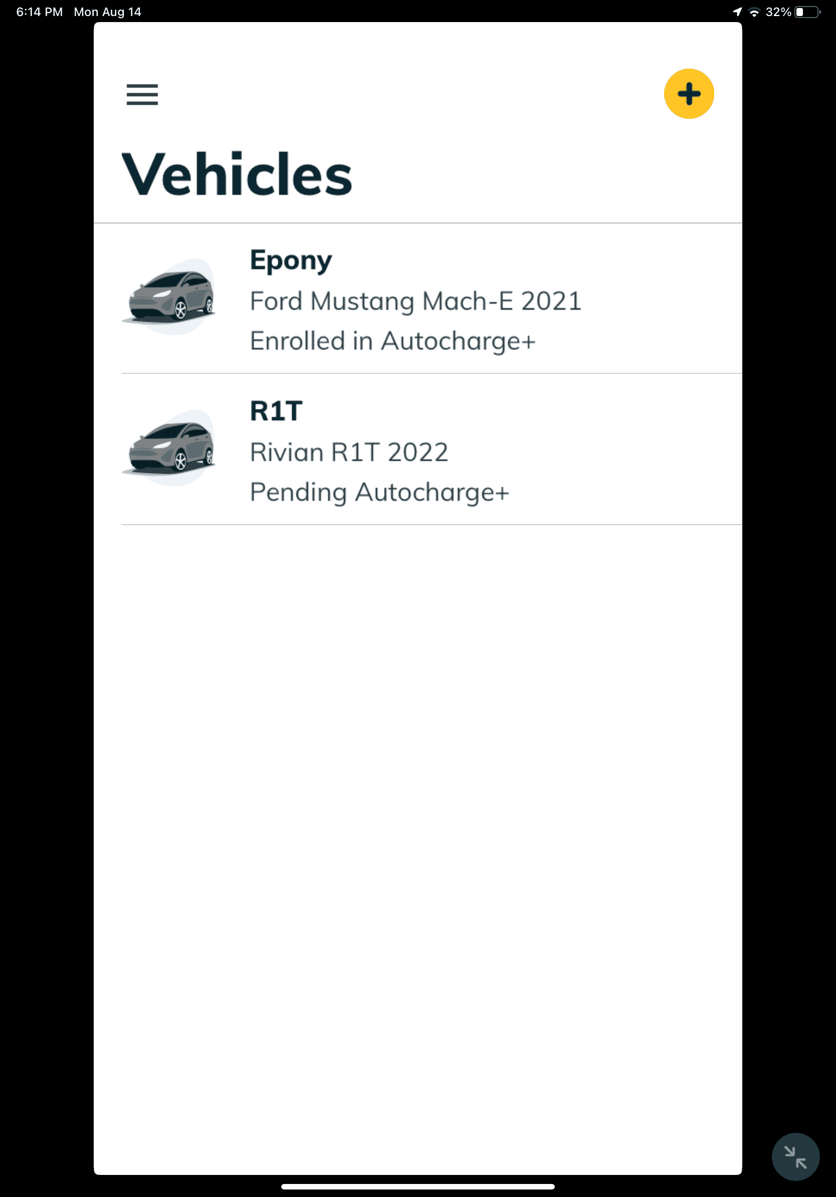

Was able to get Autocharge+ working today with my R1T. If you already added a VIN into the EVGo app you'll have to either delete and start over or change the Driver associated with the vehicle to get it to prompt enrollment. My truck is still on 2023.26.0.
azbill
Bill
Jun 8, 2020
1,699
1,983
Arizona
Mine is showing pending, so I may try it tonight. Wife is using the truck right now. I was thinking it might require the software update in the truck first.
100% Correct. I've been using the EVGo Charger near me for the last couple of months. It's sweet and fast Vs the Garbage EA Charger a few blocks away in a sad dark Walmart parking garage but I digress. The trick for AutoCharge is I added my R1T as an additional vehicle using the VIN* and now I'm Pending Autocharge+ :clap:
I simply deleted the non-Autocharge R1T and that's that.
(All inside the app since the web portal's slightly wonky.)
