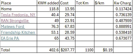

Have you ever compared your expenses on ev vs gas. I used my r1s this weekend and charged it a bit at a public charging station. It was $.50/kwh. It cost me $12.50 for a 57miles added miles. I then realized that it's actually going to cost me more to do a long drive with EV rather than a gas SUV. I would spend about $60 to get about 400 miles added for a range rover evoque while it would end up costing me about $87 to charge multiple times to get up to 400 miles added.
What are your experiences? Is charging in public always going to be costly?
I went from Niagara Falls to Sandusky Ohio this week and the it was cheaper than my F150 but more expensive than the Ford Escape we got rid of.
(all costs in CAD)
Rivian R1T R1S EV use can be more expensive than gas 1717189008584-el
(tesla, RAN, Blink, EV Connect and Electrify America)
That works out to 19.00/100km, my f150 takes about 13l/100km and at 1.75/l that is $22.00/100km and the old escape was 10l/100k that would have been $17.50/100km
If you look though the Tesla and the charger at Matews Ford (Blink Network) were really really effing expensive so ultimately comes down to better planning and research on my part.
The good thing is that 95% of our charging is done at home so expensive charging is definitely not the norm.
