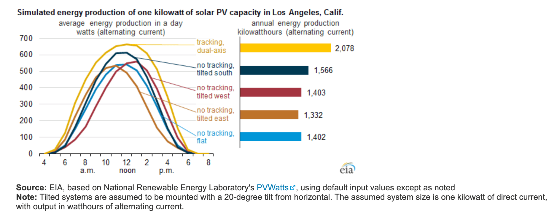

Here's a graph of typical output during the day from a 1 kw panel that has been properly oriented in full sun. Hopefully we can agree that panels draped across the vehicle are not properly oriented and will have a lower output? In this graph, a 1 kw panel is peaking at 600 watts for a few hours. If you want to do this type of set up, great. Just understand that the limitations are significant due to the less than optimum orientation of the panels and the manufacturer is not really telling you the stark reality. Ask yourself why the manufacturer has not provided actual test data or graphs.
In the graph below, realistic daily output of a fixed, properly oriented south facing panel is 1566/365 = 4.2 kw per day for a 1 kw panel. Clearly this portable system will not achieve this amount of output due to the panel orientation challenges.
You can run your own simulation for your area at https://pvwatts.nrel.gov/
