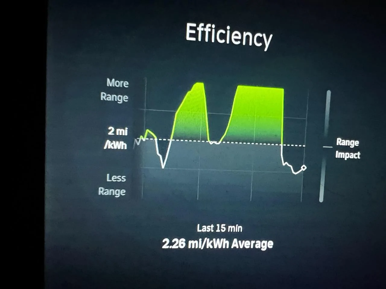

Warmed the cabin for 10 minutes this morning inside my garage, which was at 56 degrees. Had the fan at 70 degrees on the lowest setting, quick jaunt down the road (5-6 miles) on a sunny 45 degree day.
look at that bunny slope!
Rivian R1T R1S Efficiency Has TANKED IMG_0191

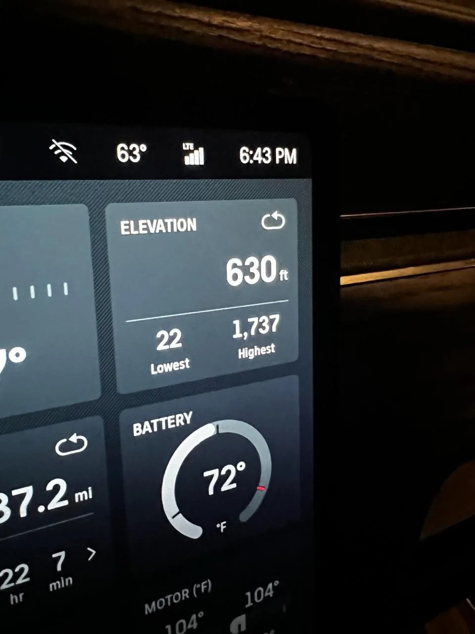

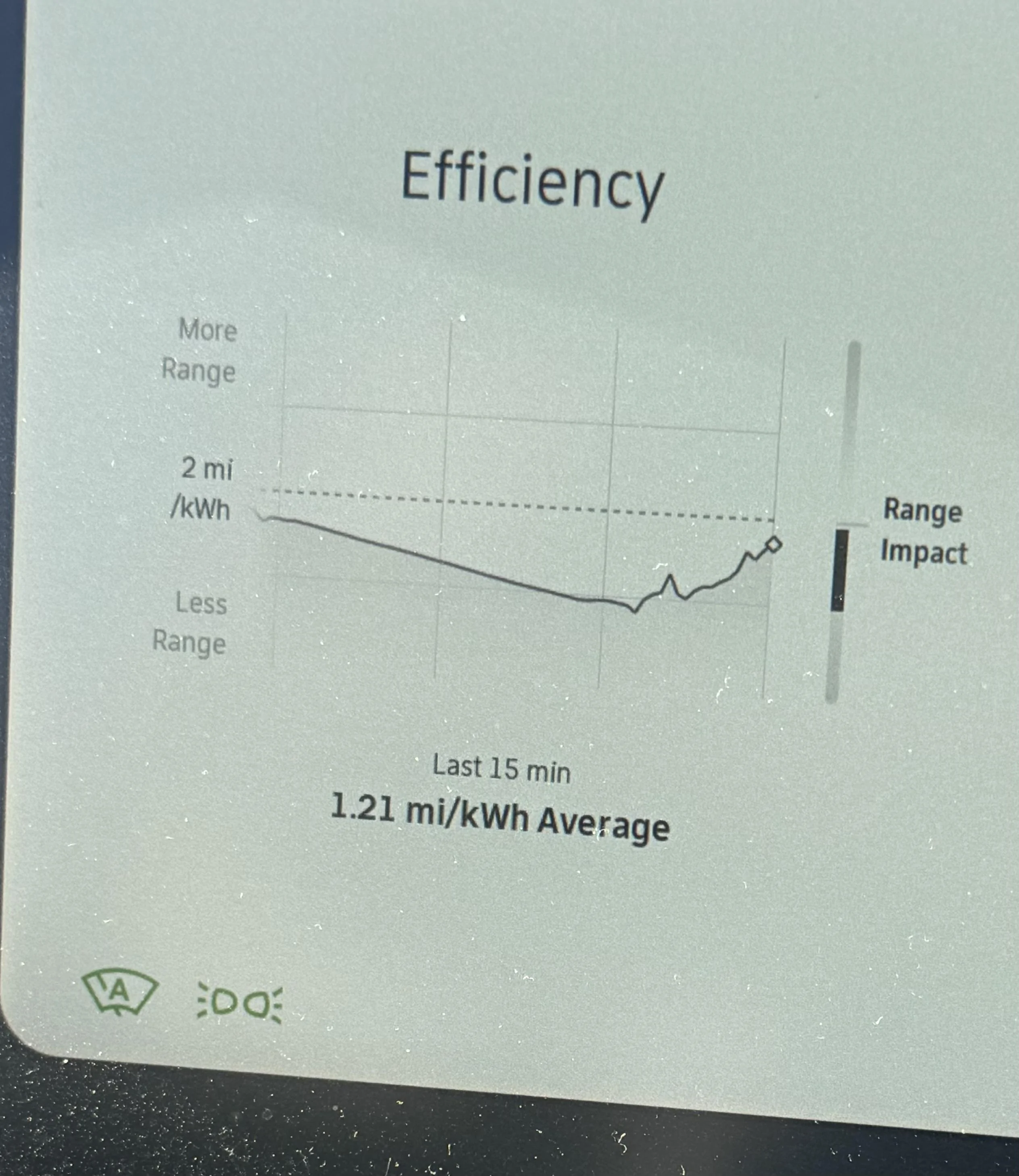

Rivian R1T R1S Efficiency Has TANKED IMG_2651
Rivian R1T R1S Efficiency Has TANKED IMG_2652
That drop off on the end of the graph is the heater kicking on— I keep it in 72 or 73 auto and it changes wether heat or AC on its own. The efficiency stayed around 1 the rest of the 20 min drive home. LA is not cold… my truck has been wildly underperforming in the efficiency department since day 1.
I had a loaner on OE 20’s that I drive 2k miles over 4 weeks and rarely got below the 2 line and it also never moved as fast as mine does— much more stead and smaller changes in efficiency rate. Overall I did about 2.2 over 2k miles vs 2.1 over 12k miles in my OE 21’s and 1.9 on my 20’s with 33” Recon Grapplers. Changing wheels and tires has basically made it impossible for rivian to want to consider any issue, even the issues that predate the wheel and tire swap.
