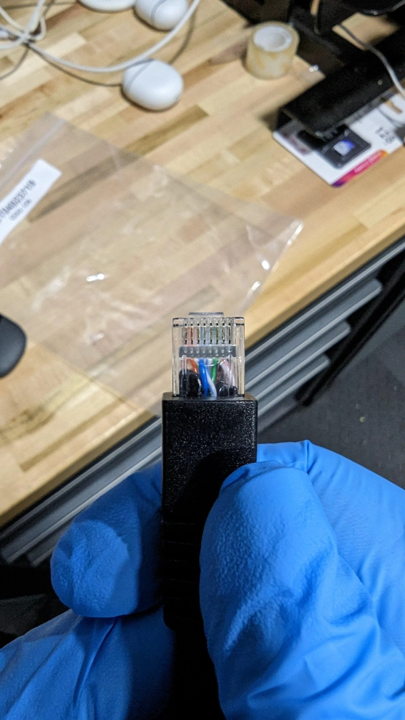

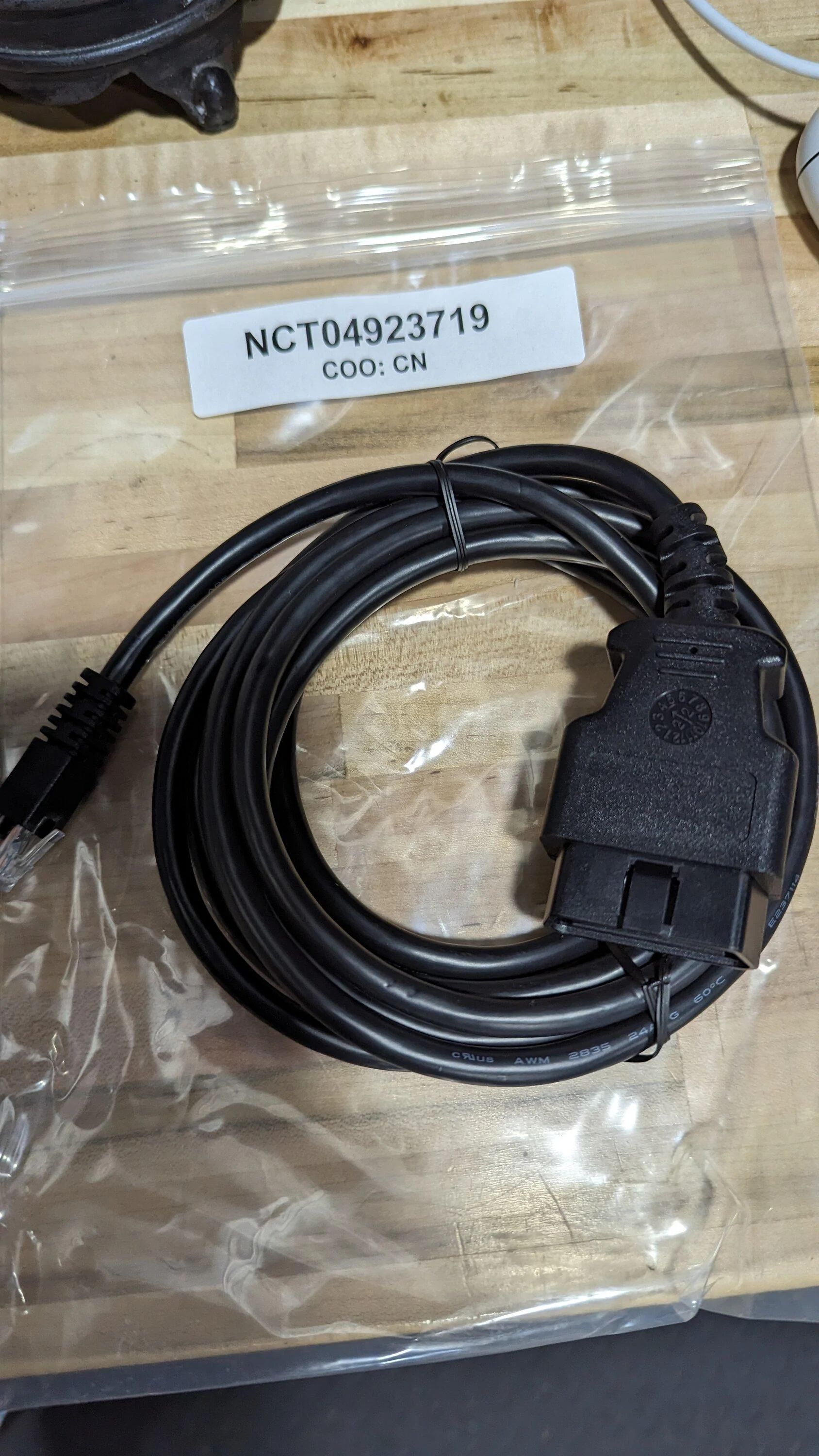

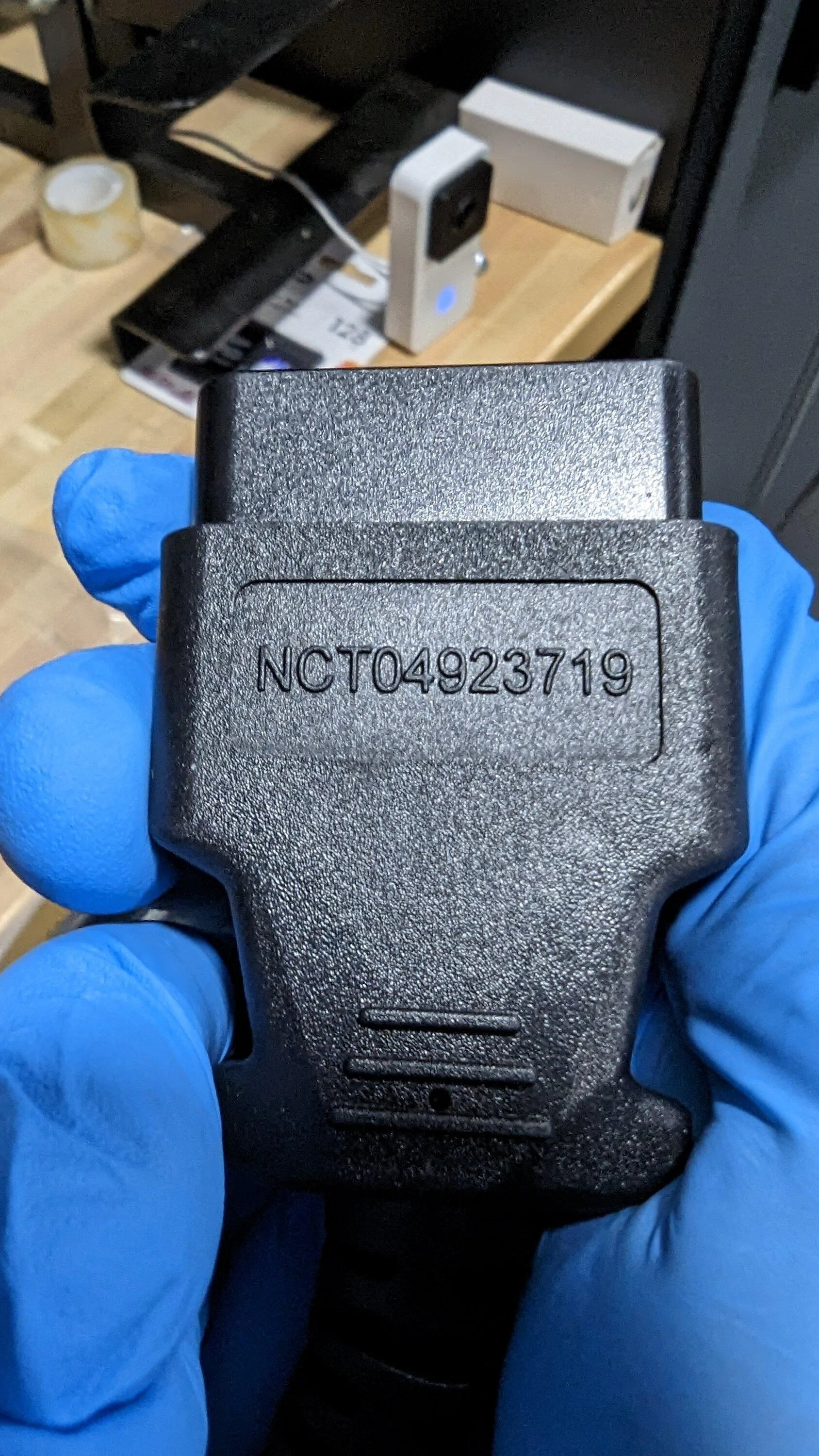

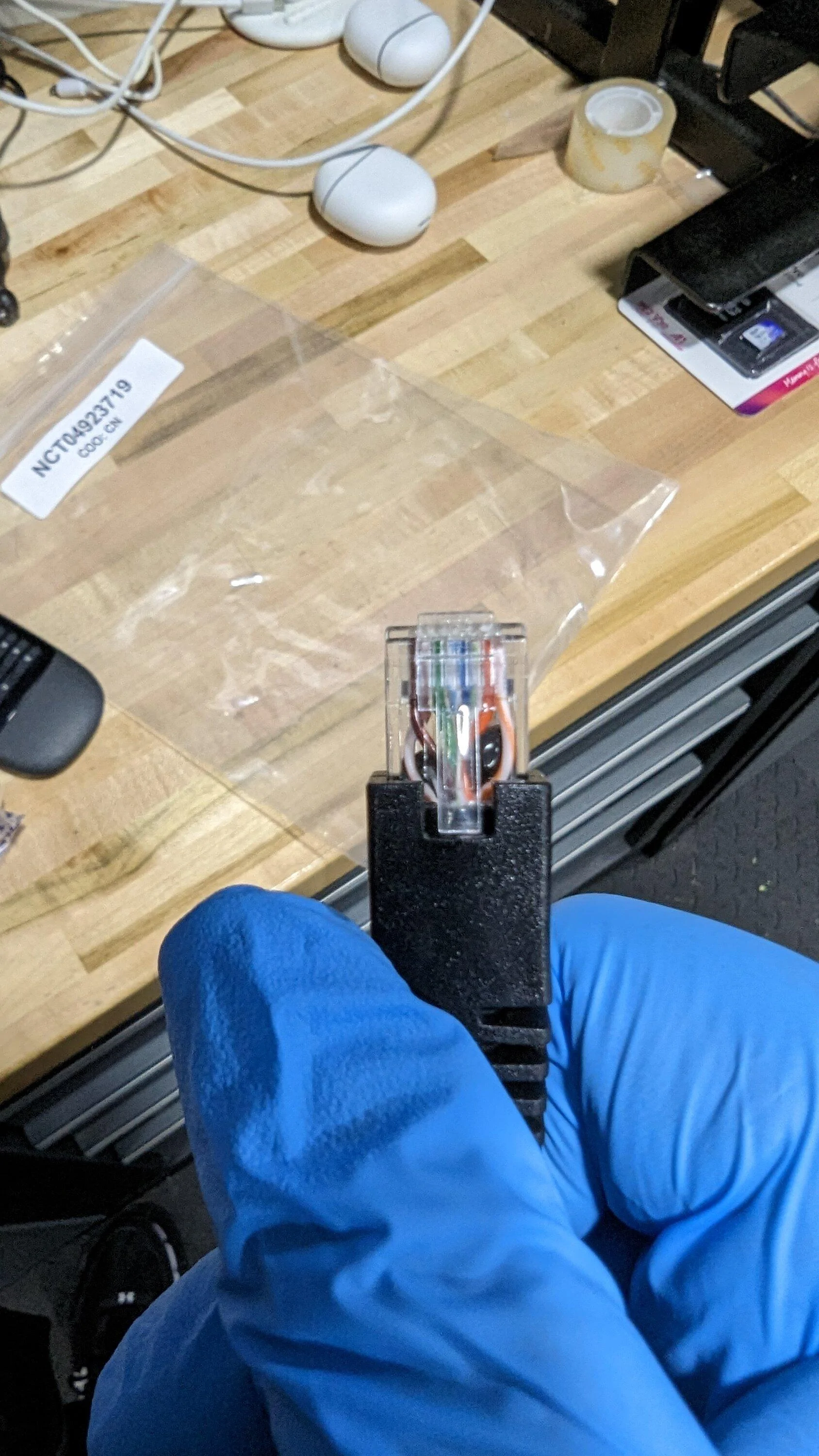

Okay so I received the Rivian branded obd to Ethernet port today.
Rivian R1T R1S Does Rivian have an OBD-II (OBD 2) Port? obd2_connector
Here's is my finding so far.
Obd pin 6 / Ethernet pin 1
Obd pin 14 / Ethernet pin 2
Obd pin 13 / Ethernet pin 3
Obd pin 12 / Ethernet pin 6
Obd pins 4-5 / Ethernet 8
Ethernet pins 4,5 and 7 appear open and do not appear to pass through to any pins on the obd side.
I also didn't measure any noticeable resistance on any of the pins.
The cable that arrived from Rivian is not serviceable like the photo on the website. It is a solid molded cable.
I haven't had a chance yet to hook this up to a laptop, but when I do I'll also Wireshark the connections to see if I can find any details.
I'll also see what other details I can find out..

I can say I have connected the cable to my laptop and ran a Wireshark and could not see the Rivian requesting or sending data. I can say that it does establish a network link.
I also tried placing a router in the vehicle to act as a quick and dirty DHCP server and the truck didn't request any IP information.
I'm not exactly sure what kind of data would be passed/requested from the truck at this point.
I'm sure they're using some semi standard methods of doing this. Just now one in familiar with unfortunately.
Anyone else have anything they'd like me to try?

I agree it would seem like that would be the case, but Wireshark should have seen traffic from that devices if it sent any network packets.
I tried a few tools to scan for tcp or udp traffic and didn't see the truck talking at all.
Now it could just be very quiet and basically only listening or talking when it's told to..
Could be it uses like a magic packet to wakeup the truck then communicate over the statically set network..
I'm open to trying any suggestions anyone may have..
