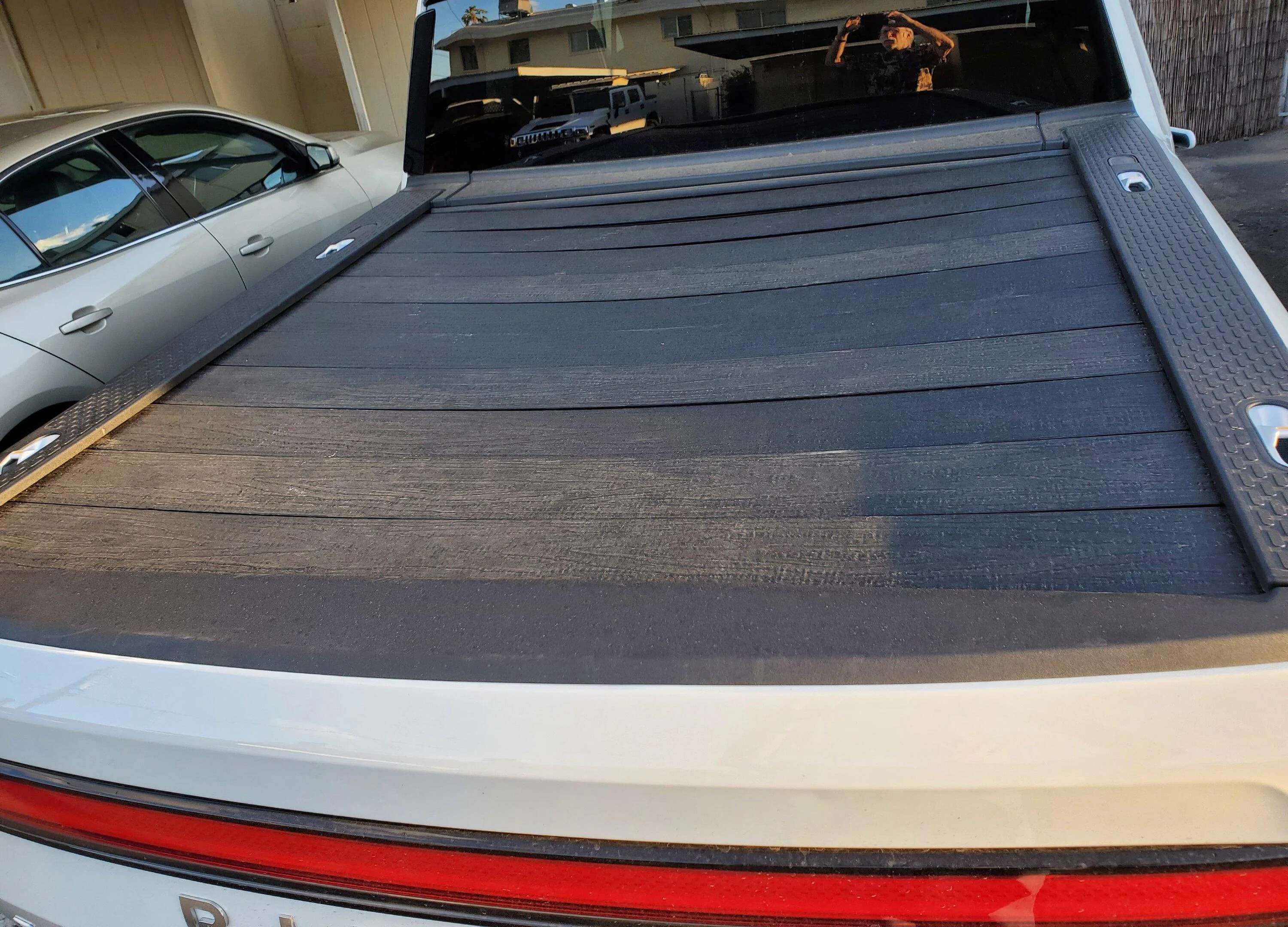

Well, this is my temporary manual tonneau cover, a work in process:
Since my truck had the end caps on the rails, I cut the caps such that the slots continue through the end caps.
Then I cut (to a length of 54 5/8") ten slats of the Shou Sugi Ban. At this point, I just slide the ten slats into the rails. The slats are a bit too flexible, so they sag some, as you can see in the photo. Eventually I expect to bind them into three panels, with at least one 1/2" aluminum channel or angle across each panel. That should stiffen them up.
I would like to caution anyone who might consider these NewTechWood slats of two things:
1) Most (or all) of the slats had one end from the factory which was cut way out of square. I didn't notice this until I had cut several slats to length.
2) There was shipping damage on some of the slats in each of the two boxes of five. Home Depot didn't stock them locally, so I had to order them, and wait about ten days. Fortunately, I was able to cut off (as waste) the worst of the damage.
I also made mine out of this same material about two weeks ago now. I luckily didn't have any issues with shipping damage. I found that they slide much better when. cutting a little shorter than needed. I made 4 sections, the two middle are 3 slats, the front is 2 and rear is 2.25. I used some rolled c channel to combine the slats together, then sliding door latches to keep each section at the same level as the next one connected to it (might change and do 6 latches soon). For sagging, I have a piece in the middle up against the front and one at the rear standing up against the tailgate. Both are notched so one long piece slides into the notches and pushes up on the middle of all slats for support. I dont really care of this technique, but it is what it is until I figure out a better idea. I might buy some aluminum L shaped channel and run one on each side of the four slat ends, then I shouldn't need the door latches anymore, as each should stay level all the way across. Your'e right about the rugged wood look matching the inside trim!

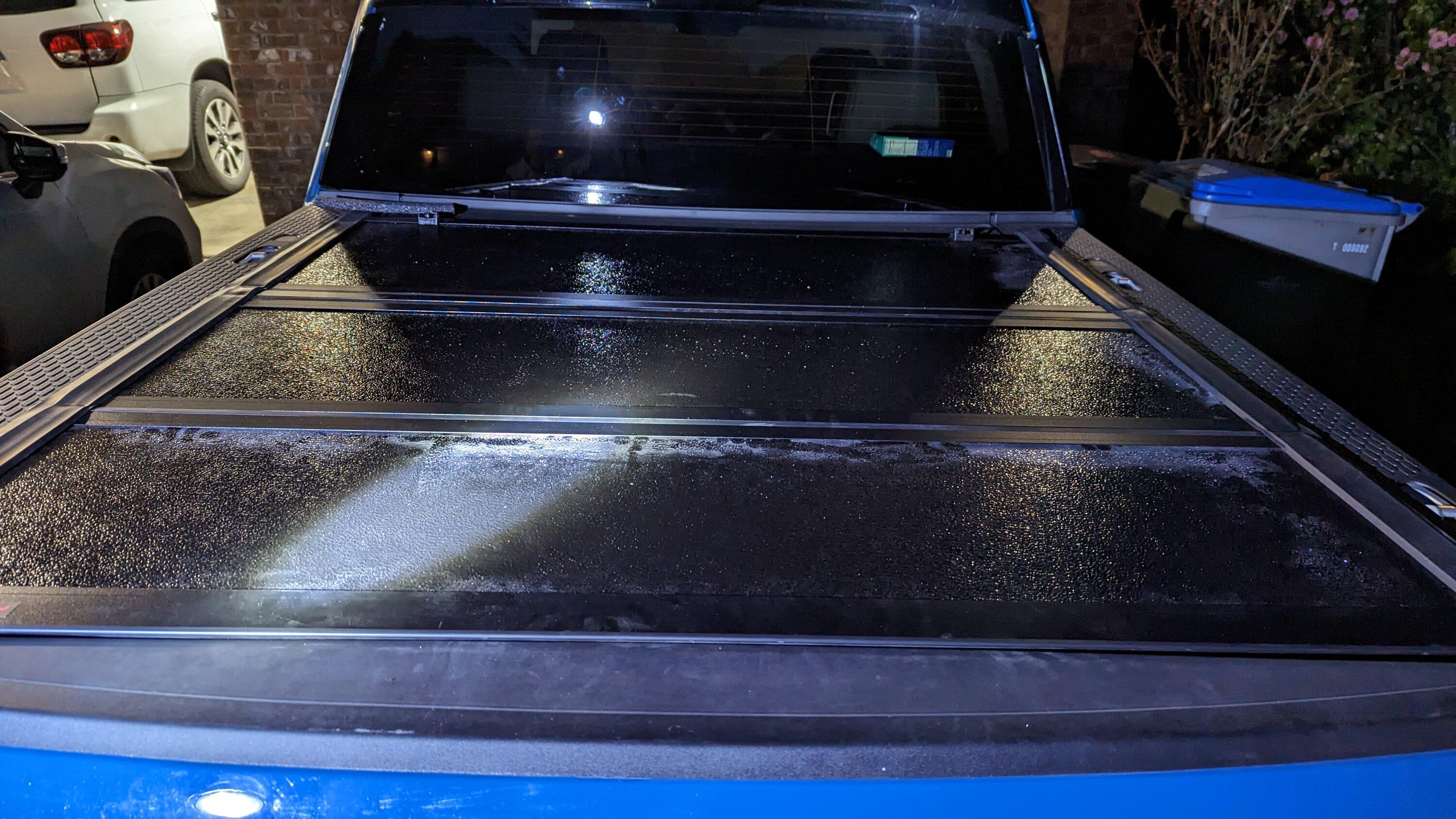

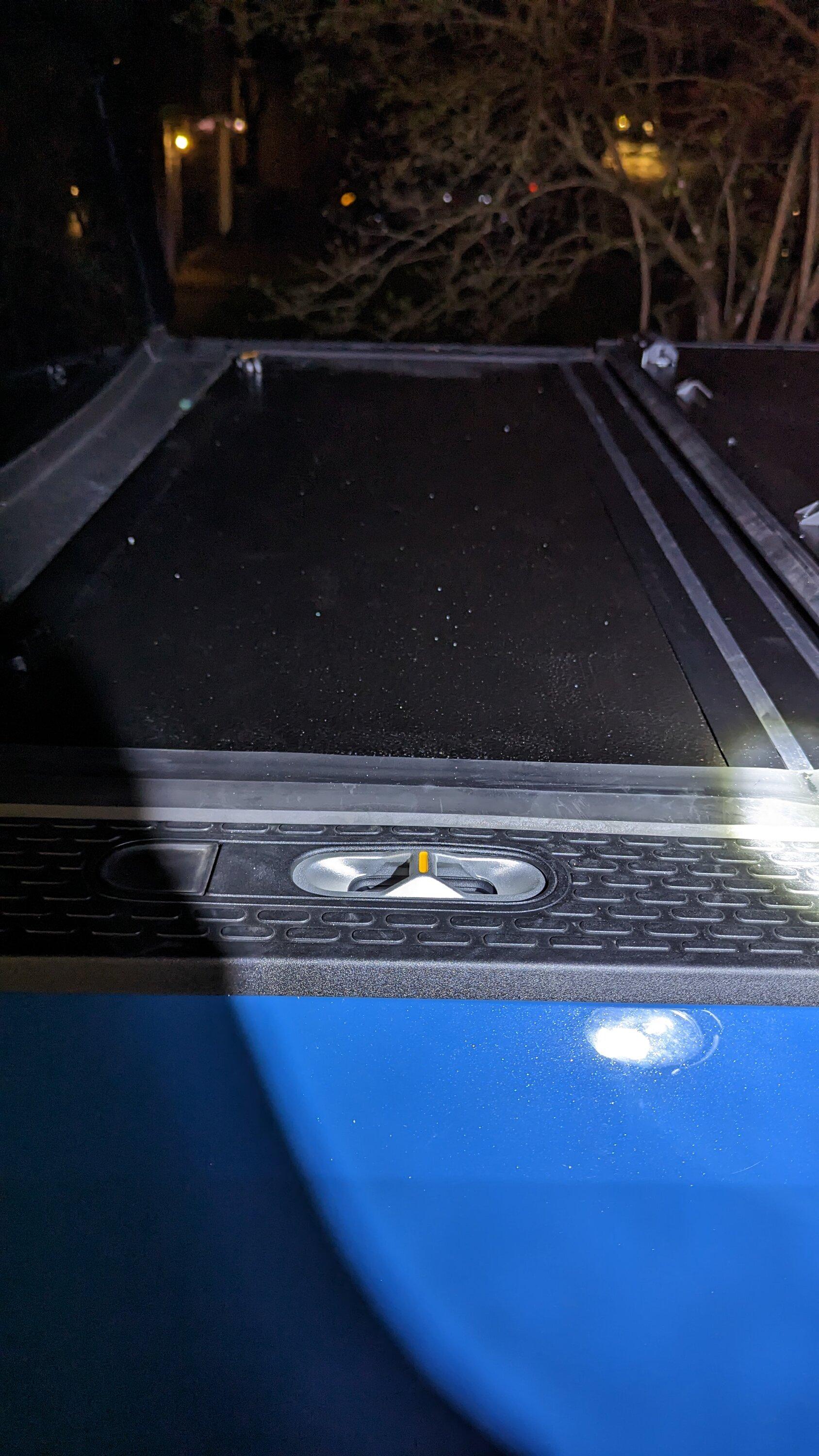

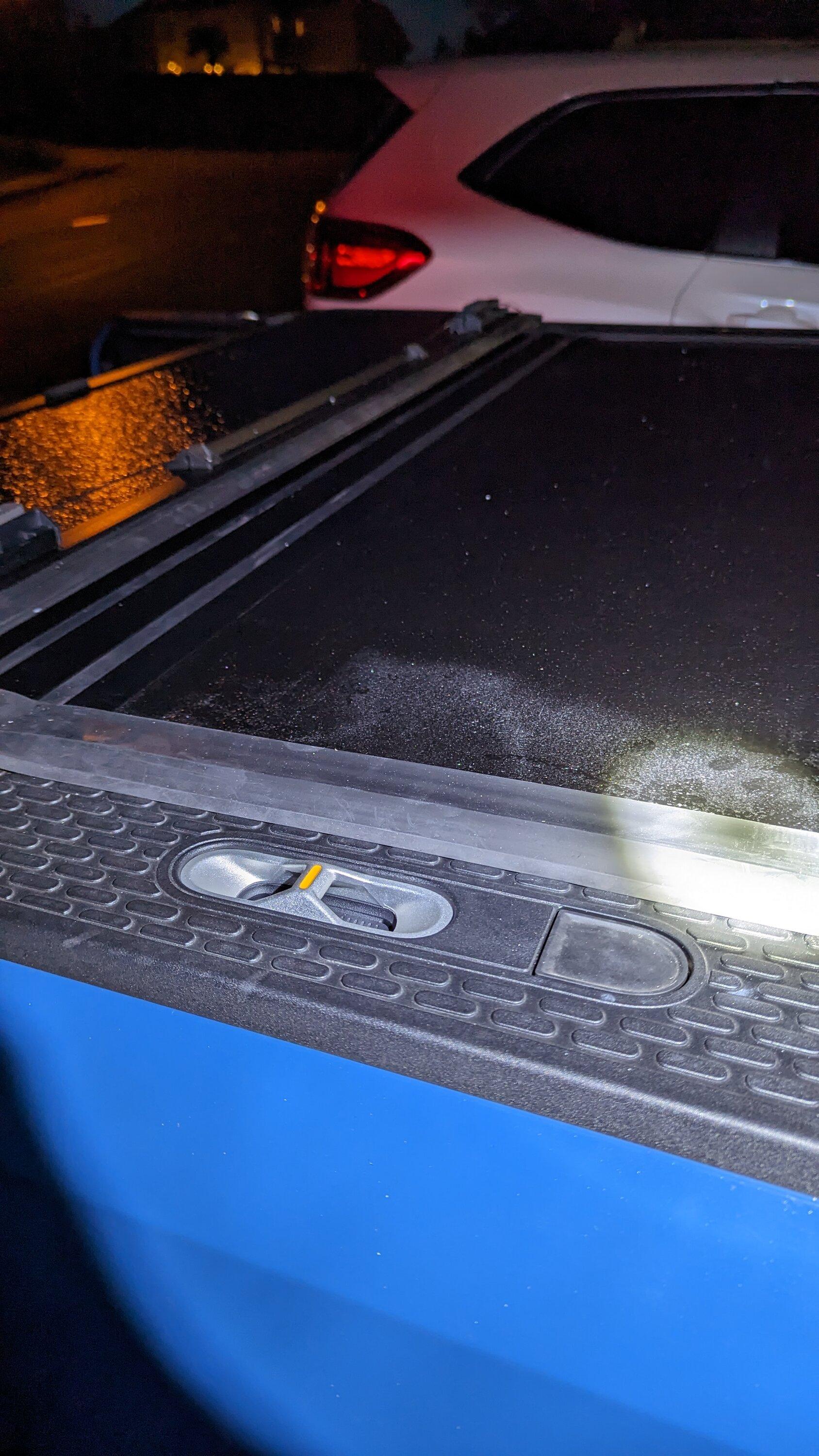

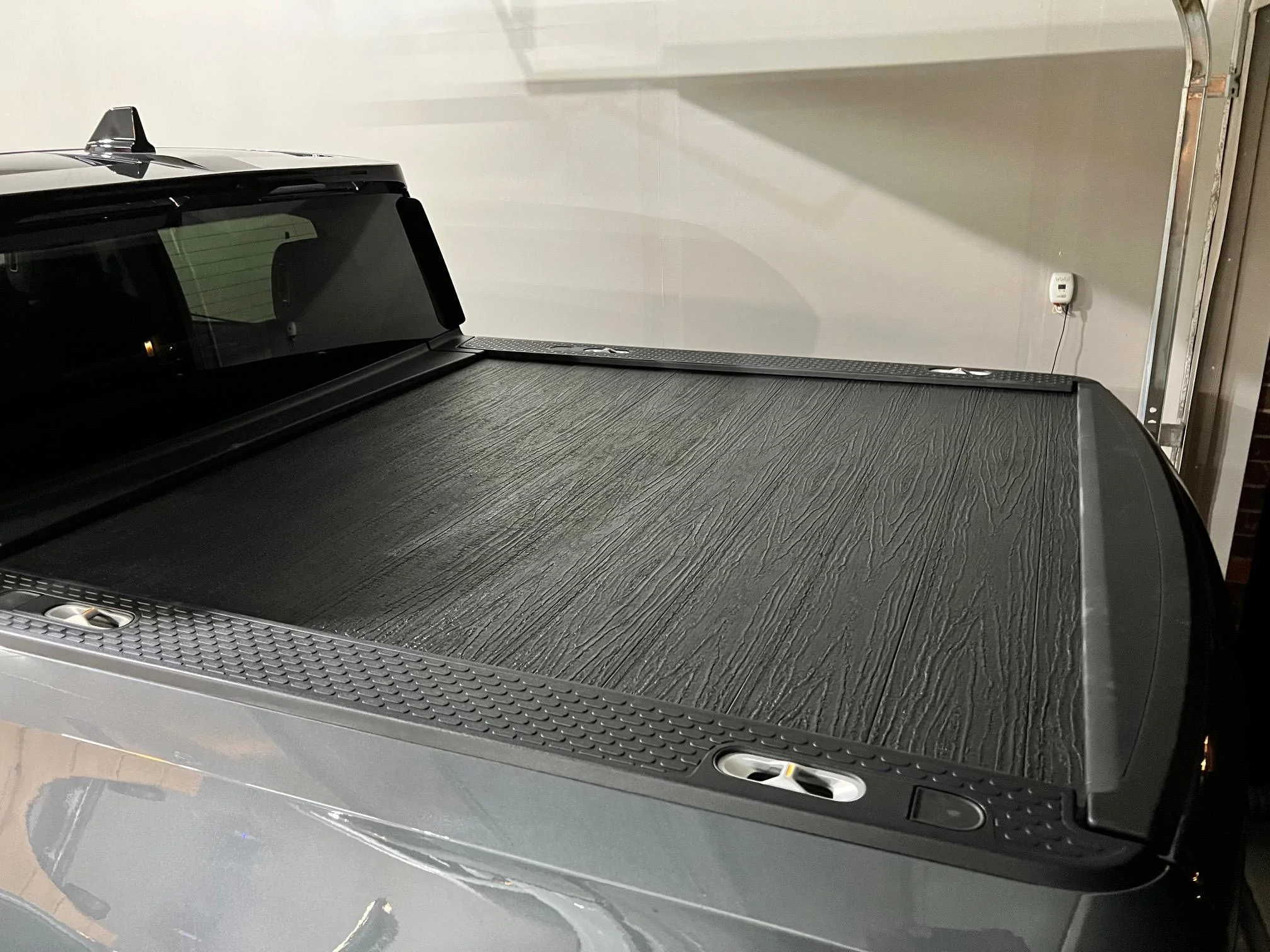

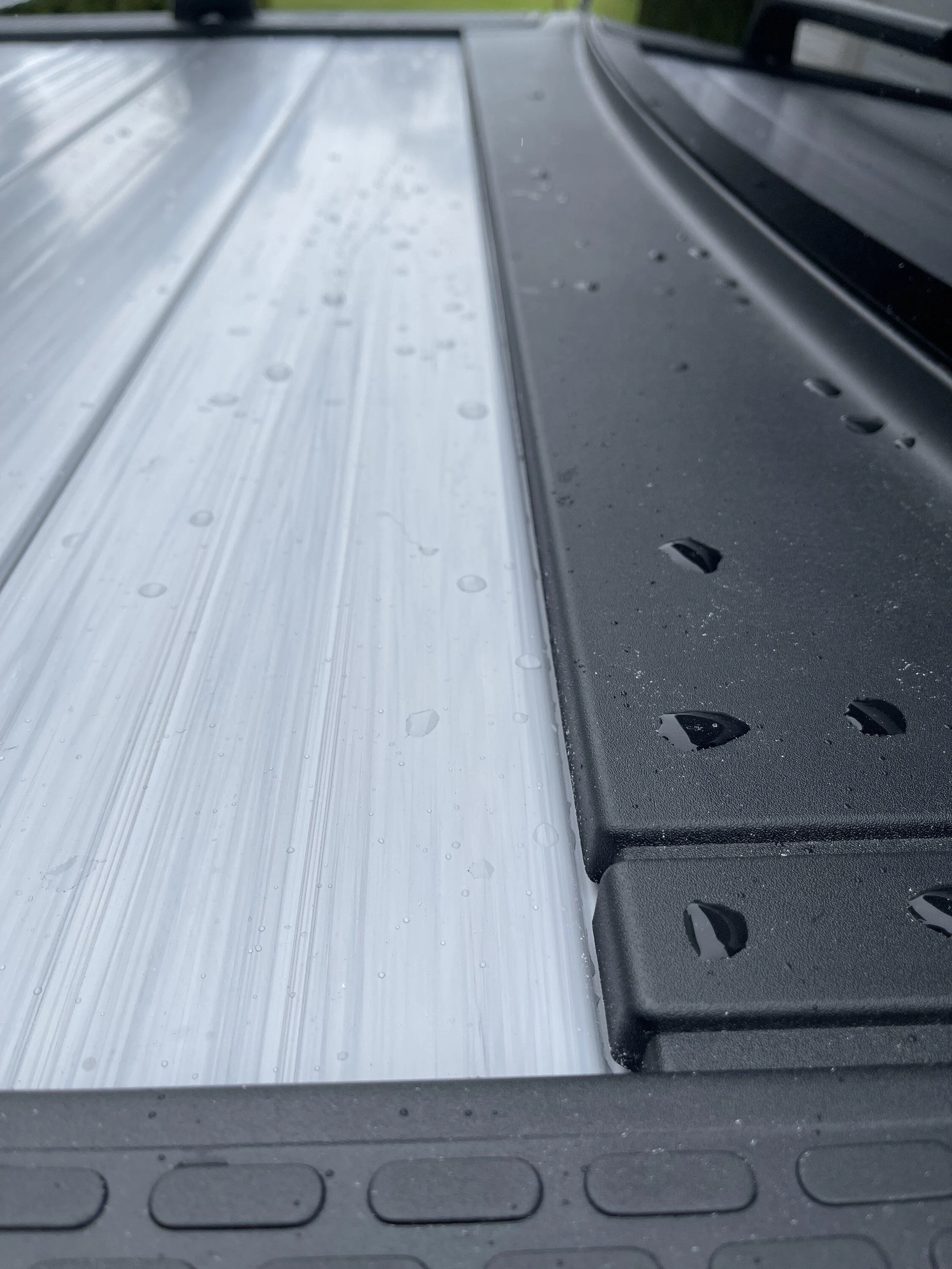

I'm not proud of it but hey it works. Tomorrow is the real test as it'll rain tomorrow in Portland, OR....
Rough country's hard trifold tonneau cover, maverick's size. I had to take off a few goodie layers.... I hope it works!
There's a bit of a gap at the tailgate. I think I'll just put some weather seal and it should be good....
Looks Great! I just finished brancky3's mod using vinyl fence panels. I've got a Rivian manual tonneau on order so that seemed like a cheapish and easy option to tide me over. I'll post some pics tomorrow.

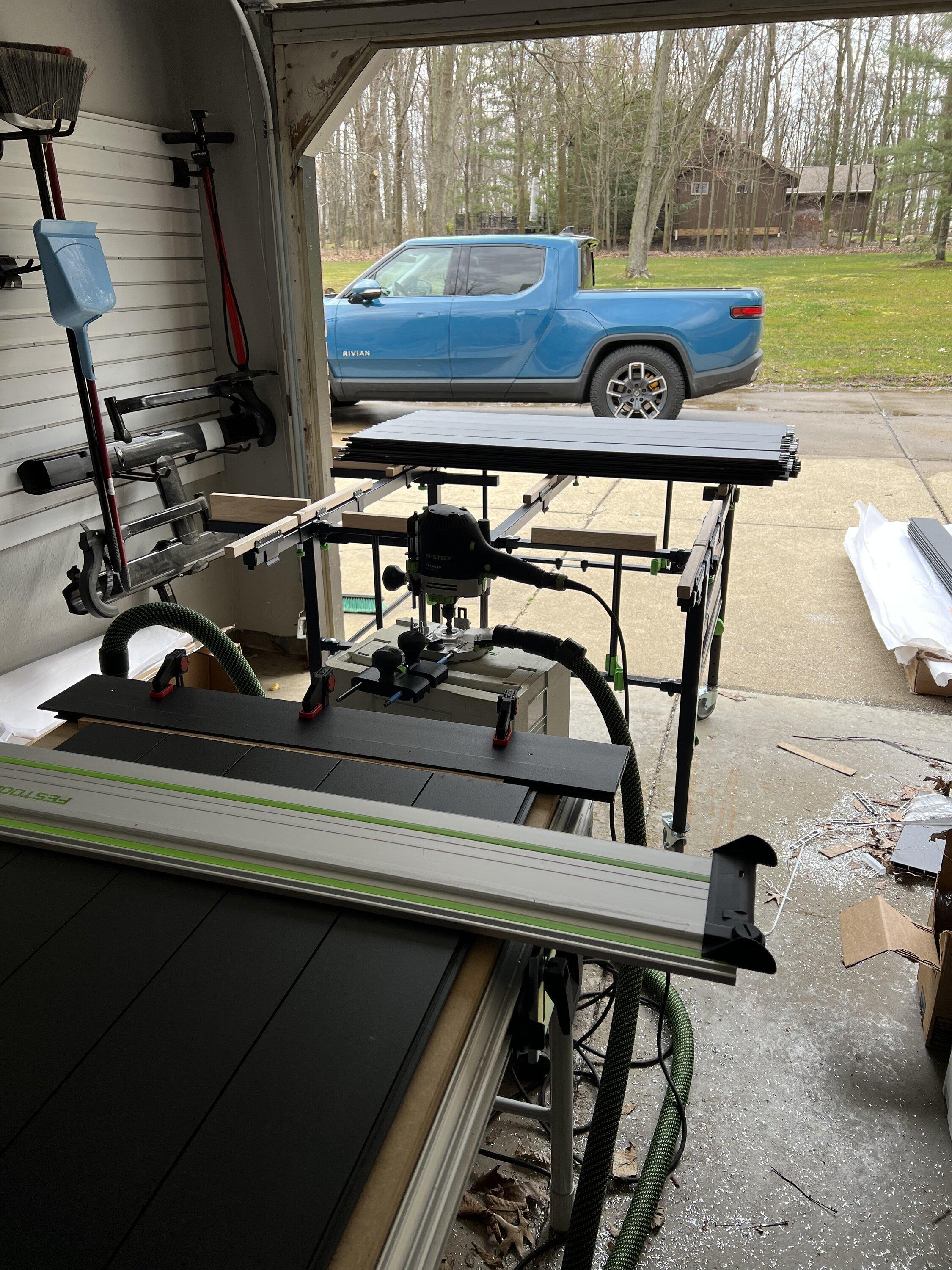

Yeah, but they don’t have my state of the art production facilities. 🤣
Festool for the win!
Still waiting on my R1T to arrive, but when it does this is the one I'm going to try to replicate. Thanks for sharing so many details. Great community here!

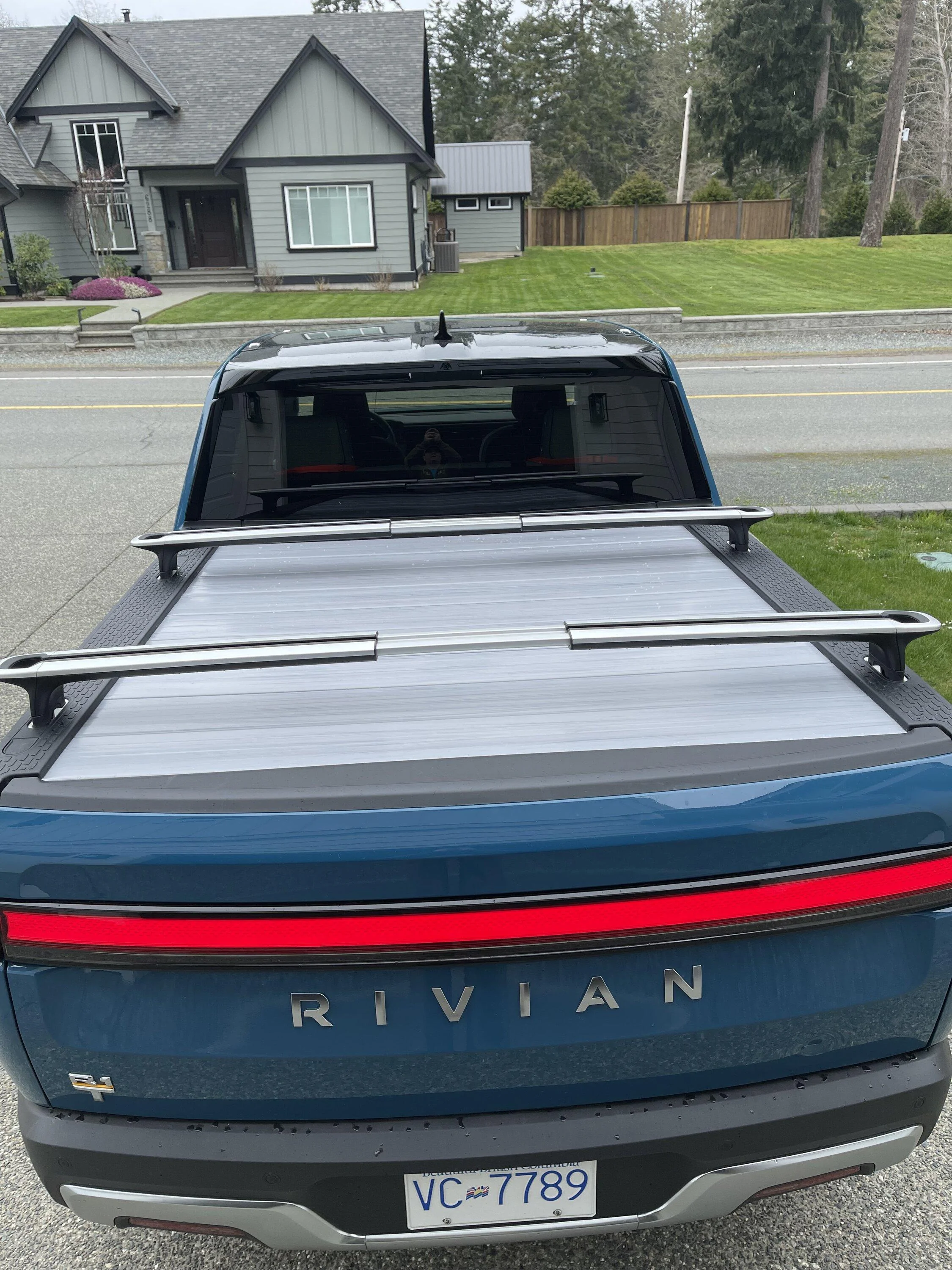

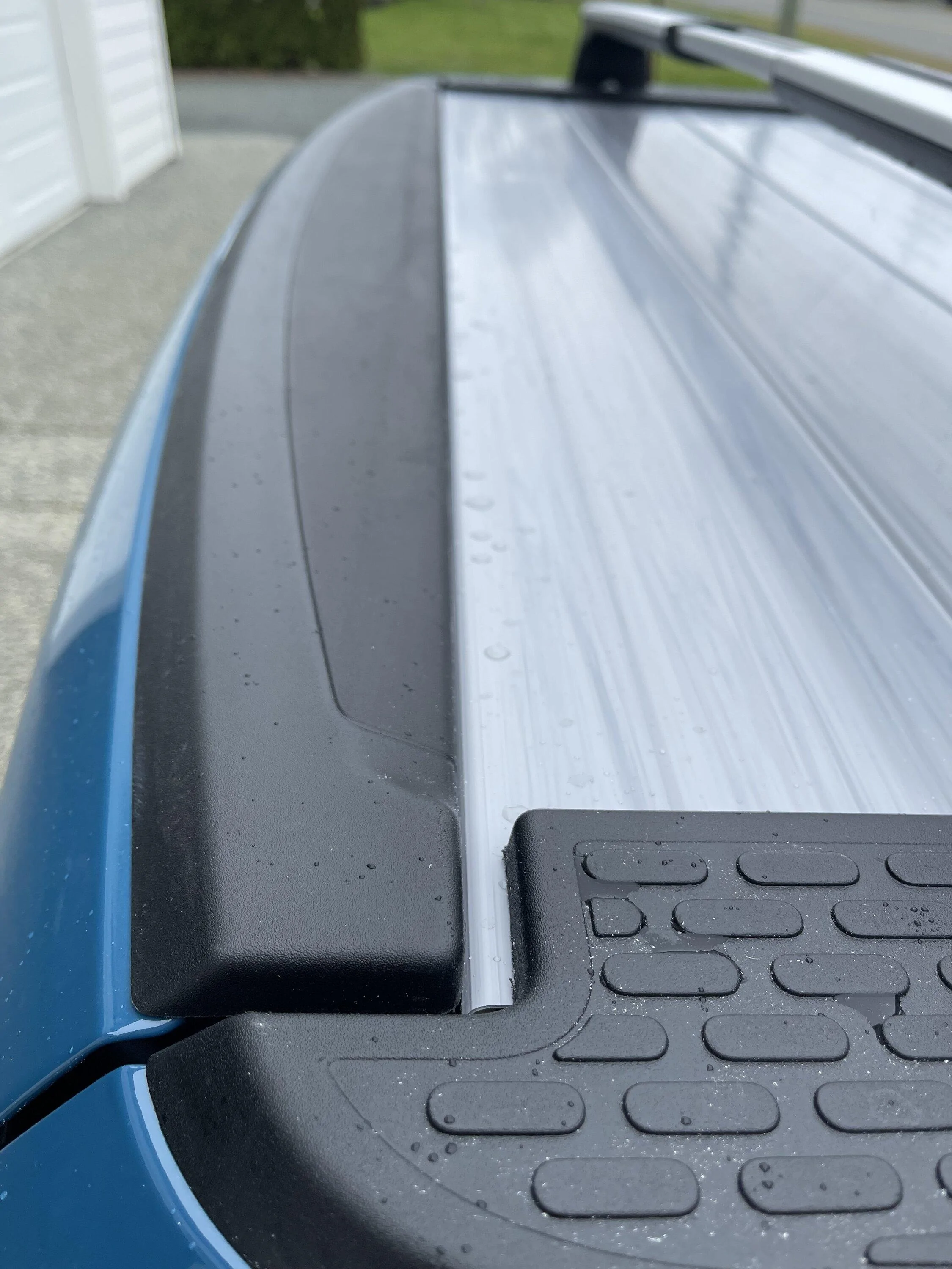

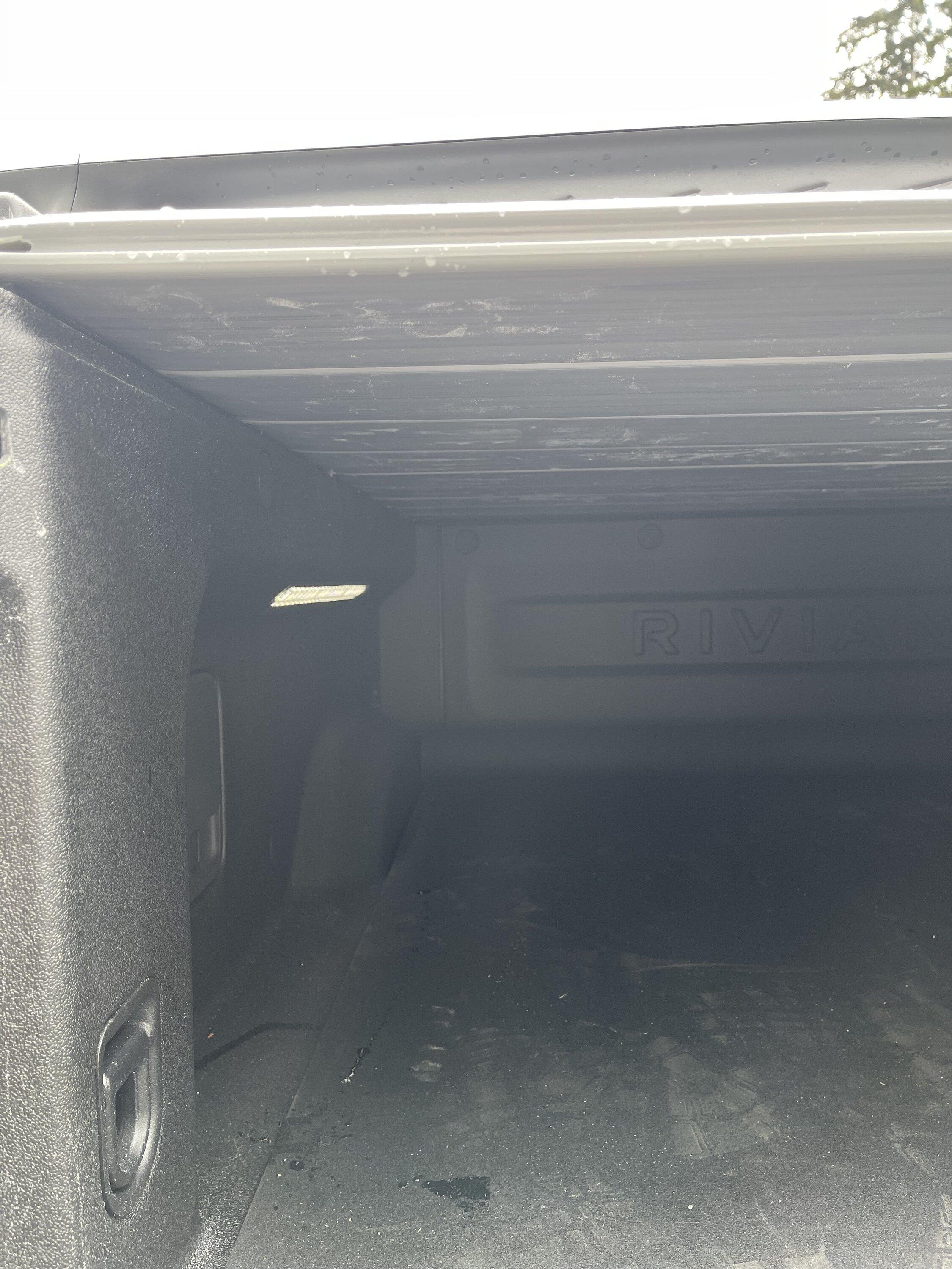

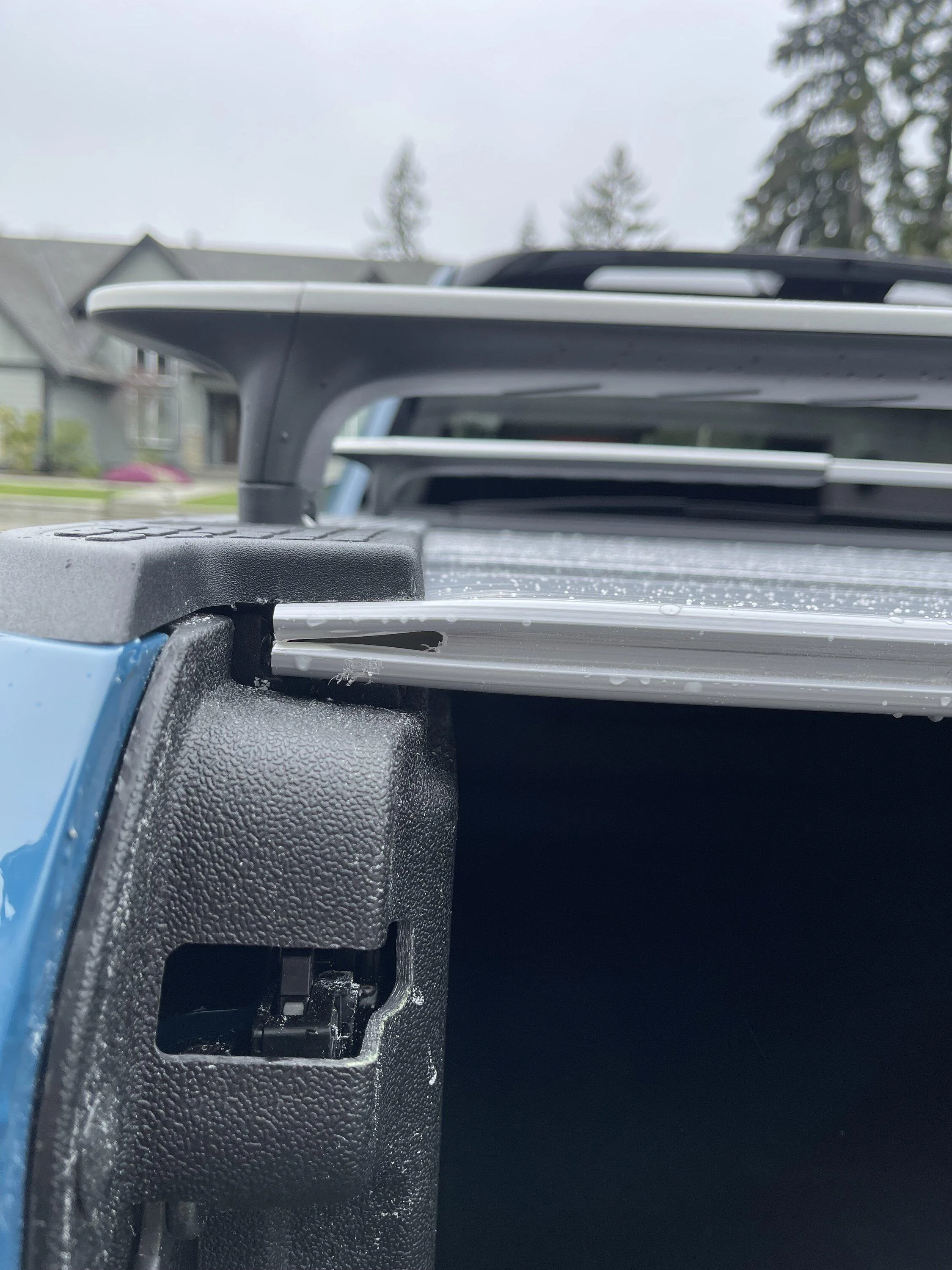

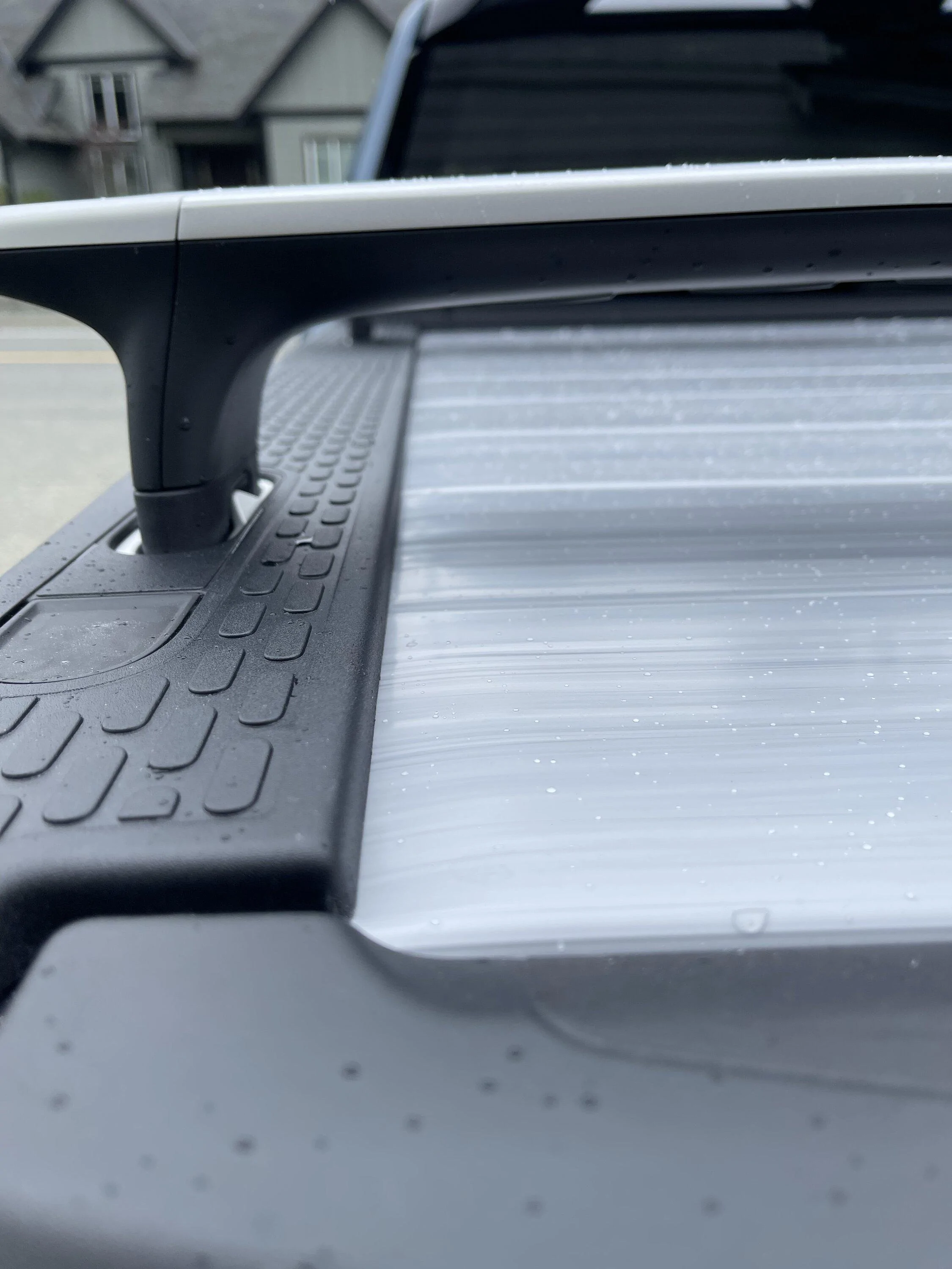

Got it finished last night. Here is what mine looks like, 9 of these panels fit perfectly and with cutting the supports about 3" or so, allowed for the ends to squish down enough to not have to take out the end caps...which sounds a bit tricky and risky of breaking tabs unless you are extremely careful.
Is it waterproof, no but it is much better than nothing at all and adds some protection. The slats are kind of stiff to slide so they should remain tight however it would be a bit of a hassle to get them out if need be but I'm not too worried about that. I don't mind this grey colour either, kind of matches my Ocean Coast Interior. I got these panels from Home Depot. It's a good alternative until my Rivian Manual Tonneau comes in...who knows, by then they may have a new auto cover that they can retrofit....for a price of course.
This was all thanks to brancky3 mod.
