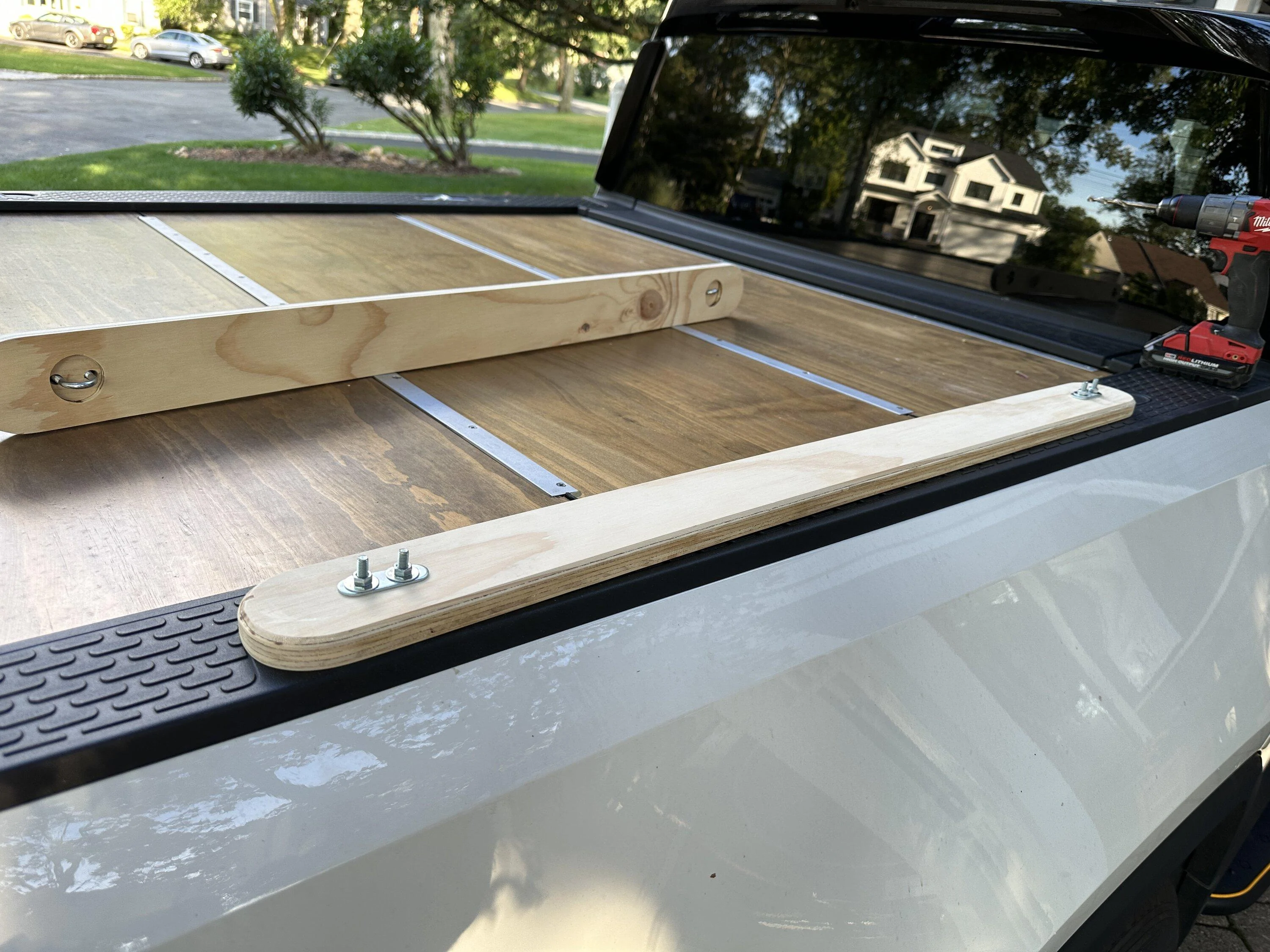

can you show how you have it attached to the bed with U bolts?

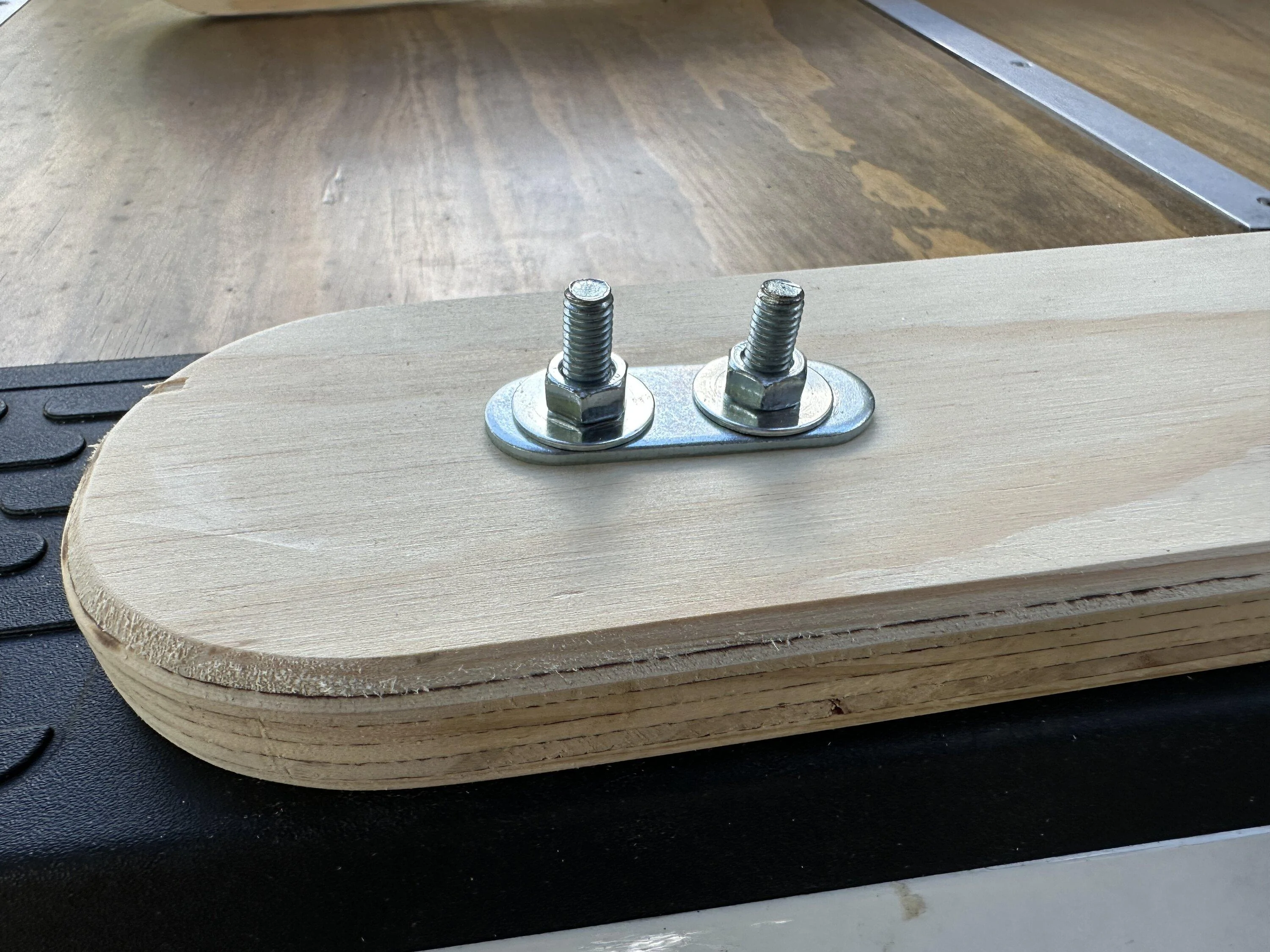

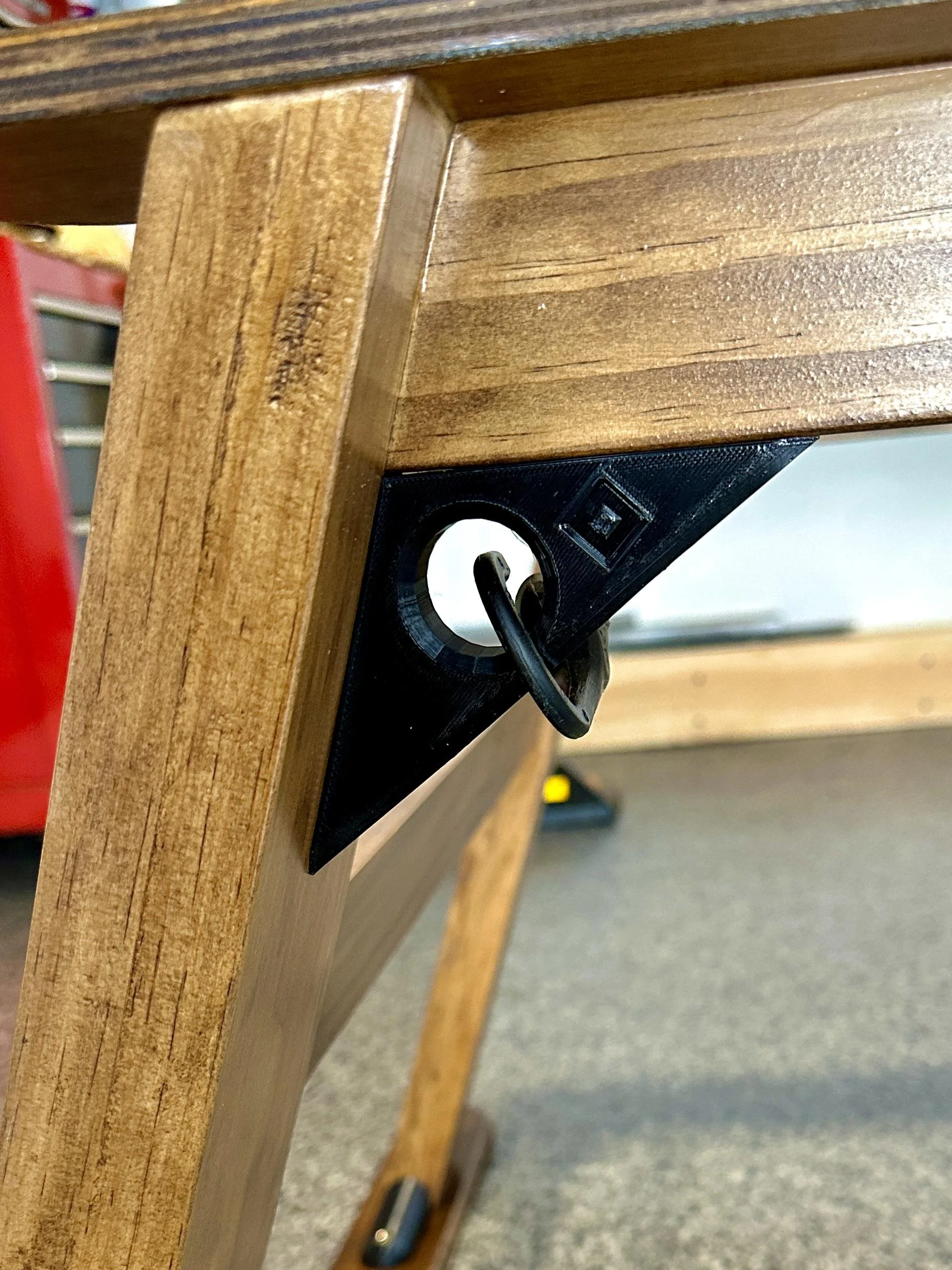

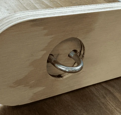

The 46mm ones? I was just unsure because that link brought up 11 different sizes you could click on.
Yup, the M6 x 16mm x 46mm, fits perfectly.
Rivian R1T R1S DIY Ladder Rack using wood 1692642430349
Make sure to router out a 1/4' dept 1"x1" circle or square for the Rivian mount to fit into.
Rivian R1T R1S DIY Ladder Rack using wood 1692642565628

Any risk of damage to the mount points or are they pretty robust?

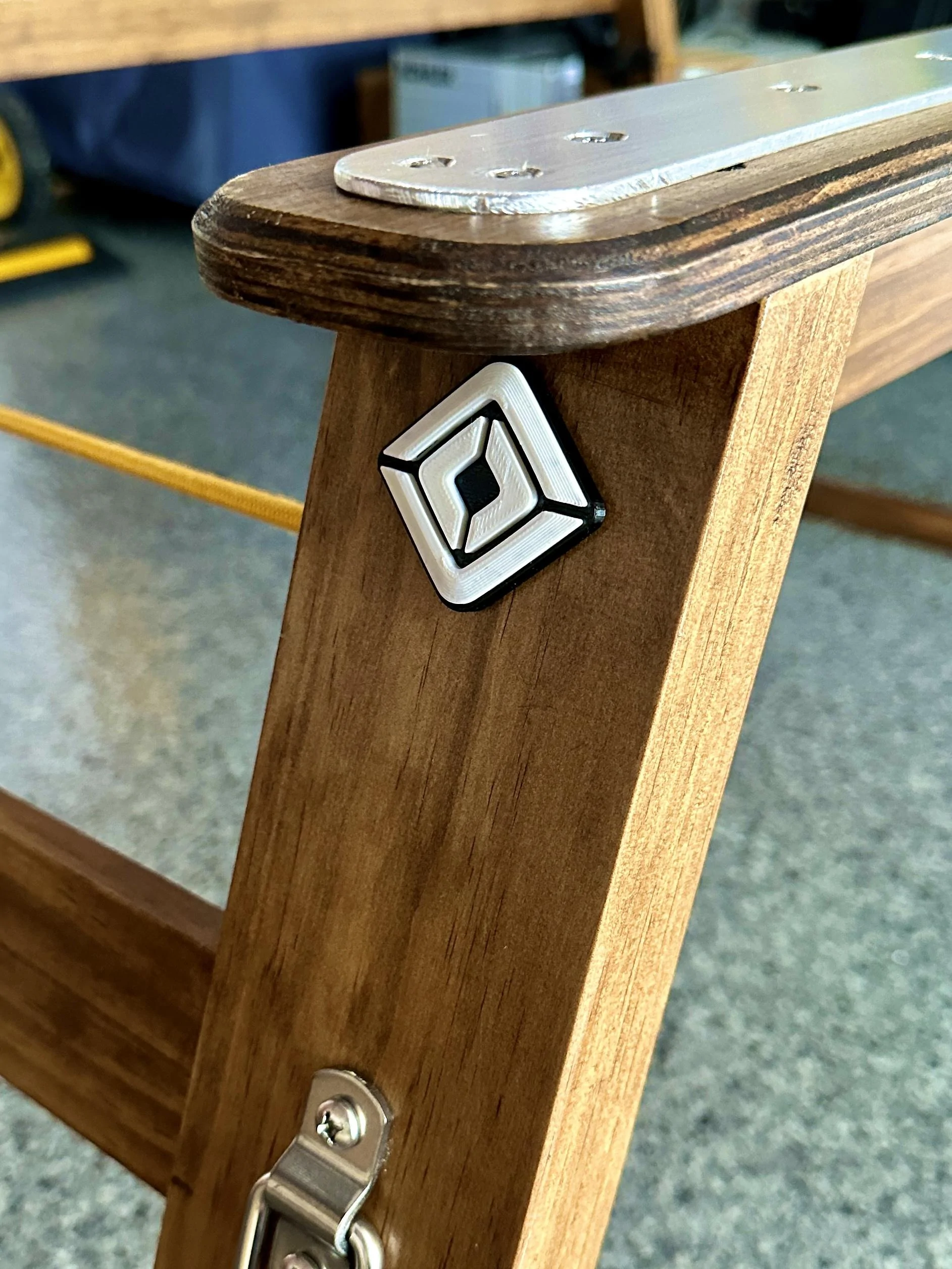

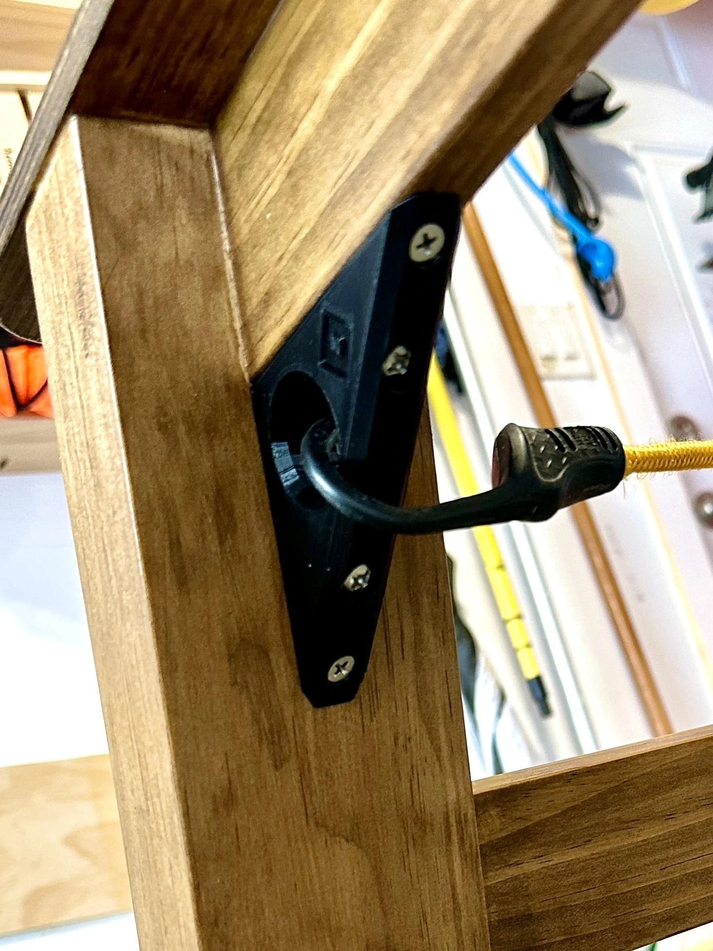

Added aluminum top rail and tie-down rings.
This is clever, beautiful and FUNCTIONAL! If you ever decide to make a batch of these, please let us (ahem, ME) know!
