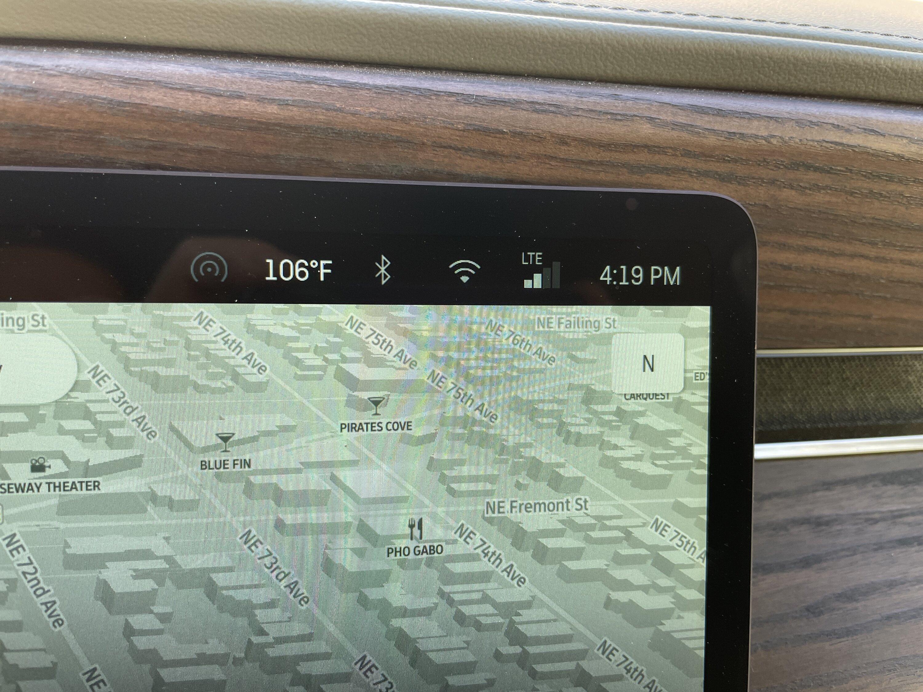

Can anyone tell me what the temperature on the display is actually measuring? It says 106 deg. Fahrenheit. App now say “cabin is 104”. So, I presume is a cabin reading rather than a flawed outside temperature. Though, it would be nice to have a reading of the outside temperature display with the cabin temperature….

It's outdoor temp. Not very accurate if the vehicle has been stationary for a while

The sensor for the OAT is located on the underside of the driver's side rearview mirror. I only know because my wrap guy left it unplugged (accidentally) and the reading was -40 when it was over 100 outside.
I think I have same issue. How was it reconnected?
The interior door panel was removed and the plug reinserted into the appropriate receptacle.
