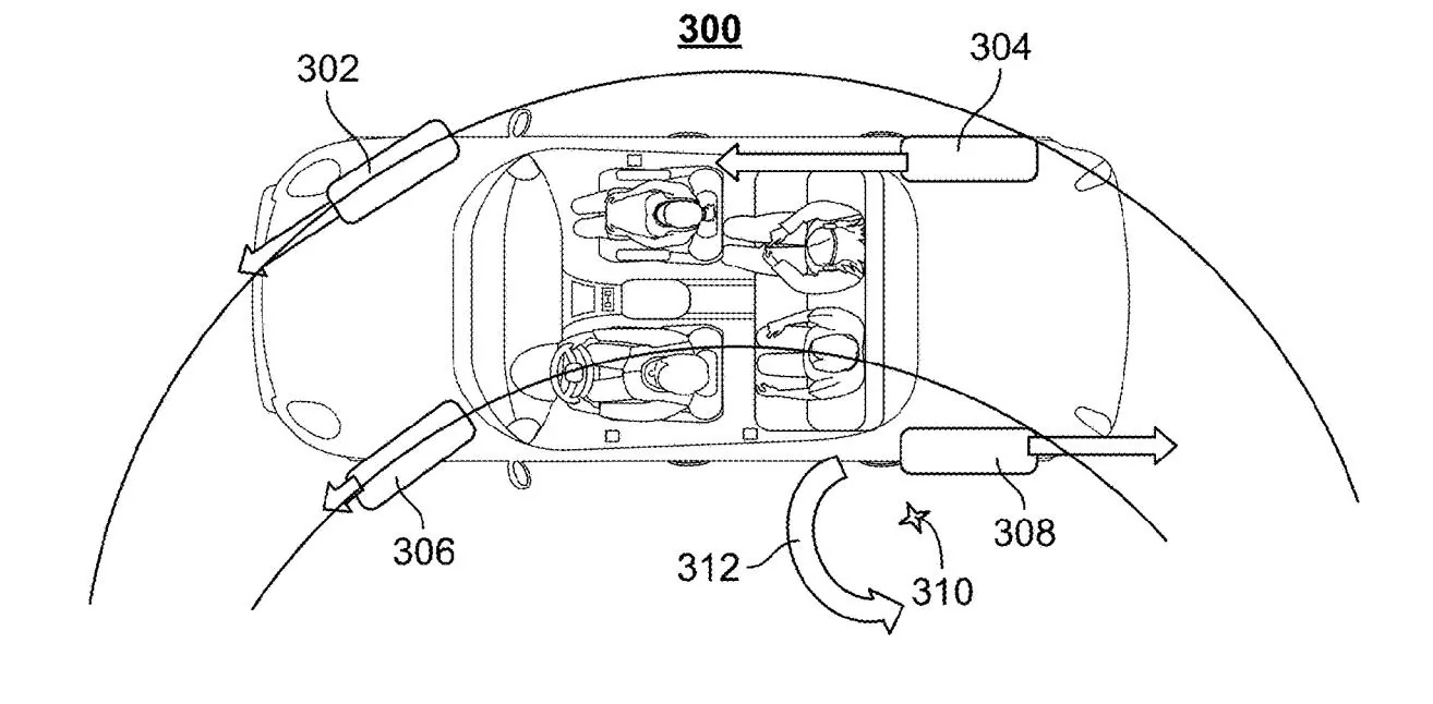

Dig mode looks to be a way to make turn radius smaller....mentions tank turn in the patent verbiage.
Abstract: "Systems and methods are provided herein for operating a vehicle in a front dig mode. The front dig mode is engaged in response to determining that speed of the vehicle is below a speed threshold and determining that the amount that at least one of the front wheels of the vehicle is turned exceeds a turn threshold. While operating in the front dig mode, forward torque is provided to the front wheels of the vehicle. Further, resistance is applied to forward rotation of the inner back wheel of the vehicle. Yet further, forward torque is provided to the outer back wheel of the vehicle. "​

So I don't get what they are trying to do. Are they putting opposite spin on the back and front wheels for a zero turn sort of thing?
Pretty much. Similar to how toyota and the new bronco use ABS pump to lock inner rear wheel for tighter turns off road, but applying torque in the direction opposite travel with individual motor instead.

Sounds nice, but this will go the way of Tank-Turn...
I don’t think so. This is more like the turn assist that the Bronco has, but the inside wheel turns backwards instead of braking.
I’d like to have tank turn, but this could still be very useful on mountain switchbacks.

I wonder if this could work on pavement where tank turn does not?
This is much more likely to get released because they are not trying to pivot in-place, where any small external input, such as sideswiping a rock, could cause the truck to literally spin out of control. By having the turn radius be some amount greater than zero there is opportunity for the vehicle to sense that the direction of travel is drifting and to correct. Being able to slide one end of the vehicle around faster than the other while at slow speed would be really handy on tight switchbacks.

I’d be up for anything that reduces the CVN-65 -like turning radius on pavement. That is, and doesn’t destroy tires and the suspension in the process.
