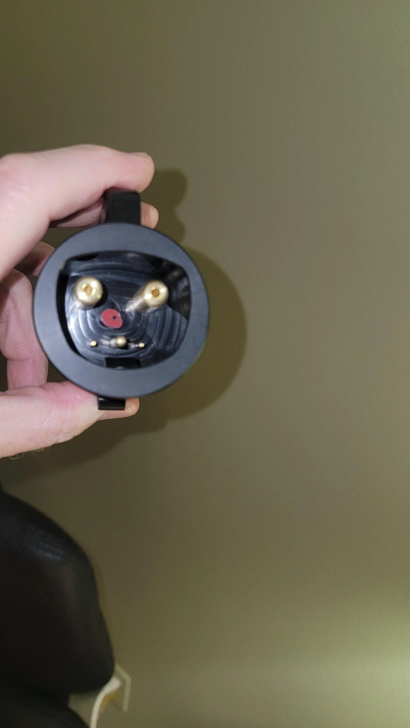

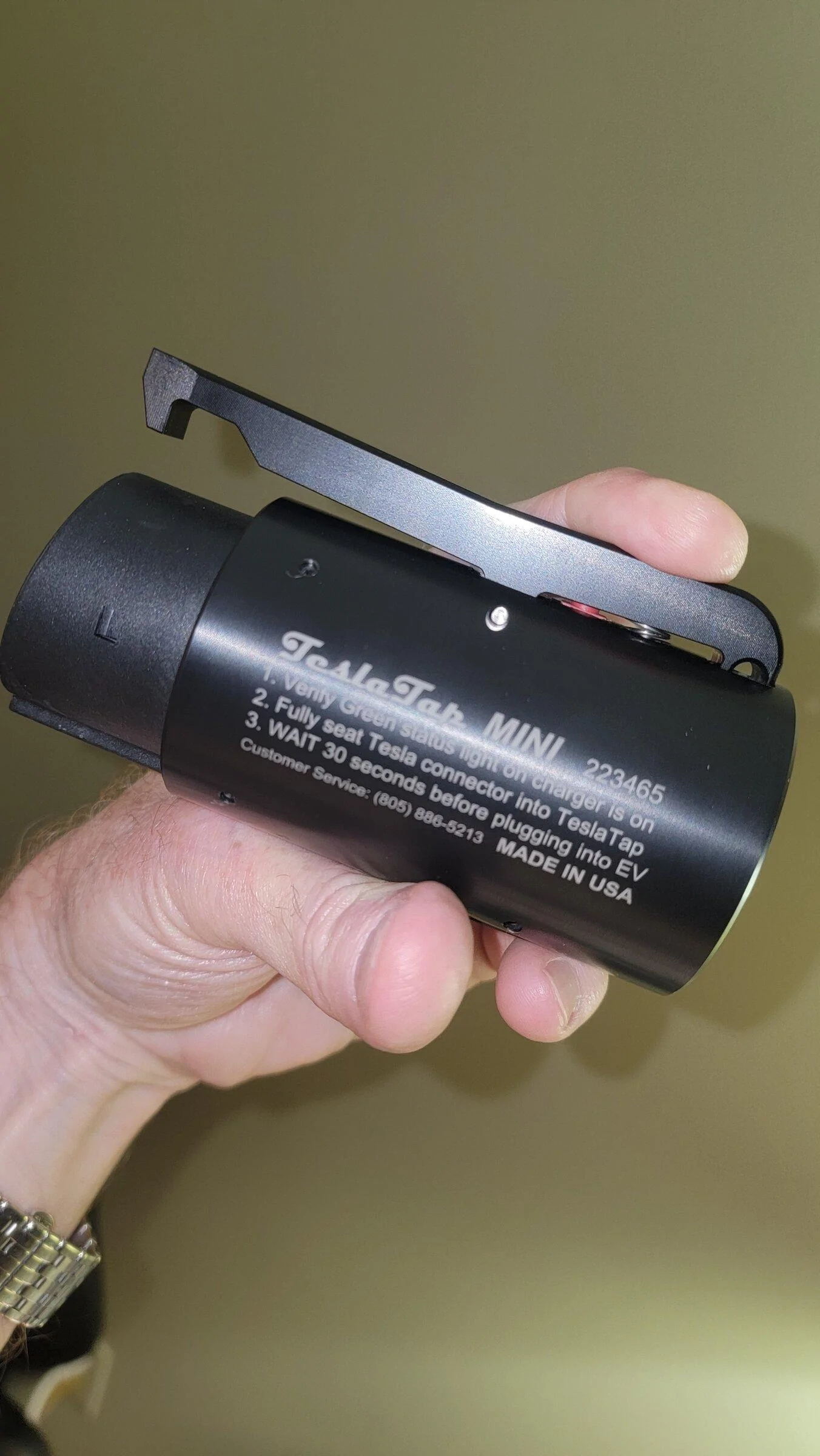

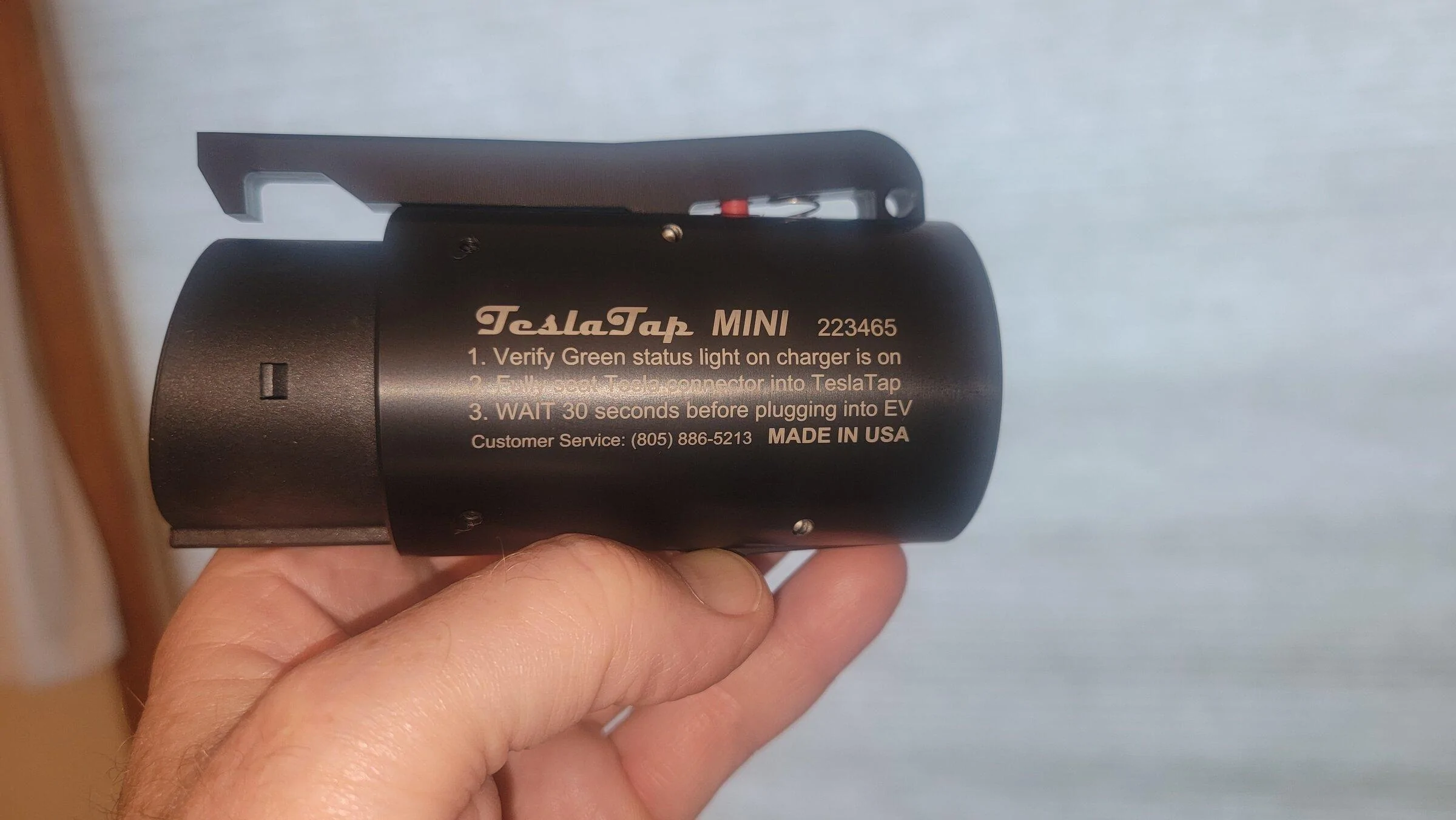

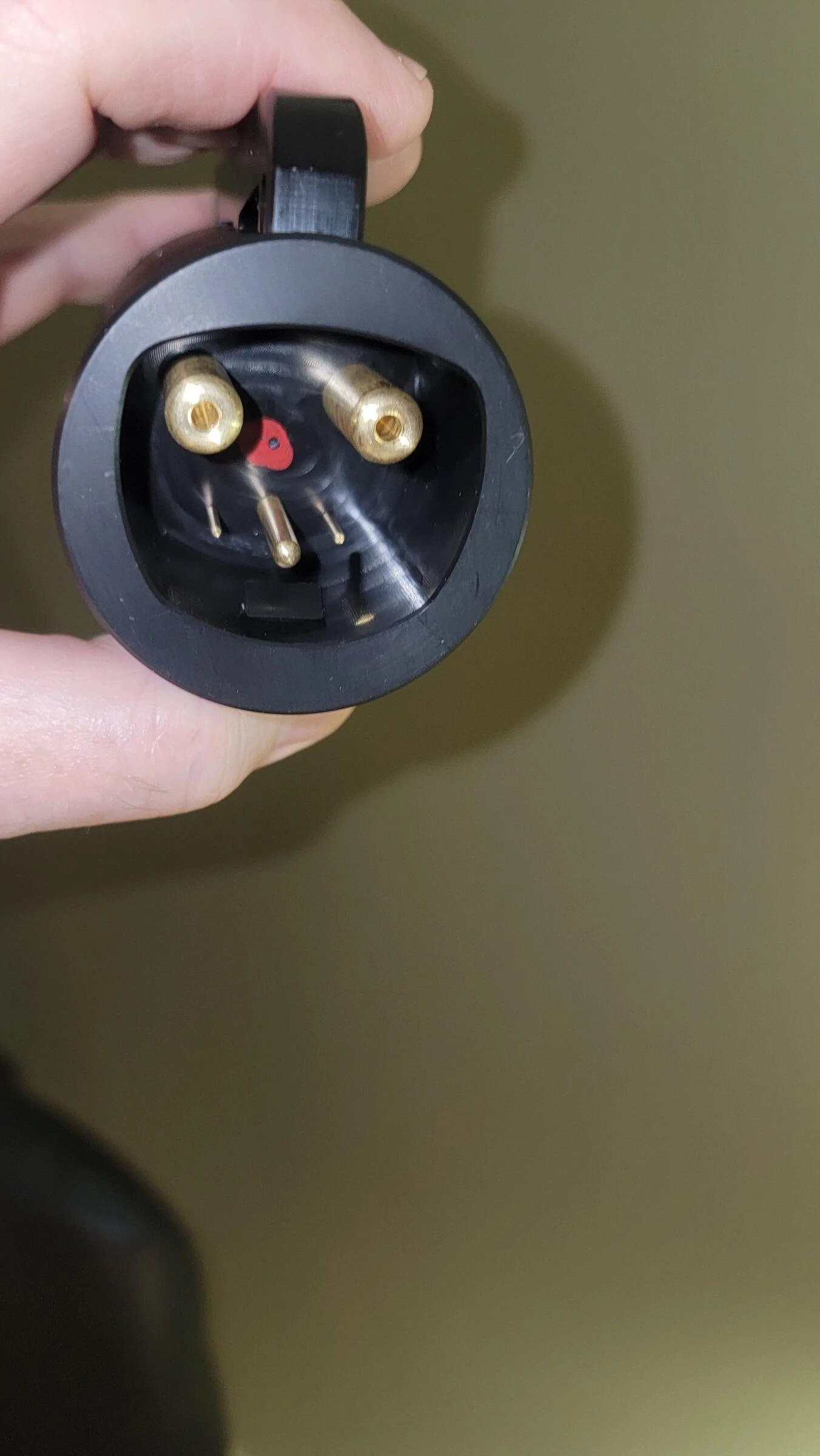

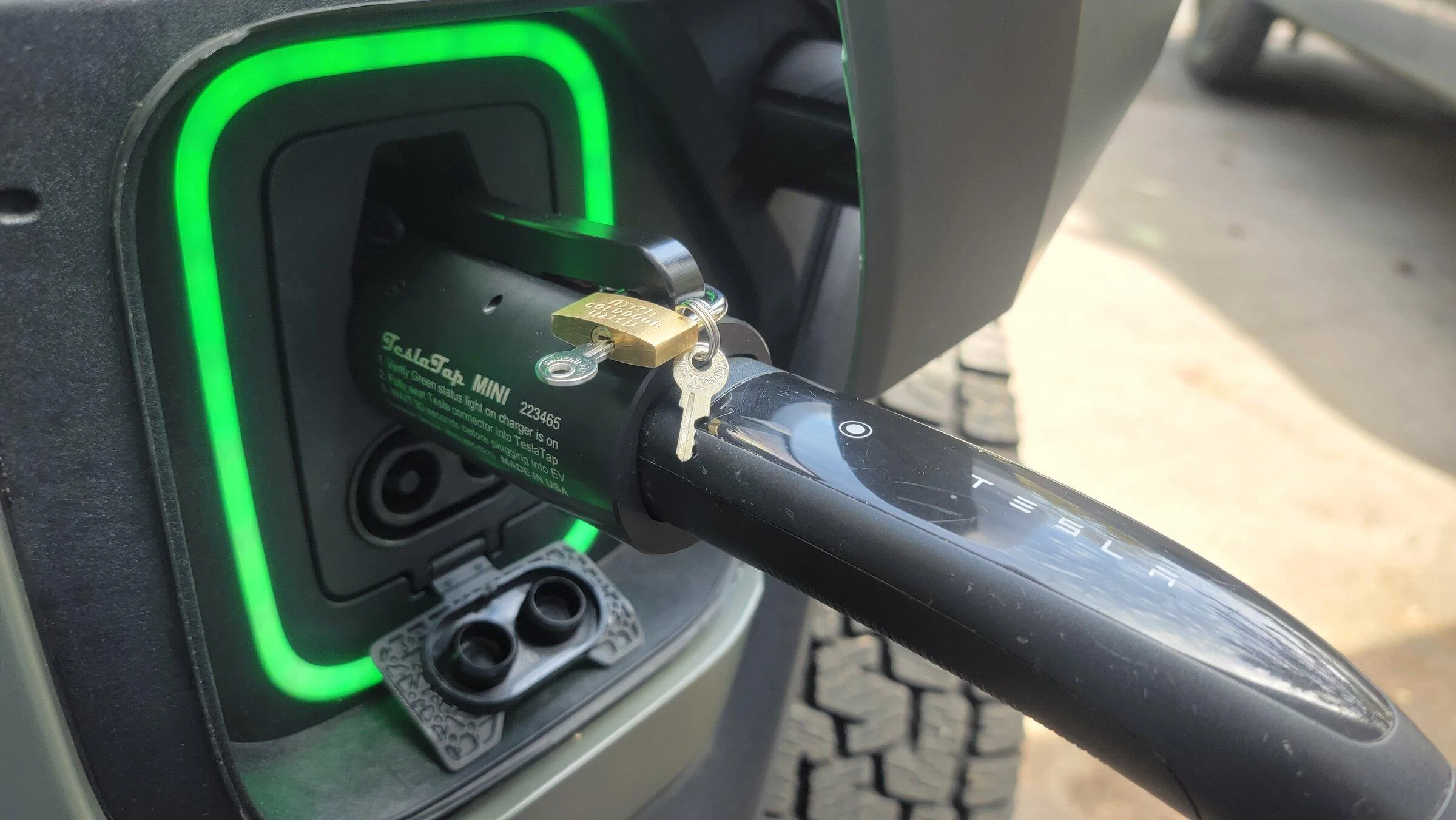

Wow, it's crazy tiny. Is there any way to lock it?

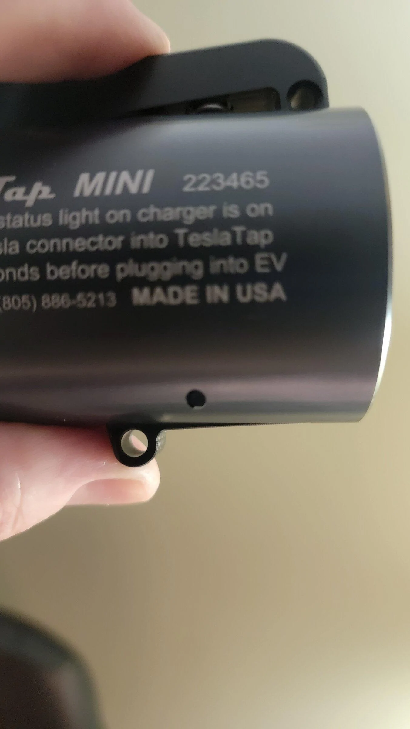

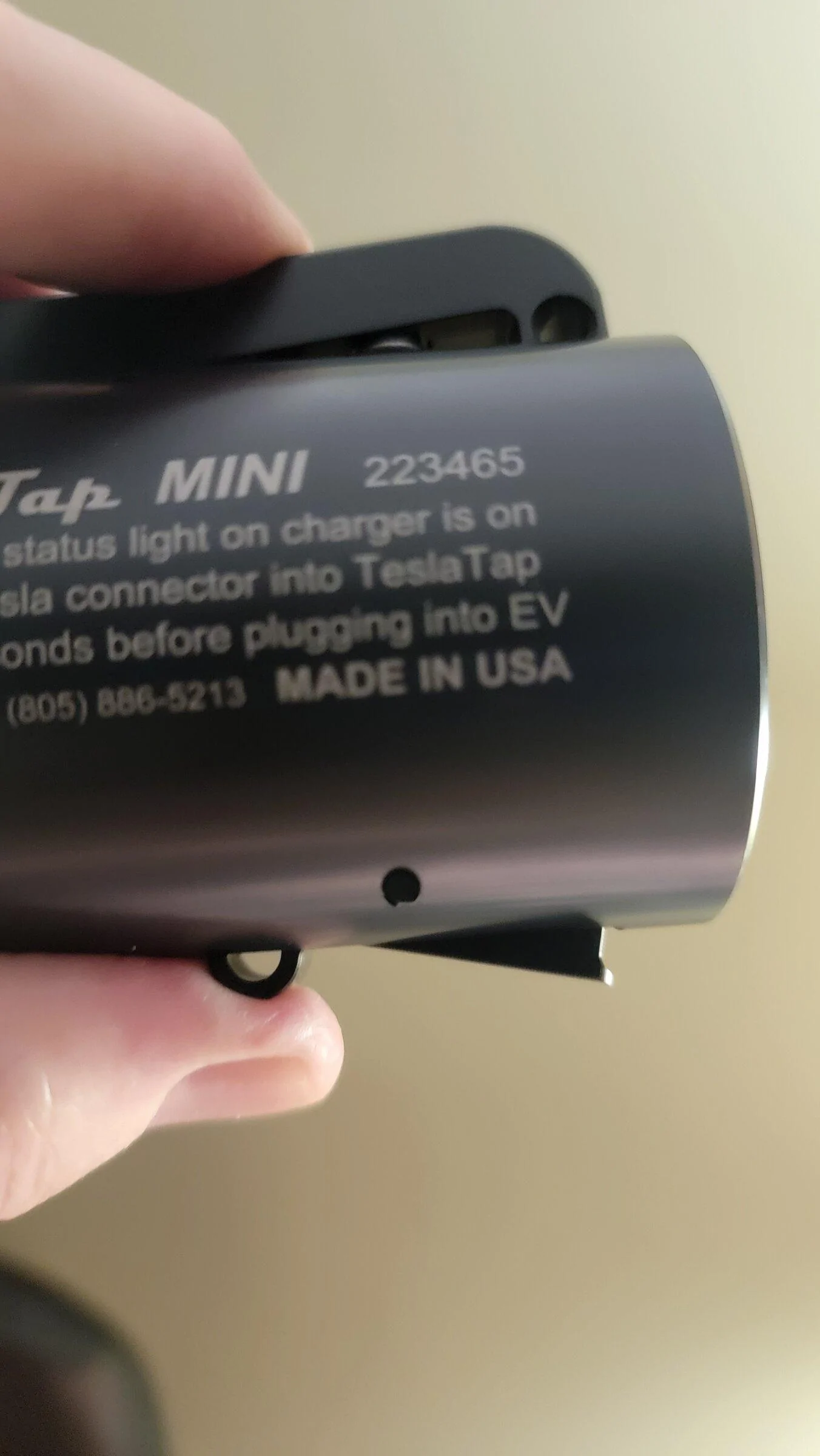

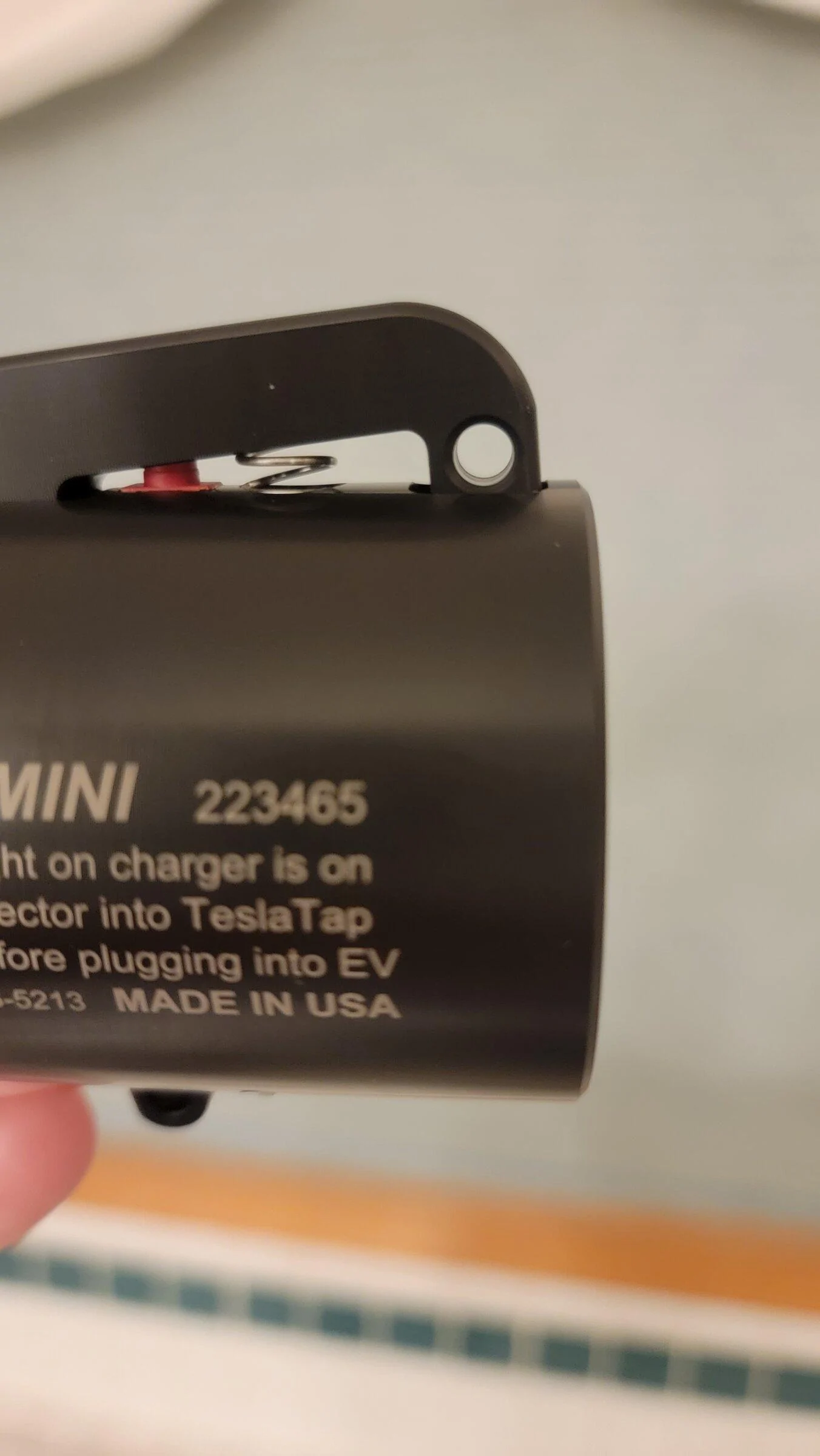

Yes. There are two locking points to keep the adaptor attached both to the vehicle and to the Tesla charging cable, using two small padlocks (not included).
I hope the attached pics show the points where the locks are to be inserted and how they prevent the adaptor from releasing its grip on both ends.
I have two small padlocks and hope to test the entire contraption tomorrow at a nearby Tesla Destination Charger. I'll post my findings here.
FWIW, this thing is hefty and feels very solidly built. The connectors all seem to be made from very high quality materials and appear to be well-machined. The proof will be in the fit and performance.

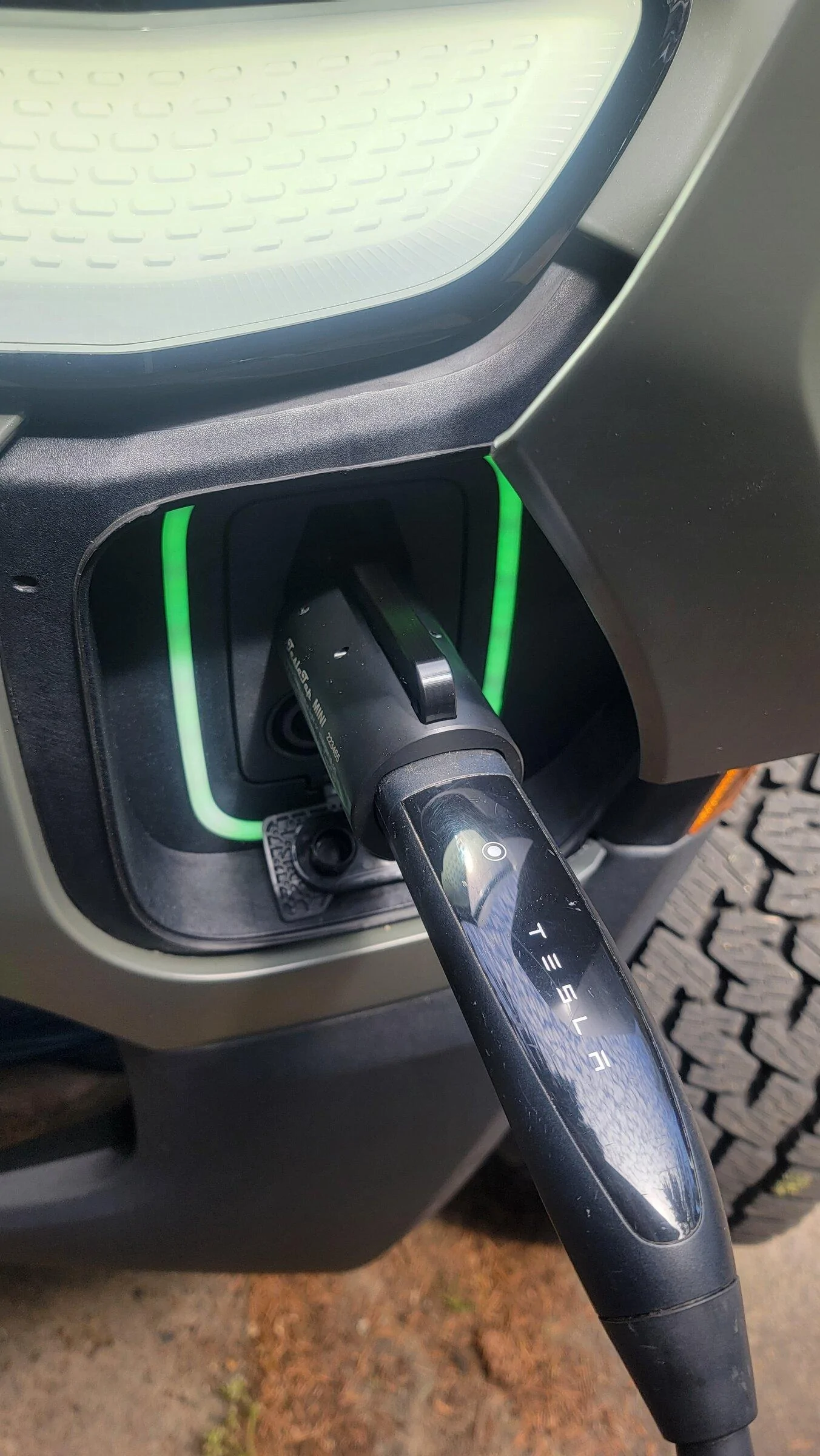

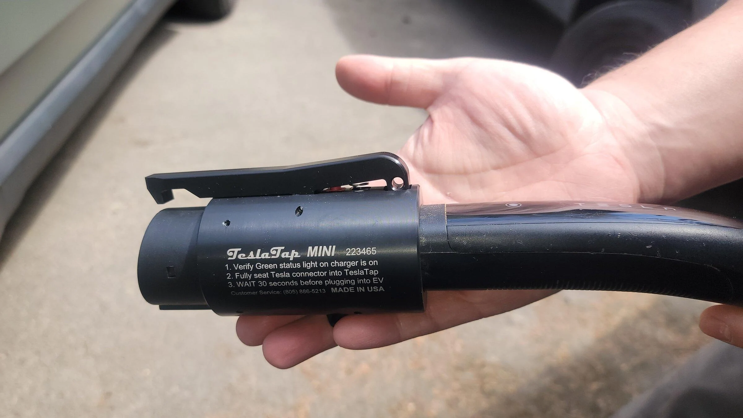

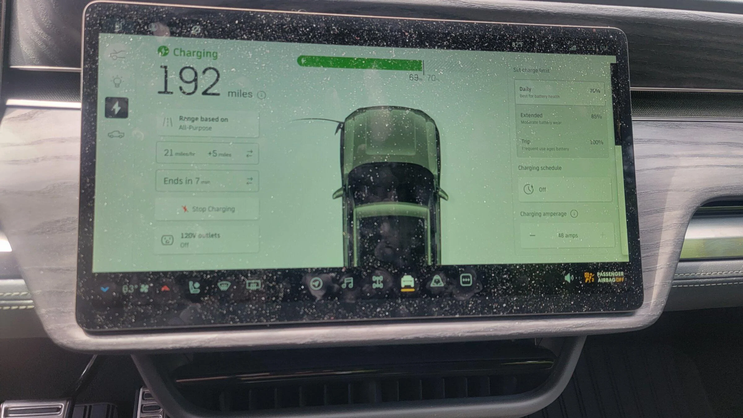

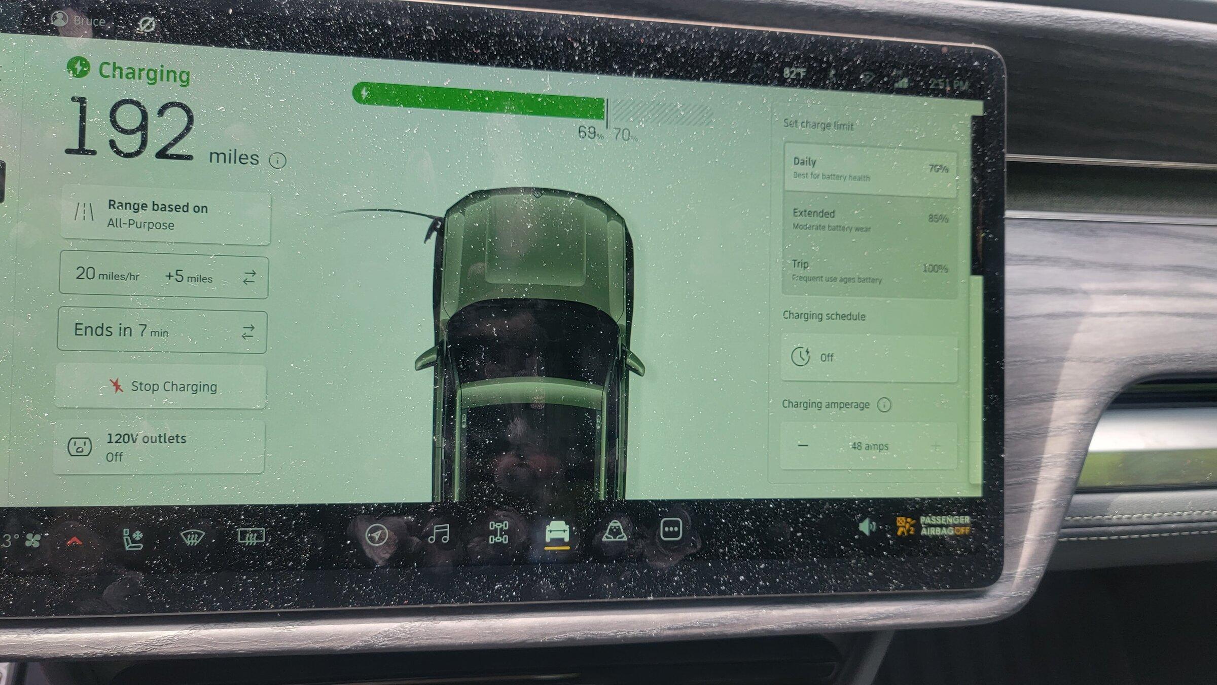

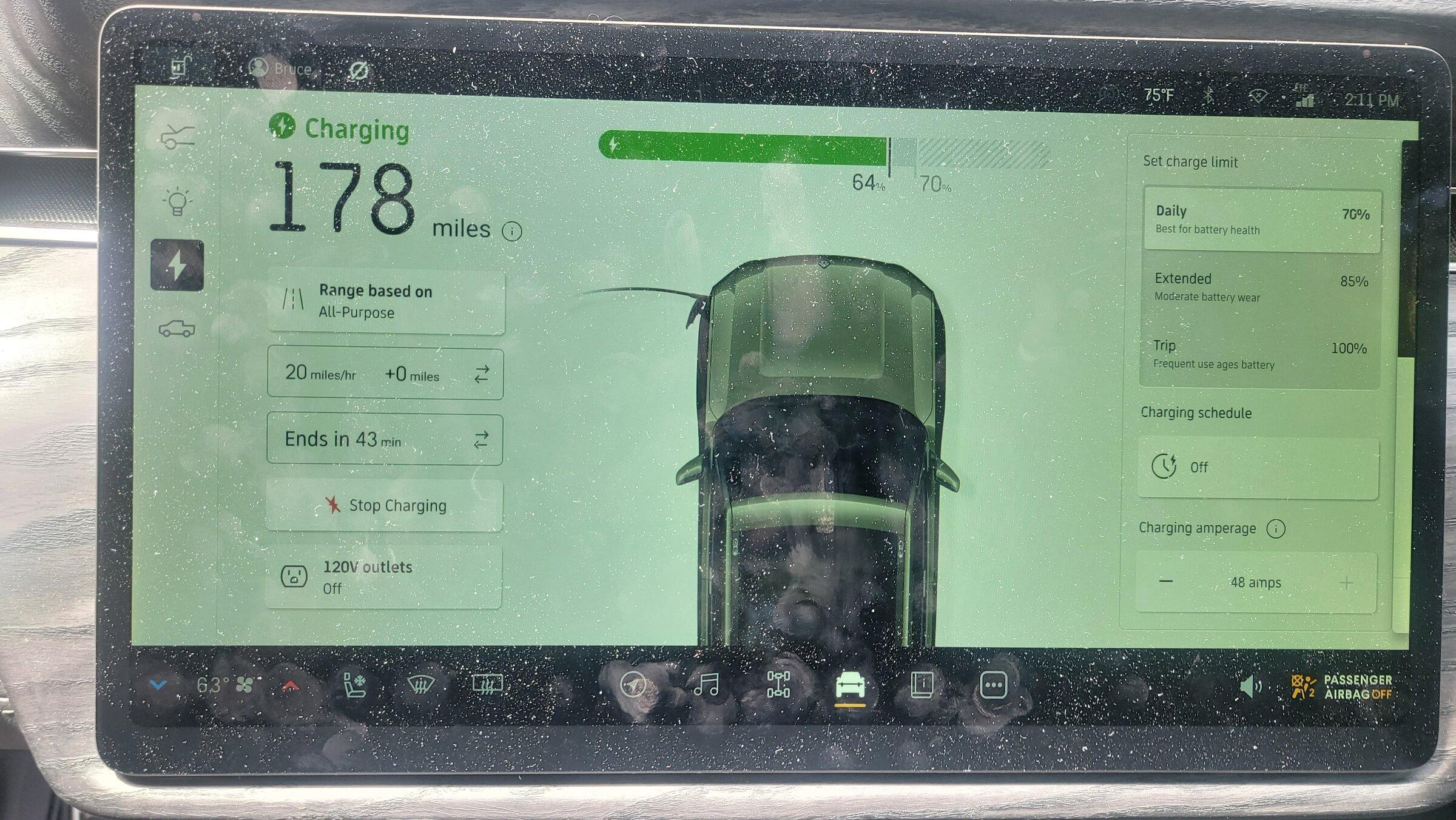

So yesterday, @xyskis and I got together to try the TeslaTap Mini-80 Adaptor on his Tesla charger, which is a 60-amp unit providing 48-amps. We attached it to the end of the charging cord, waited about 30 seconds, and plugged it into the R1T. It started charging immediately at the full 48-amp capability of the Rivian.
The Mini's fit to both the cable and the vehicle were solid. No slop or movement, and not too tight, as others have noted here, or elsewhere. (Hand modeling courtesy of @xyskis)
Rivian R1T R1S Consensus on Tesla adapter? 20220504_140948
Rivian R1T R1S Consensus on Tesla adapter? 20220504_141019
The charging went very smoothly.
Rivian R1T R1S Consensus on Tesla adapter? 20220504_141115
Rivian R1T R1S Consensus on Tesla adapter? 20220504_145133
Rivian R1T R1S Consensus on Tesla adapter? 20220504_145125
(Yeah, yeah, I know!....next time I'll clean the screens first. The sun was right overhead and lit up all of the dust and smudges)
In 40 minutes, 5% of range was added (from 64 to 69%), bumping the range from 179 to 192 miles while the R1T was in All-Purpose mode.
I'm not sure if results may have been marginally better if this experiment took place at the lower end of battery's range, say at 20 or 30%, but I was pleased it was adding about 20 miles of range per hour. That's adding range at about the same pace of a sprinter running a 10-second 100-yard dash. Conversely, using my 110-volt charger at home adds speed at about the pace of me sauntering back from the mailbox, shuffling through the junk mail on my way to the recycling can. My readout at 12 amps says 1.9 mph is being added.
Not that it validates the bump up to the 80-amp unit, but at the conclusion of the 40 minute session, the adaptor was almost cool to the touch.
The locking mechanisms to keep the adapter secured to the end of the cord and the vehicle both work just fine. We tested both, but captured only a pic of the top unit, which keeps the Mini connected to the Rivian.
Knowing this thing works well helps to open up some paths and chip away at my Range Anxiety. Since getting a PHEV six years ago, I started noticing the Tesla Destination L2 units at various hotels, restaurants, and shops. Knowing that many will now be available for either of my vehicles is great news.
I hope this info is helpful. Feel free to message me, or connect here with any questions.
Special thanks to @xyskis for the chance to test the TeslaTap Mini on his charger, and also for keeping me properly hydrated. Also, we were able to navigate some of Portland's finest goat trails in Rock Crawl mode. Luckily, all the kids stayed on the sidewalks... ?
