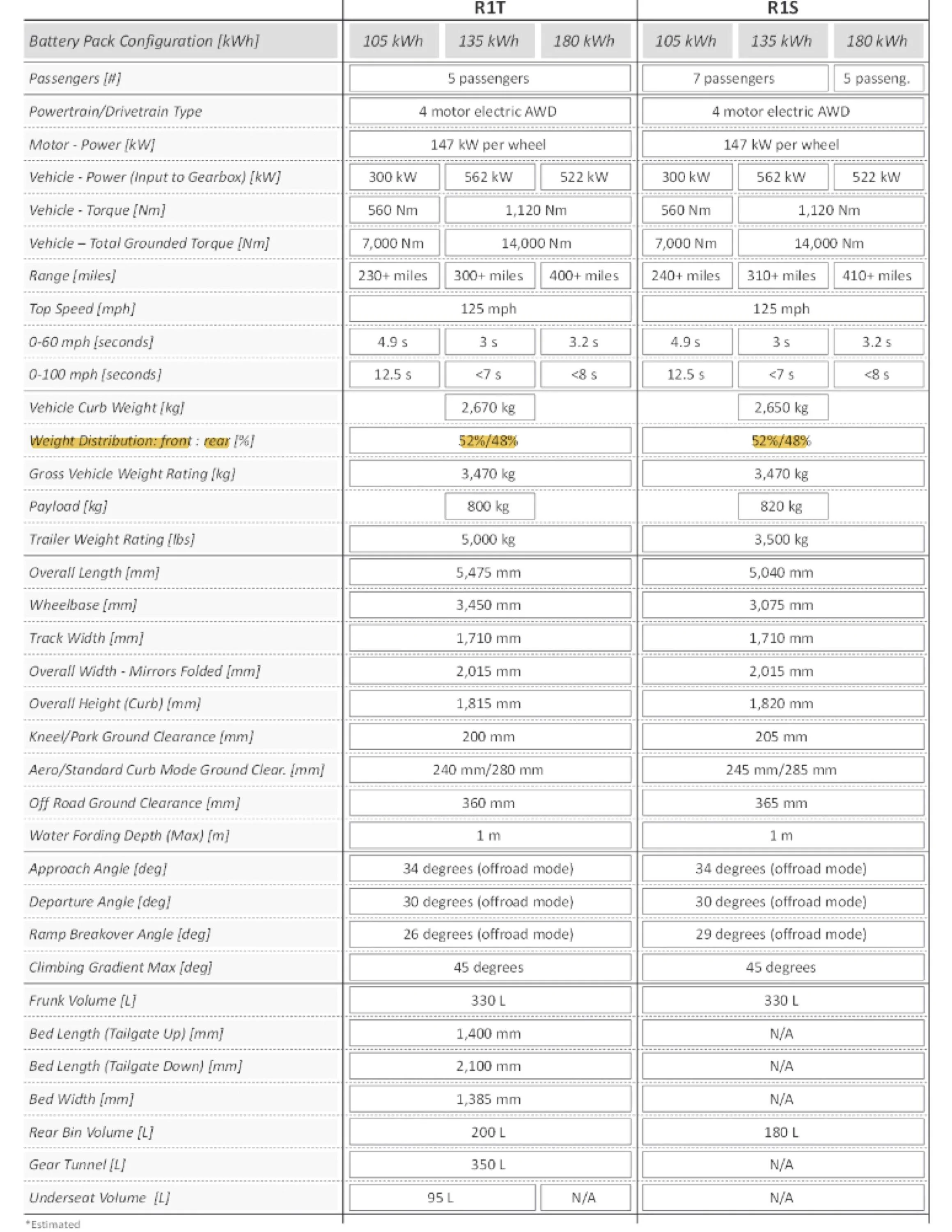

The attached info is from the original specs so things have changed a bit but not dramatically.
You just need to find the F/R distribution point and use the overall length to determine where the cg is along the vehicle. Cannot help you on the Z direction (cg height). That info requires more data regarding the weight distribution from the ground up to the roof top.
That's a great spec sheet. Looks like the 135K/wh battery has the best power-to-weight ratio...
Supposedly, that algorithm I saw (measure weight, tilt the vehicle, measure again, math math math...) would also calculate the height of CoG.
This is a good start, though. Thanks.
