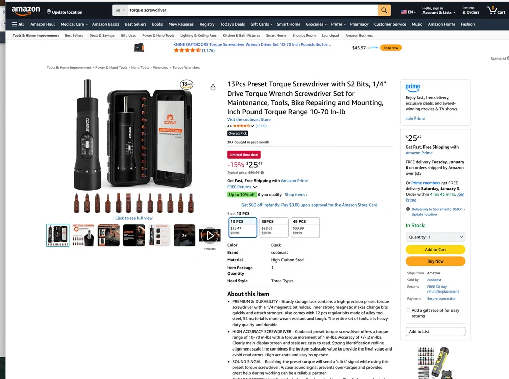

An add on to that; the lugs reguire a specific torque. Get a good tourqe driver and lookup the required torque value when tightening.

Some fasteners need a torque value higher than what that driver tops out at. The EVSE rated Leviton 14-50 recently posted in another thread needs 75 in/lbs.

Based on personal observation, a proper torque wrench is necessary. I used to work on engines and could get very close by feel, when checked with a torque wrench. For fun, I habd torqued my breakers and outlet on install and then with a wrench. I was way under. Bottom line, it’s worth the price to buy a proper range torque wrench and be safe.
I would also make sure a hired electrician does the same.
