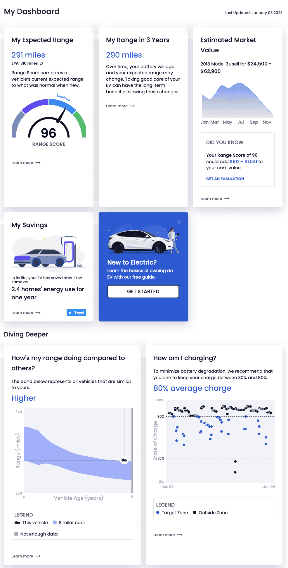

Just FYI...
Below is my Recurrent report for Jan 2023. You can see that I've lost roughly 6% in 4.5 yrs but not expected to lose much more over the next 3 yrs. Also I have my charge setting to 90% SOC. The plot on the lower right shows how often its above the 80% range.
My sense is that Tesla does a great job managing battery life. Don't know if Tesla results are applicable to every EV battery. In other words, we need to see track record of each EV maker to have a sense of general trend (or specific trend i.e., Rivian).
I know some people plug in everyday regardless of SOC and/or keep it plugged in as "shore power" - I do not. It usually gets plugged in as needed for my next use.

Just FYI...
Do you know how do they do the calculation? As far I know Tesla rolled out some software updates that increased the range even on the same existing battery, so range comparison might not be accurate one. For testing a regular lithium battery the technique is to use a shunt to get current+voltage reading and run down from 100% to 0% to measure the capacity. I wish the vehicle itself shows something like this like iPhone shows for battery health.
