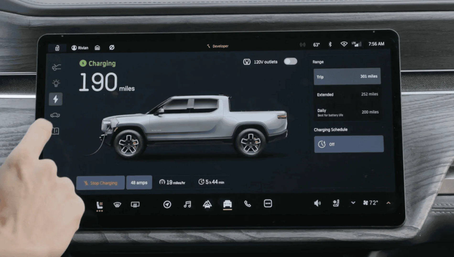

Great details on the Charge to Level from the MotorTrend article on the R1T interior.
Rivian R1T R1S Charge to level Screen Shot 2021-08-31 at 11.43.41 AM
On the right is a selectable range that you can charge to. Trip is 301 miles (I think this is the max range/EPA rated range), Extended is 252 miles (83.7% of Trip), and Daily is 200 miles (66.4% of Trip, "Best for battery life").
On the left you can see the current range at SOC is 190 miles and below that you see the charge rate and miles/hour added along with the remaining charge time (this is correct because 19 miles/hr * 5.75 hrs = 109.25 miles, the remaining to get to ~301 miles).
I think these charge to levels are interesting, being quite conservative compared to most other EVs.

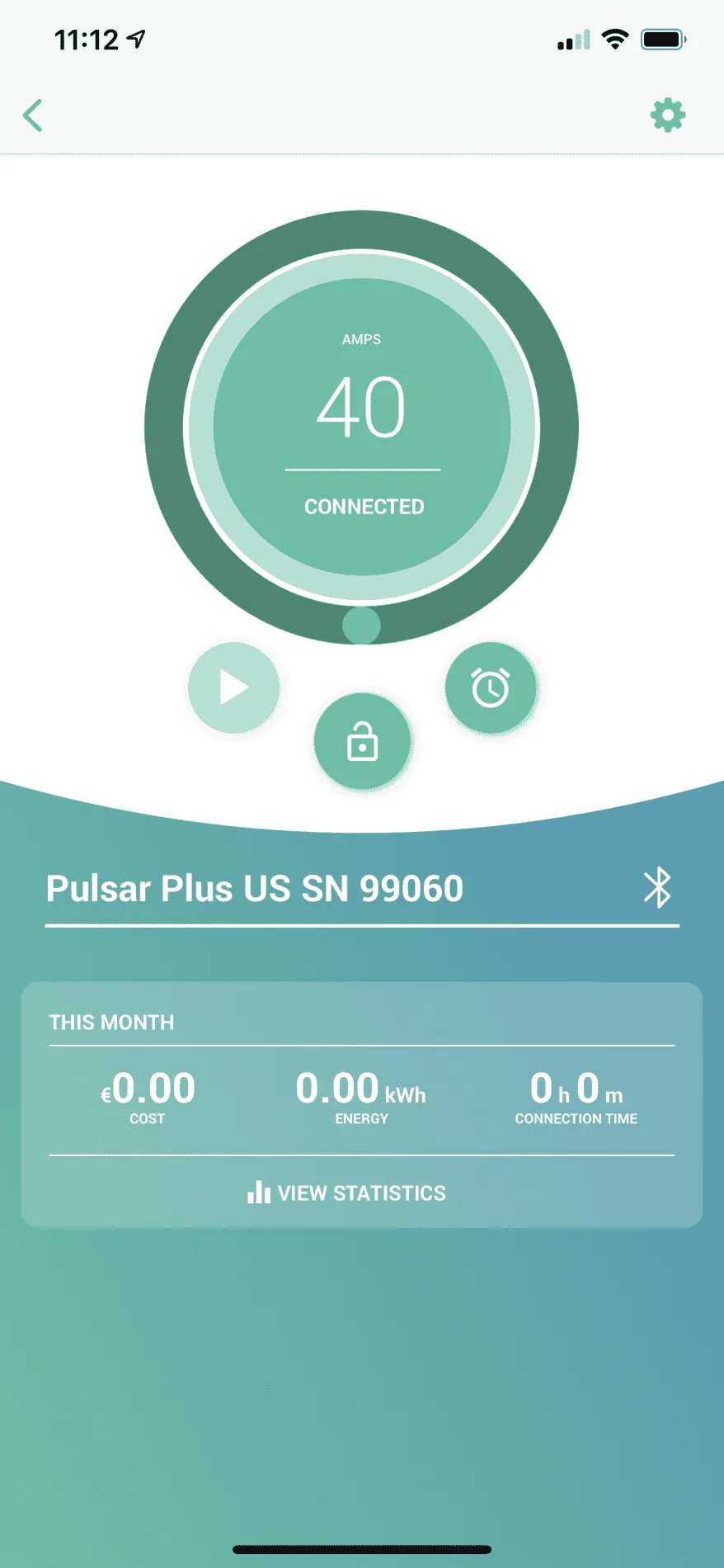

Here's a screen shot from a WallBox Pulsar which shipped with a 14-50RP wired to it
Rivian R1T R1S Charge to level IMG_1547
It's plain that it can be dialed up to 40A though it could be plugged into a 40A circuit.
If you legally install a Tesla Gen3 HPWC in a 50 A circuit the electrician will set it for 40A max charging. But if you decide you want 48 all you have to do is flip the breaker off and then back on. When the power comes on the HPWC launches a web site on which you can change the current limit to whatever you want. The password is on a sticker on the side of the unit.

It's even more restrictive - only hardwired units can be adjustable. If it plugs in, it's a no-no.
In #48 I posted a screen shot from a plug in unit that allows adjustment. Not saying the code doesn't prohibit that - just that at least one popular unit violates this. I put one in. The inspector didn't flunk it.
I really hope they don't pull a VW and only present charging rate as miles/hr or miles/minute...
Hmm... I'm guessing the 48 amps button is just setting the max the truck can pull, rather than what's actually being pulled? They've been touting their wall charger as being 48 amps and providing 25 mi/hr charge rate. If it's currently pulling 48 amps, then 19 mi/hr would suggest a different Wh/mile than we've been expecting, wouldn't it?
While I agree with @SeaGeo that I would personally like an option to show different units, I think the approach shown will probably make the most sense to most people. Battery % is really irrelevant to device usage. How long will the thing run is really what we care about.
Yes, me too. I am going to assume that there is another screen where one can select SoC in either miles or %.
I don't think so because that's not terribly useful information. The actual charging rate is and there also needs to be a display of the maximum desired charging rate. Clearaly both are not there.
That corresponds, with 91% efficiency, to 10.5 kW which with 25 mph implies 419 Wh/mi.
Yes, 552 Wh/mi. Hope it's not that high.
Can't agree with that sentiment. My advice to people starting out is to switch the fuel gauge to read percent and interpret it as you would the fuel gauge in an ICE car. There are, to my way of thinking, advantages to working in % and I think the more tech-savvy driver tends to prefer % but I'm not trying to convince anyone he should use % if he doesn't want to. By the same token it would be most disquieting if % displays were not made available for those who prefer them.
This picture suggests that one can only choose three charge levels. I hope we are not limited to only 3.
I find it interesting that they recommend 66% as best for battery life.
You pretty much have to be able to set the max charge rate somewhere, so it makes sense to have it on the charging screen. Since "48A" is shown in a bubble, I'm guessing that's it.
If it's 552 Wh/mi, these trucks are going to have massive batteries to get the 300 mile range that is also shown here. By my calculation that would be a 165.6 kWh battery for the "large" pack. That efficiency would also require a 220.8 kWh "max" pack to get 400 miles. So it simply cannot be that this truck is currently drawing 48A and only charging at 19 mi/hr. I think someone also pulled a different screenshot that showed an even lower charging rate in mi/hr (13 or 15 maybe), and it still showed the same 48A. I'm more convinced now that the "48A" is a button where you select the max rate the truck can pull, and it's not showing the actual current at that moment.
I personally would like to see both at the same time, just like I prefer to see my laptop's battery showing % as well as a "time remaining" because both are useful to me. I'm on the tech-savvy side though. Many people are not, and might have a better mental transition to EVs if they're not constantly stressed about a "low" battery % but are, instead, only presented the miles remaining, which hopefully will show them a decent enough buffer for them to feel comfortable.
Definitely agree on both of these. I could make due with 3 settings just fine, and most drivers will likely never have a need for more than those 3 settings, but you and I are tech-y tinkerers, so we'd like as many fine adjustments as possible.
