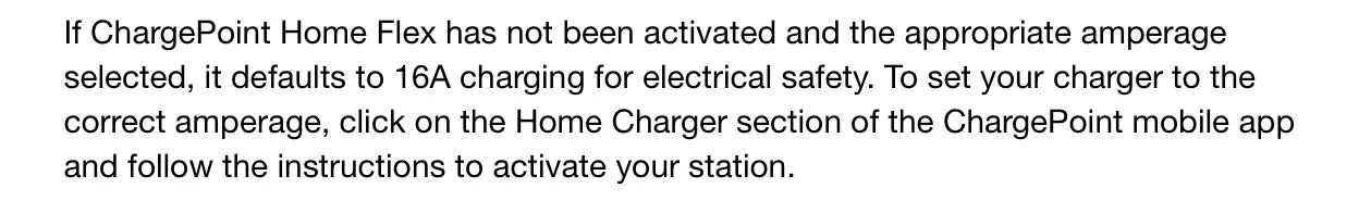

It is set to 50 Amps through the app and charges at 9.6 kW. I am just confused because you can set the charging speed within the truck, and I didn't know if it would try to pull more than my charger can output.
It won't. The truck won't override what the EVSE tells it the maximum it can output.
