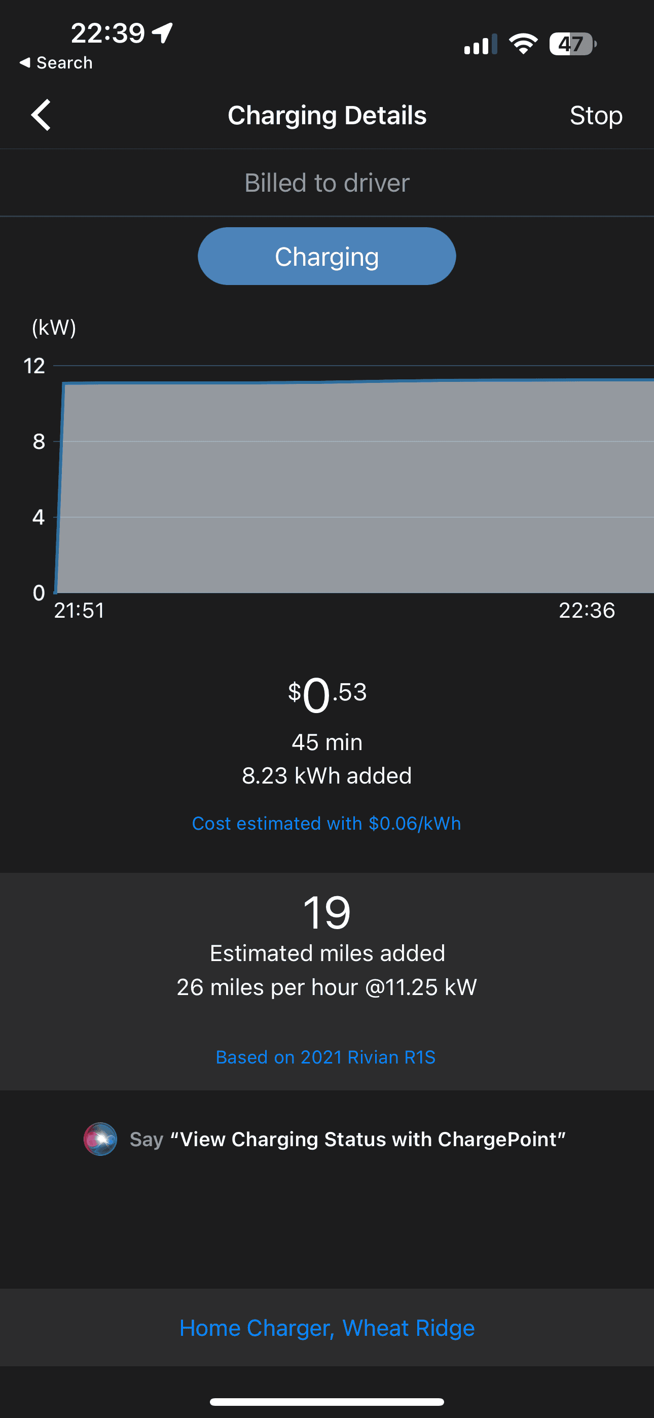

My ChargePoint Home Flex on the 60A breaker now charges the Rivian close to max vehicle capacity. With the 50 breaker it ran at 9.5-9.7. In Colorado on Xcel TOU rate between 9pm-6am. This give me 100kwh over night if I need that much

Just to clarify, I just got a ChargePoint and it's a plug setup 14-50, with a 60 AMP breaker and I'm only getting 9.2-9.6 kwh, that's normal? I had a BourgeRV charger that gave me 11.2 kwh consistently without issues.
Somethings not adding up here, a 14-50 is a 50 amp max plug, how did you get a 60 amp circuit on there, that said I think the Chargepoint limits to 40 amps of charging if using a plug, which is 80% of what the plug should be supporting. Chargepoint only goes up to 50 amps if it's hardwired.
