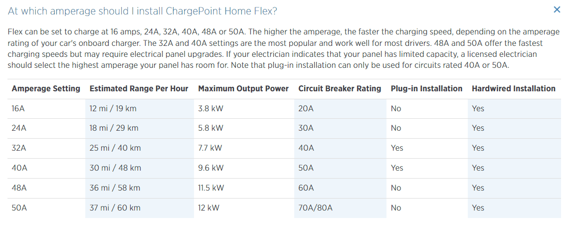

I have a Chargepoint home Flex and am currently getting quotes to move from the 14-50 NEMA plug to hardwire (going to keep the plug for backup). But the J1772 standard seems to allow up to a maximum 80 amps charging. However, with maybe the exception of Lucid and whatever Ford is doing, most EV's are not going much higher than the 50 amps my Chargepoint "can" support. I'm having a hard time getting the Rivian charged overnight with the current setup.
Chargepoint has a limitation in that the largest wire it can support is 6AWS THHN 90 degree rating. But going up to 80 would require a larger wire, so I can't really future proof by just sticking a 100 amp breaker in there with the supporting wire. I can only go up to 70 amps.
I can't seem to find good information if the industry "thinking" that 48,50 amps is going to continue to be enough for charging EV's going into the future. I don't want to continue paying for upgrading the electrical system as new EVSE's and EV's come out. but right now even the EVSE's are limiting me to 6AWG it seems like.

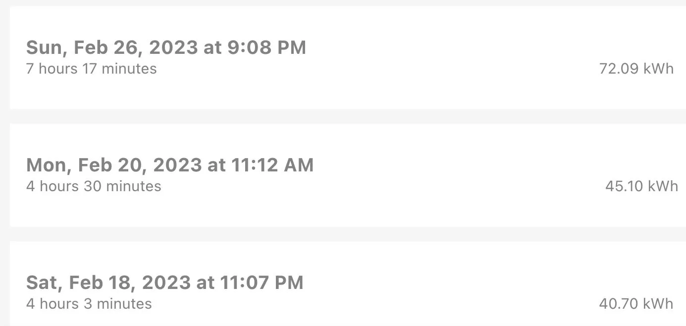

50A is the max your Chargepoint home flex can handle (which would require a 70/80A breaker), which is plenty fast for Level 2 charging a home. Most of your charging is done overnight, or over an 8-10 hour period. If you are giving the vehicle 20-25 miles per hour of range, you have more than enough speed to charge 250+ miles overnight at home. Anything else is overkill IMO.

Whats the charge rate you're currently avg at home with your Rivian (miles per hour charged I mean)?

I don't think that any of the "50 Amp" chargers are actually 50 amps. If you dig into it, I think you'll find that they are 48 amps. These, all other things being equal, will require 6 gauge copper (not in a UF-B cable). 48 amps is the max that the Rivian can/will accept, and it needs a 60 amp breaker and hardwiring. If you want to futureproof against the day that you might put in a bigger charger, run the larger wire from your panel to a "junction box" (next to the charger) with the proper screw-down connectors and drop down to the 6 gauge that your charger will handle from there. That way, if you ever do move up to a larger charger, all you have to do is drop in a bigger breaker without upgrading the majority of your wire run.

I think 48 amps is good for most home charging. I am getting consistently 10kw an hour added to my R1S at 44 amps. That is a good solid 20-22 miles an hour. Unless you need more than 160 miles daily which is 8 hours of charging.
On the occasion I need faster I’ll just go to a DCFC around the corner.

At home, max 60A Breaker. Rivian can’t charge any faster than 48amp via AC.

I use a ChargePoint home flex that allows 50A. Requires a 60A breaker. That delivers the max 11.5kwh the Rivian can take. At 40A I got 9.5kwh (with a 50A breaker)
