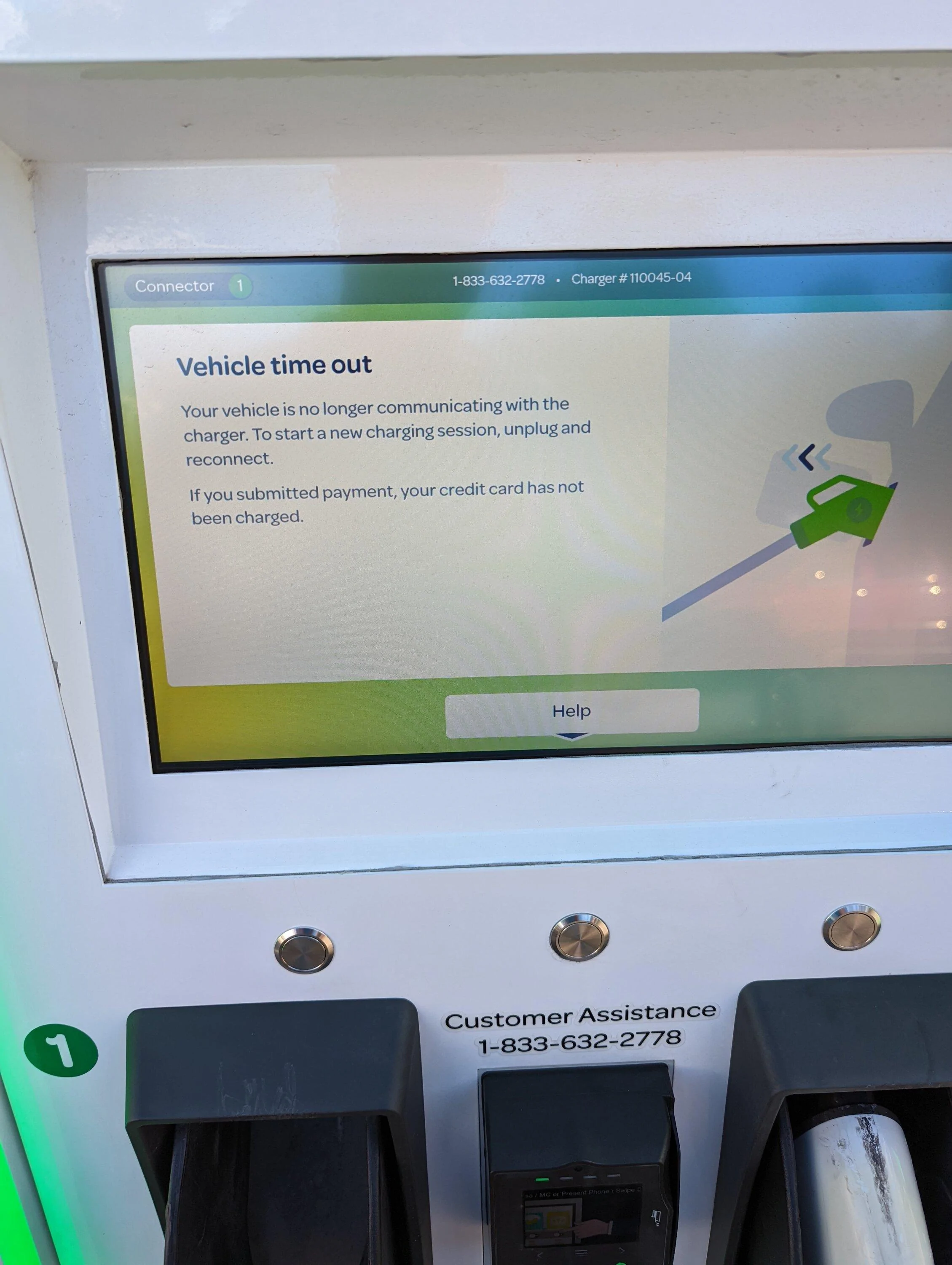

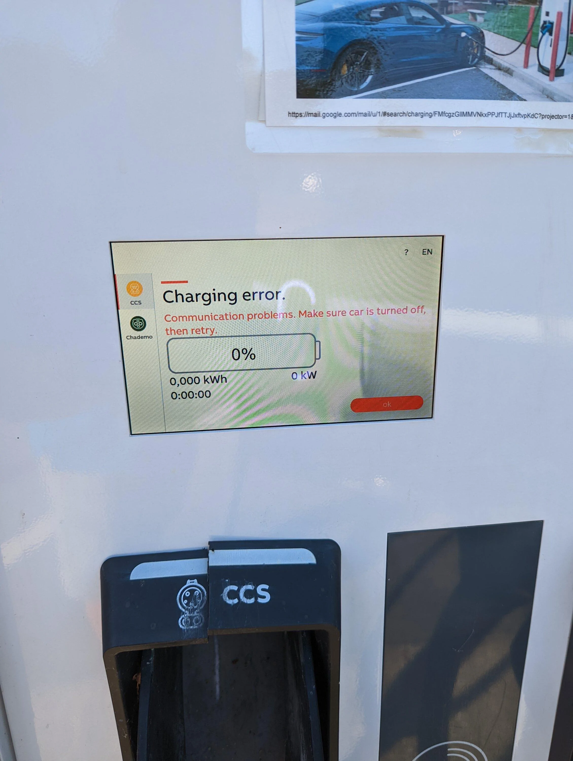

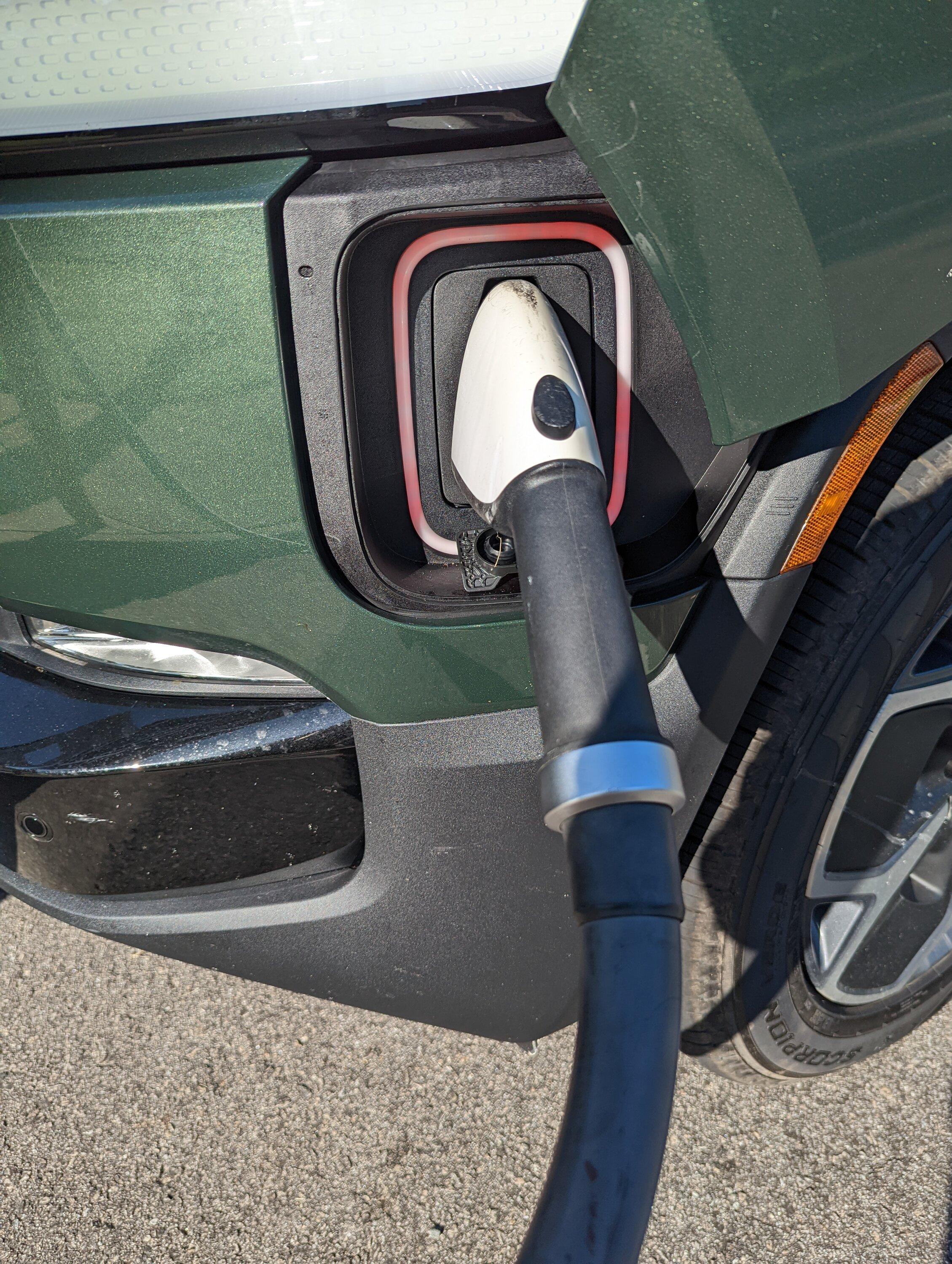

I was tempted to post a new thread but decided to put my experience here. I had a very similar issue and I'm just getting back home now. In brief, last week we performed the update and prior to a road trip we tested and made sure electrify America fast charging worked, and my charge point account worked at the office. We left last Saturday and the first DC charger was a charge point. Two different locations 5. Mi apart both would not allow fast charging on the truck, we called customer service roadside assistance and did the soft reset to no avail. The decision to proceed with the road trip or turn around and go home was a tough one and we decided to try an electrify America that was 30 mi out of the way. That charging station worked and we continued on our road trip for 300 miles and use another EA charging site. During the week we trickle charged at our rental and came home yesterday. Again, a different charge point that was at the halfway point failed to connect. We then proceeded to the same electrify America charger I used on the way down. Got there. And no charging connection was established. I spent 3 hours on the phone with customer service and roadside assistance, Andrew was very nice and as helpful as he could be. But the engineer continued to try to troubleshoot the electrify America portion, having them reset the charger and try to give a free charging session, both of which did not work. My frustration was that I had almost exclusively diagnosed it to the truck, but we still went through the motions of doing all the troubleshooting on the charging side. Meanwhile, I saw another Rivian, a Ford lightning, and two ID4s charge at the same location. So I am now on the way home after spending the night in a hotel and trickle charging on a level 2 overnight. Luckily we were within two hours of my parents house who graciously came and picked up My kids and wife and got them home safely. Each time I tried to connect I would have a initial white glow at the charge connector and then it would go red after about 30 seconds. The dashboard would give me a error that said, remove plug and try again. Each connector would go through the initiating phase and then either time out or say there was a connection issue. I will try to attach pictures. Overall a very frustrating and to anotherwise good trip. I Have a R1S on order as well and this will definitely give me pause on having two vehicles from the same startup company. In short, there is something wrong with my DC fast charging CCS connector. Whether it is hardware or software, I don't know? But three different charging companies and five different charging stations have not worked.
Just as an FYI. In my experience the ‘Unplug and Try Again’ type of error is almost certainly the truck (like you assumed). For me when I have seen it 3-4 times I can do a hard reset to get charging. Ive also seen reports that a full sleep cycle will get fast charging working too.
It’s a real shame if service didn’t have you try that, because they should know by now. ThIs is a known R1T issue that they don’t seem to have a solution for.

doc
Thanks, we did try multiple resets and did the Walk away for 30 minutes and try again. Unfortunately neither worked

First road trip from Toledo to Cincinnati to watch the Braves play. Parked the car for the game and was able to plug into a J1772 plug for the duration. After the game we were about 50 miles short which was planned so we headed to an EA charger. Tried 5 of the 10 with no luck. EA was worthless and claimed no error on their end but quick to dismiss it. Rivian went through the basic troubleshooting with no solution.
They suggested trying a L2 charger and then trying the DCFC again. Found a 50kw CCS on our way and again, no charging. Then found a 7kw J1772 which worked so we charged for a few minutes and headed to another EA charger. Once there, again tried nearly all with no luck. At this point we were about 180 miles from home with 140 range. Wouldn’t have cared if I was alone but had my 7 year old daughter with me who was exhausted. After multiple other chargers via PlugShare, no CCS charger would work. Tried a 24kw plug and finally the last EA on our route. Finally gave up and am currently about 95 miles from home at a Hilton that is on Rivian tonight.
This is my first experience with any CCS charger and wondering if anyone else has had a CCS issue? I charge daily with a J1772 plug with zero issues.
Soft reset tried, hard reset tried, turning off gear guard and letting truck go to sleep for 15 minutes as tried as well with no luck.
