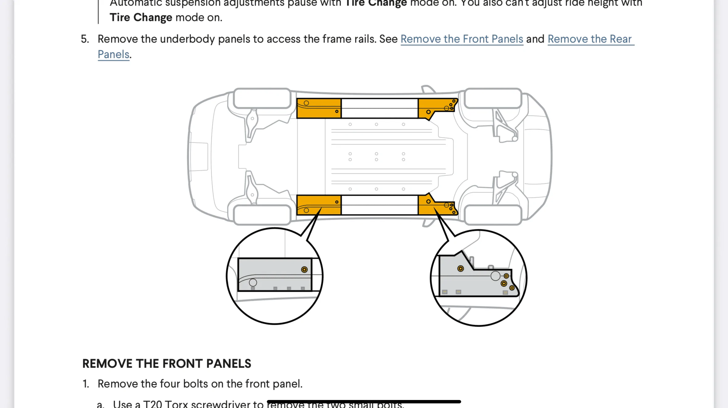

Keep in mind (if you werenā€™t already aware) that you can also remove parts of the aero shield on the bottom and use any standard jack/jack stand. Ive done it, fairly easy but the pucks/special jack stands certainly make the job easier.
Info is on page 203 in the manual
