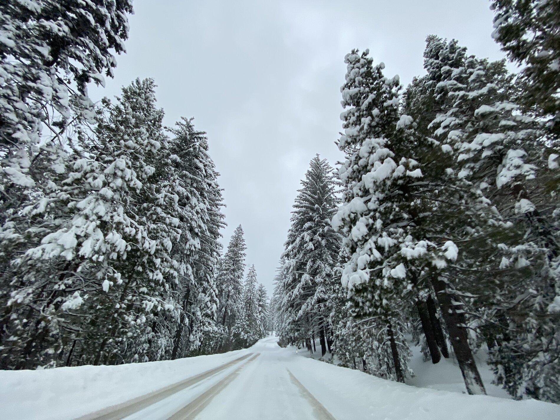

When I was in Yosemite in November 2019 for Thanksgiving, there was a large storm that mostly passed, with the roads still requiring chains at park entry. I don’t recall if the conditions were R2 or R3, unfortunately. This was all new to me, as I had driven sedans previously. I had an Telluride SUV with AWD, and M+S tires, but was required to put on chains.
