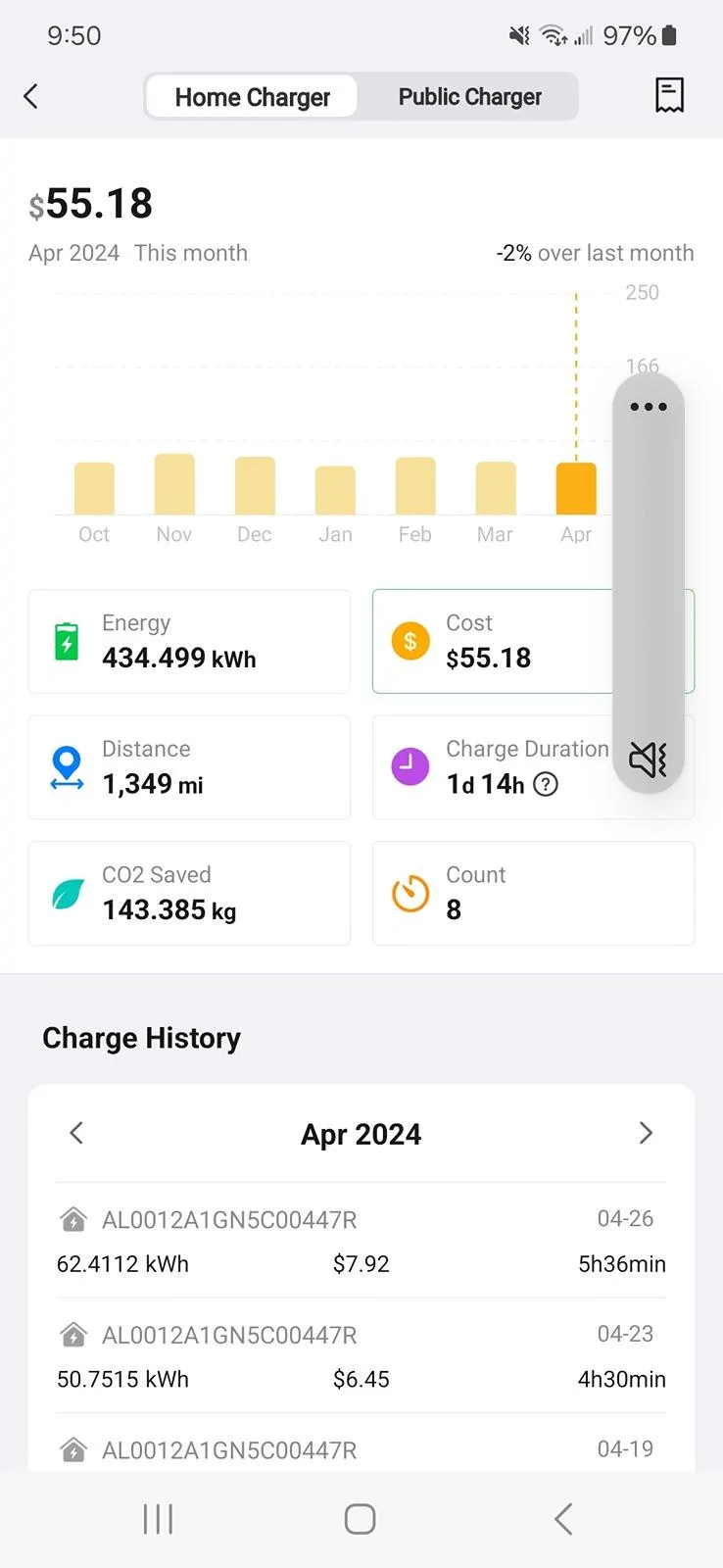

Our costs are about 25% of what gas would be so we pay around $50-$60 a month and would normally pay $200-$250 for gas. My wife has a short commute, but we runf the wheels off it on the weekend with errands, kids sports, etc. we do a few road trip each summer, but mostly all of our charging is at home. Our power is pretty cheap at $.127 cents per kwh loaded (includes taxes and fees)
