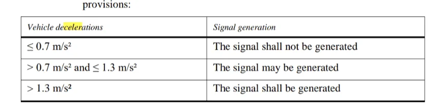

Consumer reports disagrees with you. “In spite of the potential safety hazard presented by the failure of brake lights to illuminate during one-pedal driving, the U.S. government doesn’t have an explicit standard regarding deceleration levels for activating brake lights.” And the National Highway and Transportation Safety Administration does too. The federal regulations do “not require the [stop] lamps to be activated at a specific level of deceleration.” Thus, Rivian could not have “designed to the federally mandated specifications” since there are none. The federal regulation only requires that the stop lamps “Must be activated upon application of the service brakes. …
May also be activated by a device designed to retard the motion of the vehicle.” So they MAY be activated by other means. Hopefully they work well, but it would be good if there was an actual standard.

The issue with regenerative braking and the stop lamp triggering has more to do with emulating deceleration when ICE vehicles would be "coasting."
Each ICE vehicle coasts differently. Where is the line for deceleration between "brake pedal" and "coast"?
Personally I think they could activate the lights at less deceleration than they currently do, but I don't have an exact value that represents when I think they should come on.
If it is too light, the everyone will look like they are "riding the brake."

The US adopting the new EU regs would be a step in the right direction. I agree that there is a possible over correction that could happen which we don’t want either.
Re: ICE coasting….unless engine braking, no ICE decelerates like most EVs when coasting (including something like the Taycan which doesn’t really employ strong lift off regen). It’s certainly easier then, to say that the trigger is “brake pedal pressed” because an ICE vehicle won’t considerably slow down under normal/default circumstances otherwise.

Thus you're left with a few choices, go by the existing UN standard which dictates when you MUST illuminate the lights, or spend money to do a performance study to get an average deceleration rate for coasting ICE vehicles.
