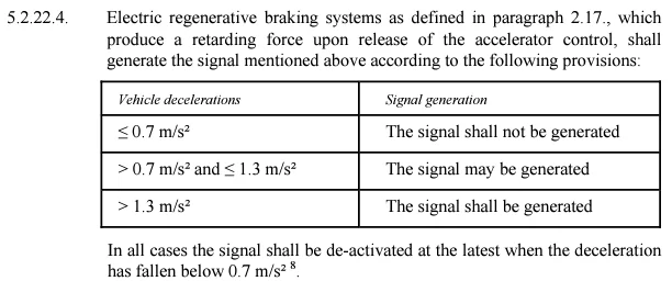

It's based off of the amount of deceleration.
This is what the law is for european countries. I thought there was an identical law for the US but I can't find it currently, so ignore previous edits of mine.

I've actually observed that when you are traveling at a decent rate of speed and regen brakes are severely limited that the Rivian will still slow down but not illuminate the stop lamps, so they have to be measuring it somehow.

As others have noted it is based off of the amount of deceleration so if you only gently let up on the pedal the lights don’t always turn on.
One thing to note is once you are driving in the truck the dash display WILL show you if the brake lights are on.

There are regulations that dictate this action. Additionally if you look at the vehicle in the drivers screen it lights up to tell you when the brake lights are triggered. Not as noticeable as the Tesla Model S display but it is still there.

As posted above, it only comes on when certain deceleration thresholds are exceeded. It's definitely not every time you lift of the accelerator. That would be crazy.
Easiest way to see when they're coming on is to drive at night with the crossbars installed in the bed. They reflect the cyclops light into your rearview mirror. If you're gently slowing down it definitely does not come on until you're almost to a stop.
