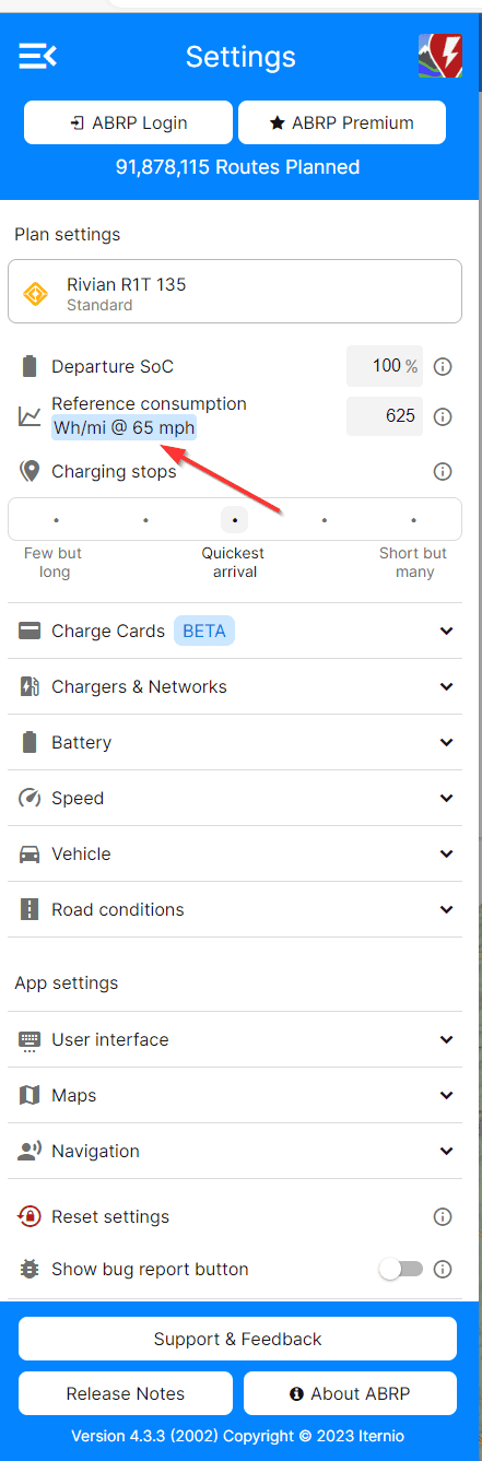

This reminds me of a question I've been meaning to ask.
ABRP defaults to 245 Wh/mi.
Anyone use a more realistic Wh/mi on 22s?

If you click on the blue portion where it says Wh/mi it will flip to kWh/mi

I've been playing with ABPR all morning. The ref consumption is so subjective, but mid-Feb it should probably be close to 1.5 conservatively speaking.
