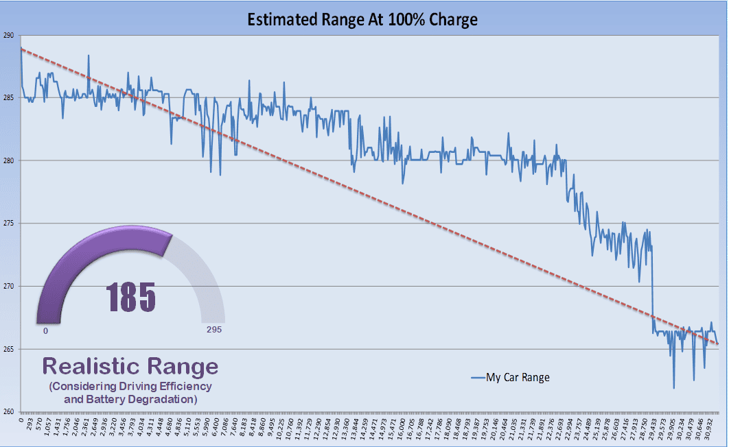

I think you are right. I am hoping that after they gather better data with the packs they are able to access some buffer to offset degradation - I think Audi was able to do his with the e tron once they gained more comfort. I am apprehensive that 300+ will be more like 200-225 in practical use a few years down the line
I have the same concern. My experience with one of Xs is along those same lines. When you factor in over 4 years of battery degradation and driving style/HVAC usage, I have a "Realistic" range of just 185 miles at 100% charge and only 167 miles at the typical 90% charge (down from the original EPA range of 289 miles). Note: that does include about 15% of the miles were towing something.
