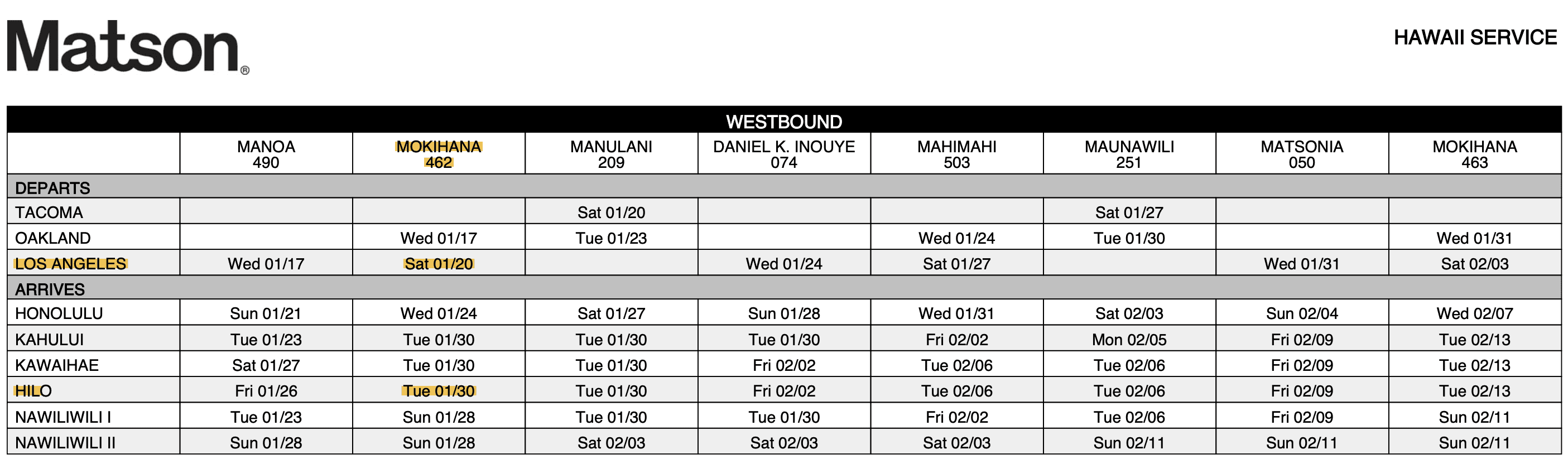

As @domoplaytime mentioned, shipping is via Matson. I'll be shipping from Long Beach, CA. There are some large annoyances with Matson, but there are no other options. Most notably:

For anyone else planning to do this, I wanted to try to minimize idle time because of vampire drain, so I took a look at Matson's fleet and realized the Mokihana lists a capacity of 1323 autos (and 1994 TEU's whatever that means). So I looked up the sailing schedule and found the Mokihana is schedule to leave LA/Long Beach on Saturday, 1/20/2024:
Rivian R1T R1S Aloha, Rivian R1S 🏝️!  -- Transporting Rivian from Phoenix, AZ to Kailua Kona, HI 1704772824117
I emailed Matson (they don't answer the phone) and they confirmed Mokihana is the correct vessel for auto transport and that the vehicle would have to be dropped off by Tuesday, 1/16/2024 @ 4pm to make the 1/20/2024 sailing. So that's the target drop off date. However, when I sought enclosed shipping quotes from Phoenix to the Matson Long Beach harbor, the quotes were outrageous - $2000 to $2850. I found that to be ridiculous for 400 miles of transport, so I'm driving it myself and with my work schedule, I hope to drop off by this Friday, 1/12/2024.

As far as pick up, this is a moving target as well. Aside from potential weather factors, according to the schedule I posted above, the Mokihana is scheduled to arrive in Hilo on Tuesday, 1/30/2024. However, my booking sheet lists a 2nd vessel voyage on what I think is a Young Brothers auto transport ship and an estimated pick up of Monday, 2/5/2024. I'm guessing the vehicle will need to sit in Honolulu for a bit for inspection, then get loaded for transportation to Hilo. We shall see.
I have shipped 2 vehicles from the mainland to the Big Island previously. I think one took 21 days and the other 28 days. Again, we shall see.

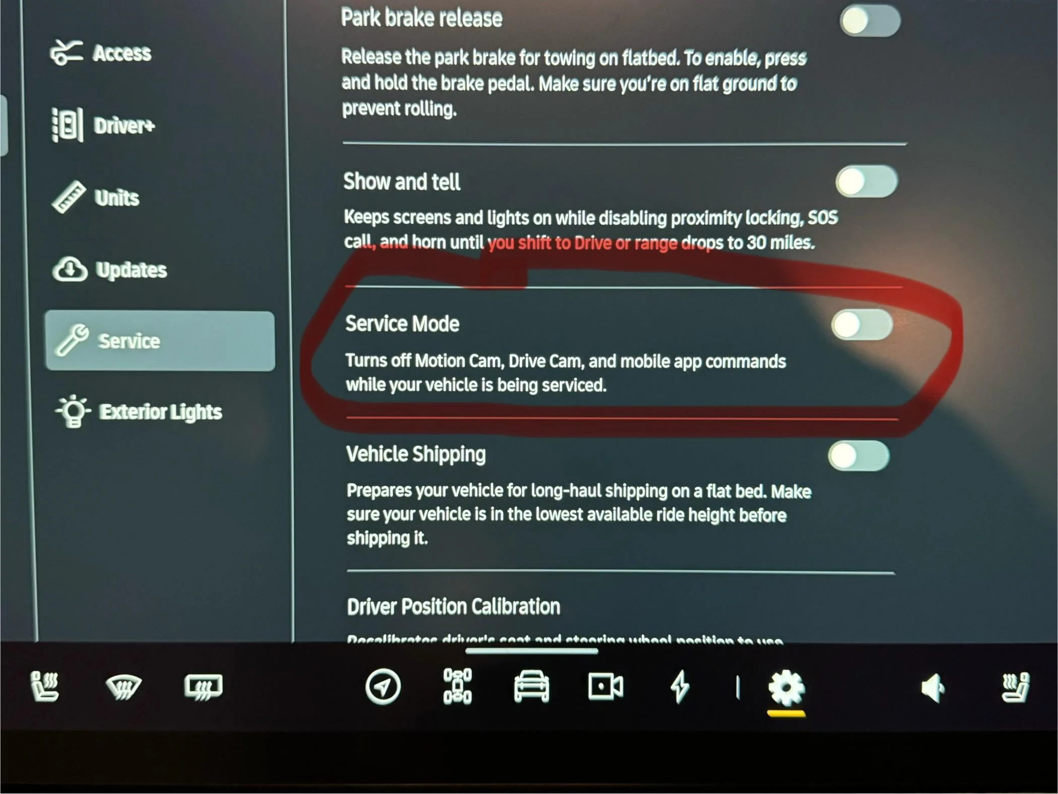

1) Any suggestions of minimizing vampire drain? This is my current plan and feedback is welcome:
- Shipping mode (of course)
- Service mode (because why not?)
- Data and Privacy - going to turn everything off
- I already dropped an AirTag in the car
- Turn off Hot Spot, Wi-Fi, and Bluetooth (I know the latter two may come back on when a door opens)
- Turn off all Proximity Lock/Unlock
- Turn off Climate Control
- Turn off all Gear Guard Options
Any other suggestions?
I did not do this. I'd be worried about the vehicle being more active to collect telemetry. Who knows.
Your other proposals are fine, but the key ones are shipping mode, gear guard off and proximity locking off.

I think the current version of Service Mode was released only about a month ago - maybe in the .46 update?
It basically turns off mobile commands and Gear Guard. I don’t think that’ll hurt anything in terms of drain.
