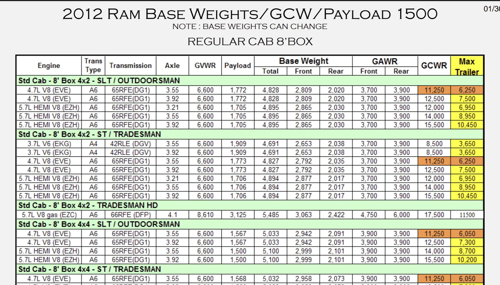

I've also found this listing rear GAWR of that series Ram at 3900lbs but an HD version runs 6000lbs. If that HD had these wheels, I'm pretty confident they can take the Rivian weight.
Reading those specs - that Tradesman is likely a 2500 in sheep’s clothing (look at the payload) - if you came across one bet it had 8 bolt hubs.
…I’m still just pissed those beautiful steel wheels had such shit load rating…
According to Tire Rack search results for 2012 1500 HD, it's the same pattern ??‍♂

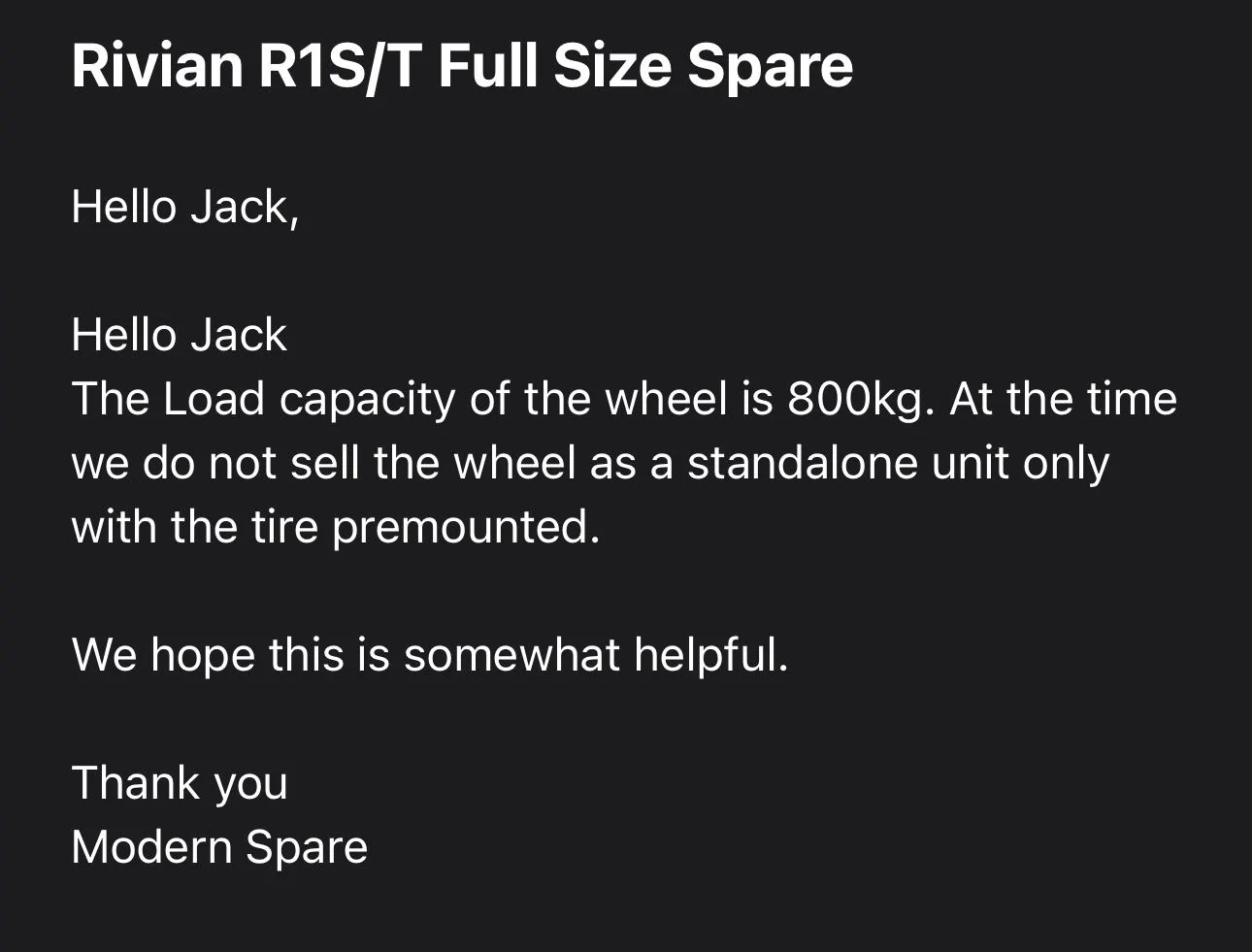

Sooo this is … well huh. The wheel modern spare is providing with their full-size spare for the Rivian. Also also has an 800 kg load capacity!! They must source the same wheel as Road Ready.
First of all they screwed up my name … but - I’m guessing they are using the same wheel.
Rivian R1T R1S Affordable Winter Wheels Setup: Ram 2363 IMG_0956

Ask him about the RoadReady steelies and that 800kgs rating!! ? Please and Thank You!!!
If he believes at all that rating would suffice … sign me back up.
