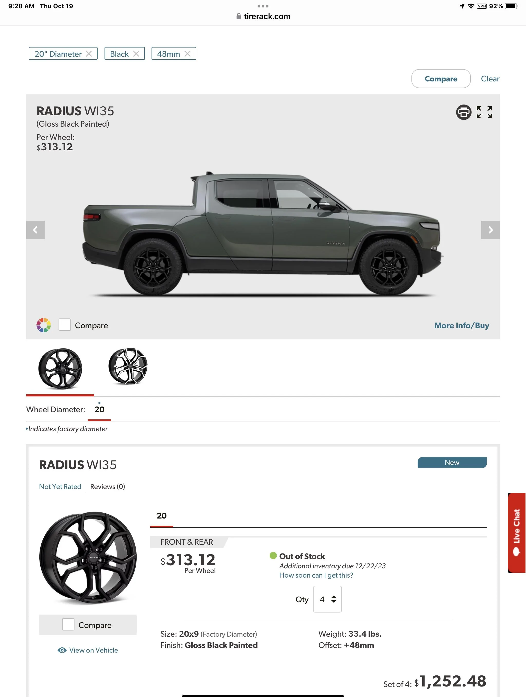

I like to have a dedicated set of snow tires and rims. So, I went with these rims from Tirerack, Rivian TPMS’s, and Nokian LT3 studded snow tires (LT275/65 R 20 126/123 Q).
(I just noticed that the delivery date for the wheels has been pushed out since I bought mine :mad:.)
A buddy of mine has the Nokian LT3’s tires on his truck (not a Rivian) and swears by them. Even though they’re studded, they are a lot quieter than I expected them to be.
We live in BC and frequently travel over the infamous Duffy and Coquihallla passes, (https://www.dangerousroads.org/north-america/canada/4008-coquihalla-highway.html). So, ice performance is top of mind for us.
The folks on this forum are looking for the safest/best options for winter travel. Now if we could just get the “I’m okay with my all seasons” crowd to buy into 3 Peak or dedicated winter tires we’d all be safer and better off.

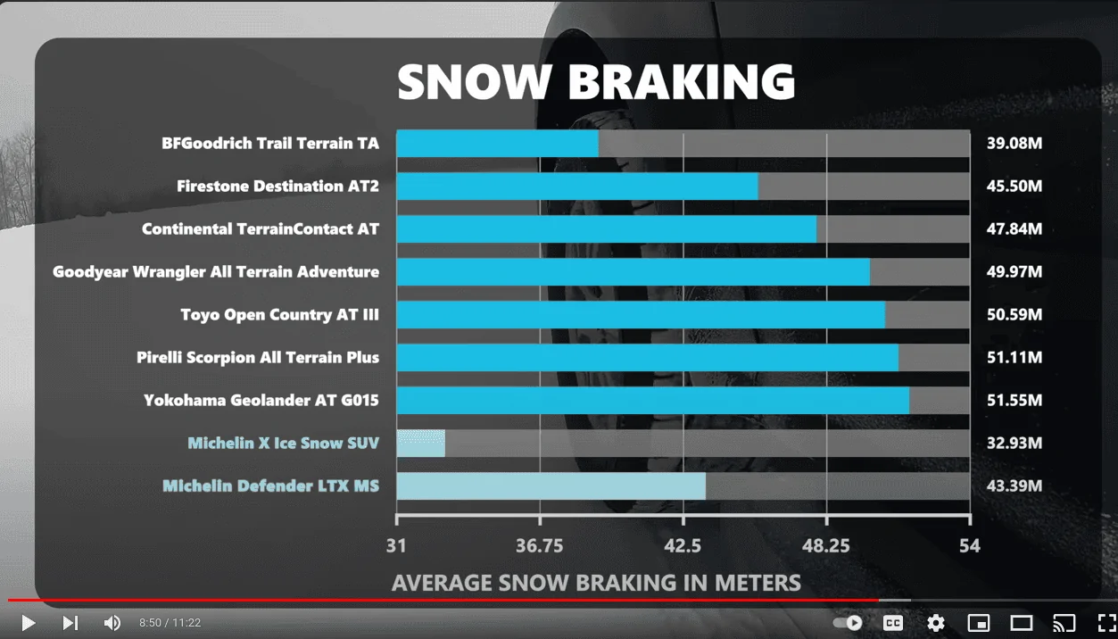

They weren't testing on a Rivian, but I just found this video that puts some numbers on the performance of the Pirelli Scorpion All Terrain Plus relative to other AT tires, an all-season road tire, and a real winter tire.
