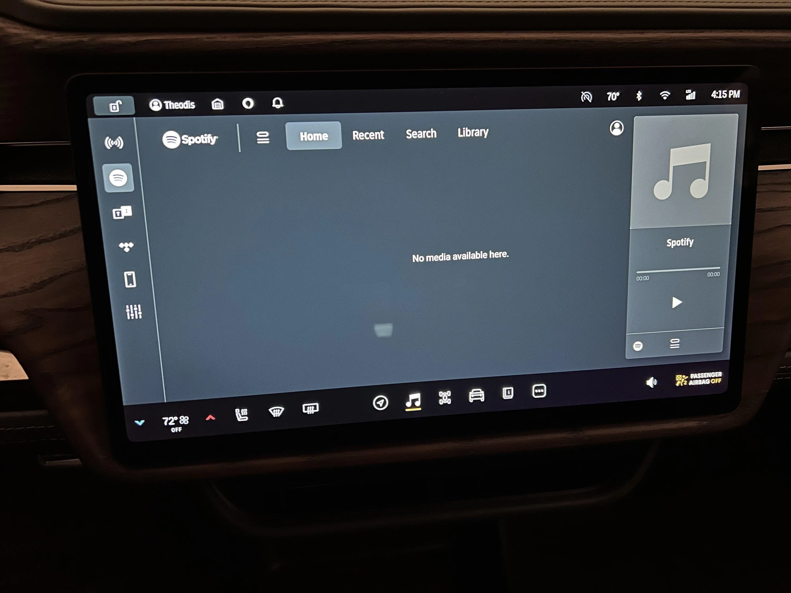

Over the past couple of months I noticed that the integrated apps in my R1T don't respond (Alexa, Map route planning) or don't populate content (Spotify, TuneIn) unless the vehicle is placed in drive. If I'm sitting in park in my garage or out in the wild, Alexa just doesn't respond to voice commands. It stays dark.
Spotify puts an error on the screen that says "No media available here". Once I put the truck in drive, all of the playlists populate.

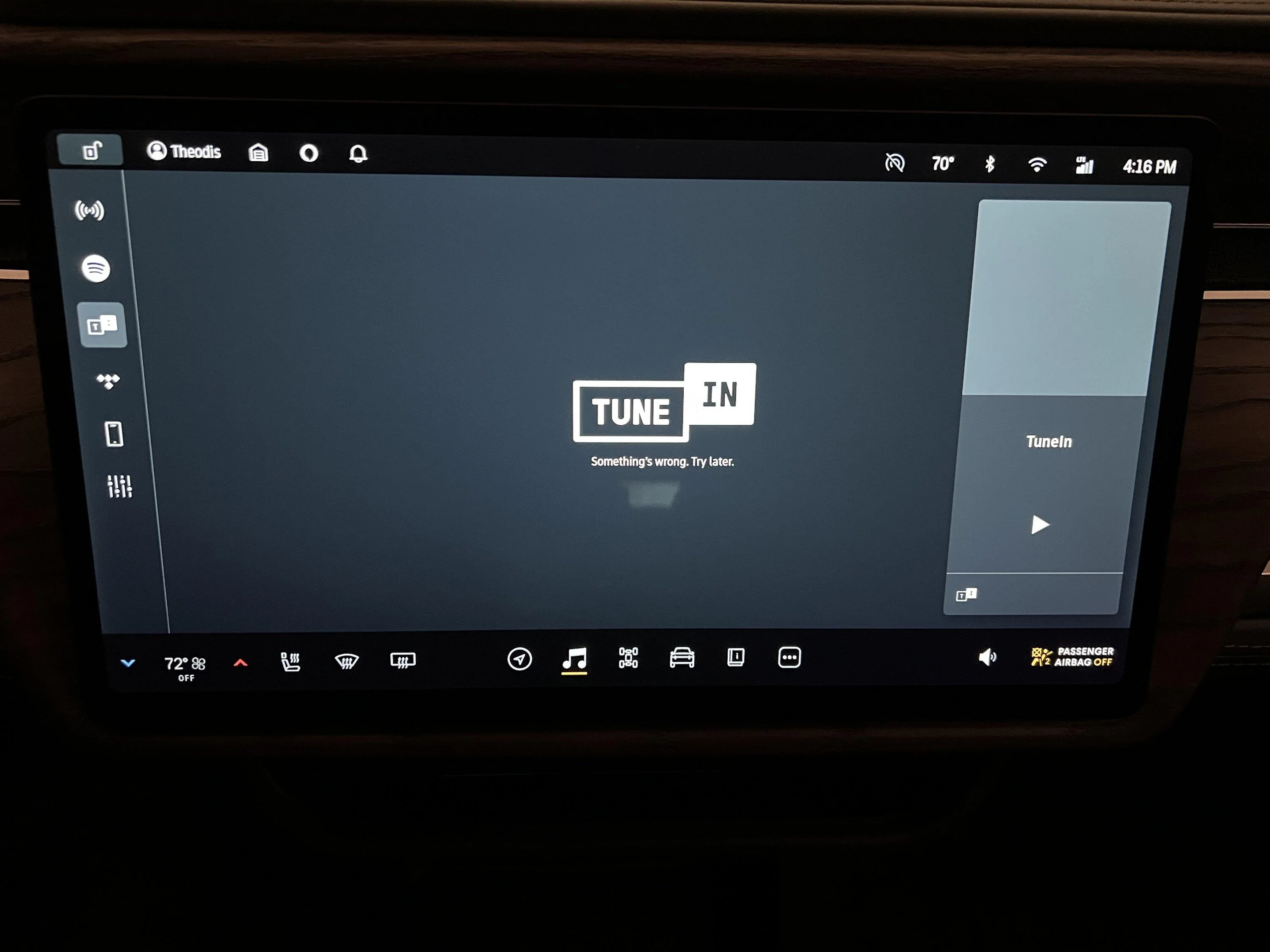

Tunein posts an error message that says "Something's wrong. Try later.". Once I put the truck in drive, all of the podcasts populate.
