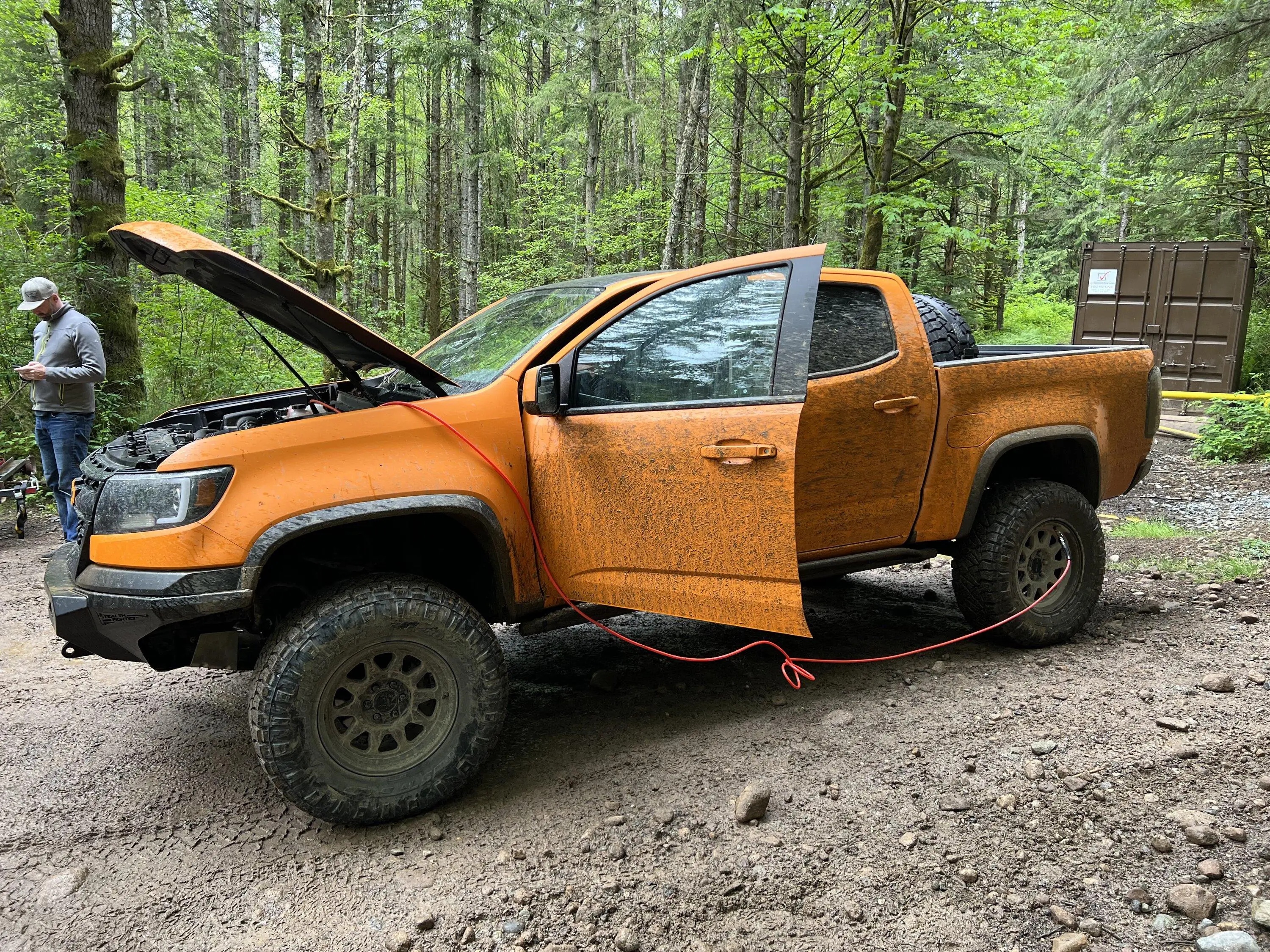

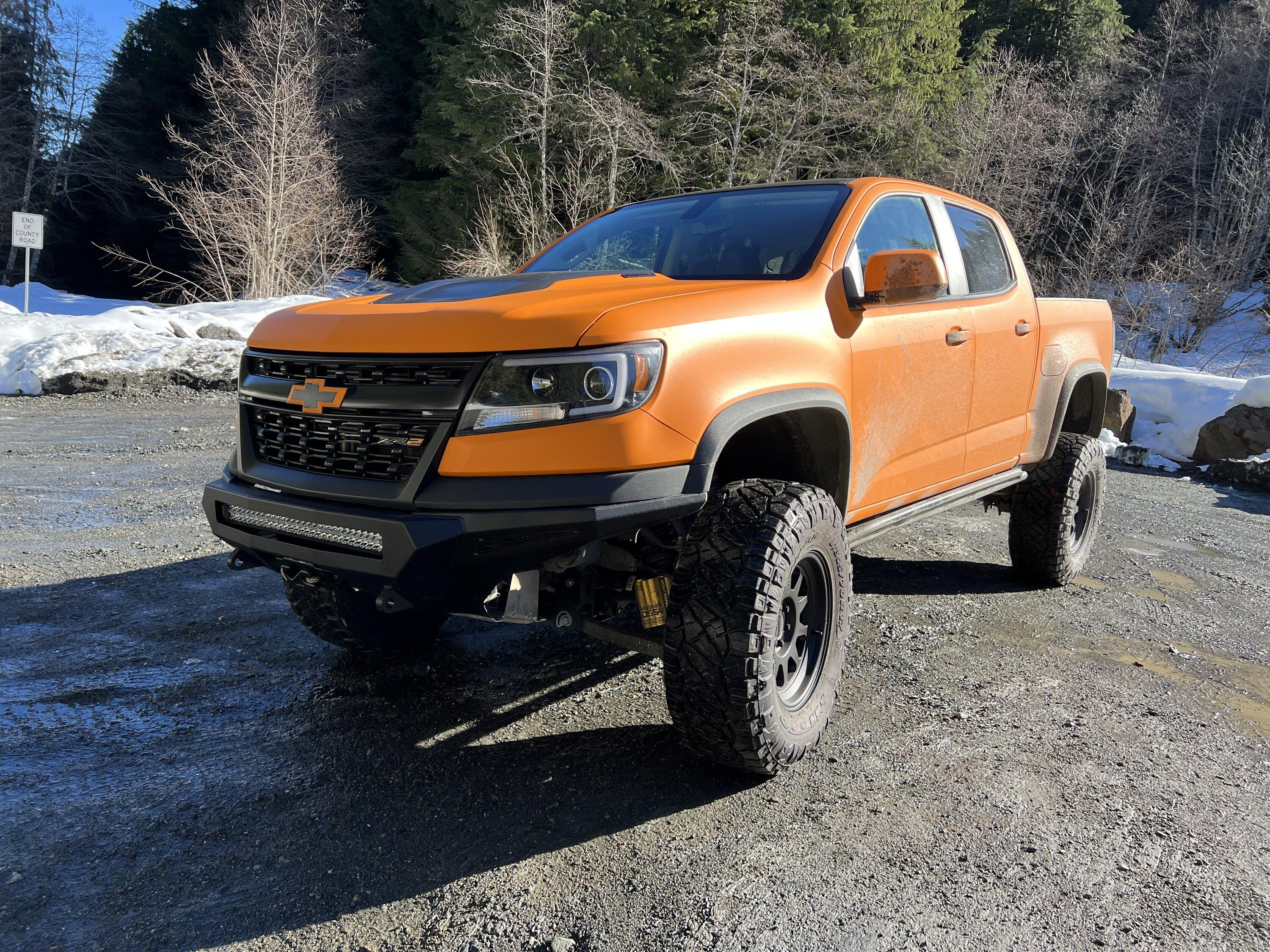

For serious off-roading you want your tierod to be the fuse.
Sleeving them transfers the stress to the steering rack.
Would you rather pay $75 for a tie rod and about 30 minutes to change it, or $3000 for a steering rack and all weekend?
My other rig is a built ZR2 and I run the stock tie rods on purpose.
