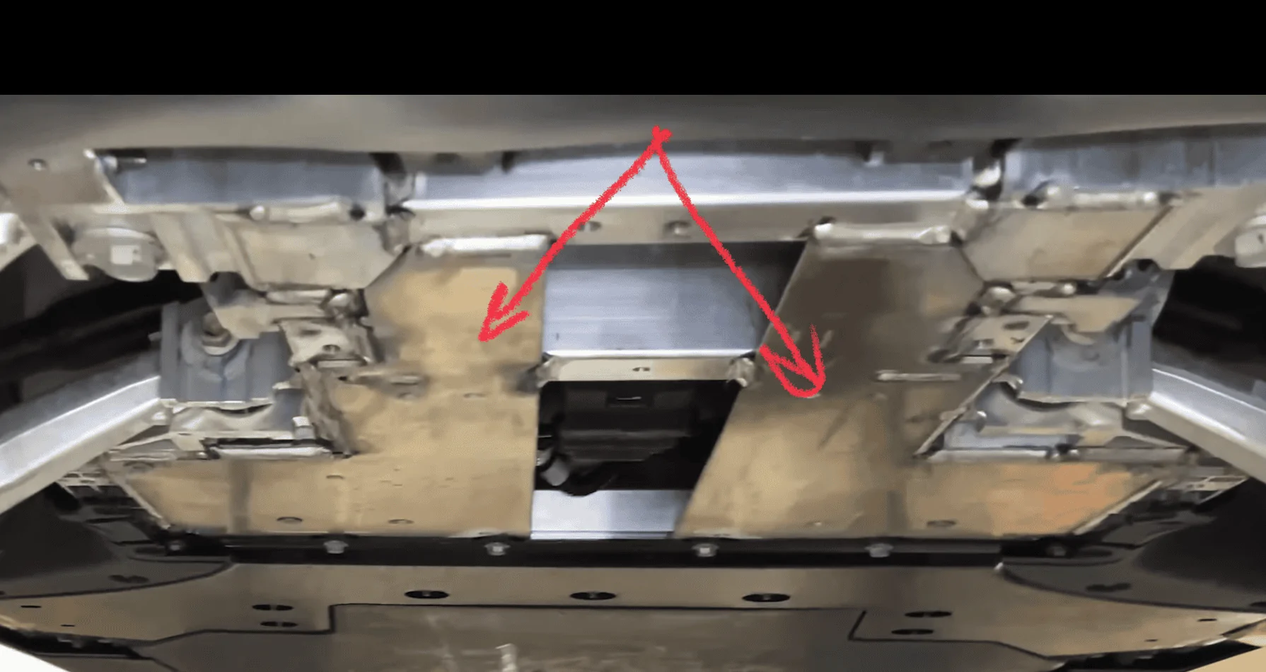

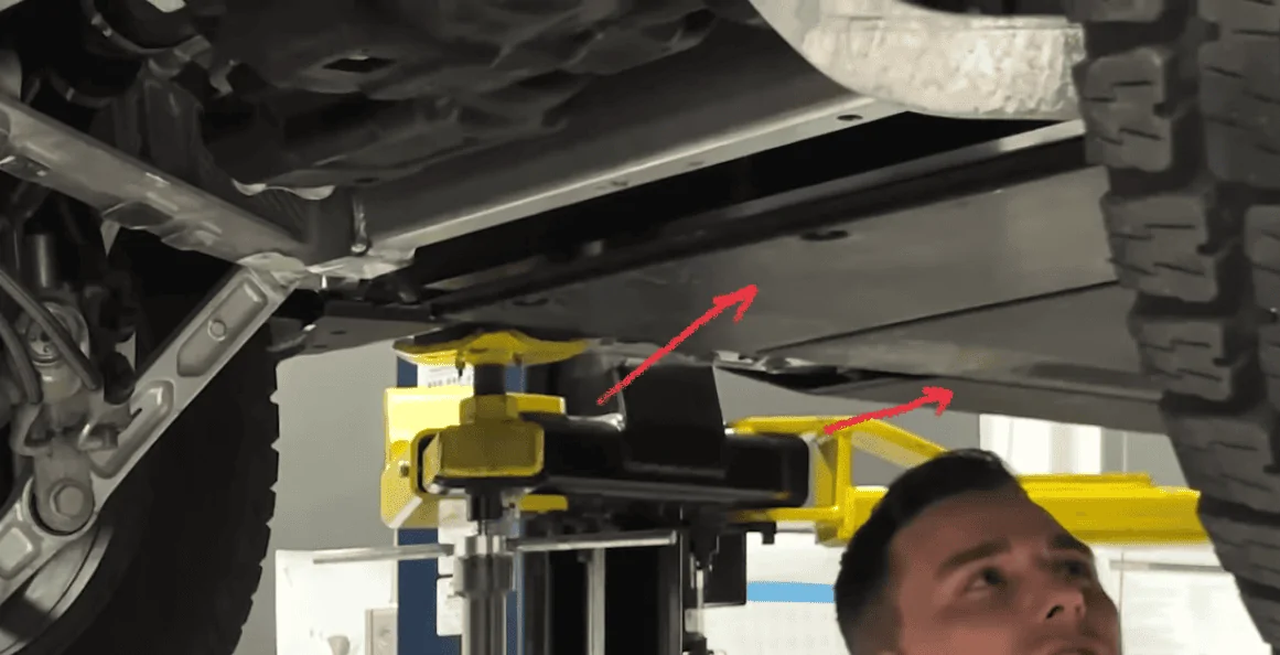

So close to answering the skid plate questions but yet so far! I wish they showed the plates they took off below the mirrors, and also took off the plastic aero cover from below the battery. Oh well, at some point someone will be able to directly compare the differences between the trucks with and without the optional skid plates.
Max
Max
Aug 31, 2021
1,534
2,351
Maryland
Nissan Truck

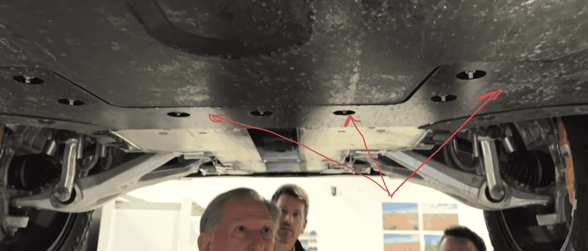

Yes, generally very disappointed with not seeing the teardown. At first glance I thought these were a part of it.
Rivian R1T R1S R1T underbody review by Sandy Munro. "Amazing suspension." 1648669745292
but they are most likely under four plastic pieces around the battery:

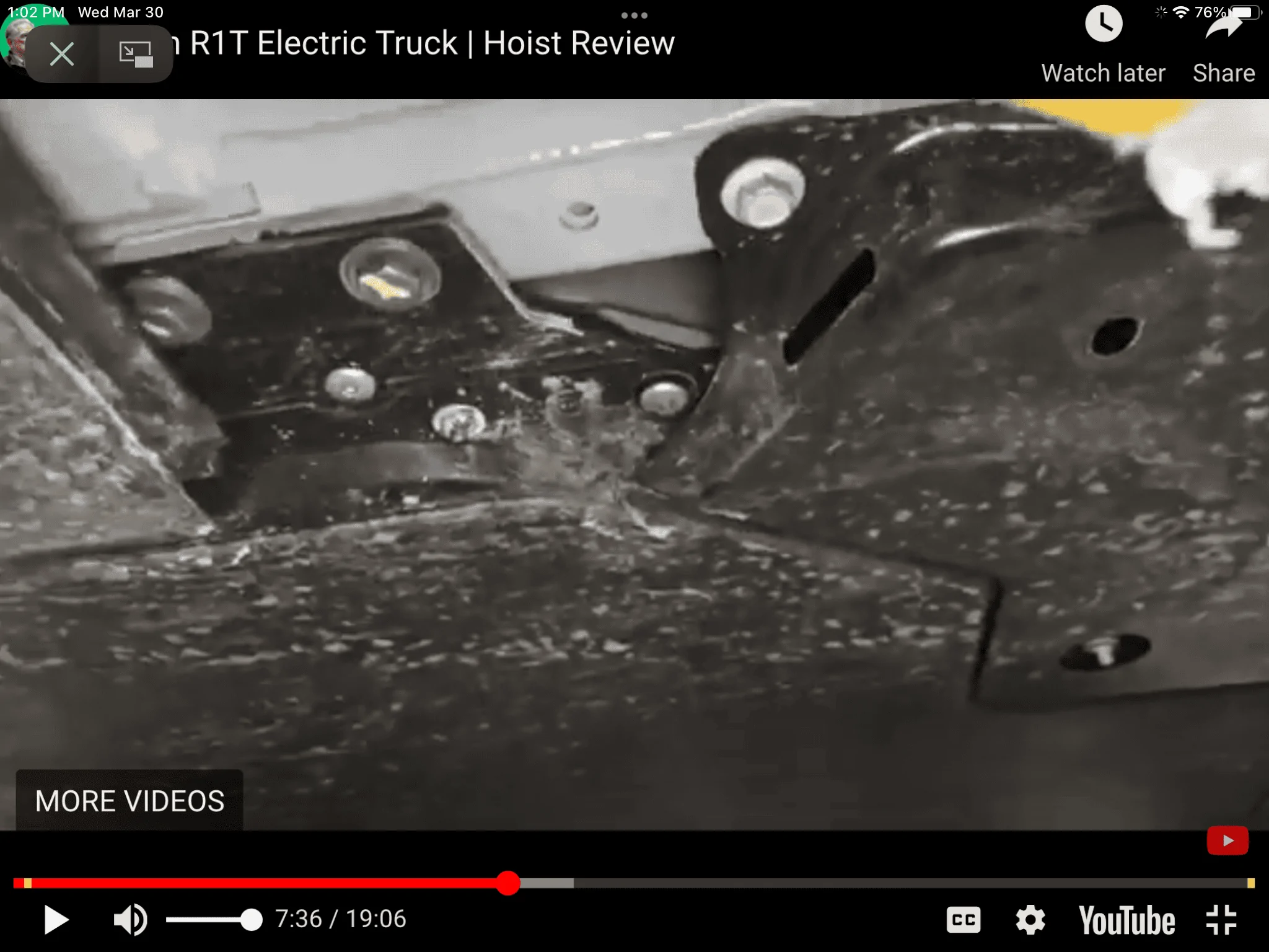

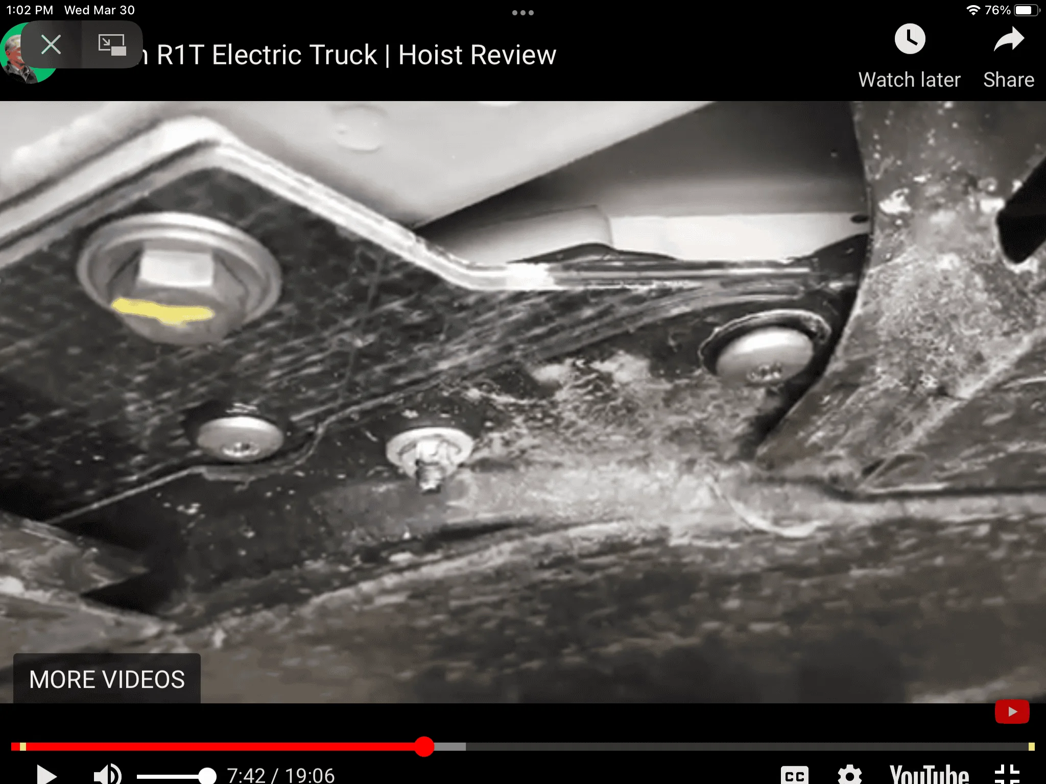

Wonder if the 1/8 inch metal plate between the carbon fiber battery tray and the outer shield is the off road skid?
Rivian R1T R1S R1T underbody review by Sandy Munro. "Amazing suspension." 1C7ACD00-7DF0-4CFB-81A5-963BBDBC979C
Rivian R1T R1S R1T underbody review by Sandy Munro. "Amazing suspension." D5ADB63E-BB39-4584-A68B-EECE635E5805

Sure hope Rivian has at least one composites mfg. engineer that made sure to call for a paste sealant/barrier gets applied to all metal fasteners attaching the plate to the carbon-fiber laminate. Otherwise that's a recipe for galvanic corrosion. The plate face itself should be fine touching the laminate surface as long as the plate has a robust anti-corrosion coating which it appears to have being black in color. But through-bolts or rivets or any kind of metallic fastener other than say titanium requires a coating. Commonly a polymer paste called ProSeal. Fastener bearing, shear and all other loads will normally wear-away at exposed surfaces at each hole location.
