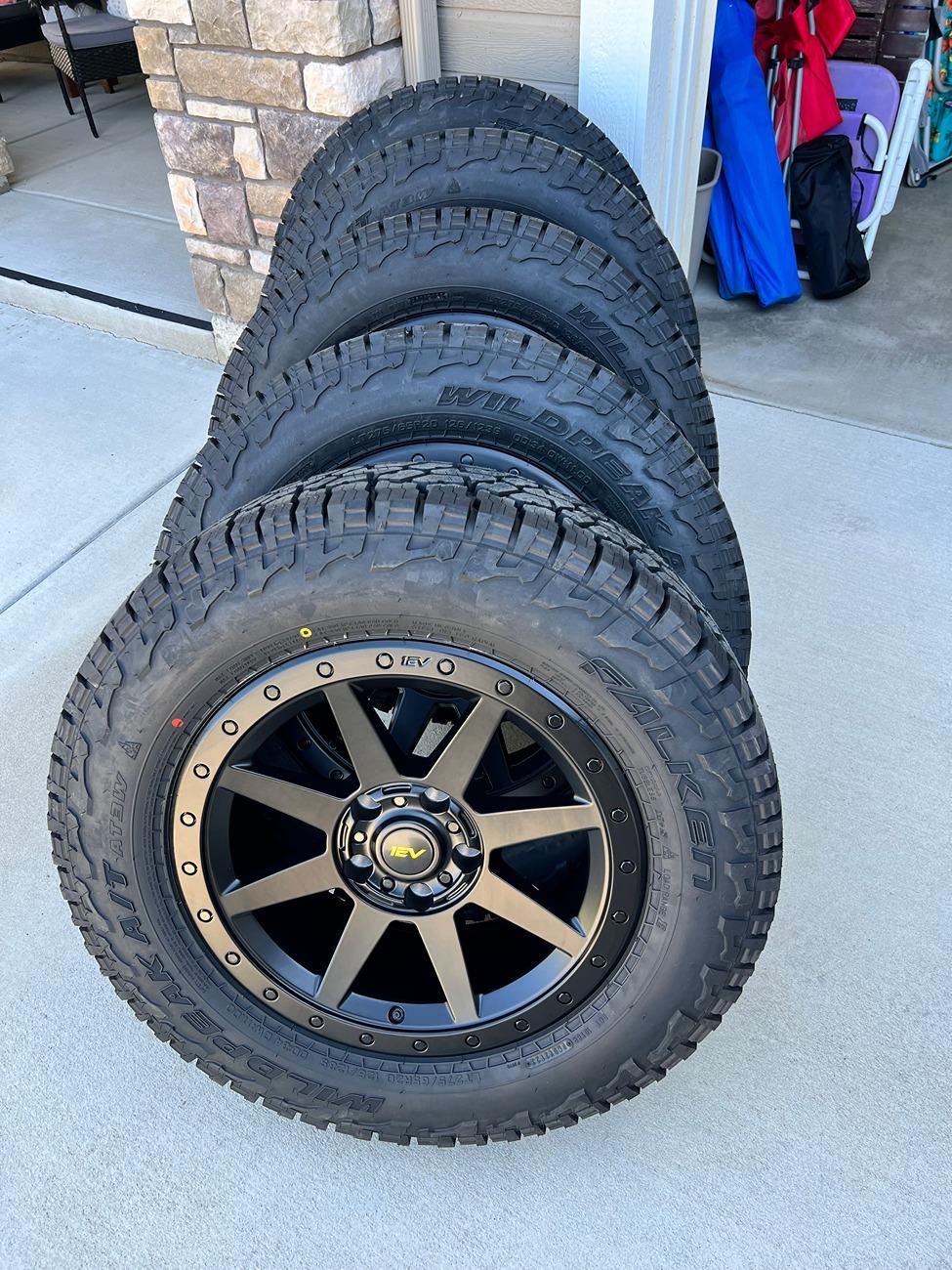

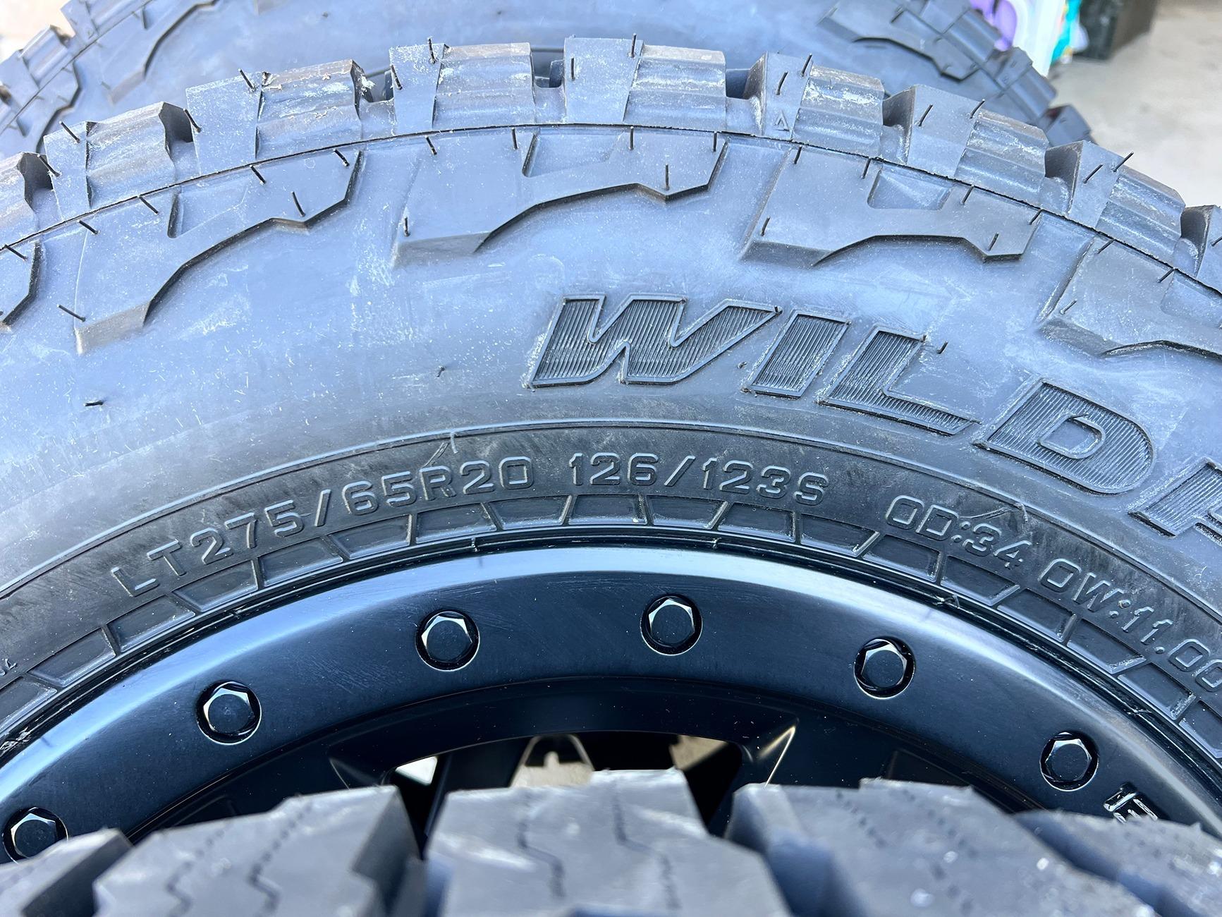

We took delivery of our R1S (Gen 1, Quad, Large) on Sept. 30, 2023 and made a beeline directly to Discount Tire to take off the 21” road wheels and put on a set of (5) of the EV Sportline R800 with the Falken Wildpeak A/T3W in the OE size of 275/65R20. Why the Falken Wildpeaks? This discussion thread is exhaustive, but extremely informative, and solidified my decision for these tires. 11 months later, and I don’t regret it!!
Rivian R1T R1S On track to get 50-60k+ miles tread life from Falken Wildpeak A/T3W tires! Big Blue and Family
“Why 5 All-Terrain tires?” you ask? First, they look SICK!! Also, I do some REAL off-roading every few months, so AT tires and a full-size spare were a must. I live in Boise, ID and we get a fair bit of snow here, so the 3 Peak Mountain Snowflake rating is a good idea. The OEM Pirellis have thin sidewalls compared to all other AT tires on the market (see the weight differences below) and they start at 14/32” tread depth. The biggest reason for choosing the Wildpeaks over BFG KO2 or Toyo Open Country was the starting tread depth of 18/32” vs. 15/32” for the KO2 (and others). That added tread depth means a massive difference in usable life!

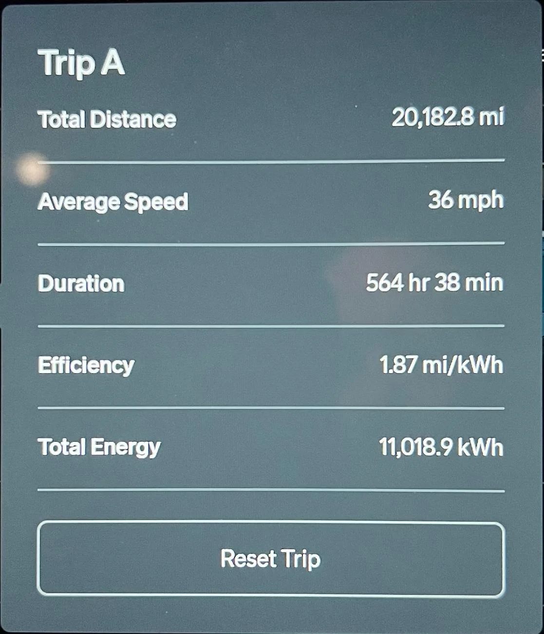

“But what about efficiency?” you ask? The R800 wheels are about 6 lbs lighter than the OEM 20” AT wheels from Rivian. The Falken Wildpeaks are about 17 lbs heavier than the OEM 20” AT Pirellis. At a net increase of about 11 lbs per corner, I knew I was going to take a big hit on efficiency. But since I’ve never even driven around on the OEM tires, I have nothing to compare it to except the efficiency I’m seeing others achieve. I also run at about 63 psi to try to reduce the contact patch a little bit. During the first 5-6 months of ownership when it was cold here, we generally saw about 1.75 mi/kWh. Once it started warming up, we started to see about 1.95 mi/kWh. Over the 20,000 miles total and almost 4 full seasons, we’ve averaged 1.87 mi/kWh. Electricity in Idaho is CHEAP (about $0.10 - $0.12 per kWh), so the efficiency losses aren’t really a big cost factor for daily life. The efficiency has really only been a problem on I-80 in Wyoming where the 212 miles between Evanston & Rawlins charging stops meant I had to charge to 97% at the EA stations and get creative by drafting close behind a semi for 100 miles of the stretch.
Did you have it reprogrammed for stock 20"? 21s are 33" and 20s in that size are 34". I'm also running AT3W on my AT wheels but a size lower to match 33" so speedo is calibrated right.
Going up would actually make it more accurate, but you range estimate will be pretty off.
