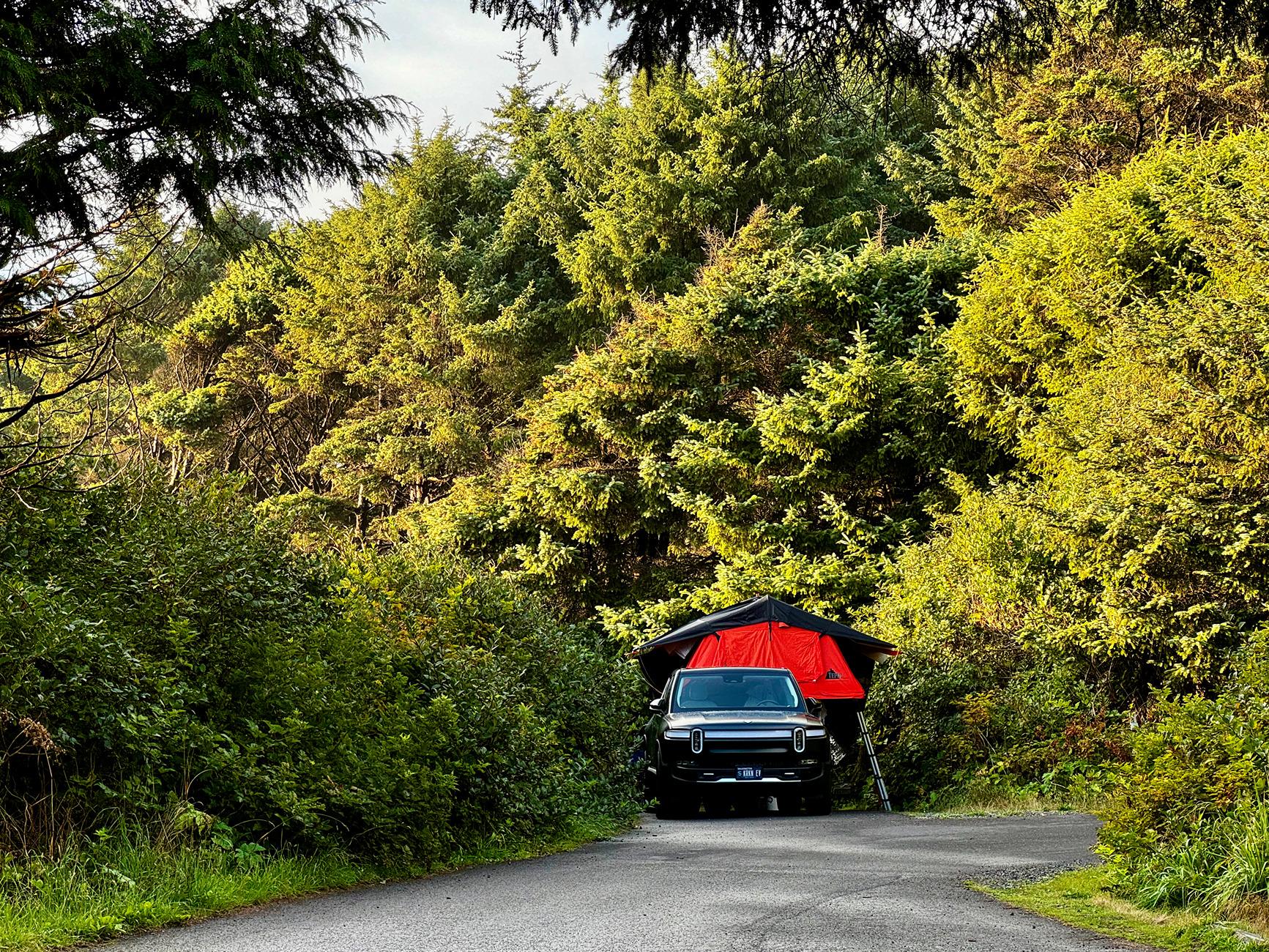

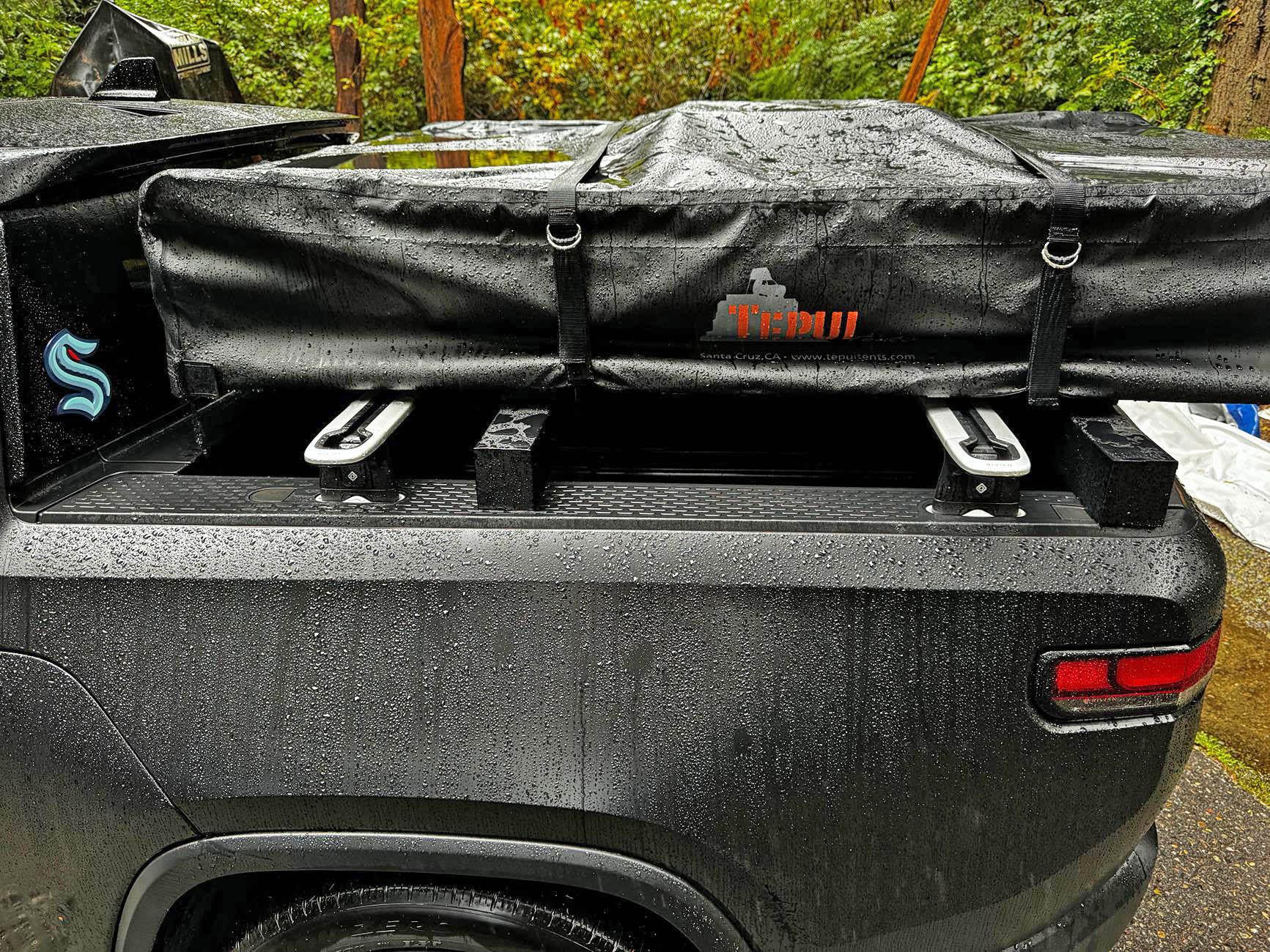

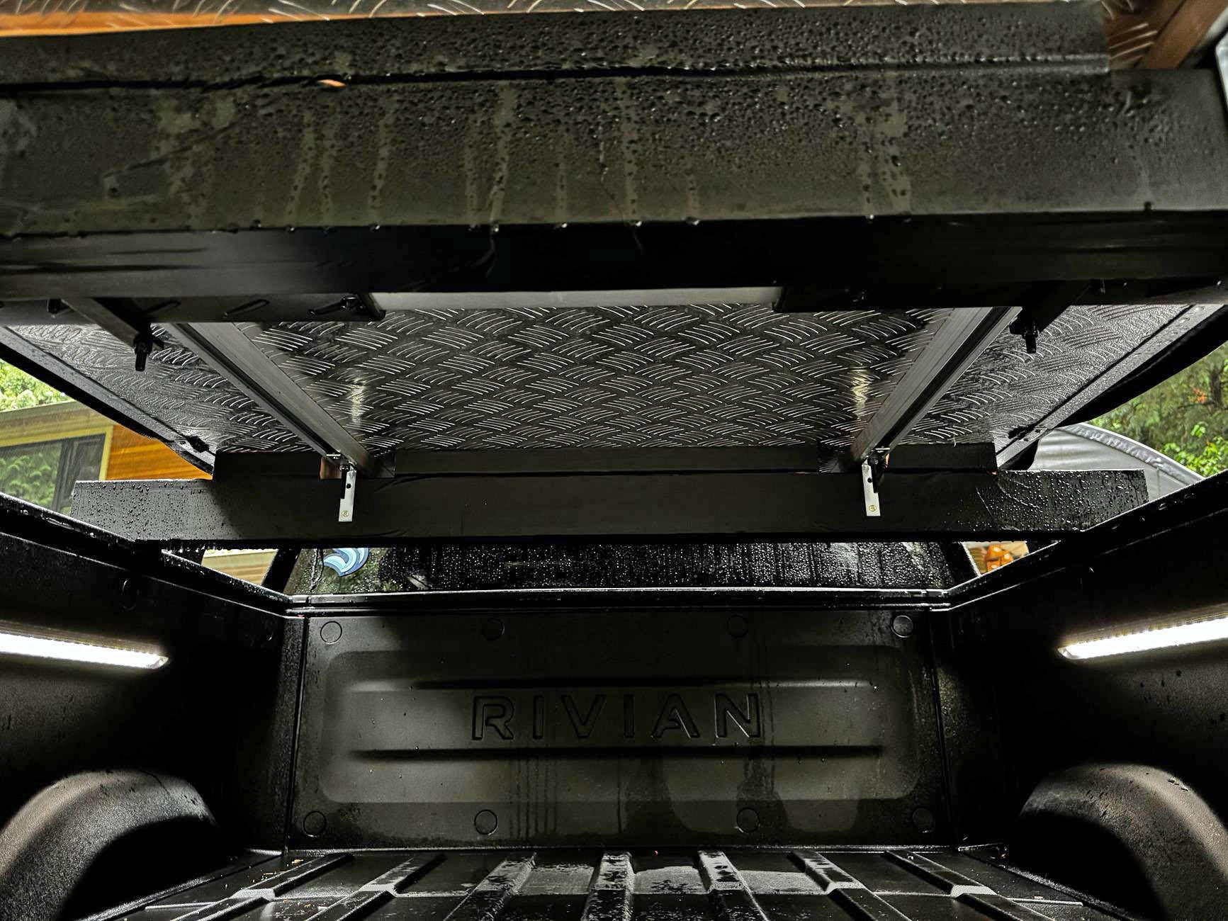

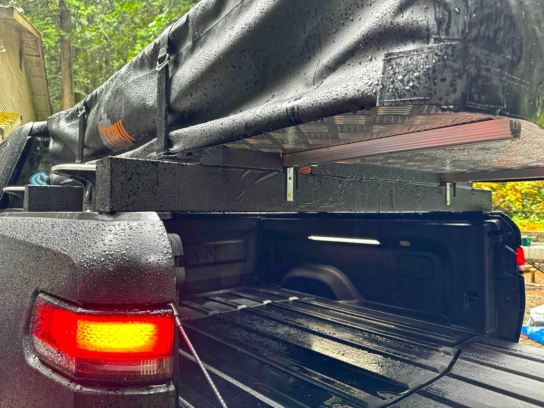

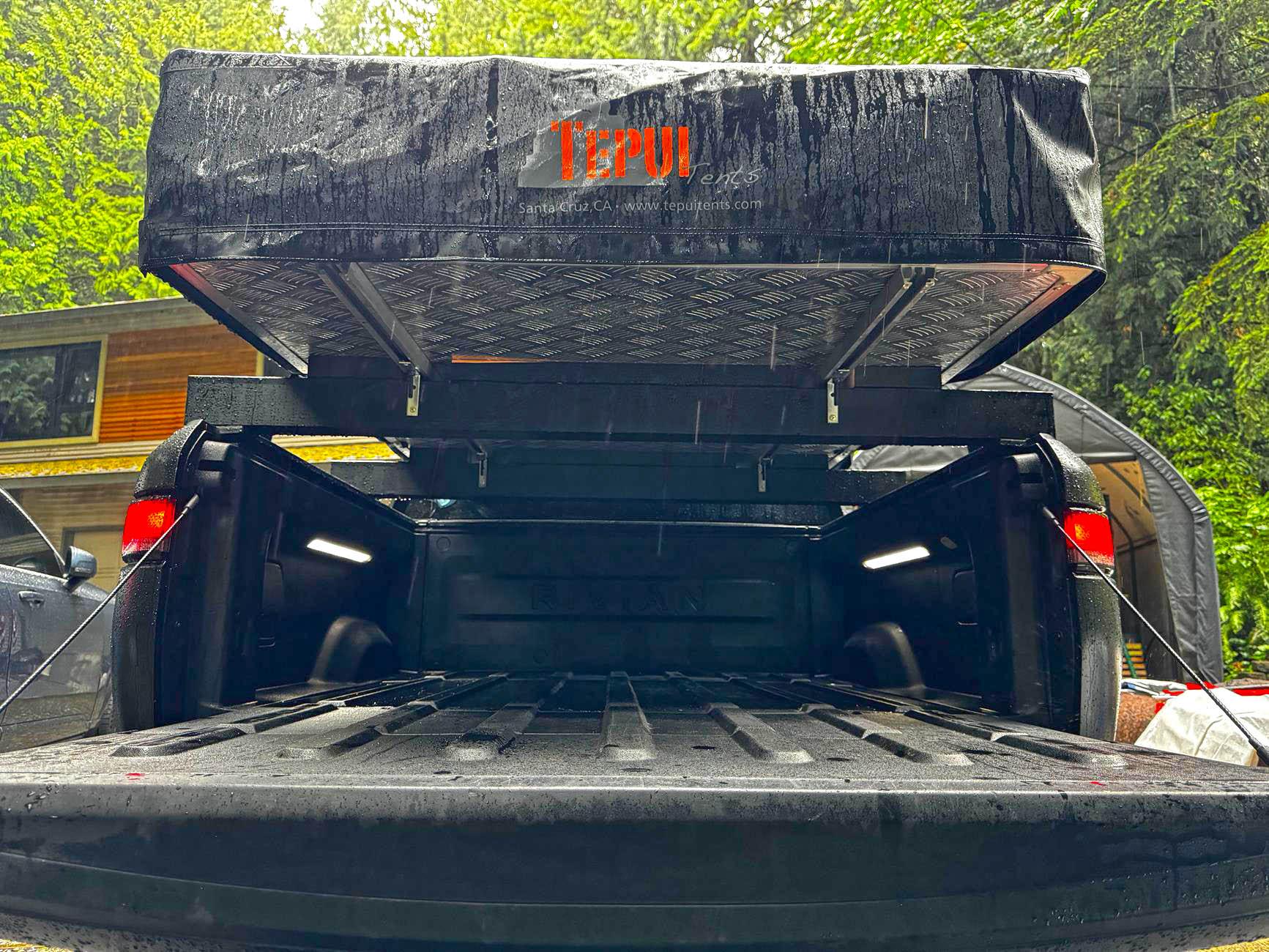

I was taking the kids over to Kalaloch, WA for a 4 day camping trip and since the weather was turning wet very quickly I purchased a rooftop tent on craigslist last minute. I initially mounted the tent, which weighs in at 225lbs, to the stock crossbars, which are rated for 250lbs dynamic and 600lbs static, but there was NO WAY that was going to work. The crossbars were flexing with one person in the tent. As a temporary solution I glued and screwed a couple of 2x4's together and covered them in black vinyl to weatherproof and hide my janky setup. ? This took the load off of the crossbars but still allowed me to use them as attachment points . Ultimately it worked out great with no flexing issues. I'm curious what other people have done for rugged crossbars without spending almost $4000 for a bed rack system from Overland?

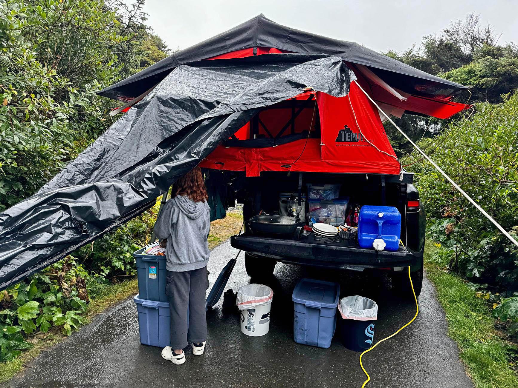

It was also fun testing out some of the Rivian camping features like auto-leveling and power management while using these 120V power outlets to cook meals like French Toast (see pics). #RoughRivianCamping ?

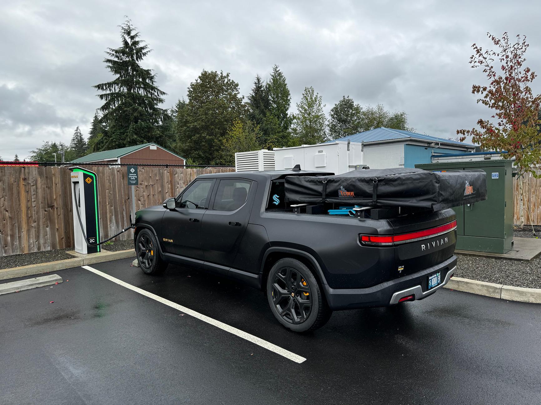

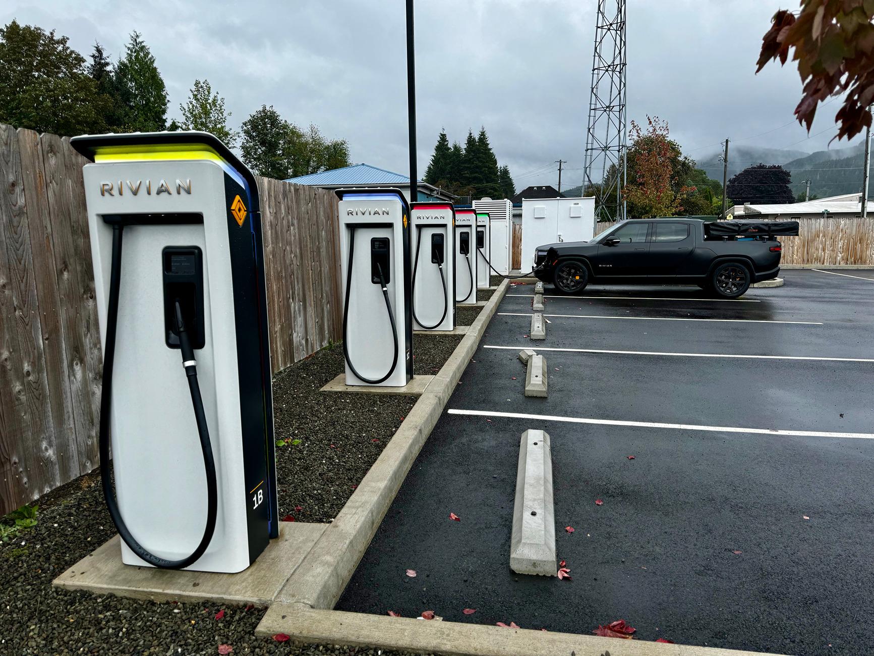

Here are some pics of my setup and a couple stops at Rivian Charging Network stations along the way on the Olympic Peninsula.
Rivian R1T R1S First camping trip with Tepui Kukenam XL Ruggedized SKY 4 Tent on R1T IMG_1521
Rivian R1T R1S First camping trip with Tepui Kukenam XL Ruggedized SKY 4 Tent on R1T IMG_1535
Rivian R1T R1S First camping trip with Tepui Kukenam XL Ruggedized SKY 4 Tent on R1T IMG_1646

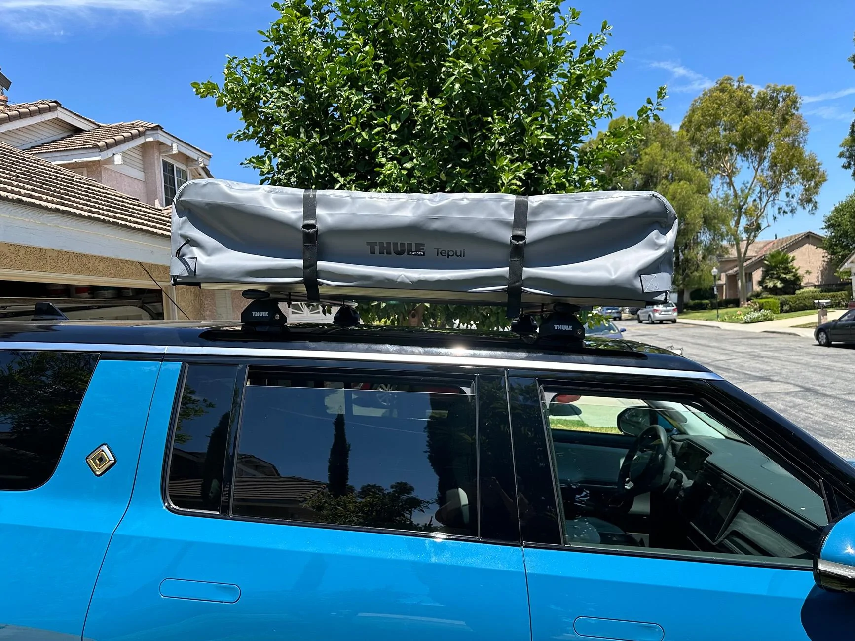

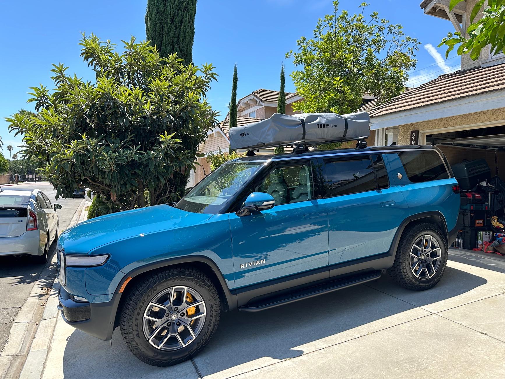

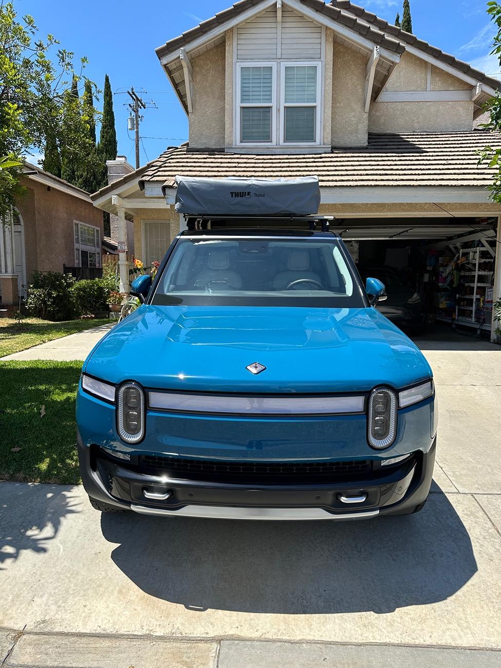

I use the Thule Wingbar Evo 135 (53”) as my crossbars. I also have a Thule Tepui but mounted on my R1S. I did not feel any flexing while in it and once set up, the tent worked great. If that doesn’t work, consider flipping the tent so that it covers more of the edges and not just the center of the bars. The ladder would be facing the back, though. Options.

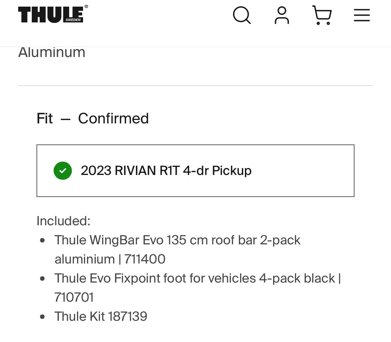

Yeah it's not a bad idea to turn the tent 90 degrees but then I would kind of lose the use of the tailgate with the folded out part of the tent in the way.
Thanks for the info on the Thule crossbars. I'll check them out. What attachment brackets do you have for the Thule crossbars?

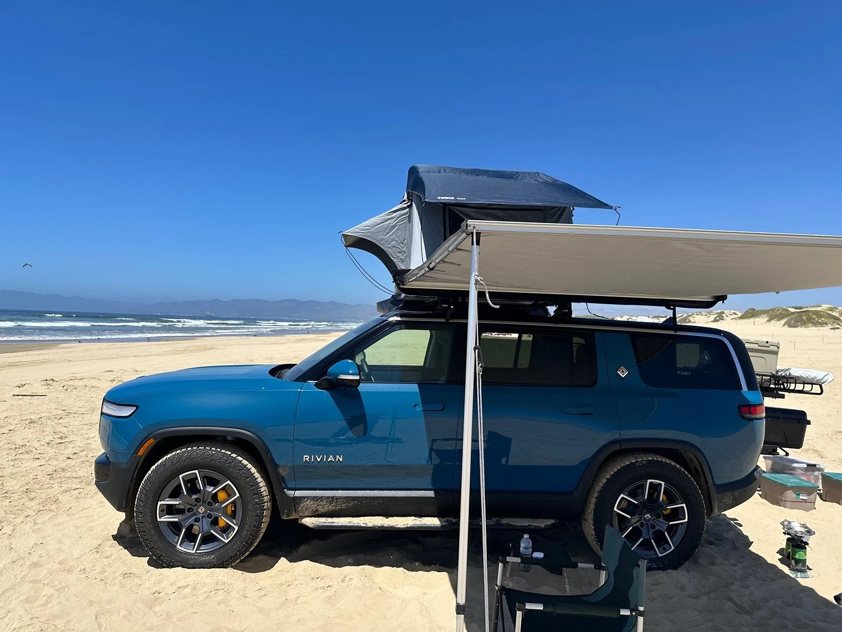

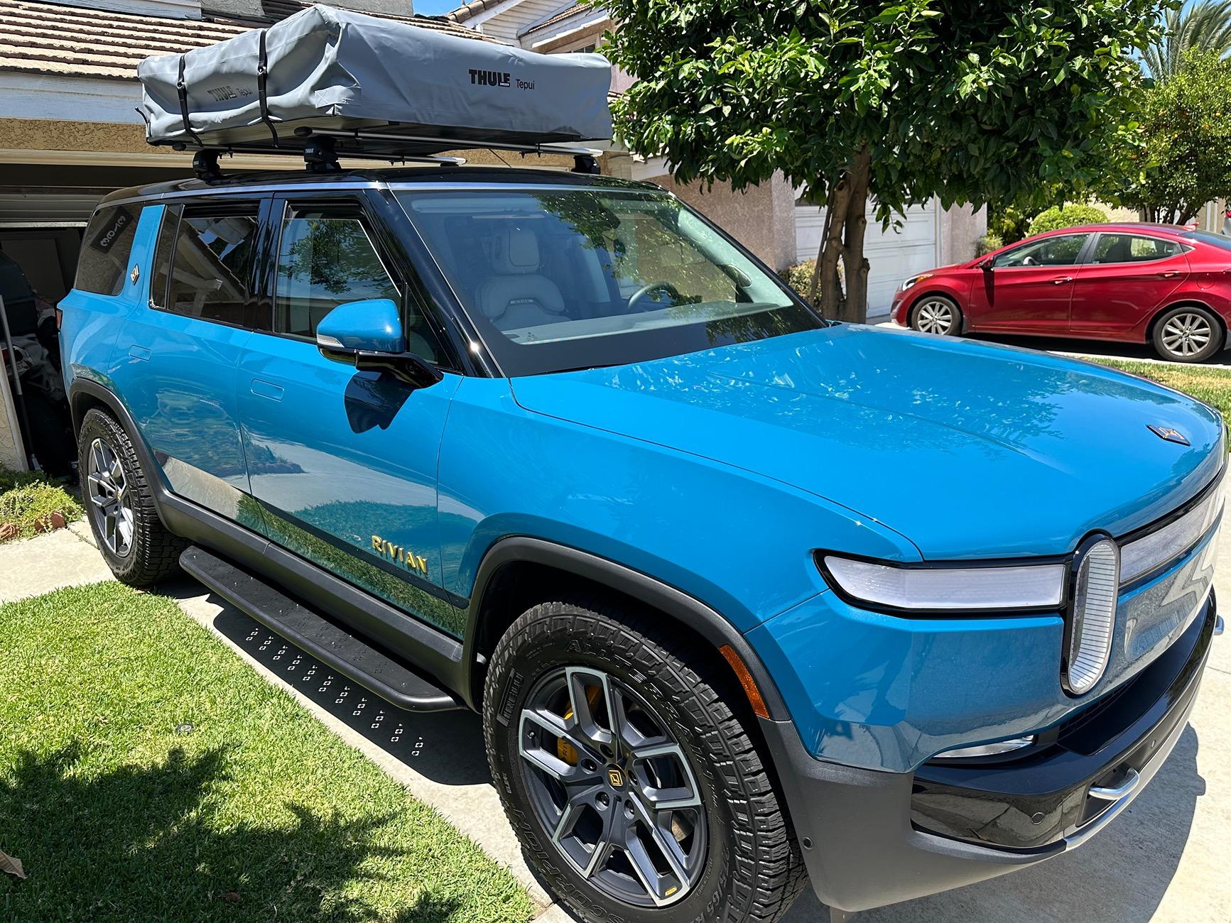

See screenshot for what I got. Good timing; seems like this kit is on sale at Thule.com and Amazon now. 20% off.
I like the Thule crossbars. They will take longer to put on than the Yakima ones from Rivian but they are much more sturdy and have no play at the fix point. Very stable, which is probably what you want when carrying so much weight on an expensive vehicle. I added pics of my set up. I have it shifted to one side so I could add a Yakima SlimShady. The set up worked great.

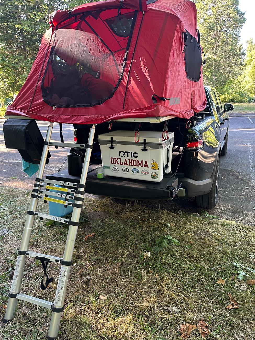

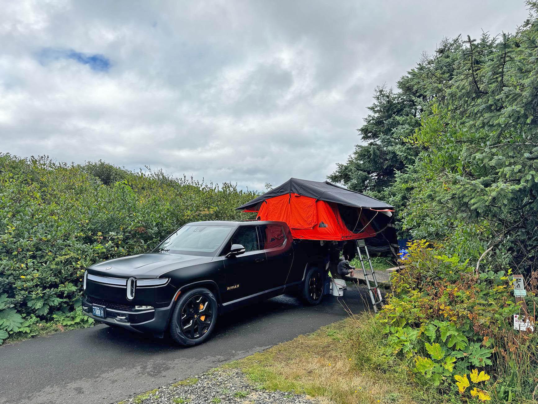

With a tent that big, I’d change 90 degrees so the ladder is on the back. It may seem a bit inconvenient, but if it rains you’ll have a covered area underneath with your tailgate as a cooktop/shelf. Although it’s certainly less convenient for loading and unloading gear into your bed if the tent is deployed, it also has the benefit of only increasing the length of your footprint rather than the width. For example, I oftentimes camp at the start/finish of trail races and I can do it while only taking up one parking spot.
Rivian R1T R1S First camping trip with Tepui Kukenam XL Ruggedized SKY 4 Tent on R1T IMG_0722

Thanks for sharing, the photos are great sounds like everything worked out including your “macgyver” set up. ????????
Thanks Robin. Yes, my MacGyver setup worked a treat. lol
