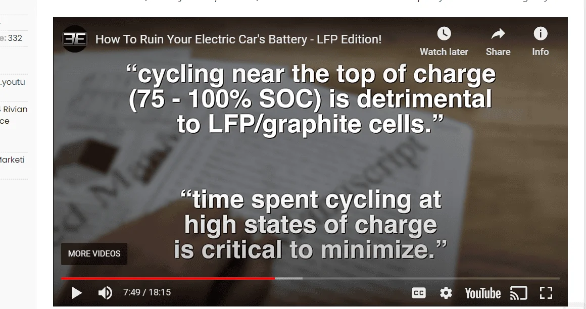

Video Description:
Electric cars are becoming increasingly popular, but a common concern remains for many owners - what about the battery? Most batteries used in electric cars today come with one of two major chemistries: Nickel Manganese Cobalt (NMC) or Lithium Iron Phosphate (LFP). LFP batteries are rising in popularity as they're cheaper to manufacturer, and more sustainable since they use more common materials. Each chemistry has unique properties, and benefits from specific best practices, as it relates to making the battery last for a long time. This video will look at the latest research and discuss four major best practices for LFP batteries when it comes to capacity retention and longevity.

What battery chemistry is in gen 2?
The Standard battery is supposed to be LFP and Large, Large+, Max are NMC chemistries.

So similar to NMC?
He says it’s actually the opposite. Instead of ABC (always be charging) LFP should only be charged when required (CWR I guess?). So what it sounds like is you treat it like an ICE truck. You drive it until you hit about 10%, then say “balls, I need to charge”. You then get home and plug it in with a charge limit of 100%.

tl;dr:
* Gen 1 or "bigger than smallest battery" Gen 2: Set daily limit as low as is reasonable for your driving habits (70% is Rivian's recommendation,) charge to 100% sparingly (only when absolutely needed for a trip, charging to it as close to departure time as possible) plug in and charge (to that daily limit) as often as possible.
* Gen 2 smallest battery: Charge to 100%, but don't charge as often, let it get closer to empty between charges.
* All: Don't let charge drop to 0%
* All: When storing the vehicle for a long period (multiple weeks) set max charge to 50% and leave plugged in, then charge to your normal max (per above) before using again.
