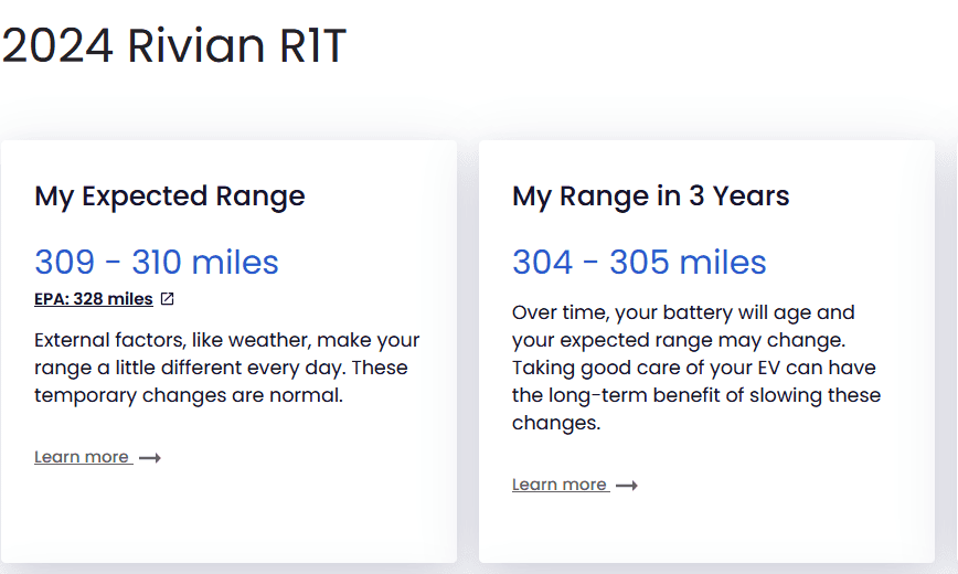

Though my hardwired EVSE can charge at a higher rate, I have it set to 40 amps. I also have the upper SOC limit set to 65% for local driving, and recharge once I drop below 30%. I've only charged above that a couple of times when we planned to head to our small cabin in the Poconos, a round trip of just under 200 miles. I'm only a few months into Rivian ownership, so a pretty small sample size, but according to Recurrent, my Gen 1 Large battery, at a 54% average charge level, is doing pretty well:
Rivian R1T R1S Engineering Explained: Best practices tips to slow down LFP Battery degrading & extend SOH life 1724517852184-q5
