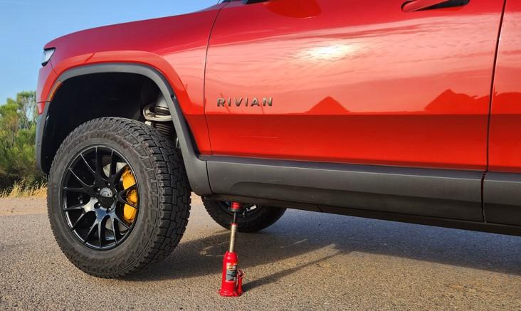

I got the rivian spare recently, it was easy to get it. It took 15 min to install. Since it fits underneath, my preference was getting that.
For air - amazon has it too. https://www.costco.com/fanttik-s100-apex-powerful-portable-air-pump-%26-tire-inflator-with-power-bank,-black.product.4000230430.html
For pucks - jackpucks.com
Jack -
https://a.co/d/08SCq23
Thanks for the recommendation for our jack pucks! We've put over 6000 pucks in Rivian owners hands and they are now at over 100 commercial tire centers.
