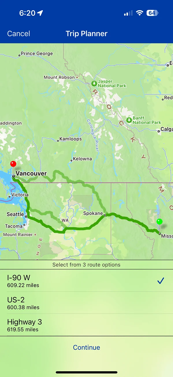

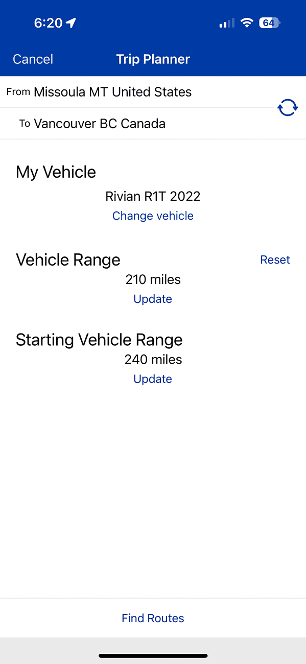

Open that and you can enter your range or how long you are willing to sit and drive in one shot, 210 miles for me. Also enter your destination.
Rivian R1T R1S How to use PlugShare for route planning IMG_3397

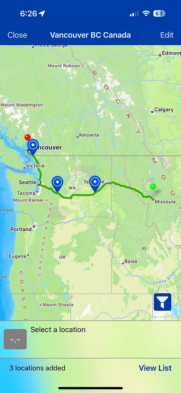

It will give you a choice of routes,
Rivian R1T R1S How to use PlugShare for route planning IMG_3398

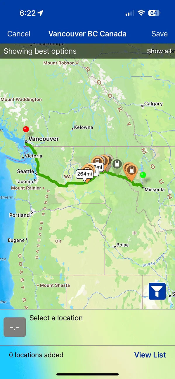

Select the one you want then you get a screen of your routes and the chargers around range you put in. This is why I like PlugShare planner, I can select the charger I want at the point in the trip I want to stop. You can do all the normal PlugShare filtering by network, score, speed, etc. Even if you use ABRB you are likely going to check PlugShare for reports anyway so why not just to it all in PlugShare?

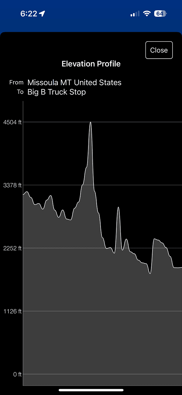

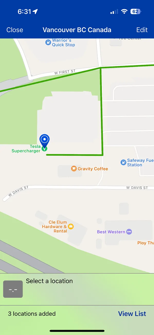

Select the stop you want and at this point you can see an elevation proflle which may influence your driving distance.
Rivian R1T R1S How to use PlugShare for route planning IMG_3401

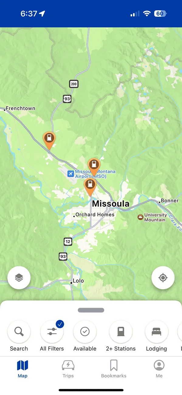

You can zoom in and see other stores in the area for refreshments.
Rivian R1T R1S How to use PlugShare for route planning IMG_3405

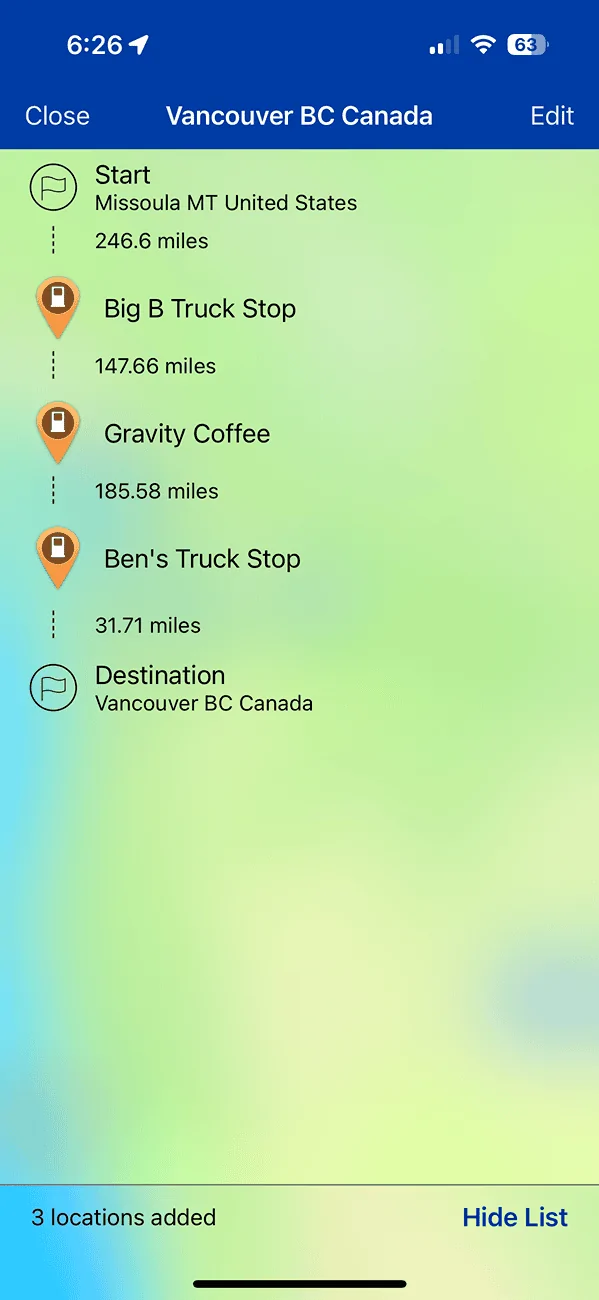

Once you have your first stop you can continue on to the next in a similar way. When finished you get the trip summary which is easy to edit.
Rivian R1T R1S How to use PlugShare for route planning IMG_3403
Rivian R1T R1S How to use PlugShare for route planning IMG_3404

Great write up. I used it once for a short trip with only 2 charging stops, and the sheer simplicity of being able to use one app was definitely nice.

But, you enter the range you expect into PlugShare. It is only as good as your inputs.

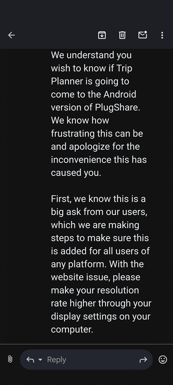

Confirmed: Android app version v4.28.1 (June 27, 2024 update for me) does not have trip planner capability. Also, I cannot create a trip at www.plugshare.com on my phone because it says I need a minimum display width of 1024.
Rivian R1T R1S How to use PlugShare for route planning 1000007471
Edit: I sent an email inquiry to them asking whether they plan to add the trip planner to the Android version...
Update: noncommittal reply from developer. "Working on it."

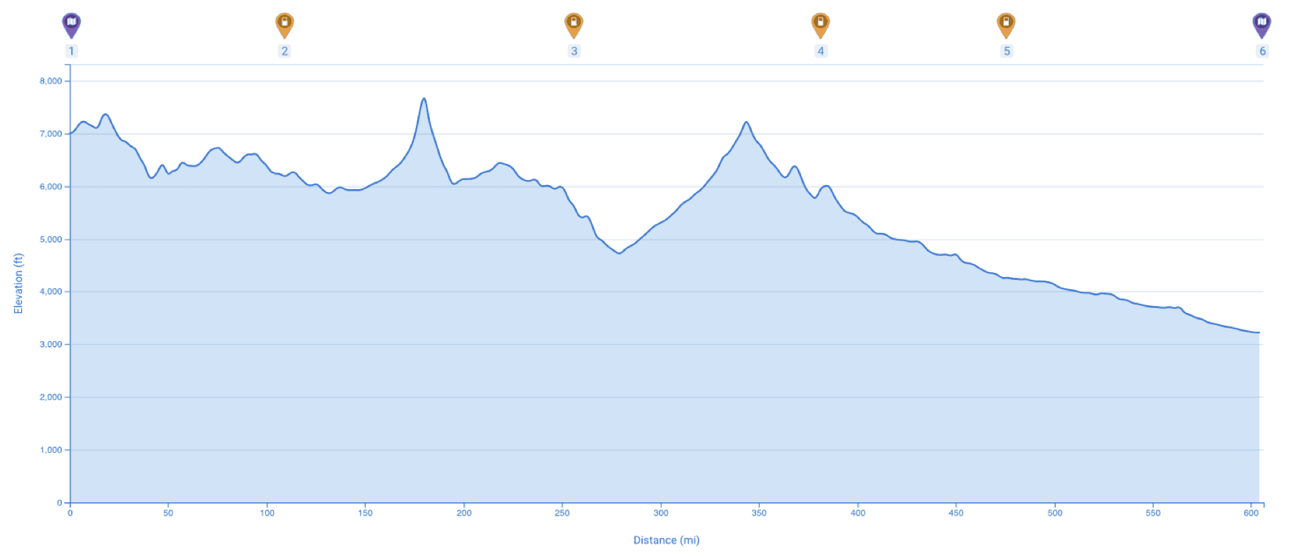

You can do trip planning on a Laptop at www.plugshare.com. Some of the trip summary outputs are better for me in the web version, like full trip elevation profiles with charging stops highlighted like this;
Rivian R1T R1S How to use PlugShare for route planning 1720474454114-od
