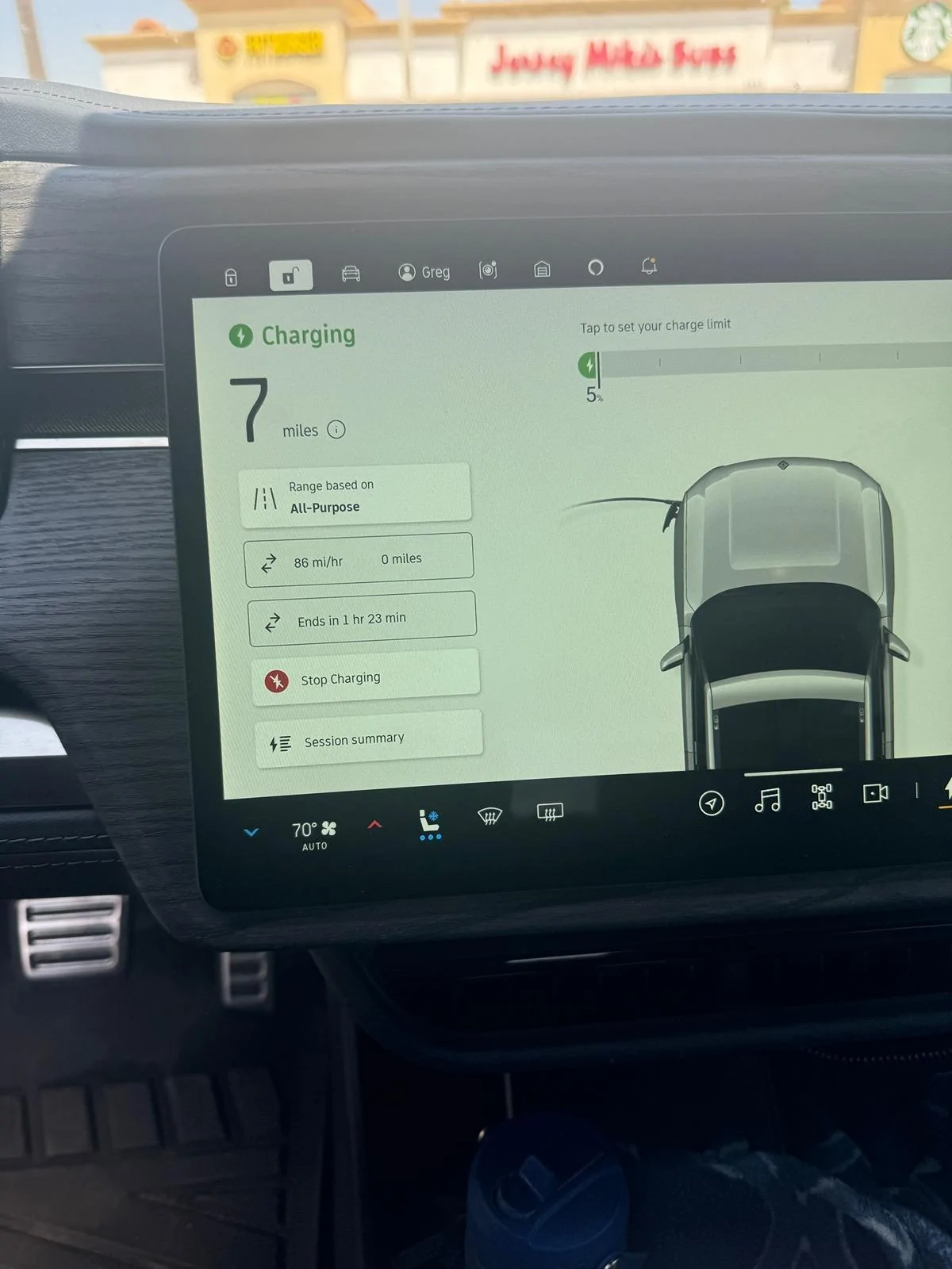

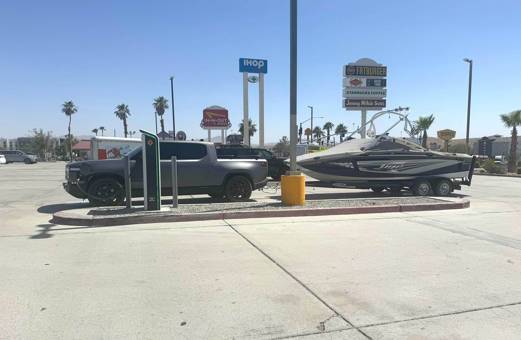

I needed to bring my boat home from the Colorado River area near Topock / Needles to get some work done. It is a 250-mile trip, and this was the first time I had towed a long distance where I would need to charge multiple times. I left Pirate Cove Marina at 92%. Here is what my experience was like.
The Good-
  • The R1T is the best towing vehicle I have owned! I have had a Ford 250s with V10s, a Ram 1500, a Toyota Tundras, and a GMC 1500 with a 6.2 L engine. I couldn't even feel the boat behind me and had to watch my speed as I could have easily been going 80 mph.
  • RAN with a trailer spot in Barstow and next to the world's best Del Taco (IYKYK)
  • EA charger in Needles. There are 4 new chargers where you can pull in and charge up with a trailer still hooked up. The lot to charge is dirt but has a lot of room, so you can pull straight in to charge and then back out with ease.
  • The R1T self-levels and adjusts based on the trailer's weight, which in this case was 6,500 lbs.
The Bad-
  • Needing to unhook the trailer in Essex to charge as the charging station does not have any spots for a trailer
  • Unhooking the trailer erases the data needed when towing, so my mileage was off when I charged up, and I didn't get a great idea of how much charge I should have to get to my next destination; I got to the RAN in Barstow with 7 miles left.

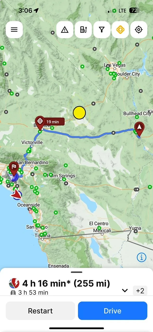

  • Navigation pushed me to Baker, taking Kelbaker Road, part of the Mohave Desert Reserve. That would be great in the fall, winter, or spring, but not in the middle of a heat wave at the start of the summer. Plus, it would add many miles to my trip. So I rolled the dice, ignored the navigation, and did a straight shot to Barstow. The yellow dot is where it wanted to take me to charge.
  • Rivian R1T R1S Towing my boat through the CA desert -- the Good and the Bad Screenshot 2024-06-20 at 3.06.26 PM

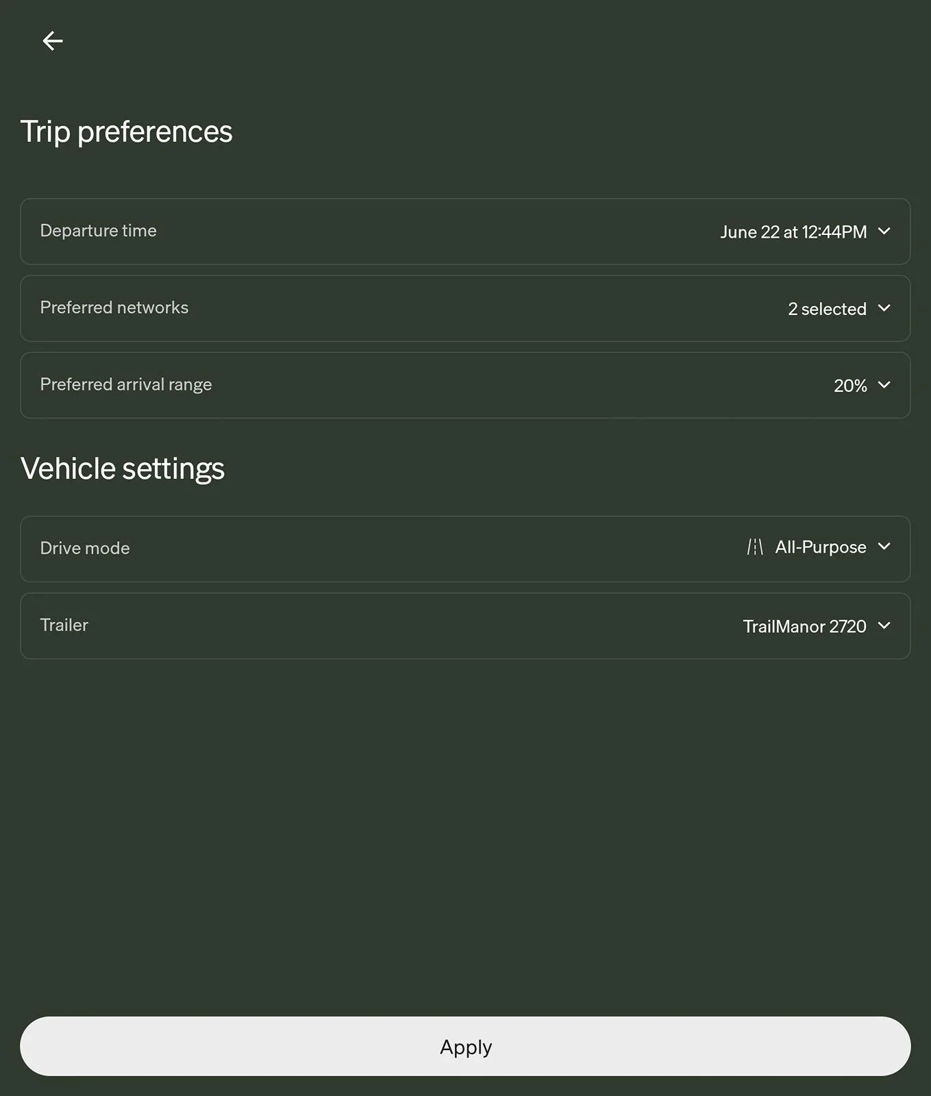

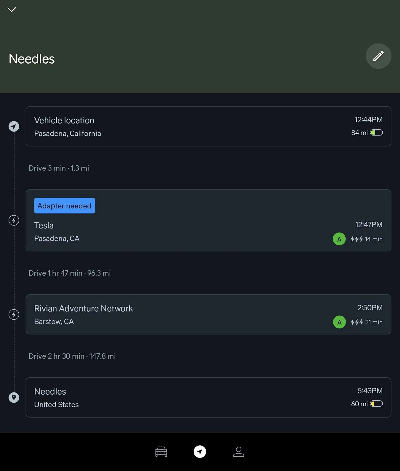

Great write up! Wow that's a hole about disconnecting and the nav but I you can select a trailer in the app and see how long you need to charge. That's at least a fix for now. Take a look and see if the nav allows selecting a trailer for planning on the same way.
Rivian R1T R1S Towing my boat through the CA desert -- the Good and the Bad Screenshot_20240622_124451_Rivian
Rivian R1T R1S Towing my boat through the CA desert -- the Good and the Bad Screenshot_20240622_124542_Rivian
