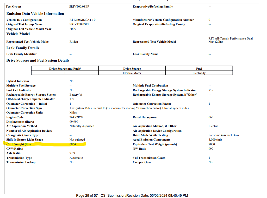

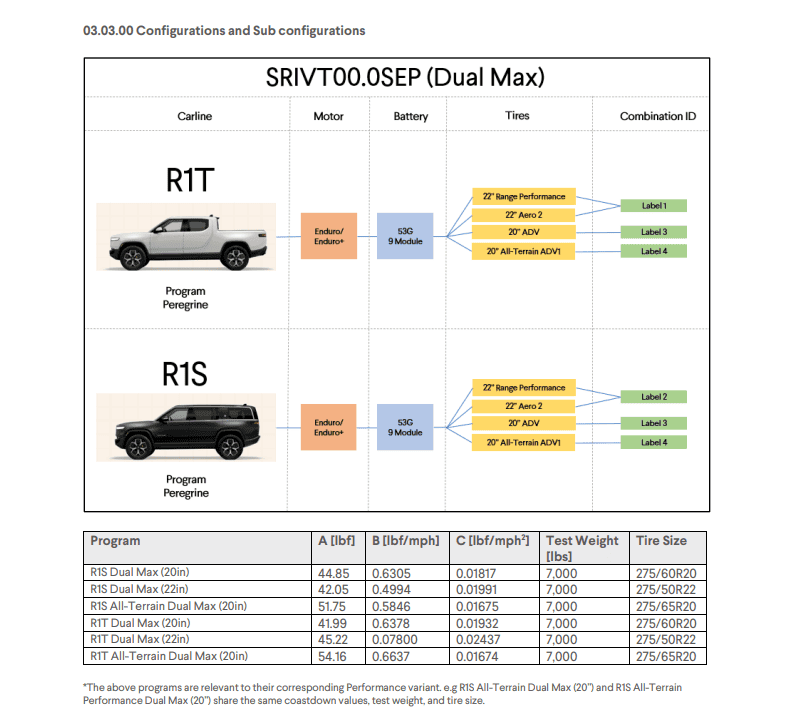

I'm surprised I haven't seen anyone mention it yet, so I thought I do so. We previously had the 2025 R1 DUAL STANDARD models confirmed with the EPA certificate filings dated 4/10/24. We now have the Dual Max, All-Terrain Dual Max, Performance Dual Max, and
All-Terrain Performance Dual Max 2025 models confirmed with the EPA filing dated 5/18/24.
To get to the reports to go https://dis.epa.gov/otaqpub/ and select Rivian in the manufacturer block then click on the Search button at the bottom of the screen (not the one at the top of the screen). You'll see all the recent filings. There are applications for certification fillings by Rivian and corresponding certificate issued fillings by the EPA in that list.

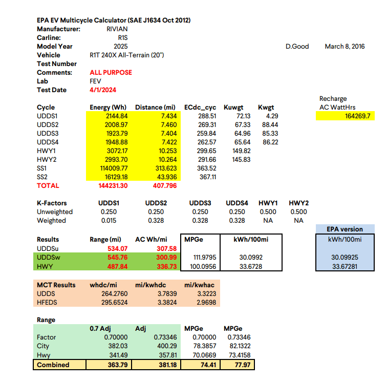

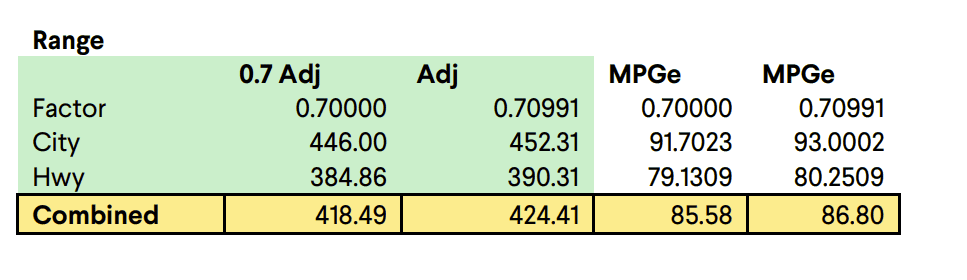

Looks like the R1S DM Max Pack is going to get a significant bump in range/MPGe on the 22" aero wheels:

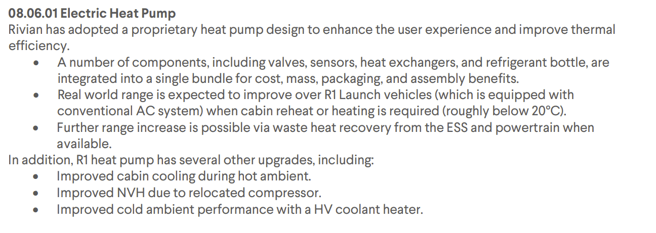

Also, has this info about the heat pump been posted before?
I’m confused how you read it, so do you follow the 418 number, or the 424, both of which are excellent…
Yes. On the standard pack EPA docs at least. Nice to see it confirmed on the large/max dual as well.
