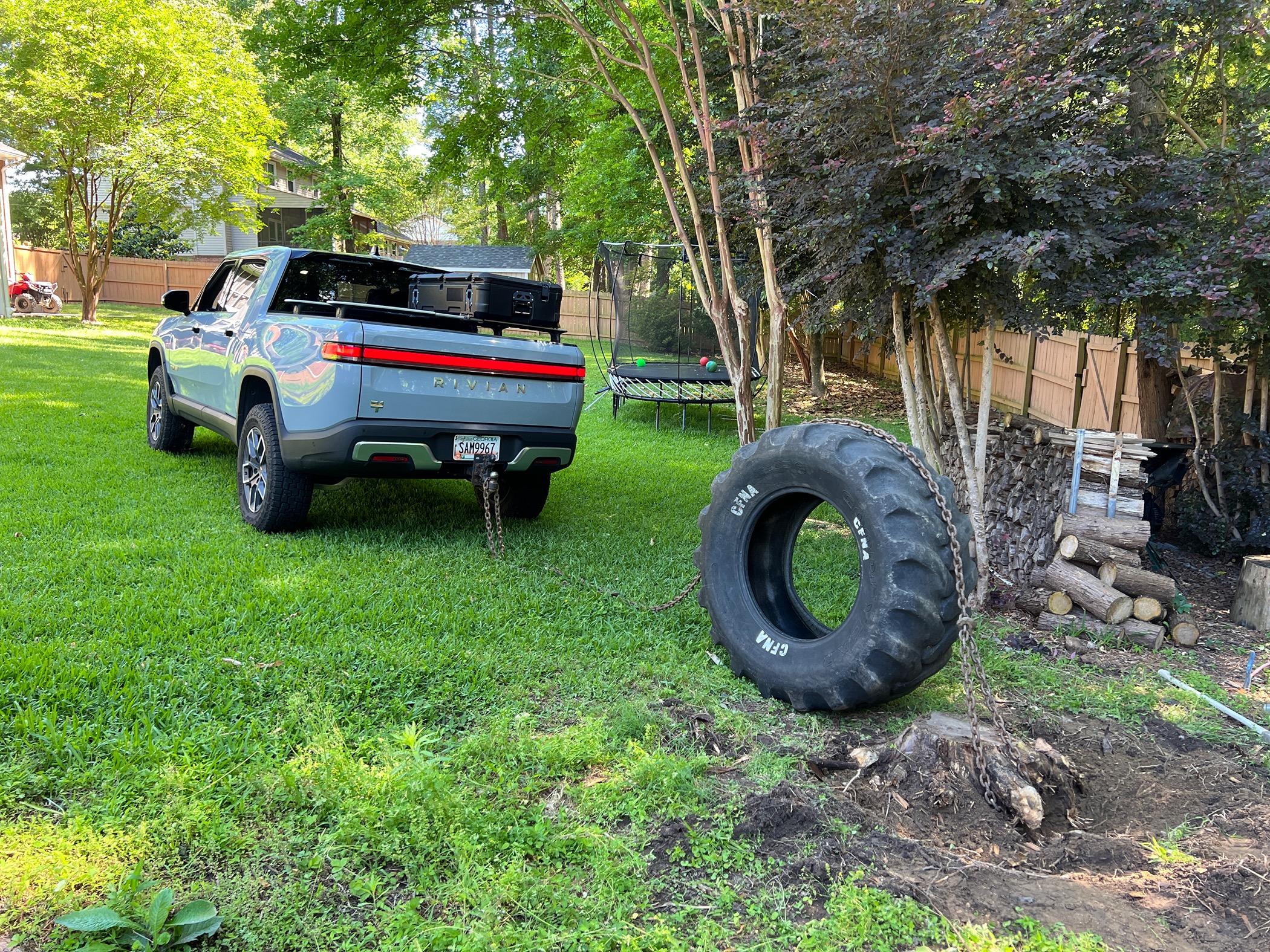

Shouldn't pull on a ball hitch like that.

I haven't done a whole lot of stuff like this, so I'd love some insight: what are the advantages/risks associated with using the trailer hitch vs. the front tow hooks or vice versa? Thanks!

It’s not the hitch mount, it’s the ball, specifically. They aren’t rated to pull things in weird directions, and can snap off at the weak point on the bottom. Then they become potentially dangerous projectiles. Use a hitch-mounted recovery point in the future.

Thanks! I'll keep that in mind if/when I need to do something like this--very useful insight.

Here's a photo of how I rigged it. Grabbed a large root on the backside of the stump.
I did tear up my grass a bit when all 4 tires spun on my 1st attempt. Unlike the hair on my head, it'll grow back.
Just FYI, for all those folks watching this and thinking of all the things that could go wrong, I've done this (with my 1986 F250) at least 2 times prior. I knew what to expect. I'm a huge fan of the tire method. IMO really helps in 2 main ways:
1. Redirects the force more upward
2. Helps cushion the chain

It doesn't have to snap during this event to be a problem either, if the metal stretches out it could lead to eventual fatigue failure while towing.
