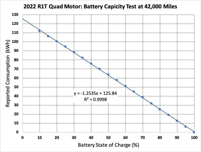

I got my Quad Motor Large Pack R1T in July, 2022. VIN in the 8000 range. Been driving the heck out of it and loving every mile. I have the 21" road tires.
Yesterday I attempted a battery degradation test for the first time. My procedure was as follows;
1. Fill battery to 100% as indicated on main GUI screen in the Rivian cockpit
2. Reset the "Trip A" odometer
3. Drove on a mixture of 70 mph interstate and 60 mph rural highways.
4. Monitored the state of charge on the main screen and at every 5% interval we recorded the miles drive and consumption data in the "Trip A" odometer
5. Pulled into my garage with 9% remaining on the battery. (didn't really want to run it down to zero.....)
6. Charged to 100% again and recorded the energy added to the battery.
This gave me two estimates of the energy in my battery at 100% state of charge.
The first estimate is from the consumption data recorded at every 5% SOC interval from 100% to 10%. I fitted a linear line to the data points and then extrapolated this to 0% state of charge as shown in the graph below. This indicates 125.84 kWh would have been used from 100% to 0%. Rivian says the original usable battery capacity is 131 kWh. 131/125.84 = 0.9606 which says 125.84 is 96.06% of the original capacity of the battery or about a 4% degradation.

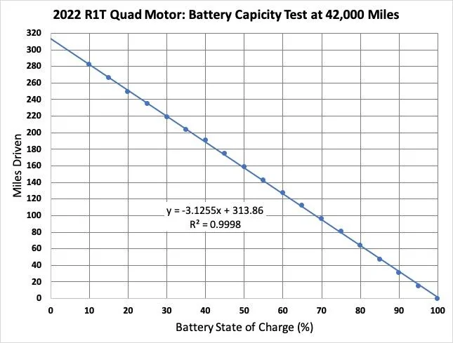

The miles covered at each 5% SOC increment in this test is shown below. Again extrapolating to 0% says my full pack range would have been ~314 miles. At the start of the test the vehicle computer said my range would be 315 miles! Almost exactly right!

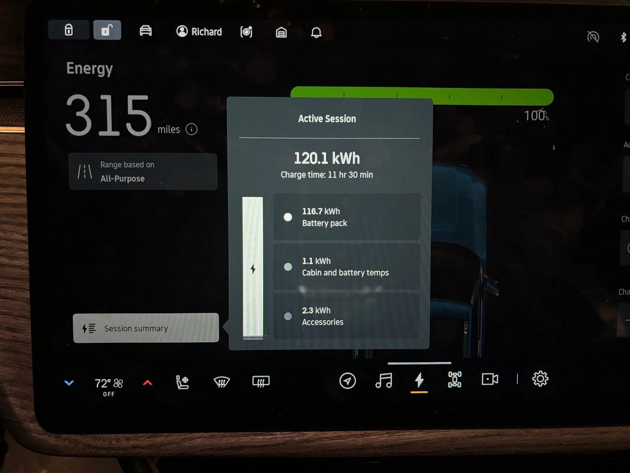

Method two comes from the reported energy put back into the battery when I charge back up from 9% to 100%. The Rivian user interface says 116.7 kWh were added to the pack. Dividing 116.7 by 0.91 gives the estimated energy that would have been added if starting from 0%. 116.7/0.91 = 128.24 kWh. This is 97.89% of the 131 original usable capacity. Or about 2.1% degradation.

The second method is probably more accurate but if we average the two methods the degradation is around 3% after 1 year and 10 months and 42,000 miles. Pretty good result in my opinion.

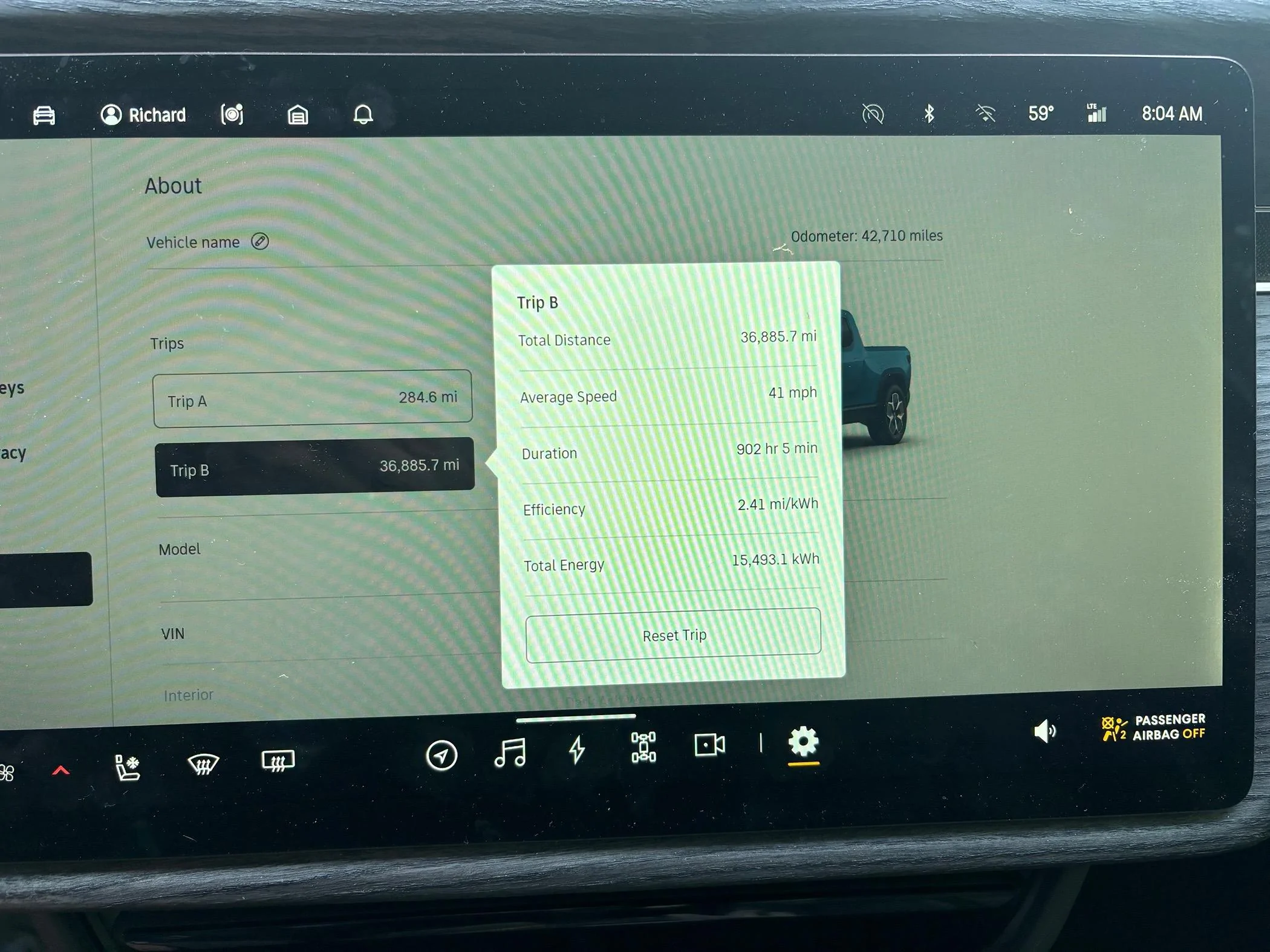

My Trip B odometer has almost 37,000 miles on it and my efficiency over that distance has been 2.41 miles/kWh

Very happy with these results. 3% or so degradation and the range estimate being spot on.
Overall I have had a very good experience with my R1T. Got 37,000 miles from my first set of tires. My powered tonneau has always and continues to work fine. The only issue I've had is a sticky charge port door which was fixed under warranty by replacing the actuator motor. I give my sincere compliments and thanks to the entire Rivian team.
