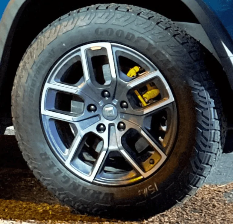

June 6 2024 Update: There's now a 20" 275/60R20 OEM Tire: Goodyear Wrangler Territory AT
Likely to have same/similar MPK to the 21" OEM, also looks like Rivian will discontinue the 21" option:
Spotted in March 2023:
Rivian R1S Test Car seen with Goodyear Wrangler ATs

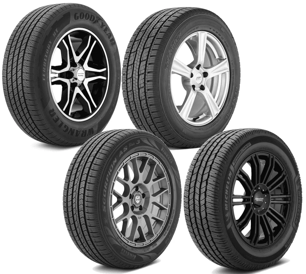

5 tires compared: Five (5) 275/60R20 [33"] Tires Compared: Defender, Territory HT, Geolander CV4S, Grabber HTS60, and Nomad Grappler
Highlight: Four high efficiency 275/60R20 tires rise to the top getting ~2.5 MPK:
General Grabber HTS60, Pirelli AS+3, Goodyear Wrangler Territory HT, and Michelin Defender M/S2:

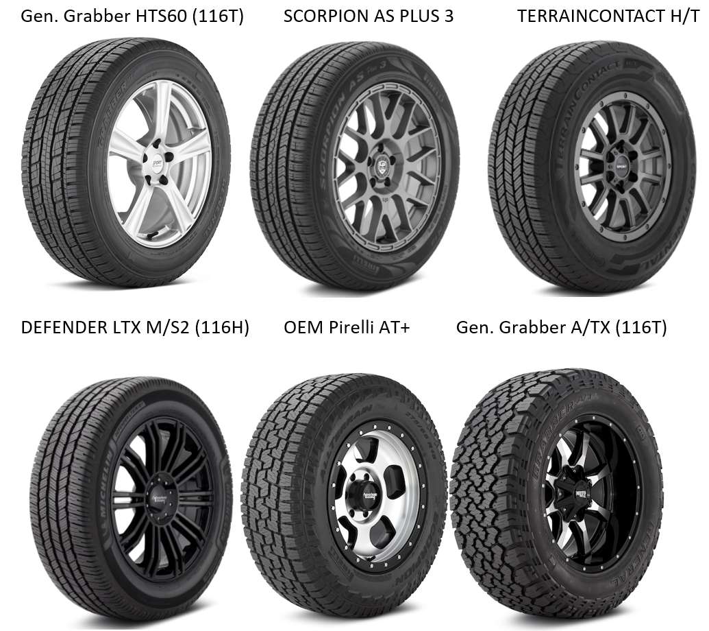

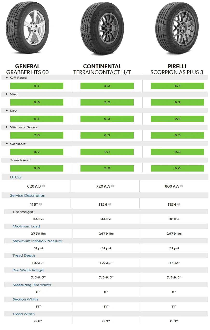

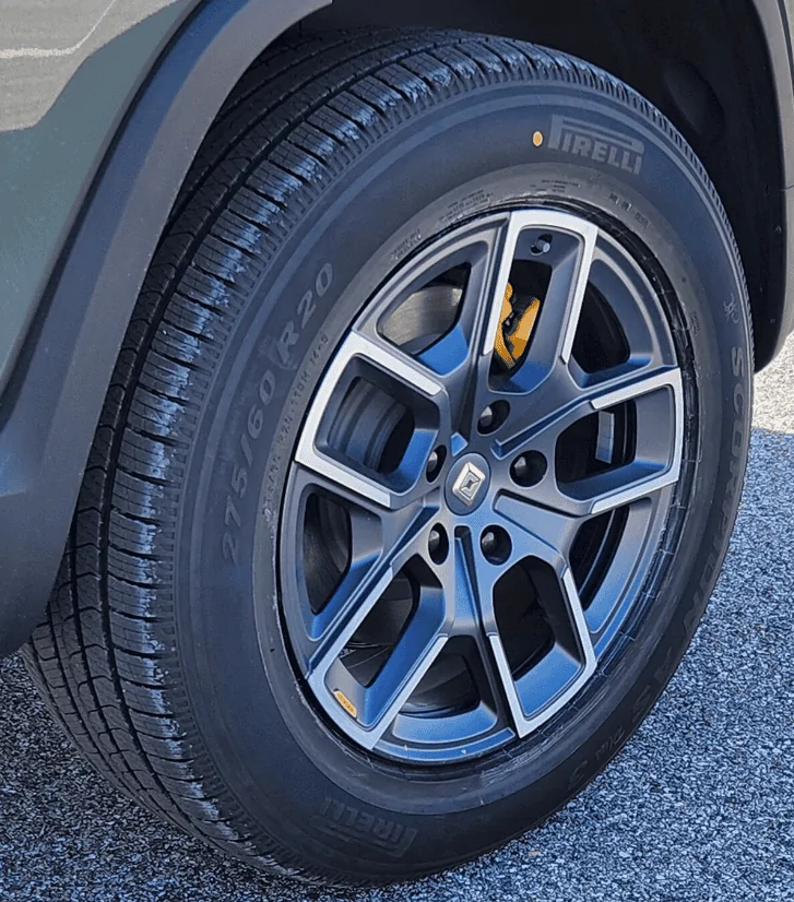

My top four choices come mainly from wanting a wider tire, they are in order:

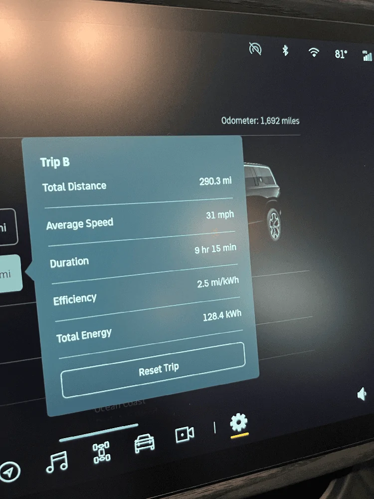

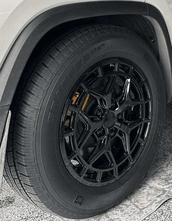

1) General Grabber HTS60 [320 m. Range; 620 AB] - Best efficiency/range and 116 (but only 10/32 tread - ~20k miles expected). Also a A/T tire in XL and D size (65 psi) available. Cost per mile of $0.05 for tires plus $0.15 for electricity. $200 per 1,000 miles operational cost. Wet stopping dist. - 140 feet; wet cornering 0.60 G-Force. (Photo source: LL75; Rims (32#) - Atomic Wheels AW09 - Gloss Black 20x8.5" +48 offset - $2,580.00 [~$2k w/ discount])
Rivian R1T R1S Affordable high efficiency 20" wheels and 33" tires options (275/60R20) 1710872251194-2
2) Pirelli AS+3 [307 m. Range; 800 AA] - Excellent efficiency and UTQG, width and 115 not so great, only 11/32 tread, also only 20-25k miles expected. Cost per mile of $0.06 for tires plus $0.16 for electricity. $220 per 1,000 miles operational cost. Wet stopping dist. - 132 feet; wet cornering 0.62 G-Force. (Photo source: JJE; Rims - OEM 20")
Rivian R1T R1S Affordable high efficiency 20" wheels and 33" tires options (275/60R20) 1710880136890-ci

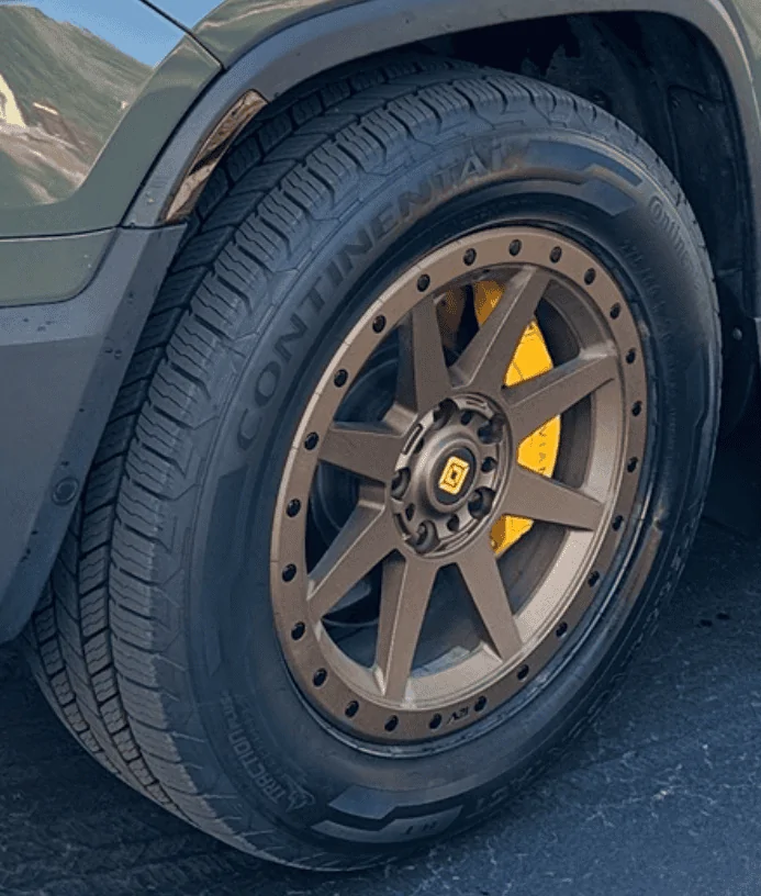

3) Continental TerrainContact H/T [288 m. Range; 720 AA], special note for #3, it's also a high performance tire, rating much higher on wet performance and stopping distance....potentially 30k miles. If you're in a rainy area this is prob. the best choice. Cost per mile of $0.04 for tires plus $0.17 for electricity. $210 per 1,000 miles operational cost. Wet stopping dist. - 109 feet; wet cornering 0.70 G-Force. (Photo source: DoubleTake; Rims (33#) - EV Sportline Adventure Bronze - 20x8.5" +48 offset - $1,995.95)
Rivian R1T R1S Affordable high efficiency 20" wheels and 33" tires options (275/60R20) 1710878874533-d7
4) Goodyear Wrangler Territory HT [304 m. Range; 680 AB], only around 25k miles tire life expectancy. Some light off roading is possible with this tire if you are careful. The only reason this tire is #4 is tire width (and no treadwear warranty), it's pretty narrow at 8.2". Cost per mile of $0.04 for tires plus $0.16 for electricity. $200 per 1,000 miles operational cost. Wet stopping dist. - n/a feet; wet cornering n/a G-Force. (Photo source: Goodyear.com)
Three options come with a 65-70k warranty. Goodyear Wrangler doesn't.

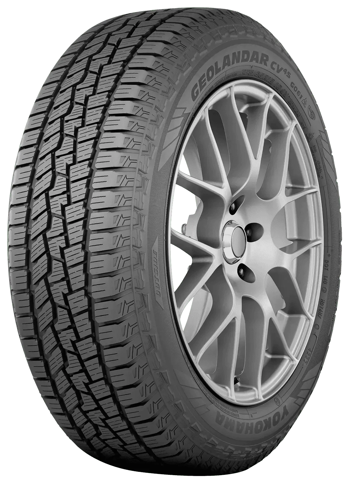

A new Yokohama tire option on the horizon that is 3PMSF, 116H, lightweight (41#), and UTQG=660AA:
Review: YOKOHAMA GEOLANDAR CV 4S | 275/60R20 - 116H - 660AA - 3PMSF

Below is a list of 275/60R20 Tires that can be grouped into the high efficiency club, organized by weight based on the correlation of low weight and high efficiency (I know, I know, rolling resistence-schmolling resistence...), also note there is a correlation to tread depth and weight:
PSI (max)UTQGExamples (275/60R20)Width / Depth
(inches)
#sAll Purpose
mi/kwh
eRange
51​
620 ABGen. Grabber HTS60 (116T)
8.6 / 10/32​
34​
2.50​
320-358
51​
800 AAPirelli AS+3 (115H)
8.3 / 11/32​
38​
2.40​
307-345
50​
820 BADefender LTX M/S2 (116H)
7.8 / 11/32​
40​
2.35​
301-339
51​
640 AAKumho Crugen HP71 (115H)
7.8 / 11/32​
42​
2.30​
294-333
51​
720 AAConti. TerrainCntct H/T (115H)
8.9 / 12/32​
44​
2.25​
288-326
51​
680 AAKumho Road Vent. AT52 (115T) SNOW
9.1 / 13.5/32​
46​
2.20​
282-320
50​
640 ABOEM Pirelli AT+ (116H) [275/65R20]
9.1 / 13/32​
48​
2.15​
275-314
50​
640 ABGen. Grabber A/TX (116T) SNOW
9.6 / 14/32​
50​
2.10​
269-307
* Add ~0.3 mi/kwh for Conserve mode; range will increase by ~30 miles or so...Assumes 65 mph, flat terrain, no wind, no cargo/passengers.
20" OEM QM efficiency (EPA): 289 mi / 2.1 mi/kwh
21" OEM QM efficiency (EPA): 321 mi / 2.4 mi/kwh
22" OEM QM efficiency (EPA): 303 mi / 2.2 mi/kwh
My top choices come mainly from wanting a wider tire, they are in order:
All 3 come with a 65-70k warranty.
The OEM 20" tire has an operational cost of almost $300 per 1,000 miles...

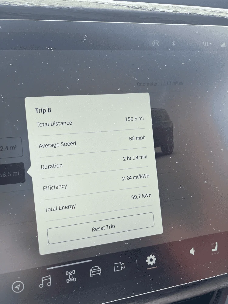

like @Mtbaddict I'm curious how you're calculating the various efficiency and range numbers.

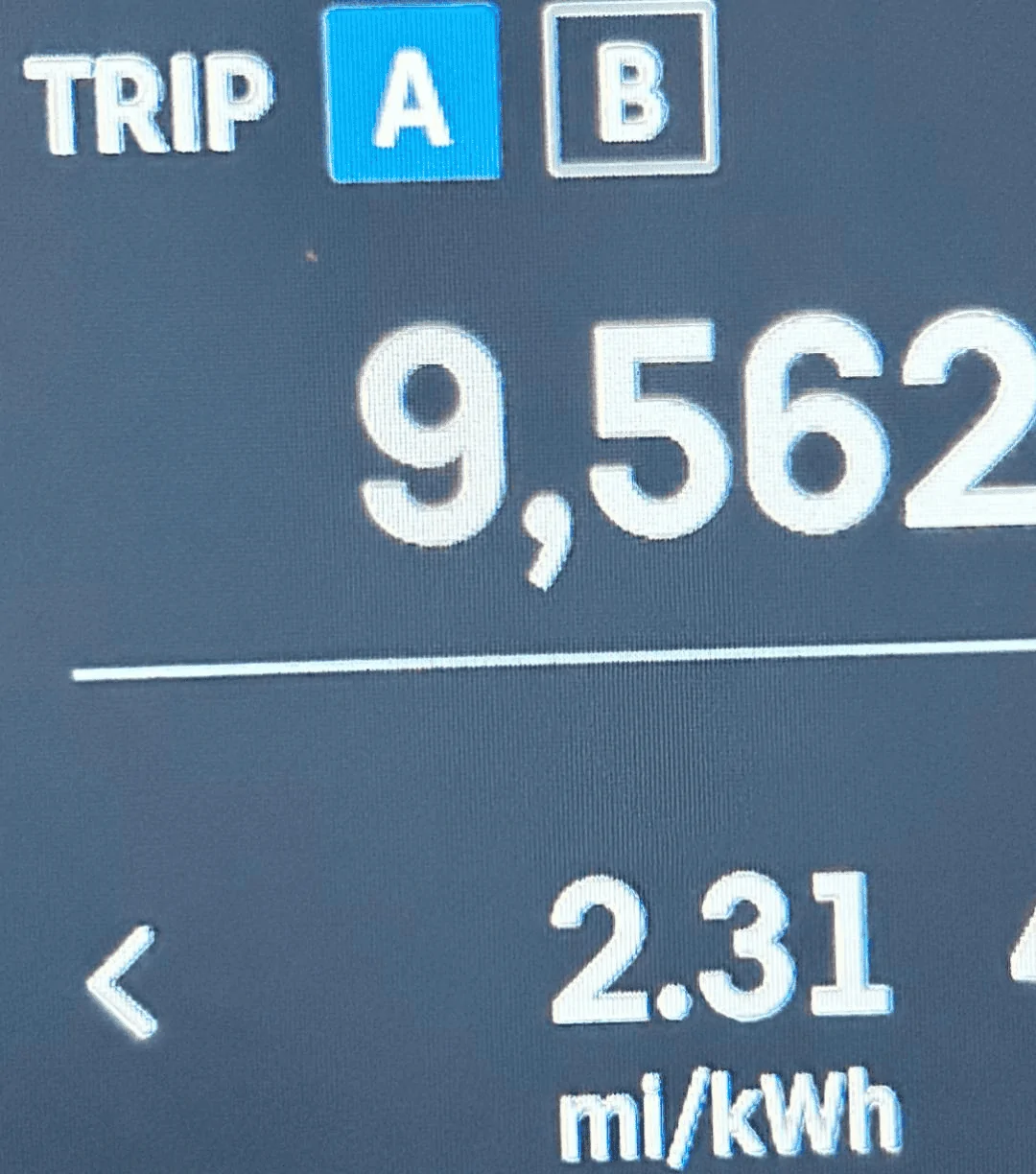

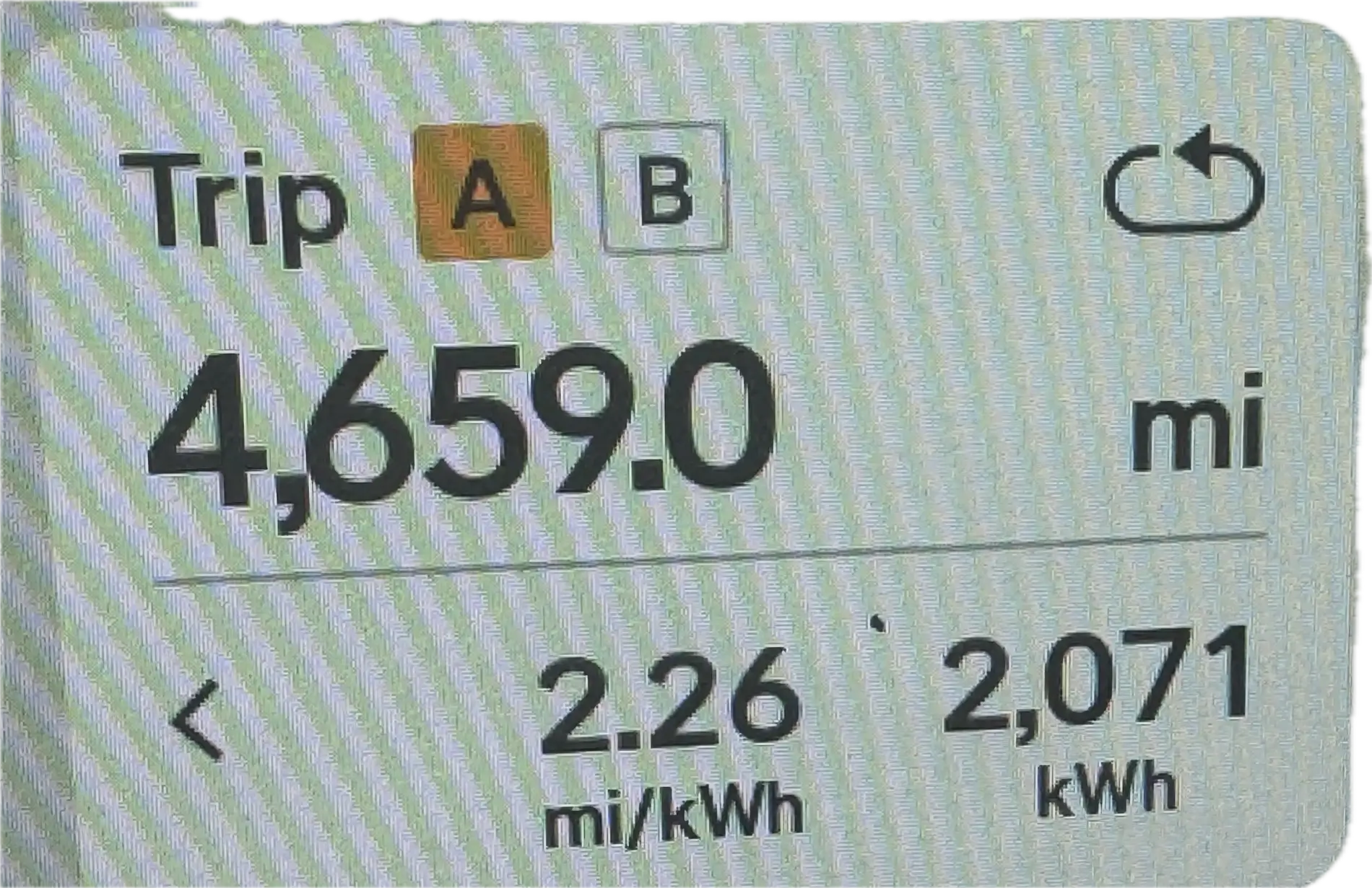

Here is some data. My R1S quad large is programmed to 22’s. I have OEM 20 brights with 275/60/20 Pirelli. I did a 100% to 0 driving test for my use case. Took 10 days to drain. 343 miles in conserve. I did the same test in AP mode, 293 miles.
On highway trip on FL turnpike I see 2-2.25. My S is 5-10% more efficient than my R1T with 21’s, large quad.
R1T lifetime over 5700 miles was 2.31.
Current lifetime with my S at 6800 miles is 2.48.

That tire is something, do you feel it has any downsides? Width is borderline, so is load, but any handling or ride characteristics that you feel are negatives? Also, what is your 80% range indicator? Thanks for adding this data!
Mar 29, 2021
121
6,441
10,896
Kitsap, WA
It’s tricky because how/where you drive is #1 factor, definitely some guesswork involved.
Battery temp makes the biggest % difference for me, so if comparing efficiencies, you need to afix a few factors:
-Tire pressure
-battery temp (external temp don't matter none if it's a short test run)
-equal conditions (wet, dry, rain, etc... So long as it's the same for each test you do)
-Route and average speed
-Drive mode/height
-cabin conditions
-carrying weight (less burritos = better efficiency @COdogman )
I'm about to rotate my 2363 ATs, if it
Screw it, for science, I'll swap early and test my 3 275/60R20 setups: AS+3 on stock staples, AS+3 on 2363s, AT3W on 2363s. Give me a couple weeks to squeeze in a couple more ski trips and I'll post results.
