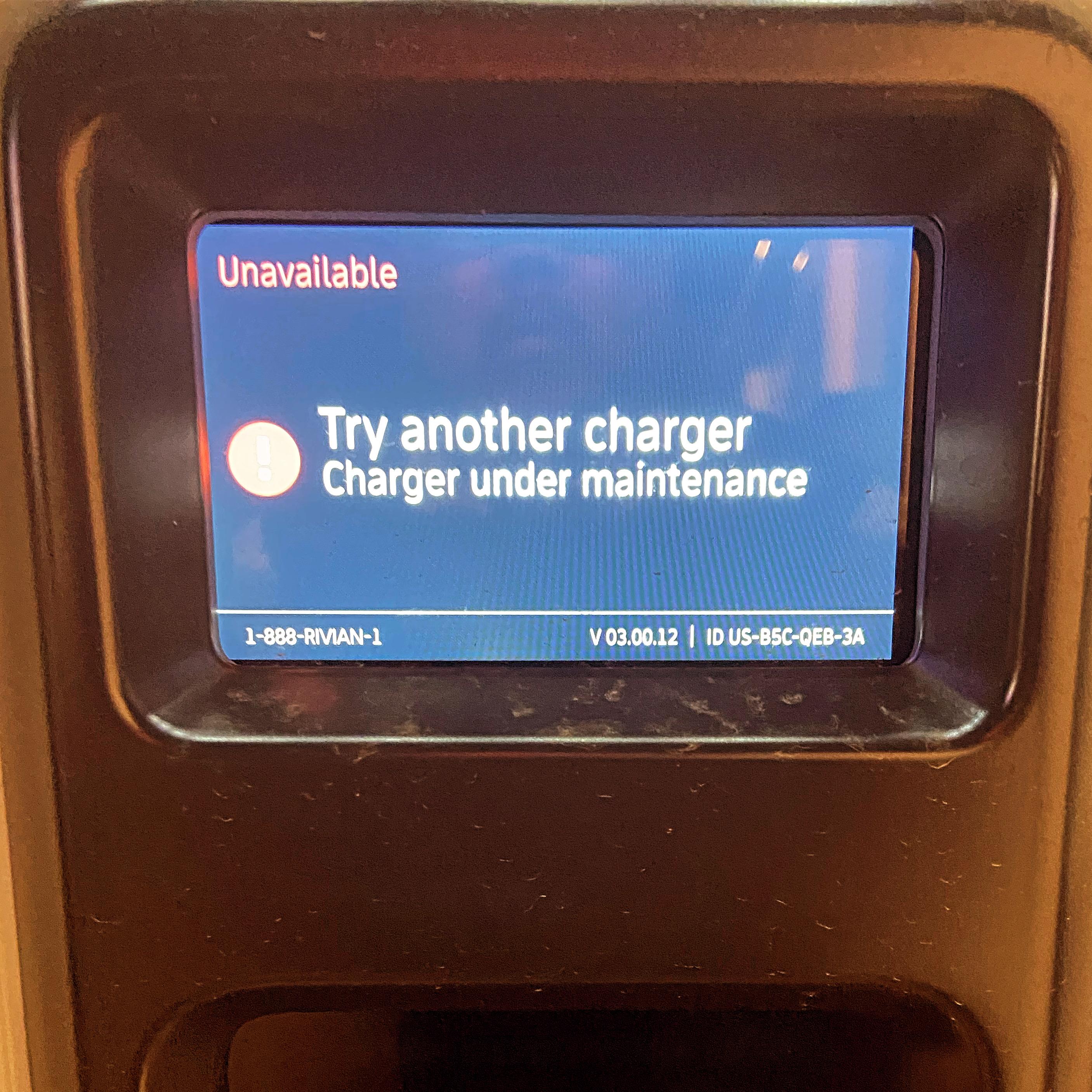

most folks at chargers were friendly and had good charging etiquette but a couple of times chargers were blocked or they hadn't returned to their vehicle even though they were done charging. guess they dont mind the idle fees but its annoying.
charging locations don't have any covering and are usually located "around back". it could make it uncomfortable/unsafe for those traveling alone. in most cases, shops/restaurants were nearby but its usually never as convenient as gas stations.

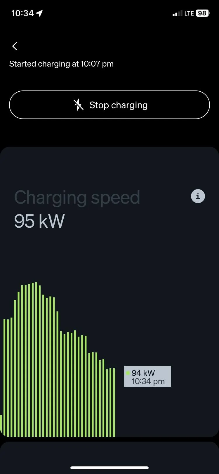

i used the Rivian Adventure Network (RAN), Electrify America (EA) and EVgo. i used battery preconditioning for each charge. sometimes the vehicle started that 1 hour before, sometimes 30 min, sometimes 15 min. sometimes it'd do it twice. seemed like it was trying to get the battery to the low 70s temp.
i had the best charging with the Rivian Adventure Network. plug and charge, best rates, high charge speeds and almost always working and available. there was one time the entire station was down but a week later when i returned it was up and running. second best was EVgo. consistently got good charge speeds as stated on the charger/app. also never ran into an issue with the charger not working when the app stated it was. connected each time and simple to start the charge. EA comes in third. i did get good charge speeds but a few times it didnt go as high as expected and a few times even though the app said it was working when i got there it wasn't. it wouldn't always connect properly and a few times it stopped the charge and i had to restart or move chargers.
RAN peaked at about 200-215 kW
EVgo peaked at about 175-200 kW
EA peaked at about 165-190 kW
the charging curve pretty consistently looked like this, regardless of charger. peak speeds sometimes lasted a bit longer, sometimes a bit shorter. definite step down over time, as expected.

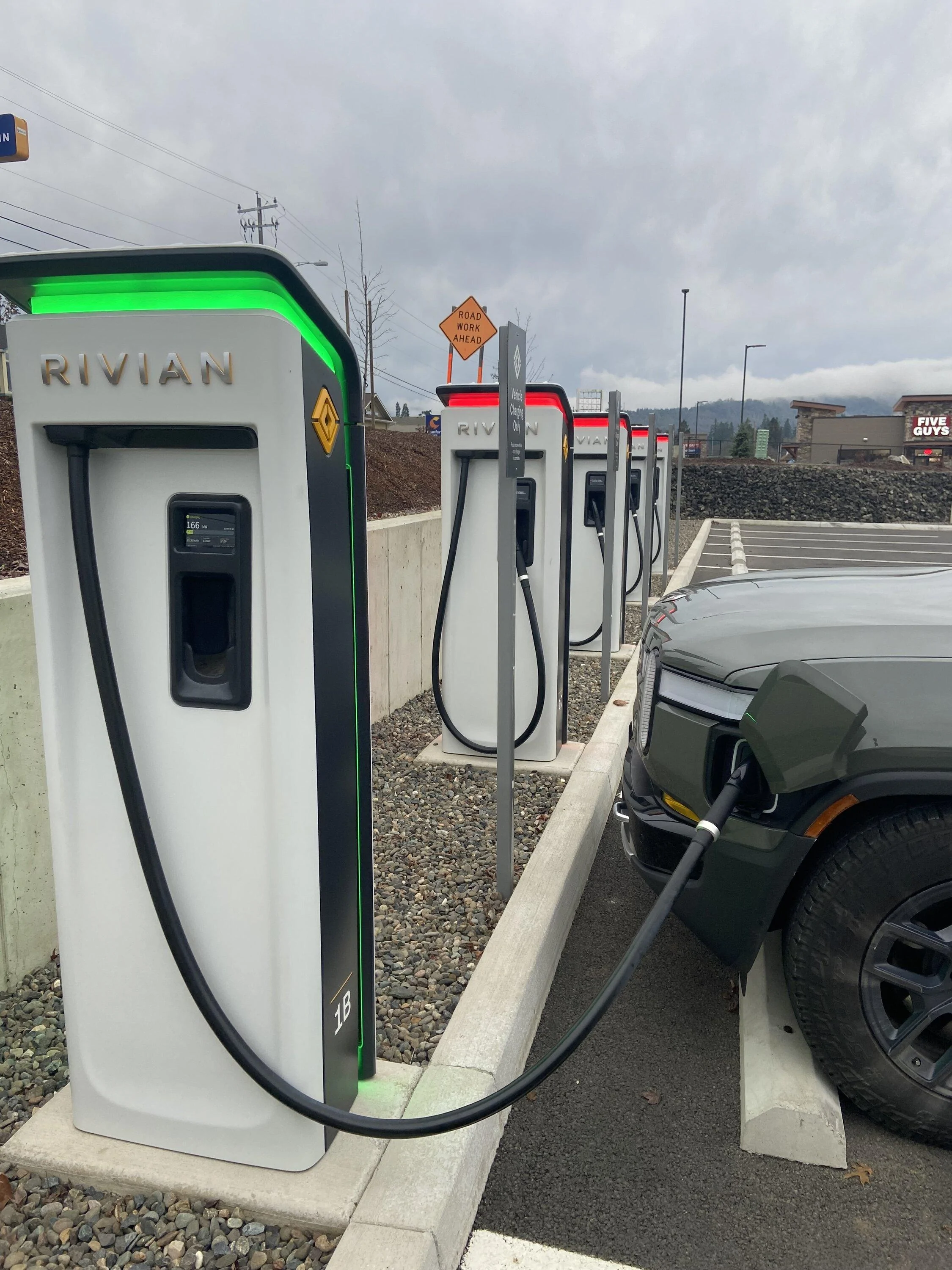

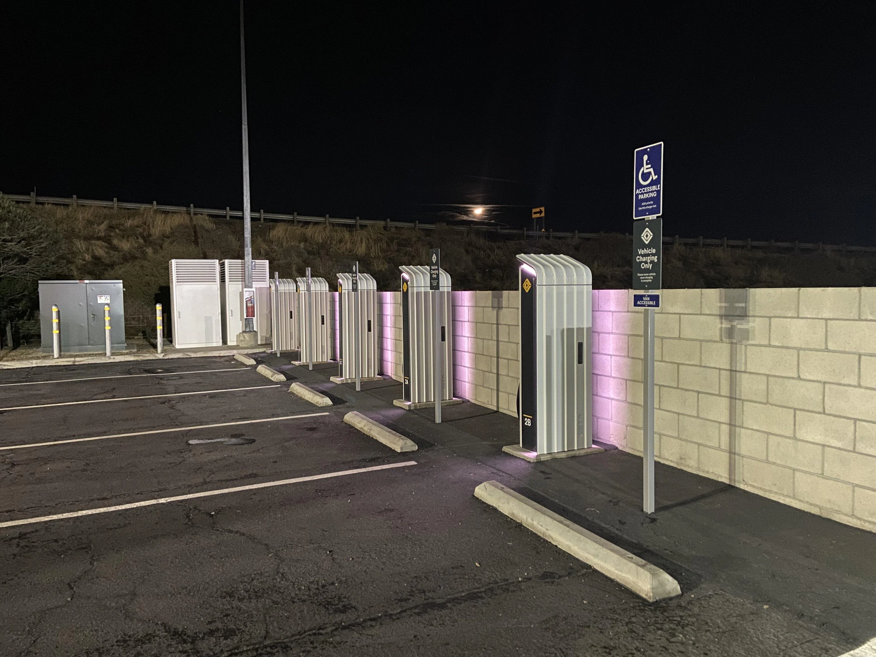

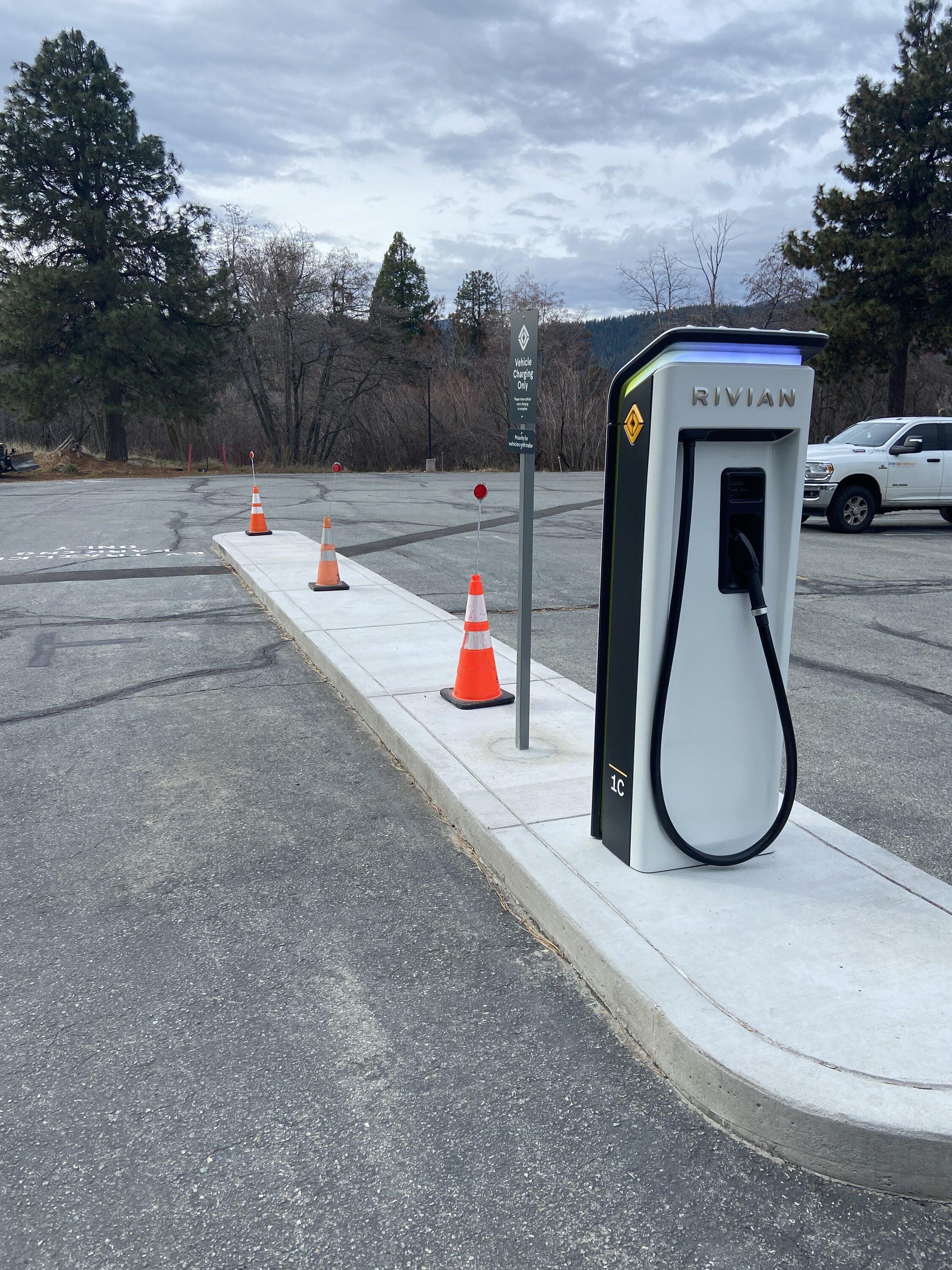

RAN - Roseburg
Rivian R1T R1S Roundtrip Seattle to SoCal in my R1T: Experience and Observations IMG_5887

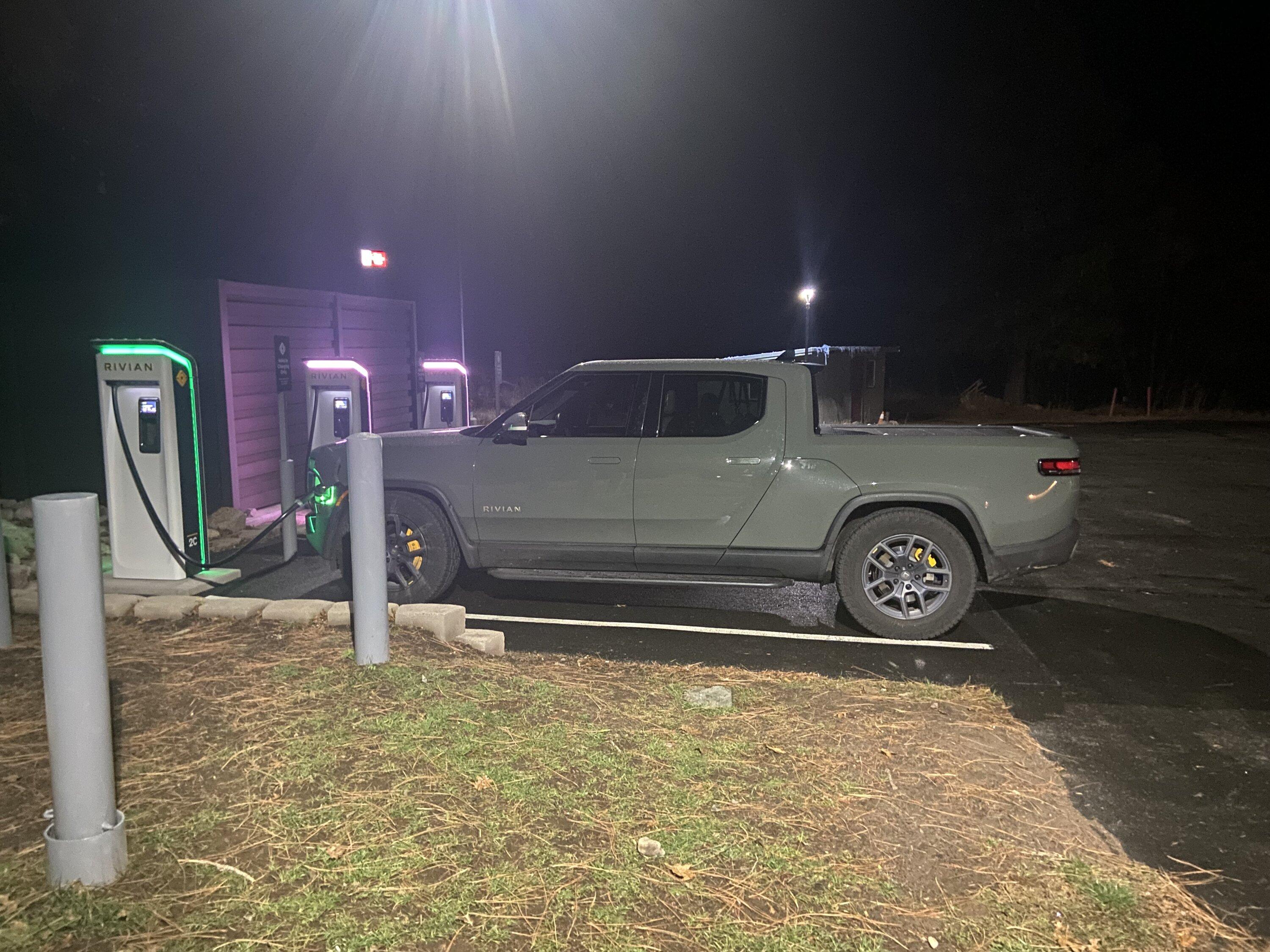

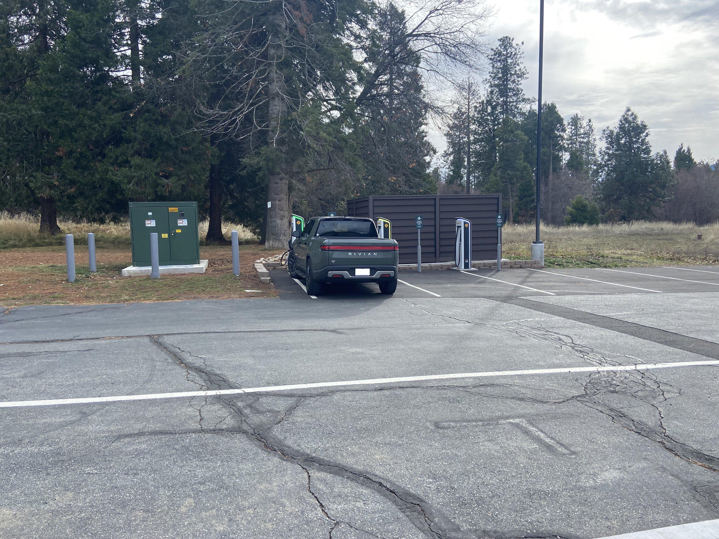

RAN - Mt Shasta
Rivian R1T R1S Roundtrip Seattle to SoCal in my R1T: Experience and Observations IMG_5897
Rivian R1T R1S Roundtrip Seattle to SoCal in my R1T: Experience and Observations IMG_5987
Rivian R1T R1S Roundtrip Seattle to SoCal in my R1T: Experience and Observations IMG_5986

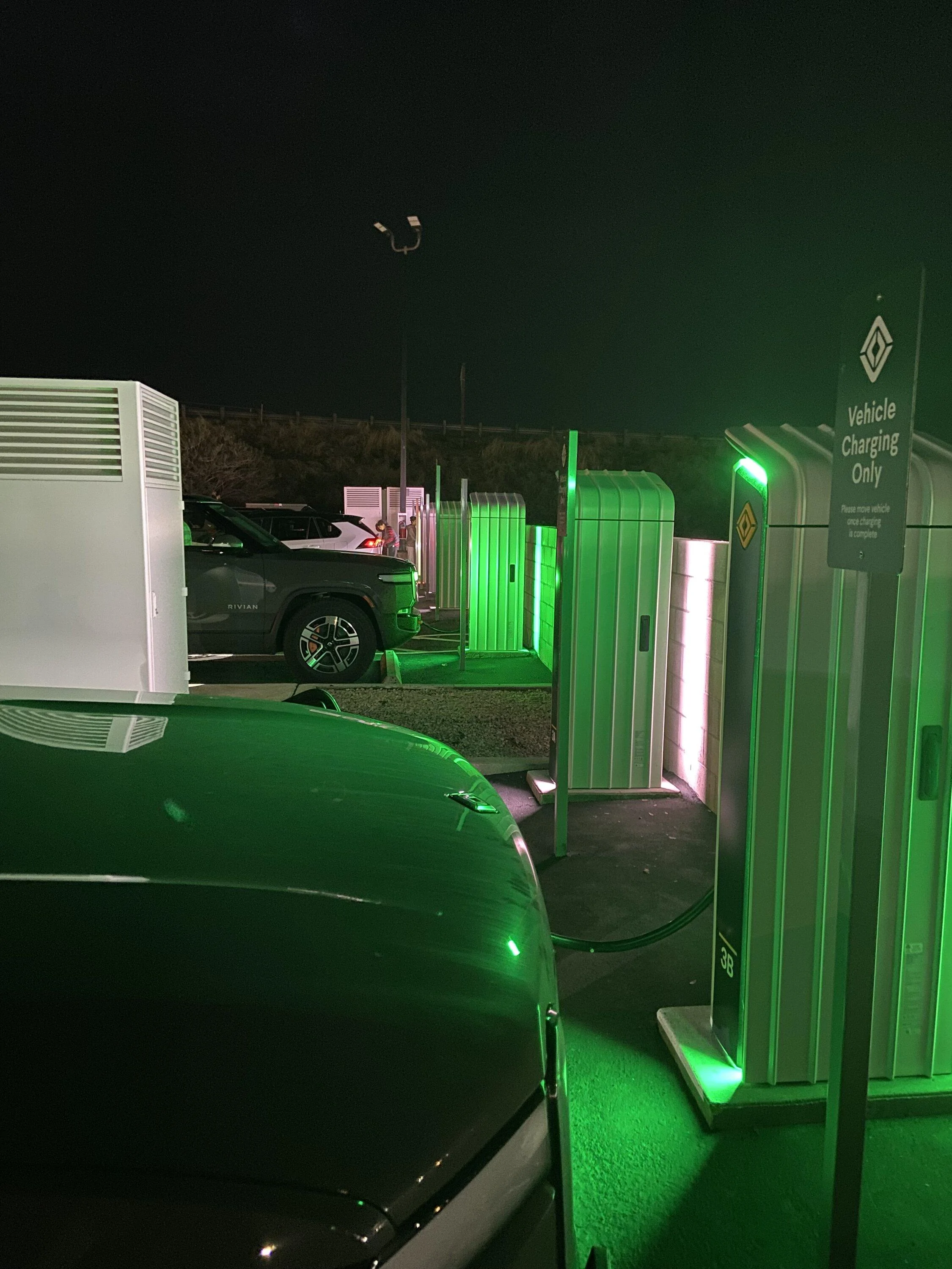

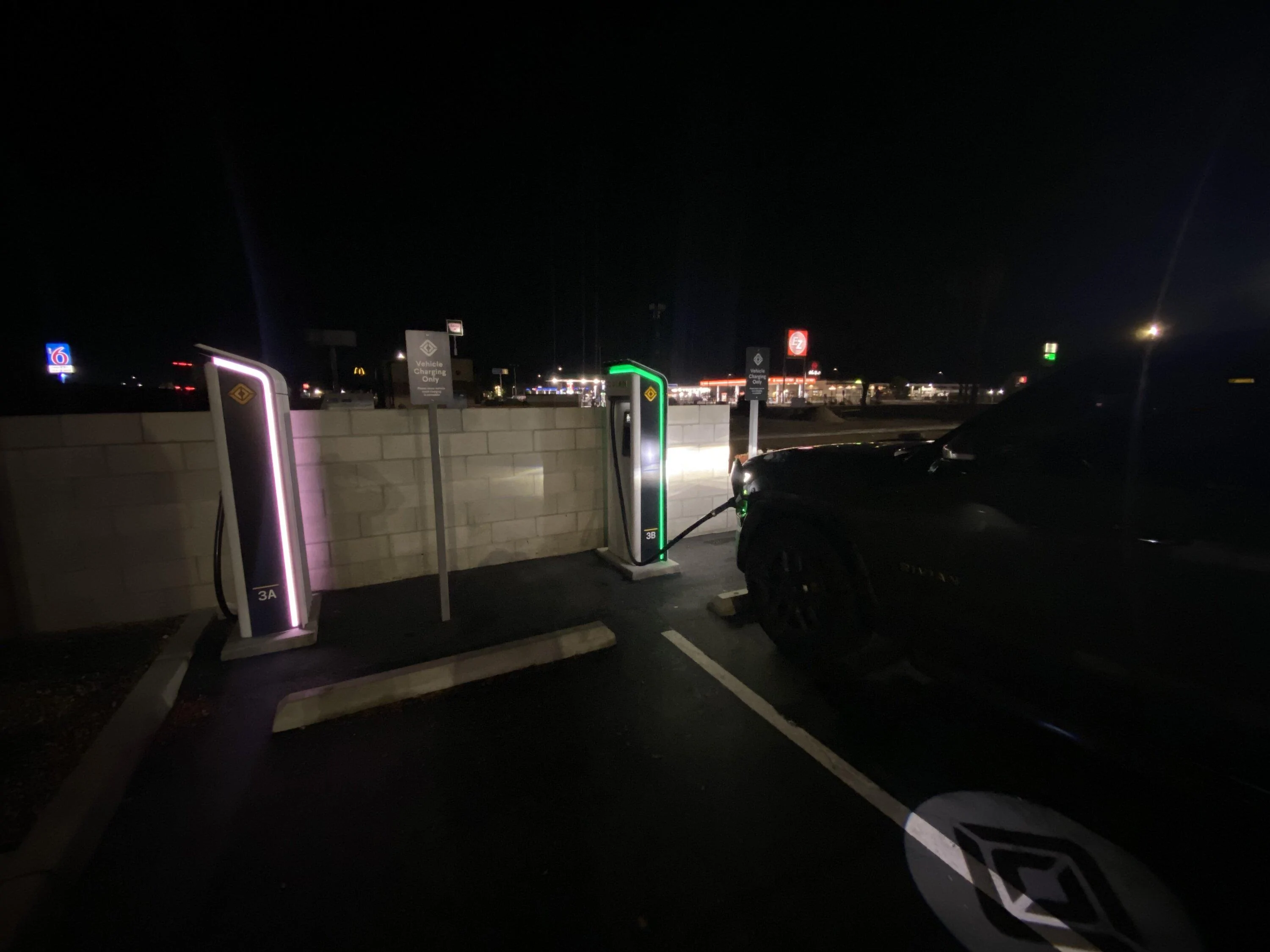

RAN - Buttonwillow
Rivian R1T R1S Roundtrip Seattle to SoCal in my R1T: Experience and Observations IMG_5906
Rivian R1T R1S Roundtrip Seattle to SoCal in my R1T: Experience and Observations IMG_5911
Rivian R1T R1S Roundtrip Seattle to SoCal in my R1T: Experience and Observations IMG_5971

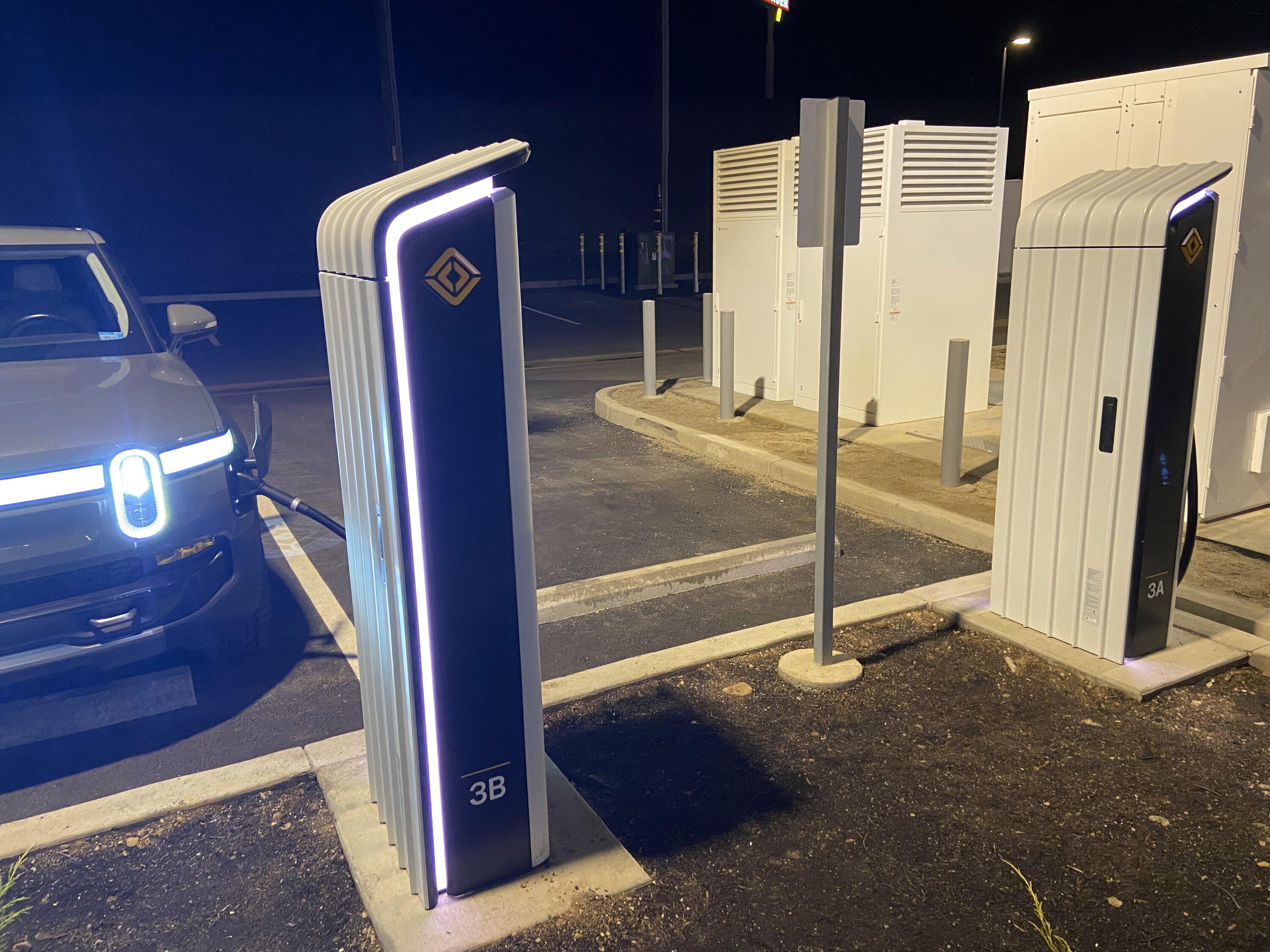

RAN - Santa Nella
Rivian R1T R1S Roundtrip Seattle to SoCal in my R1T: Experience and Observations IMG_5973
Rivian R1T R1S Roundtrip Seattle to SoCal in my R1T: Experience and Observations IMG_5974
Rivian R1T R1S Roundtrip Seattle to SoCal in my R1T: Experience and Observations 0E5B5E2A-4F75-4525-91A6-DAD9F994C3C4.JPG

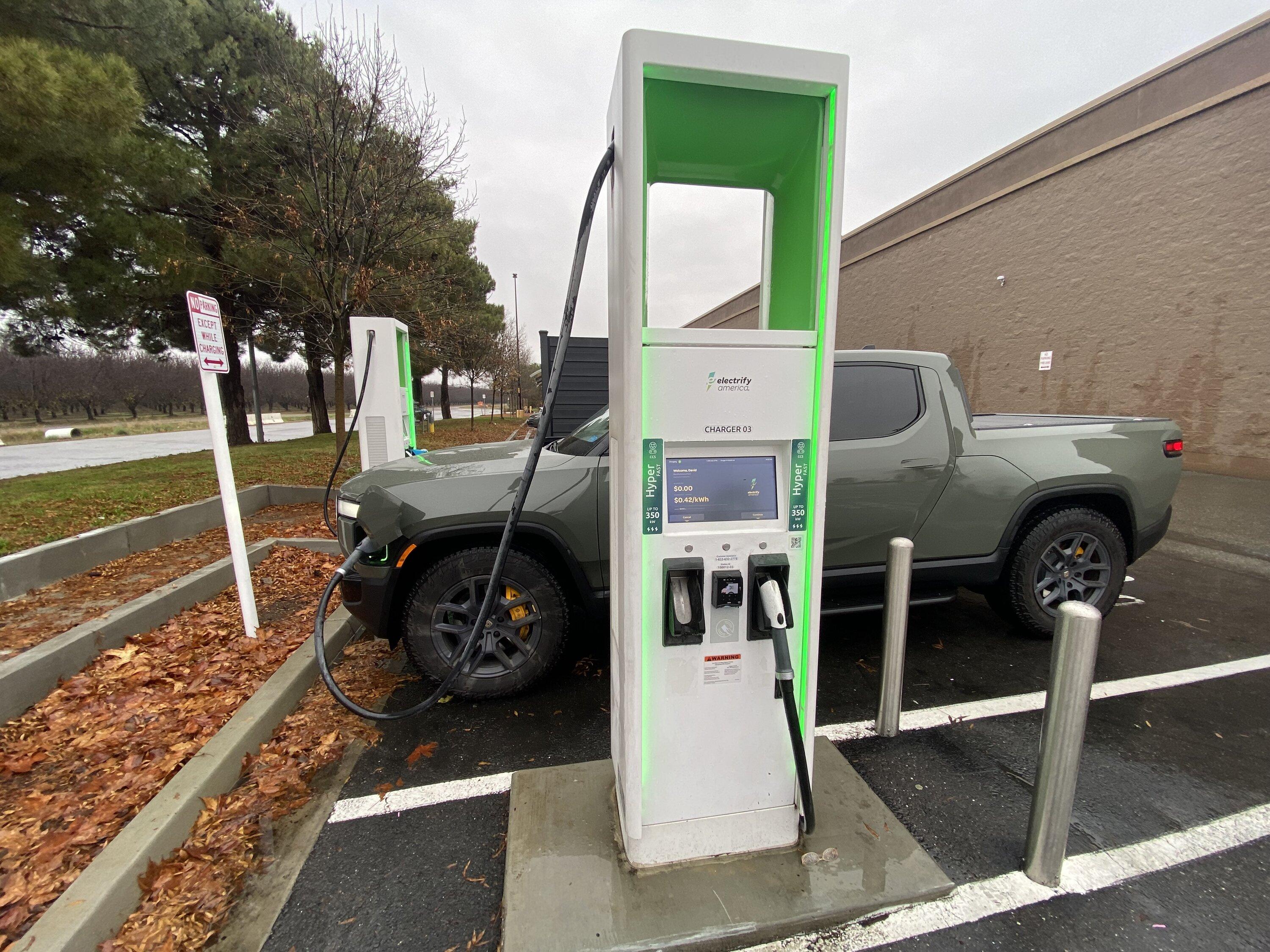

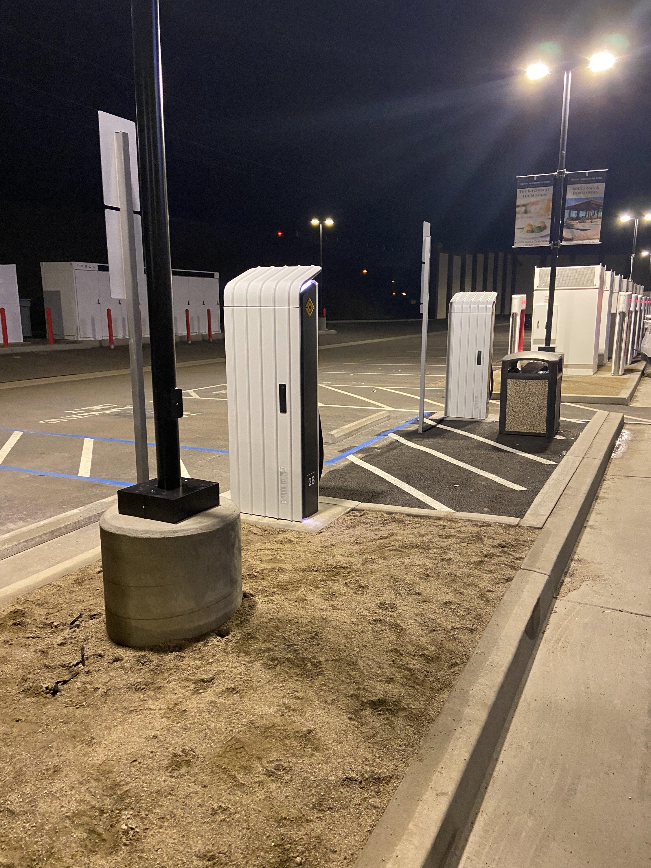

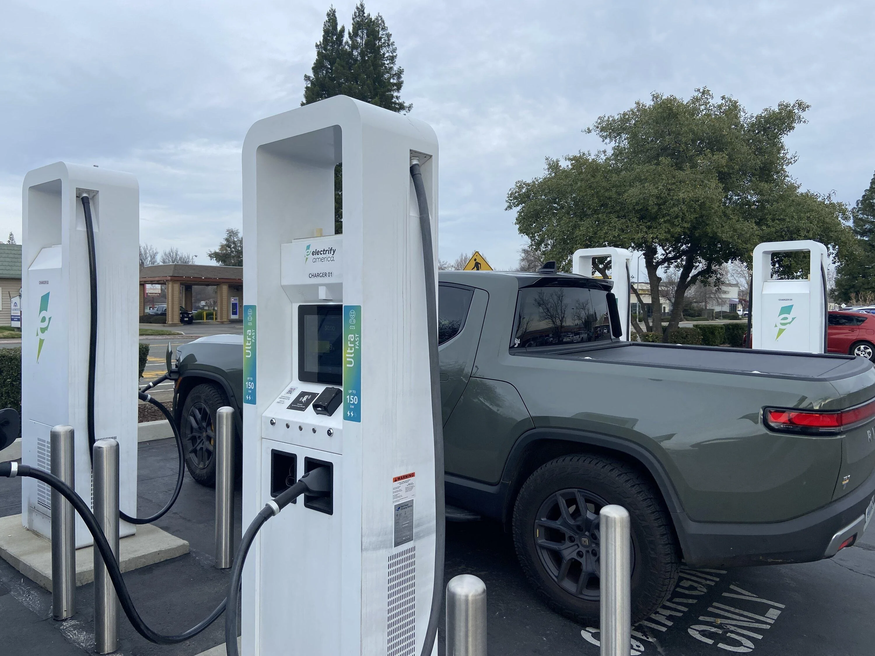

EA - Willows
Rivian R1T R1S Roundtrip Seattle to SoCal in my R1T: Experience and Observations IMG_5900

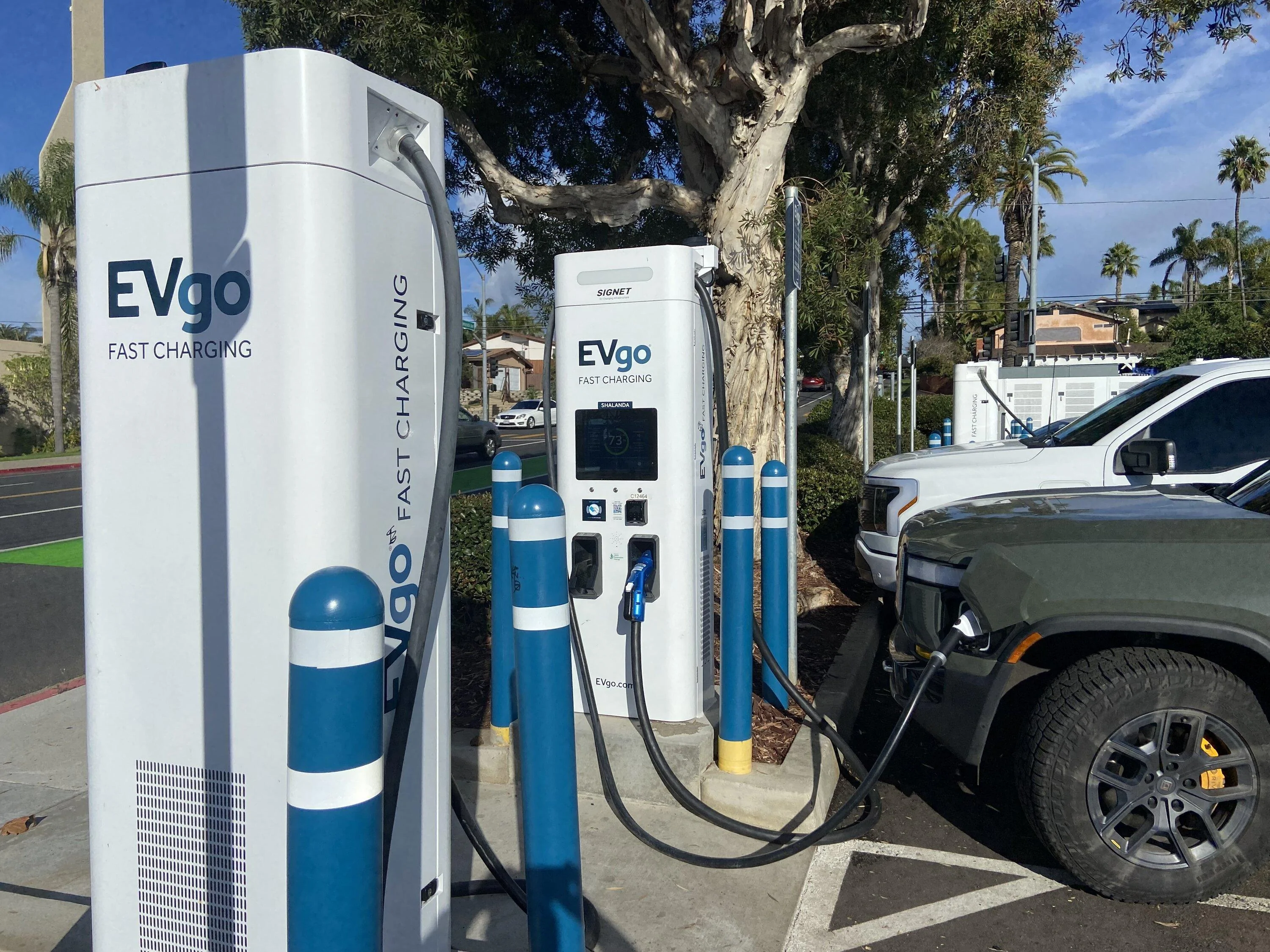

EVgo - Carlsbad
Rivian R1T R1S Roundtrip Seattle to SoCal in my R1T: Experience and Observations IMG_5952
EA - Anderson
Rivian R1T R1S Roundtrip Seattle to SoCal in my R1T: Experience and Observations IMG_5984

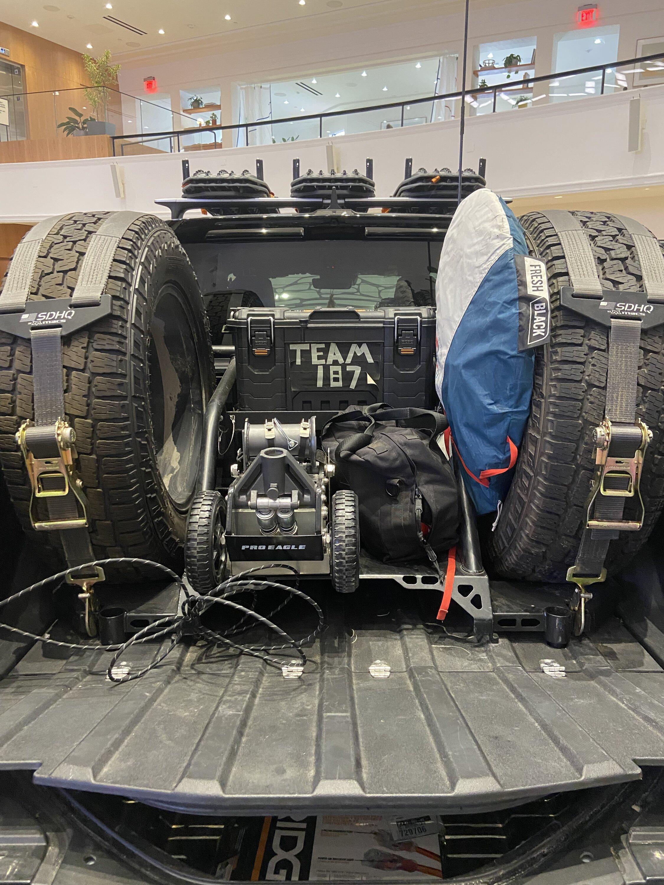

Rivian Space - Laguna Beach
Rivian R1T R1S Roundtrip Seattle to SoCal in my R1T: Experience and Observations IMG_5940
Rivian R1T R1S Roundtrip Seattle to SoCal in my R1T: Experience and Observations IMG_5942
Rivian R1T R1S Roundtrip Seattle to SoCal in my R1T: Experience and Observations IMG_5945

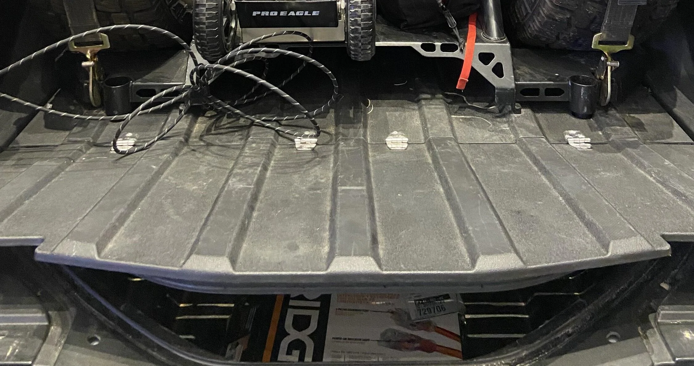

Also, I want to know more about these hinges... Did they remove the struts to make it easier to get in and out of there? Like a quick flip up and down to access? I've always been annoyed by those struts, seems like too much trouble and something that should be replaced by an old-school hood prop rod.
Rivian R1T R1S Roundtrip Seattle to SoCal in my R1T: Experience and Observations IMG_5945~2
good question. for this trip i wanted to run in AP as a test. also, i ran conserve on a shorter trip, about 300 miles earlier in the year, mostly freeway driving and i visibly saw tire wear on the front tires so ive decided not to use it unless absolutely necessary.
if you'll notice, this is not the standard cover for the in bed storage. its a hack/mod. they essentially cut it about 60-70% shorter and put exterior hinges. they stored the spares in the bed but still wanted access to storage space for tools. as i recall there are struts there but much shorter.
Love it! I see some ultra-saw action in my future ??
I feel this one. I hit two different stations that were full with folks waiting on a trip from Denver to Chicago. Chevy Bolts and Kia Niro EVs were the super slow to charge folks, but it's hard to fault them when they still stopped at 80%. I had one Hyundai Ioniq 5 owner that decided that the perfect time to charge to >95% was while 2-3 cars were waiting to charge...me being one of them. :mad: When I finally got on a charger at that station I actually re-planned the end of my trip to add one more quick charge so folks didn't have to wait as long for me to move on. Sadly, that additional stop was the other one where I had to wait 15+ min for a stall to open up. In contrast, traveling on Xmas day was glorious as I barely saw another car at a charger for over 800 miles.
