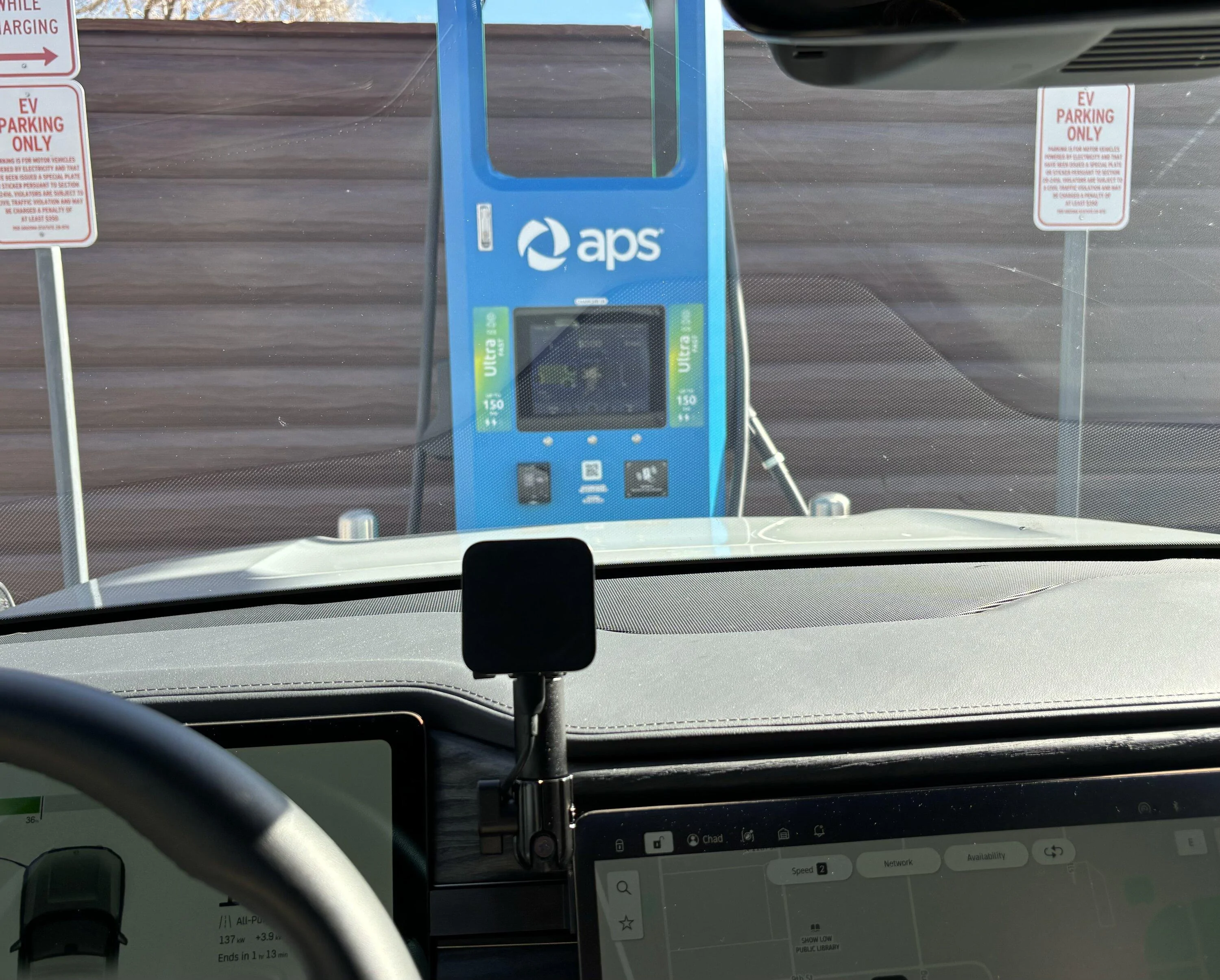

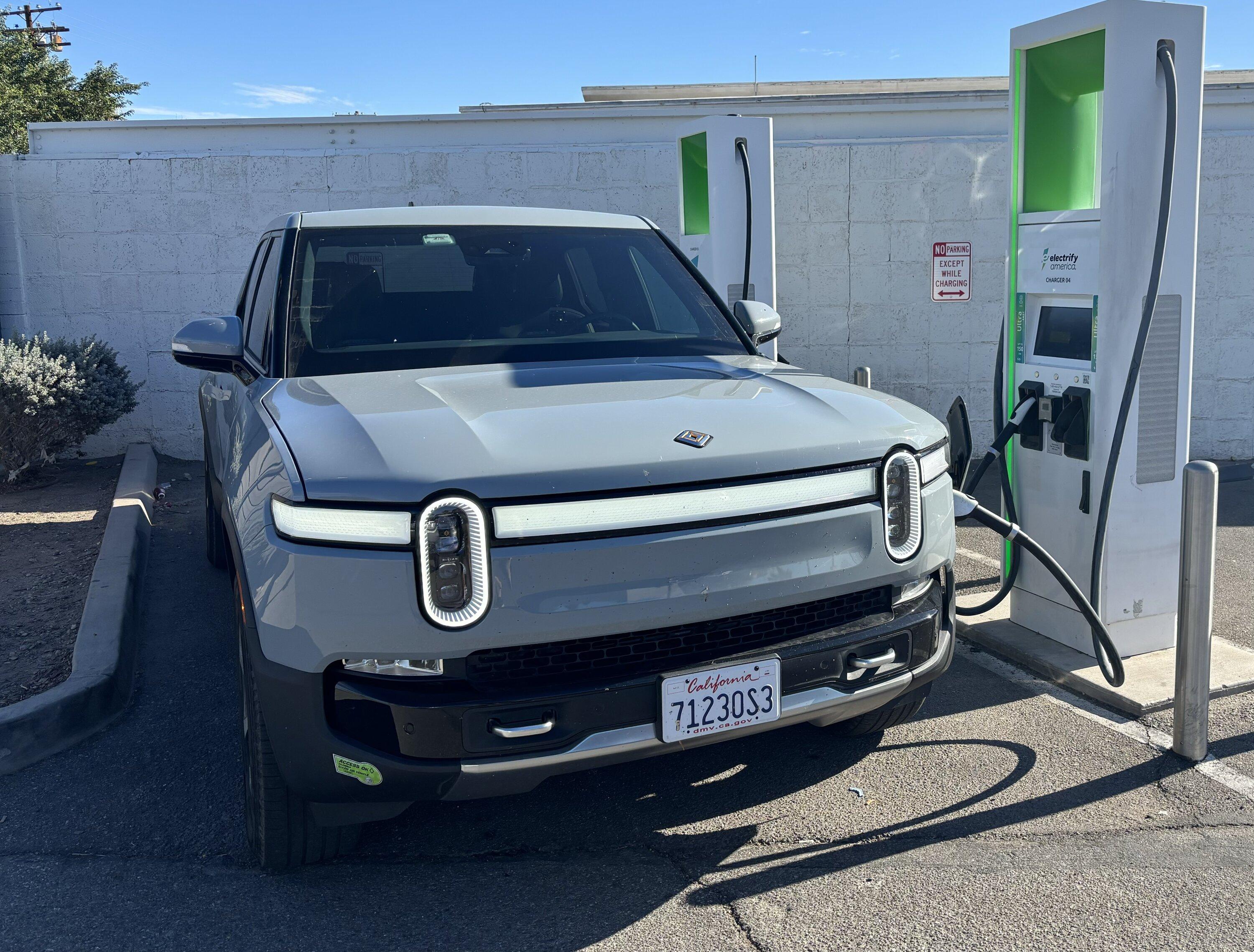

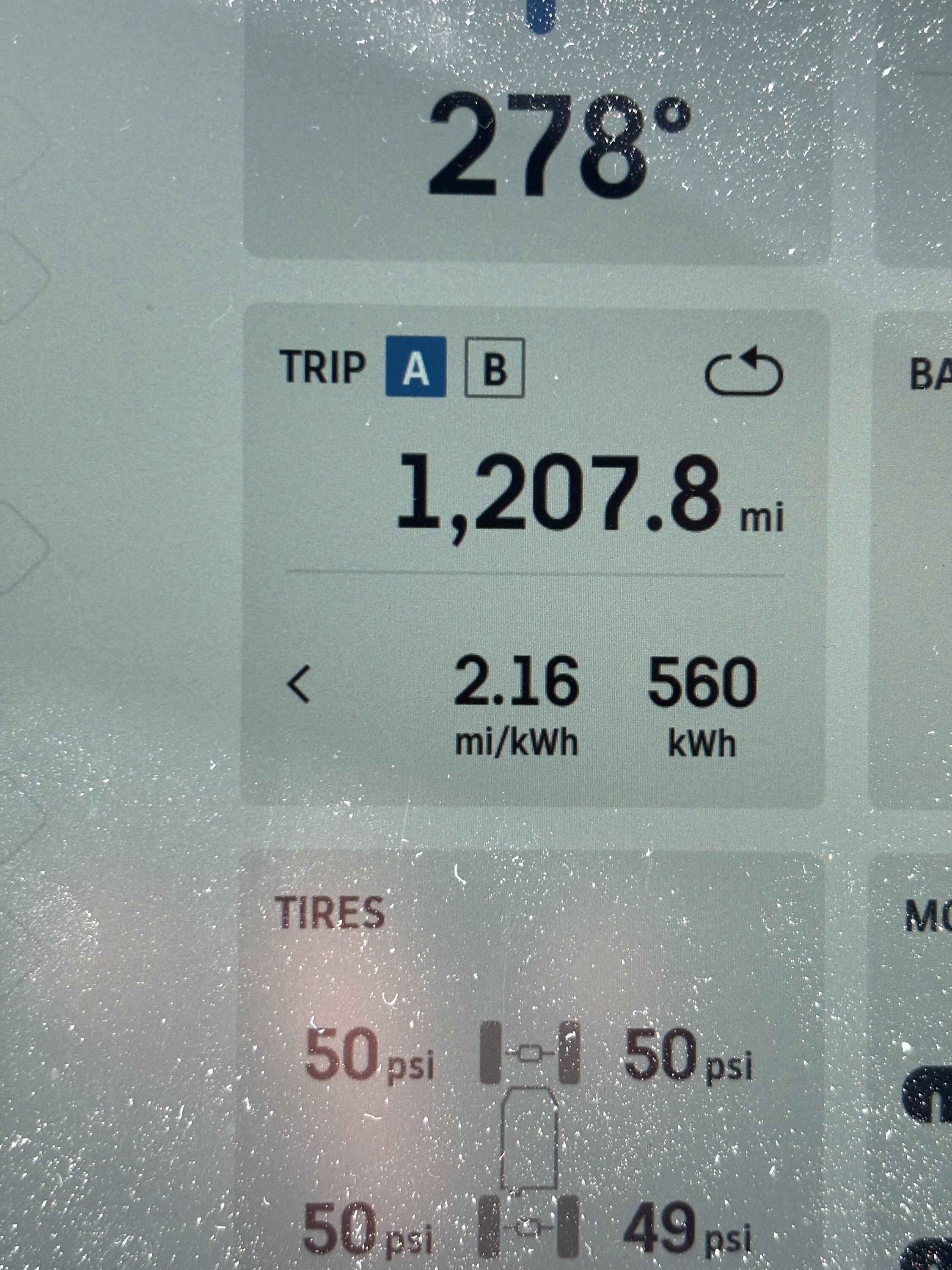

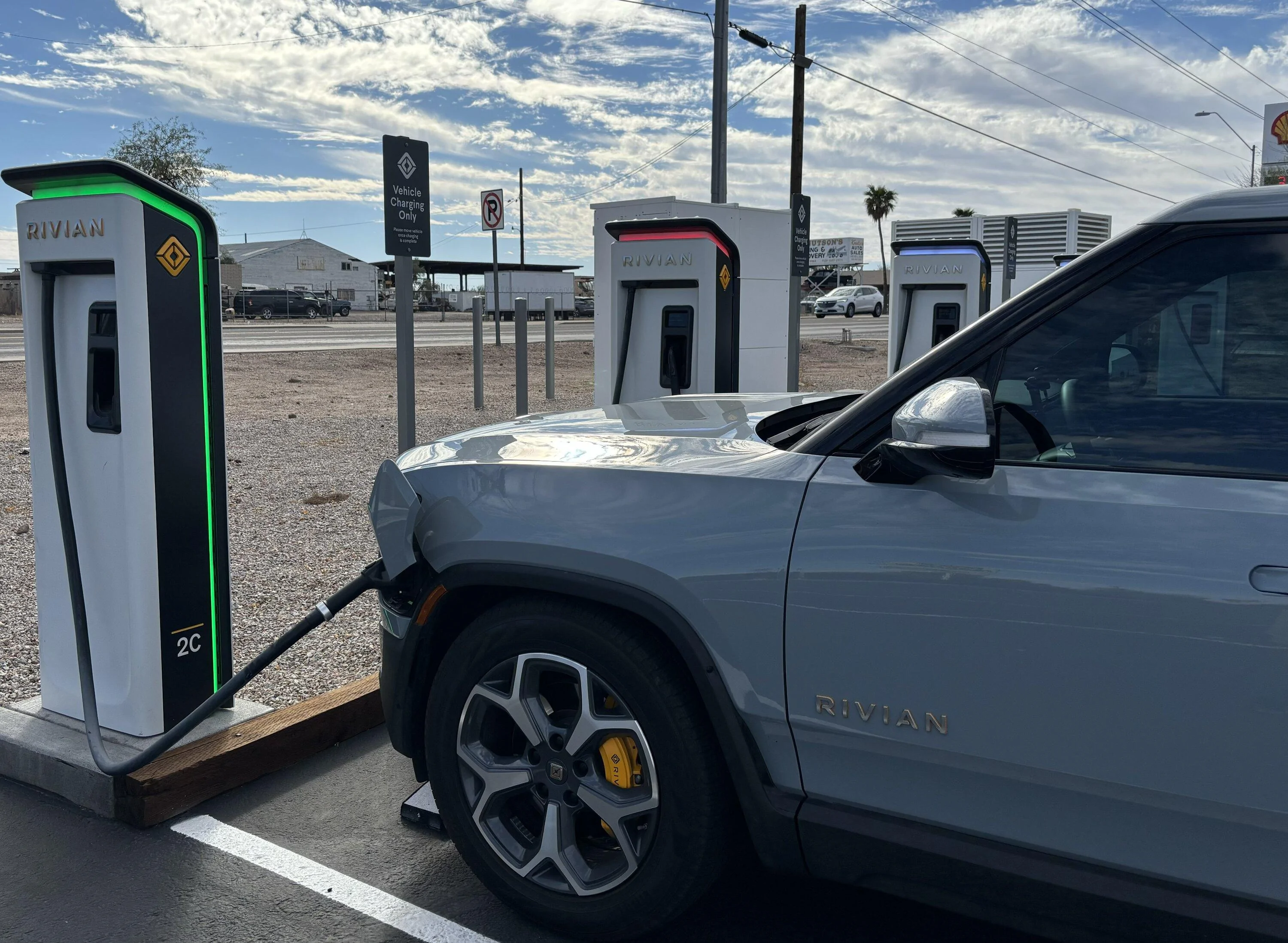

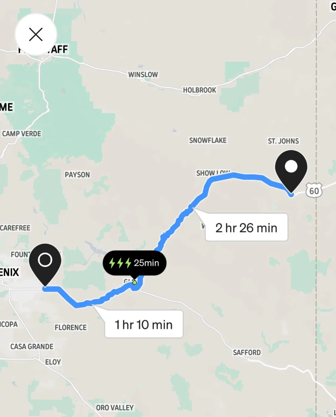

Did an elk hunting trip over thanksgiving from Vista CA to Springerville AZ.
1200 miles round trip. Took I8 from Vista to Meza and stopped to charge at EA in Yuma and RAN and Gila Bend.

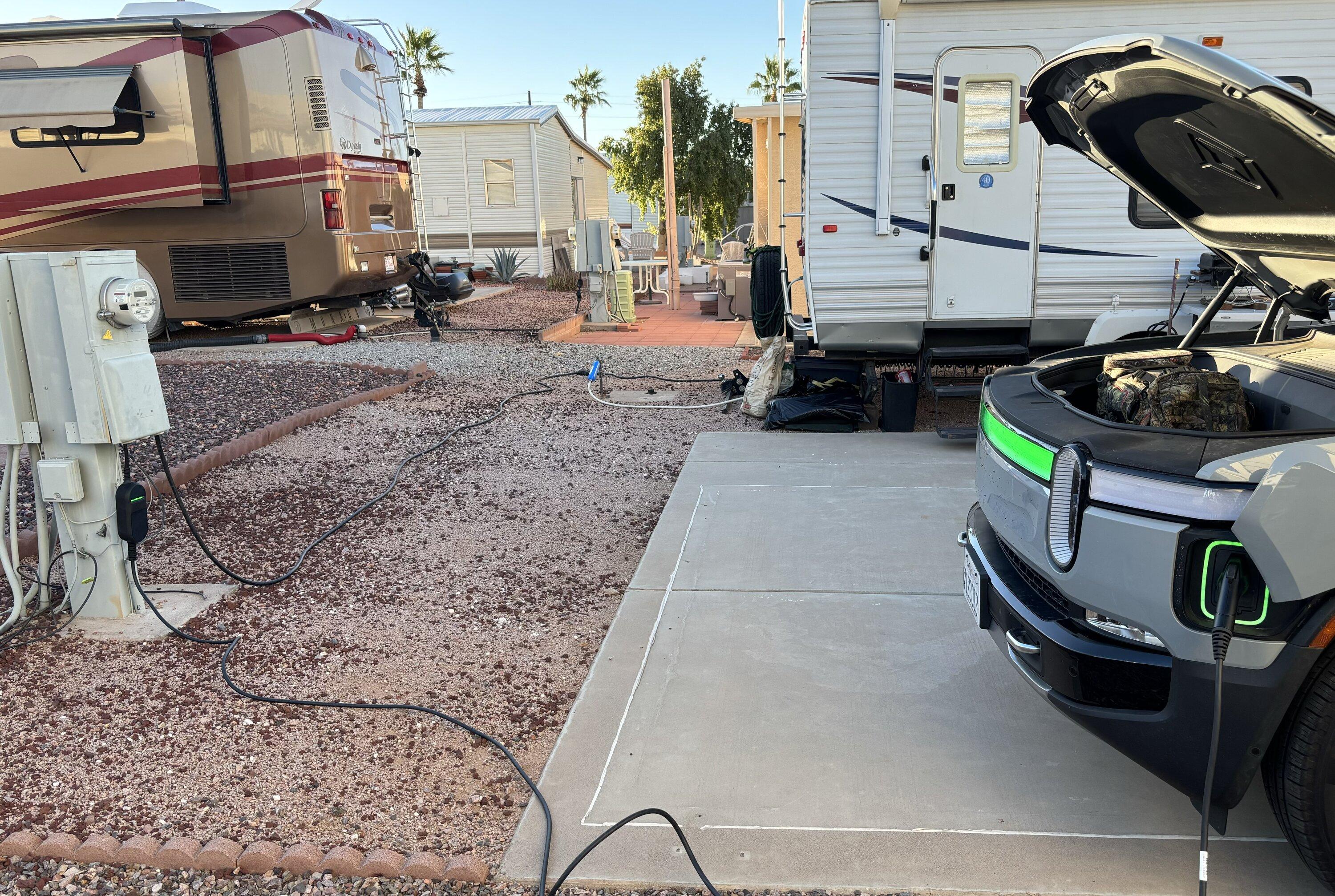

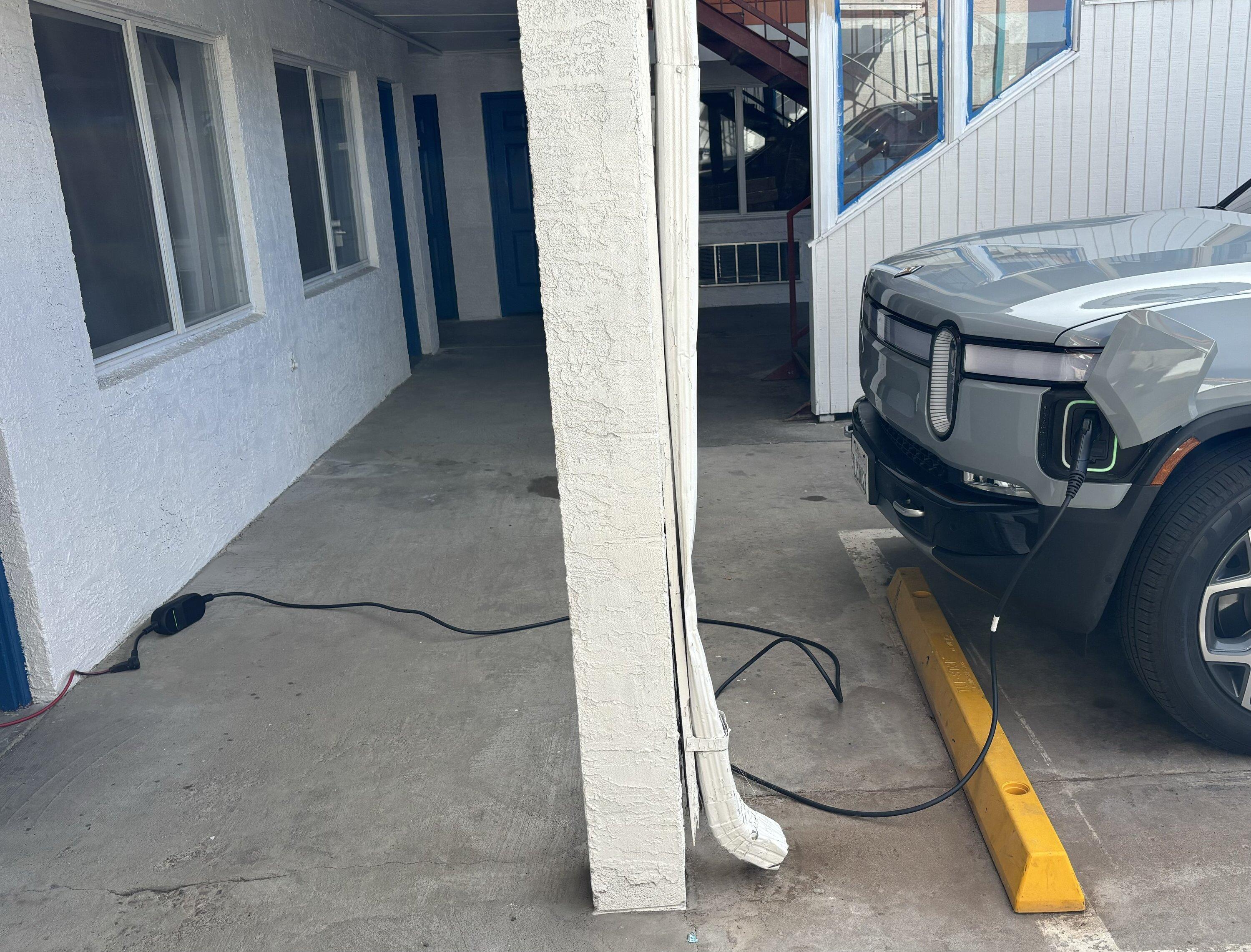

I used a 30 amp RV plug to charge in Mesa to get to 100%.
On the way to Springerville, stopped at APS/EA station in ShowLow. No more DCFC available after that. Used the wall plug at the hotel. There was RV hookups in the area, but didn’t need it.
R1T did great on the trip, my main observation is if you can access a RV or other 230v plug, you can charge at 6.6KW and make up a lot of range over night.
Reversed the route and left stopped in GB and El Centro on the way back.

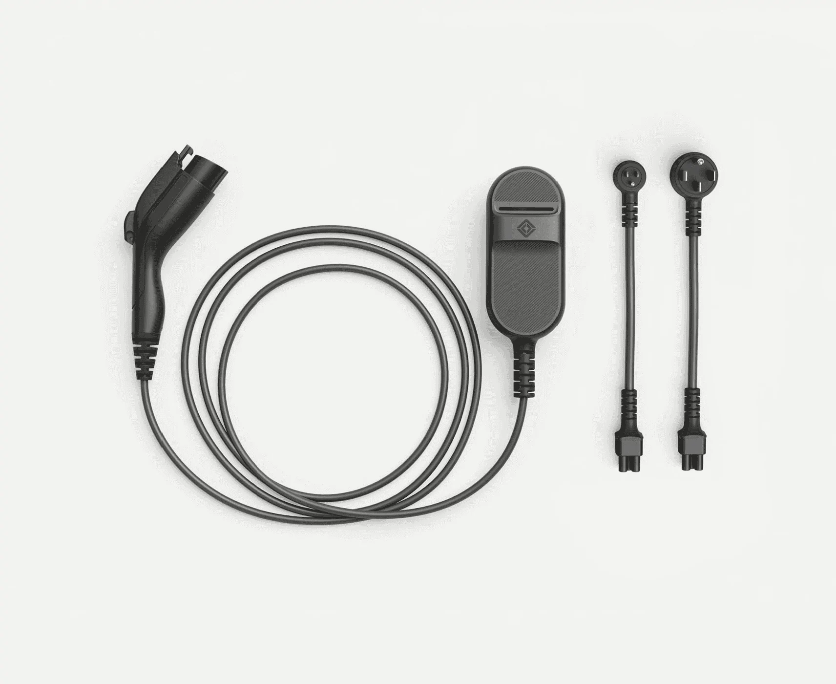

The included portable charging kit has the plug. No adaptor needed.
The Rivian kit, and your photo show a 15 amp 110 and a 50 amp 240 plug, nothing for 30 amp RV (three blades at an angle).
For those interested in a truly capable gorilla charge kit, I use and recommend the Tesla mobile EVSE with their NEMA kit. Extremely powerful and flexible.
Sorry, I should have been more clear, I was on a 50 amp plug with the 240 Plug, but the EVSE limits charging to 32 amps.
