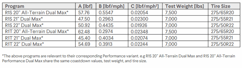

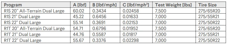

So I don't know a whole lot about the EPA range testing, but does Rivian have control over these coefficient numbers? That could explain the better (rated) "efficiency" in the max pack:
Large pack [1]:
Max pack [2]:
[1] https://www3.epa.gov/otaq/datafiles/FOI_PRIVT00.0192_APPIPT1.PDF
[2] https://www.rivianforums.com/forum/attachments/foi_privt00-0sep_appipt1-pdf.75046/
Or maybe the max pack is truly more efficient in some magical way I don't understand.
Yes, those coefficients are supplied by the manufacturer
