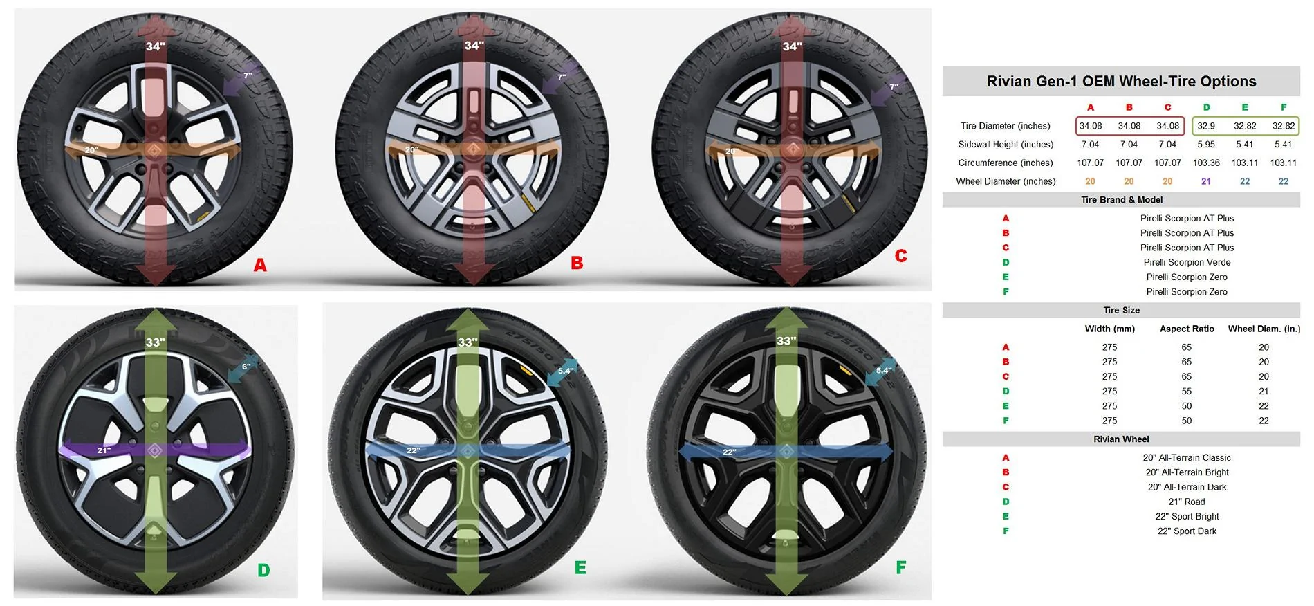

Rivian R1T R1S 21" Tires a problem   ANY suggestions ? GEN 1
|||↑|Selection of aftermarket|↑|||||||||||||||||||| Figure 4 (Gen 1 wheels/tires) from here.
||||||||tires is very limited for
||||||||||||a 21-inch wheel.

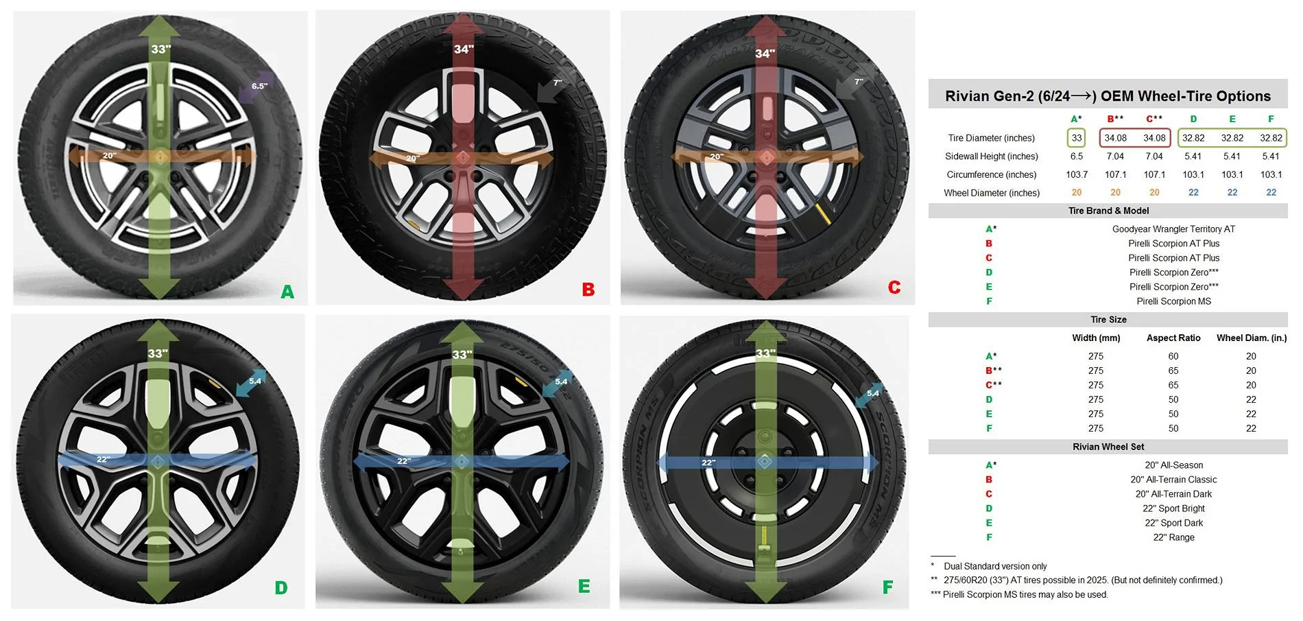

Rivian R1T R1S 21" Tires a problem   ANY suggestions ? GEN 2
Figure 5 (Gen 2 wheels/tires) from here.​
I keep editing these figures, as I learn more information and confirm facts. But the figures and tables summarize some of the key issues Gen 1 Rivian drivers faced (and, even though Rivian OEM 21" wheels were discontinued, Gen 2 drivers still face):

Let me steal a couple of illustrations from that post:
Optional Rivian Gen 1 Wheels & Tires
Figure 4 (Gen 1 wheels/tires) from here.​
Optional Rivian Gen 2 Wheels & Tires

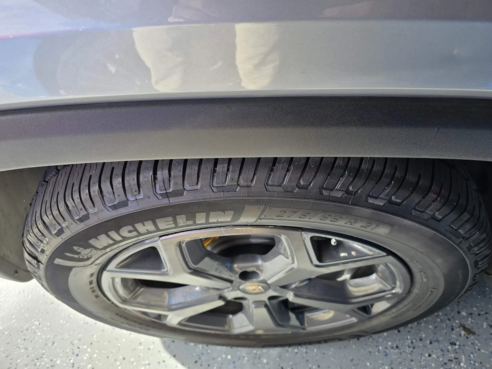

Got my Michelins installed yesterday. First thing noticed is the ride quality improvement! It was an instant change.
It's getting below freezing in texas so I can't still test grip levels for acceleration and braking but I'll be doing that in a few weeks and it warms back up. I have data (GPS data from my RaceBox) from the Pirelli's to compare.
Did you put them on the 21s? How do they look?
Yup, 21" - They look awesome! But I'm a sucker for Michellin tires ond their look, so I'm very biased :)
y
Yeah they look great. The 20’s show more plain sidewall but seems like the 21s get it about perfect. I may wait until next tire change to swap wheels.
